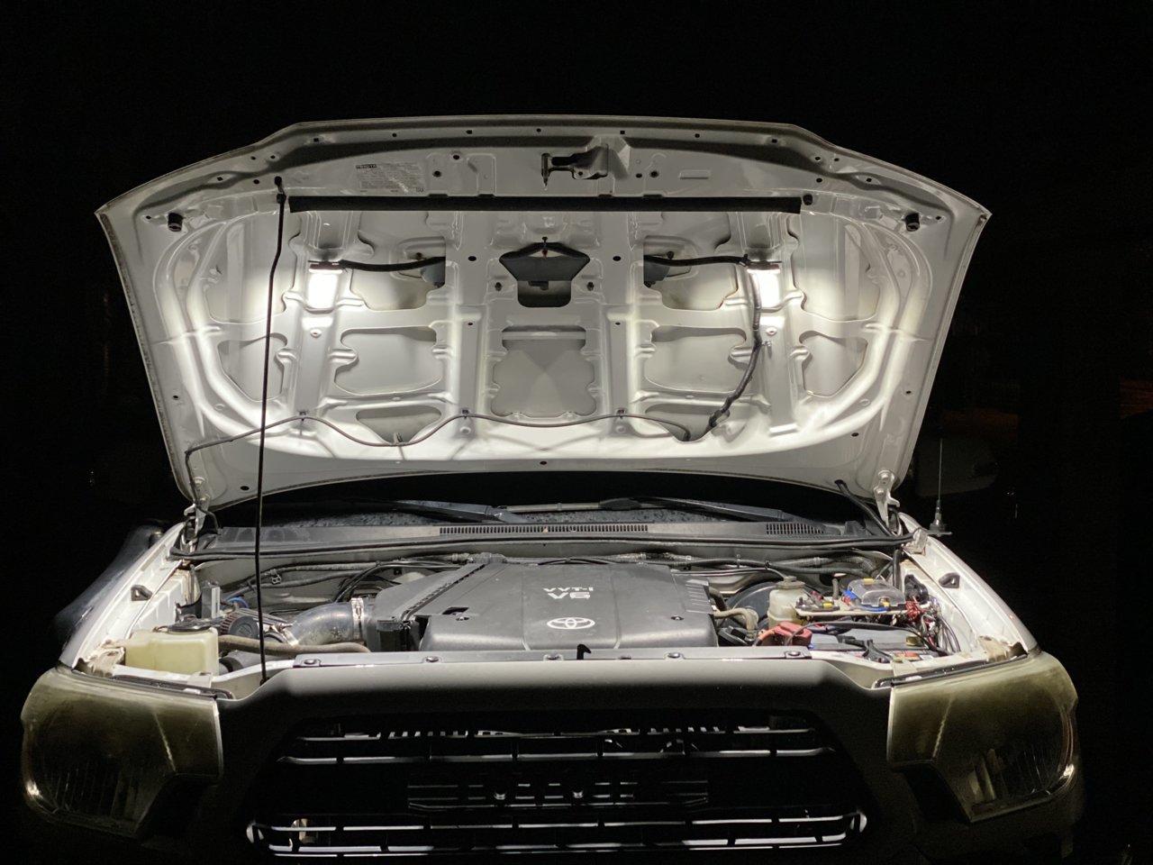

    Finally remembered to grab some pictures. 0728FA39-2C2D-4D16-A3AF-07E3419CC94D.jpg

    Looks awesome! Thanks for posting! Those KC's are bright!

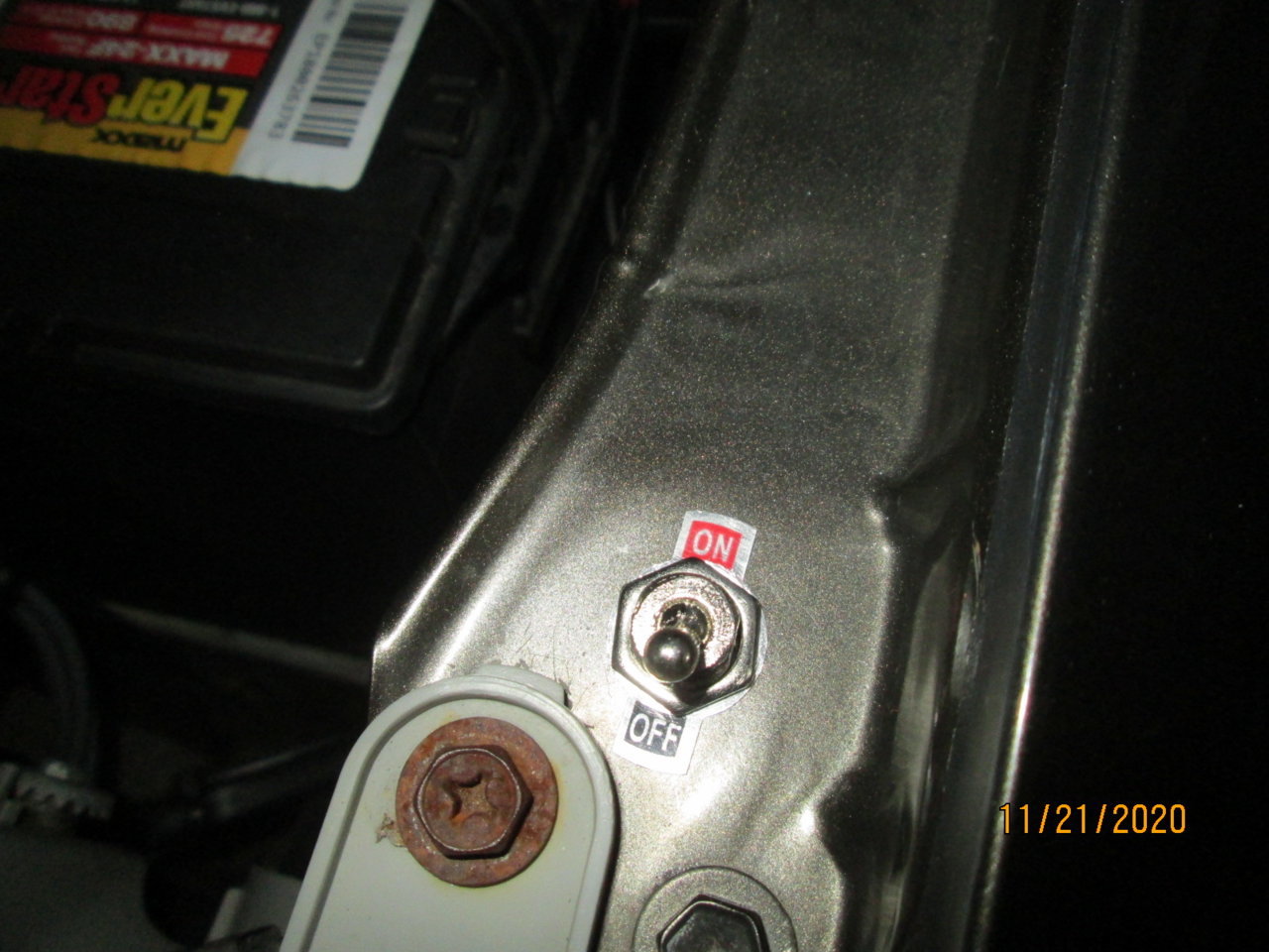

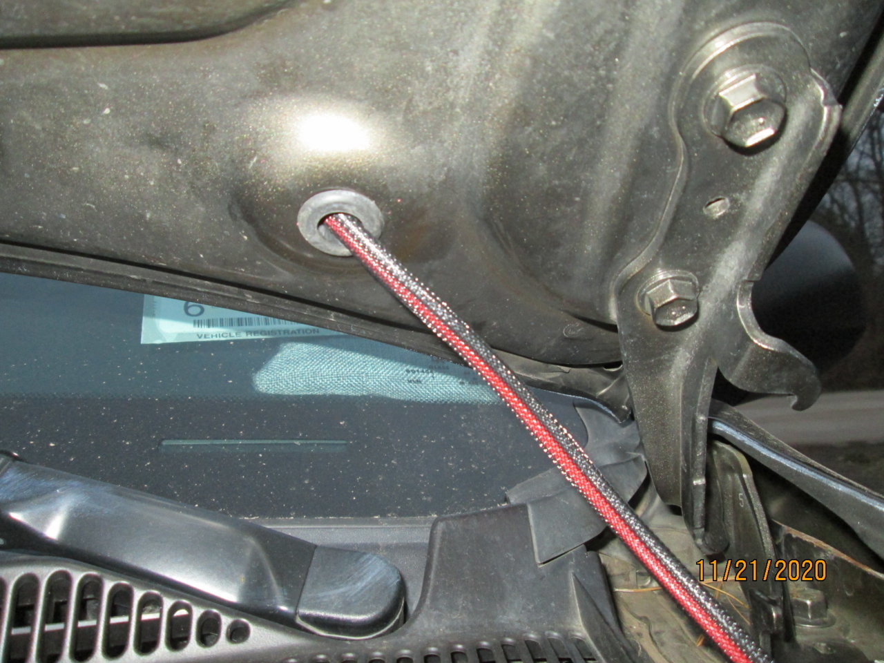

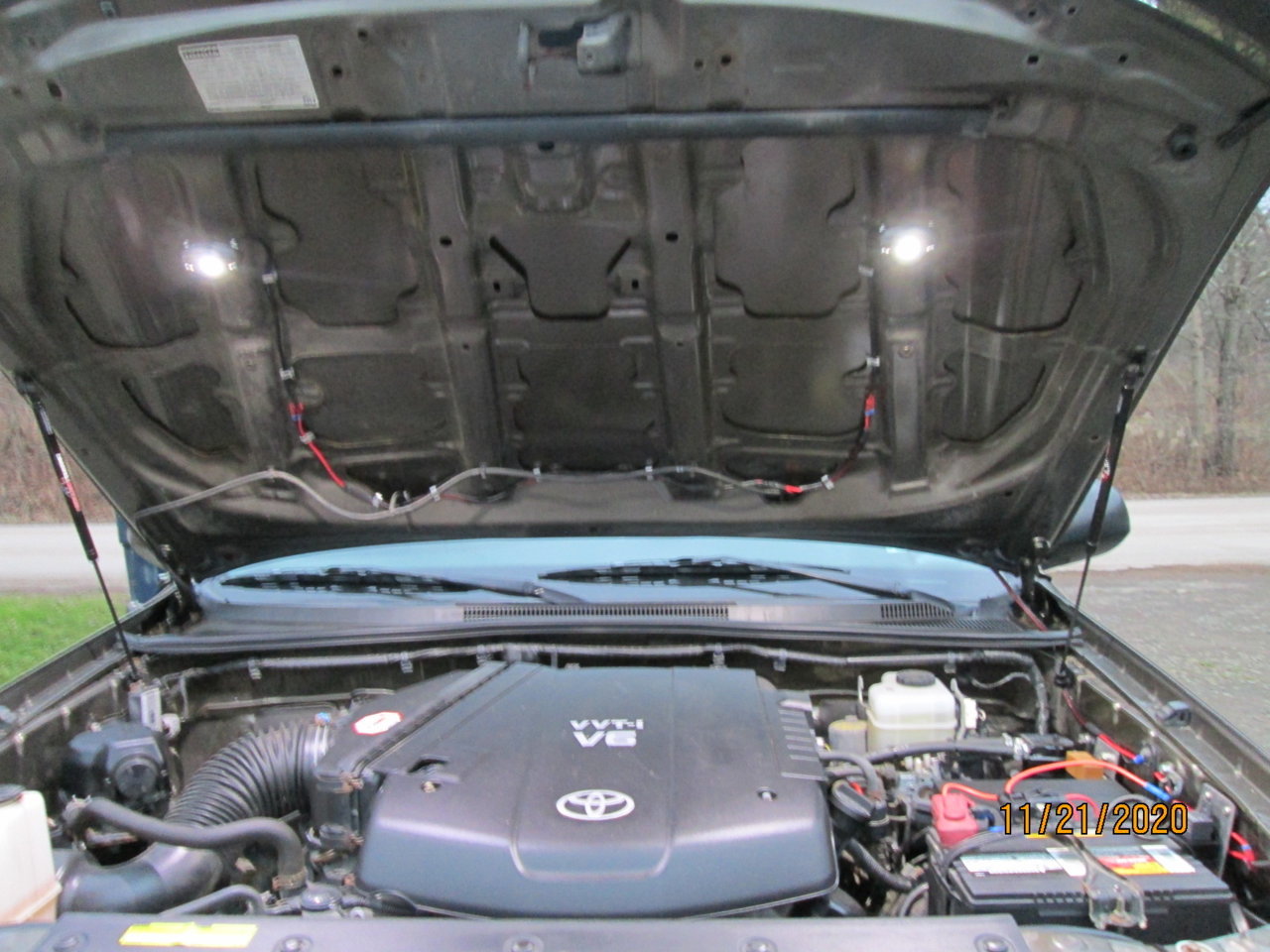

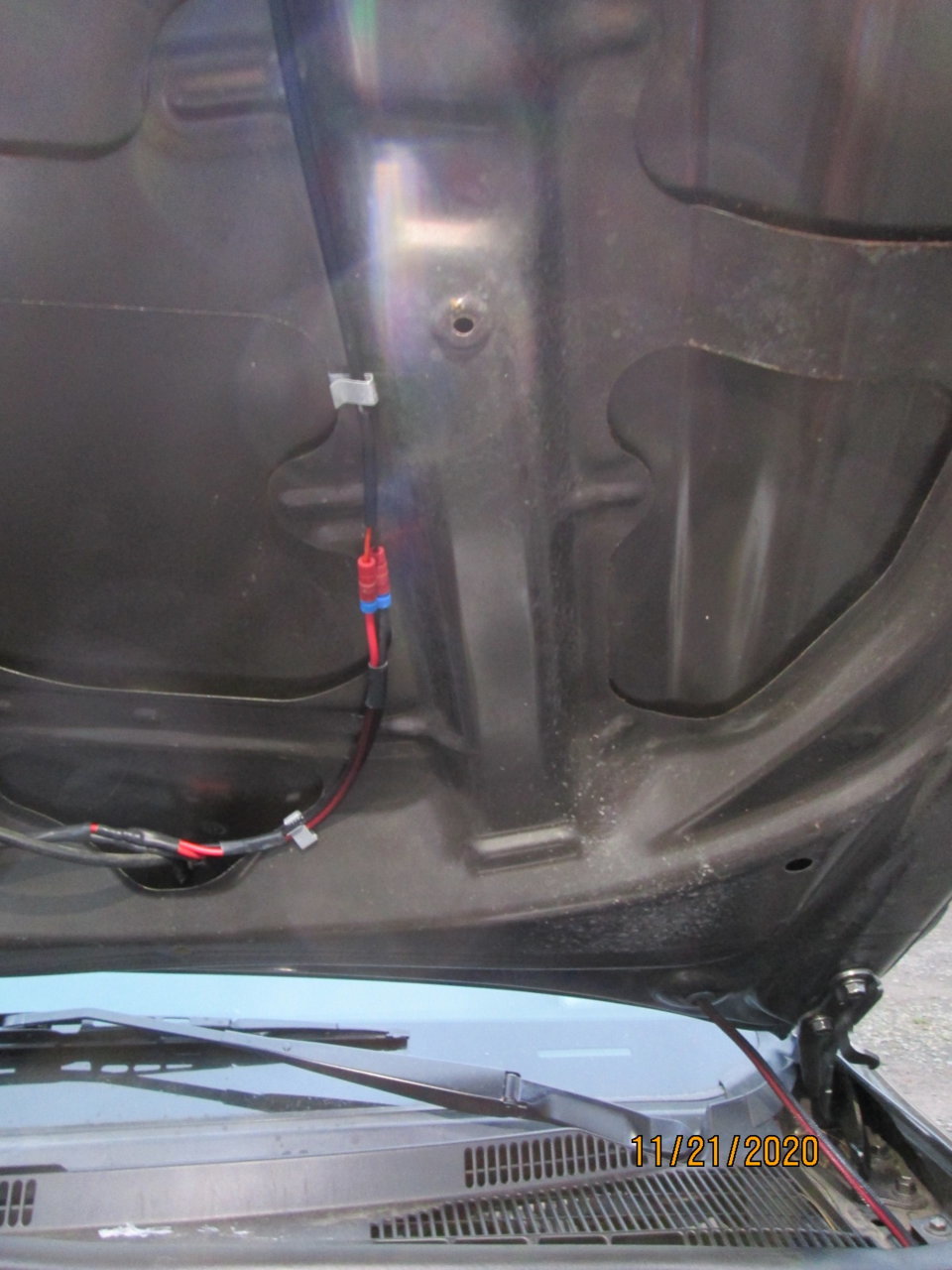

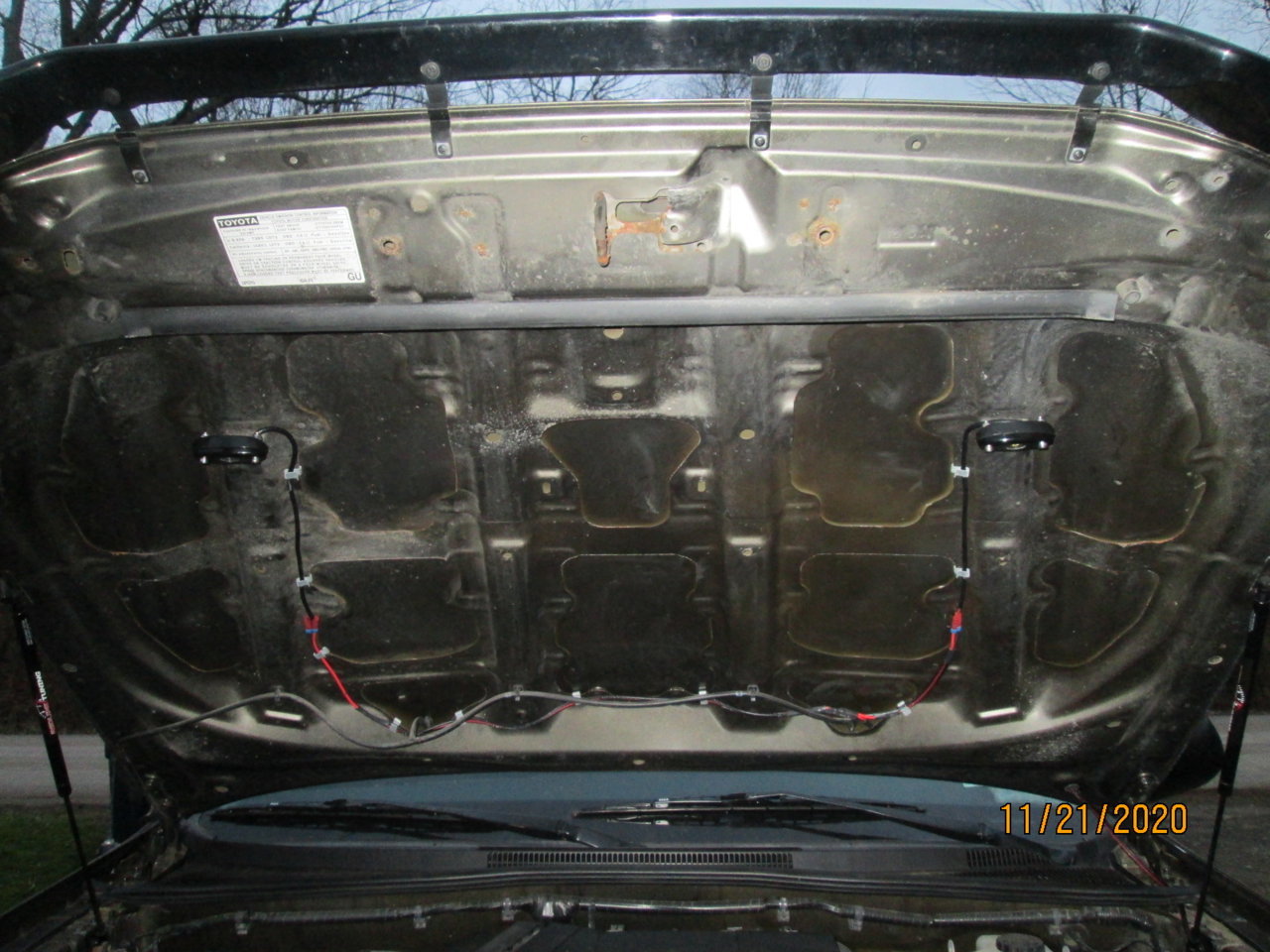

    Installed my underhood lights today. The weather took a turn and the temps drop so I had to rush to complete. When the weather warms a little I'll tidy up the wiring. I'm admittedly OCD about wiring so it takes me way longer than the average bear to wire anything.
    I used trailer frame/wire clips to route the wires and a 3/4" grommet where the wire exits the hood and enters the engine bay. I filed out the existing hole in the front of the fender to accept a switch. Posi-Lock connectors were used to make most of the connections. They are reusable so in the event of a component failure it's very easy and quick to swap a new component in.
    Thank you for making the light brackets. They worked perfectly!

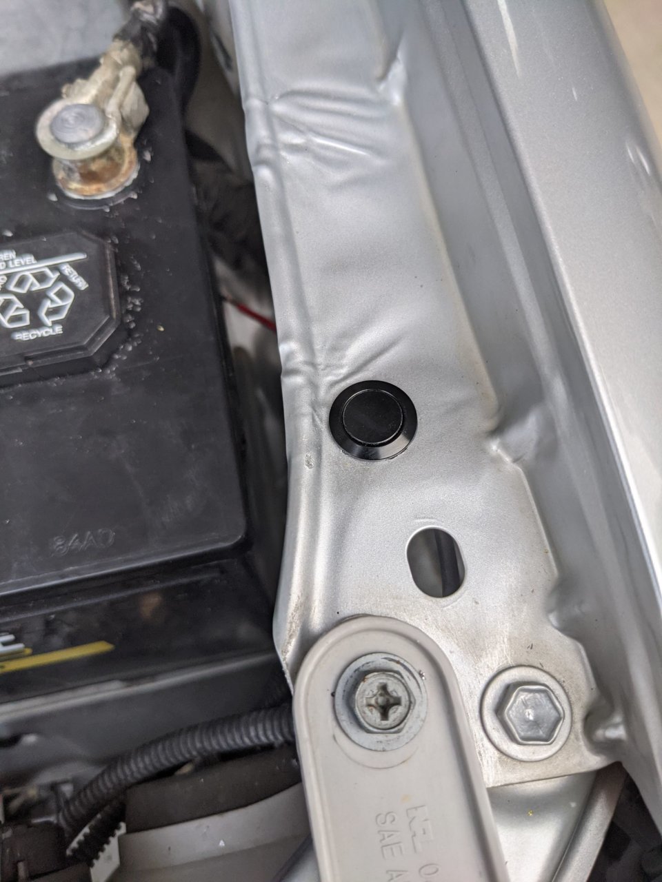

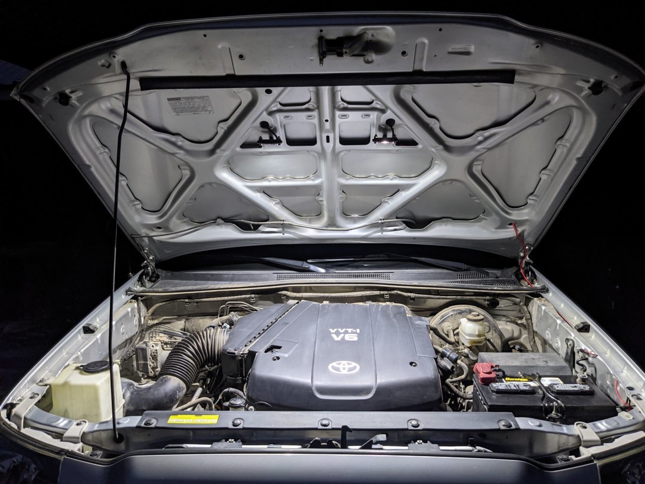

    Finally got my lights installed and wired up. Amazon kept having issues delivering my inline fuse and I was picky about the switch I wanted to use. Even with the lights a little closer together on the 2nd gen hood vs the 2.5 gen, the coverage is good. Anyway, here is my obligatory photo. Thanks again!

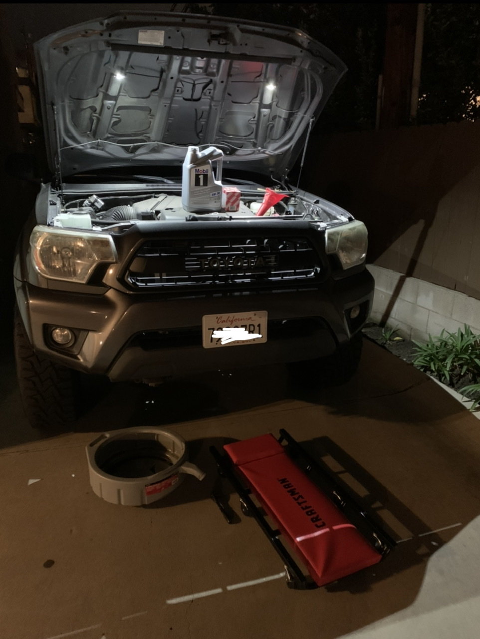

    Night oil change real easy with under hood lighting..
