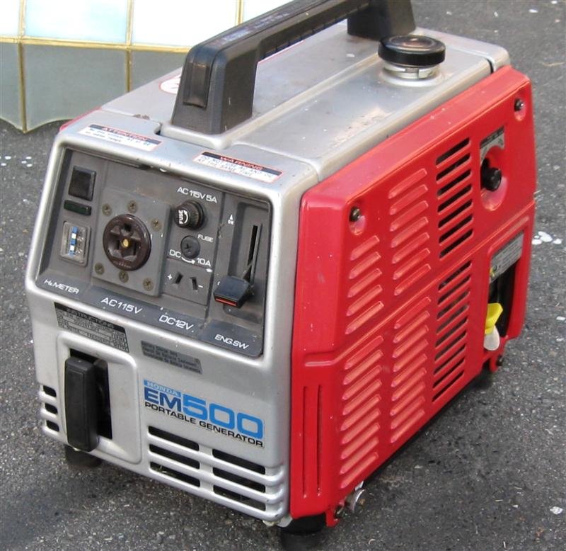

    Speedfreak
    Speedfreak Member in poor standing
    Sep 22, 2017
    #230756
    4,912
    Dave
    Canada Eh!
    2017 Tacoma TRD Sport DCSB 6MT, Blazing Blue Pearl
    Manual Mall Crawler
    I was just given one of these
    There are so many more reasonable (and cheaper) means of back up power than trying to convert your truck to handle the task.
  14. Nov 9, 2019 at 4:53 PM
    #134
    shane100700
    shane100700 Bed, Bath & Beyond Crawler
    Jun 1, 2011
    #57578
    7,012
    Montana
    2019 DCSB, OR
    Rocket Boosters
    Thank you!
    btw- 1000 watts, awesome for camping or just vehicle use. 1000 watts for backup power for basic house items, congrats you can now run your refrigerator and freezer. Not much else.
