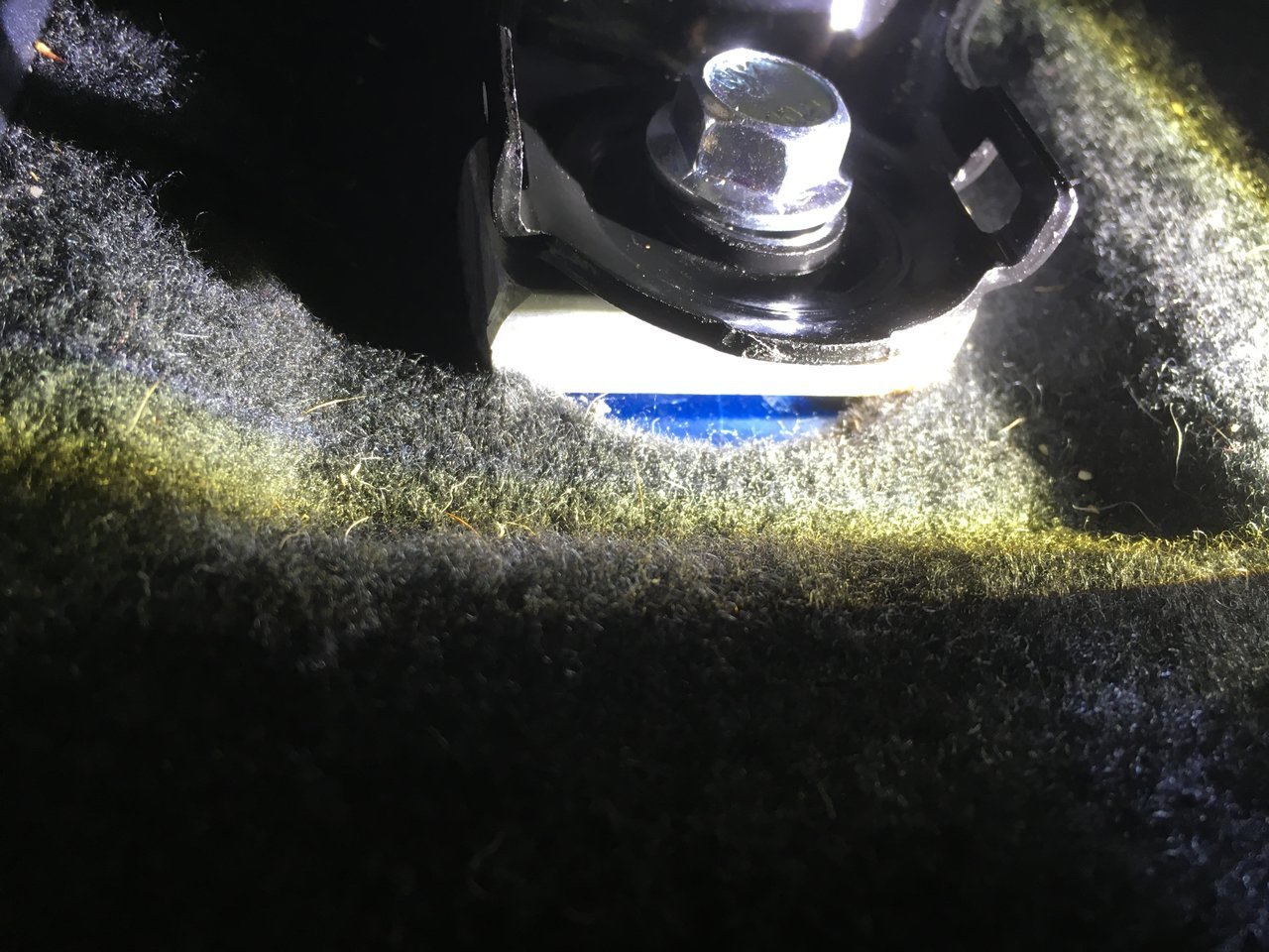

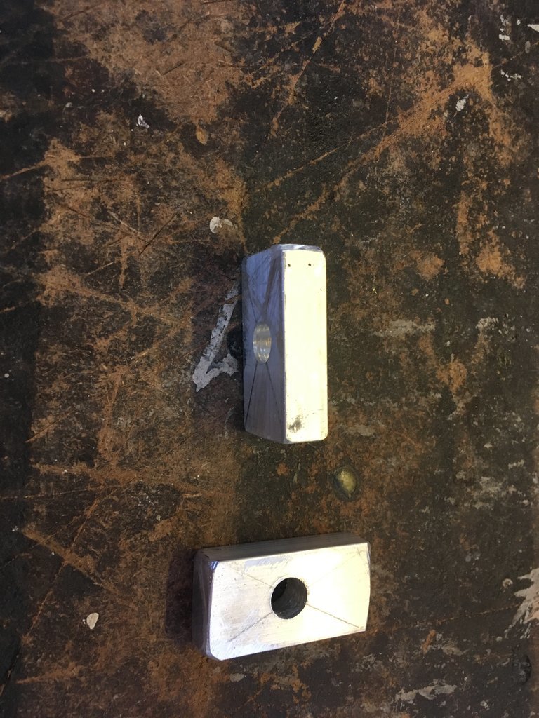

    .05" 1'x2" 6061 aluminum flat bar stock, and a couple 10x50mm 10.9 grade bolts with grade 8 washers and lock washers. I installed the spacers where the back of the drivers seat attaches to the floor. It takes the pressure off of my hamstrings. I am only 5-5 so I don't know if it would be any help for you, however, I played around with longer bolts and a stack of washers to find my custom height adjustment.
