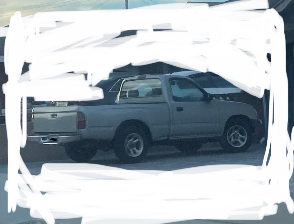

    Hello guys I will be purchasing a 2004 Toyota Tacoma single cab from a family member very soon and trying to get ideas on what route I should go aesthetic wise. I saw this cool taco driving home from work and don’t know what year but loved how low and clean it looked! Any guesses on what wheel size he might be running or how much he lowered it? And can I make my 04 look similar to his!IMG_0486.jpg

    The forum here for street tacos would be where yo start
    Also is it a 5 or 6 lug truck? Very different suspensions

    Isn't that just a regular 5 lug RWD Taco???

    As others have mentioned, you posted a picture of a 5-lug (I.e., 5 lug nuts per wheel) Tacoma, which is different than a 6-lug 2 wheel drive Tacoma (aka prerunner). They have the same body and mostly the same frame, but completely different suspension designs.
    the most obvious difference is that 5-lugs come on small tires and ride much lower. They also have smaller 2.4l motors. I am sure there are other differences.
    So, if you are buying a 5-lug, it’ll already look like this. If it’s a 6-lug I guess you’ll need to look into lowering the suspension. Start googling or searching these forums and see what you can find.

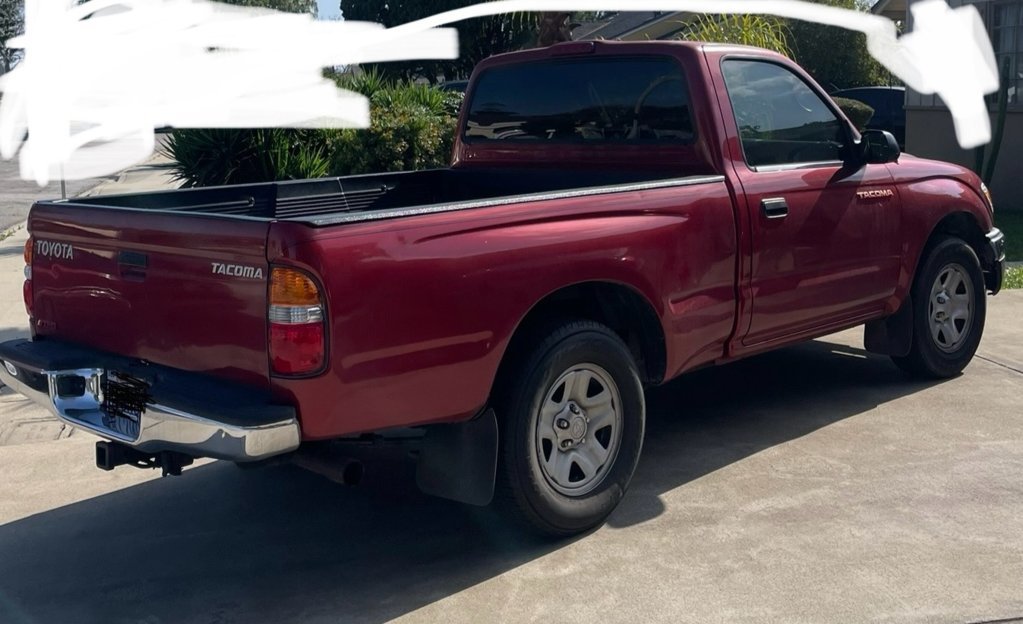

    This is how mine sits right now for reference

    Only difference I'm seeing is the wheels and mud flaps. I don't think that one is lowered, or if it is, not much.
    Theres a ton of info on suspension wheels and lowering kits over on the 5-lug forum

    Really hard to tell if the gray one is lowered from the picture quality, it does look slightly lower if I were to guess / speculate comparing the 2 pics...
    here's some sweet rides & info...
    I dont recall what gen single cab I had, guessing 90's of some sort, lowering was super simple, crank the front torsions & install some rear blocks...

    just know what size you want ....in later years stock came with 15in rims like yours..
    the earlier ones first few years .....like the one in the picture....came stock with 14in.....like mine

    I talked to the owner briefly and he said his truck is a 2000 and it’s on 15s he said it wasn’t lowered but my 04 sits taller in the rear and I have no idea why if there both stock height and 5 lug??

    If all else is equal, then his leaf springs are shot in yours are in better shape

    Will worn out leaf springs really make a big difference in height? Sorry I’ve never had anything with leaf springs so I’m not familiar.

    Yes

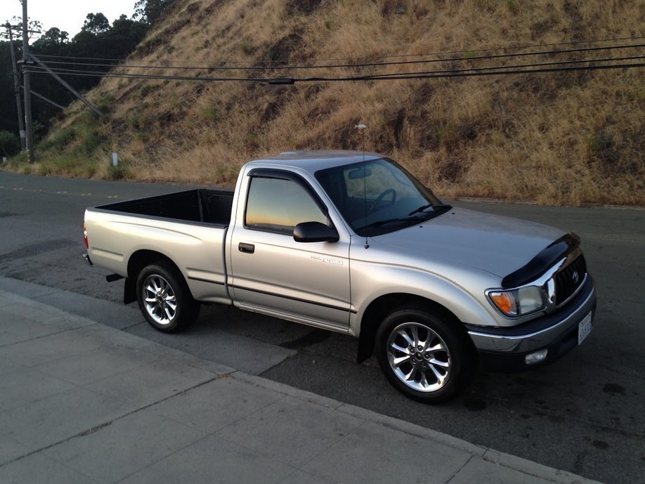

    Looks like stock height 5 lug with 15 inch rims to me. Im running 17 inch rims with 60 series Yokohama's.
