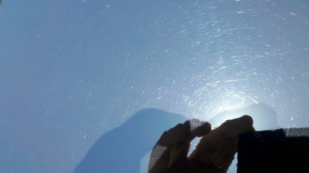

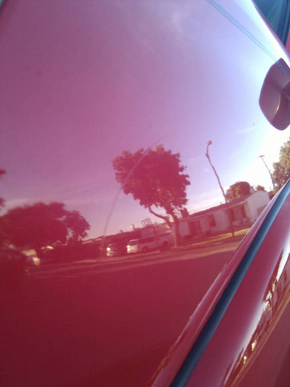

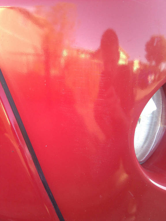

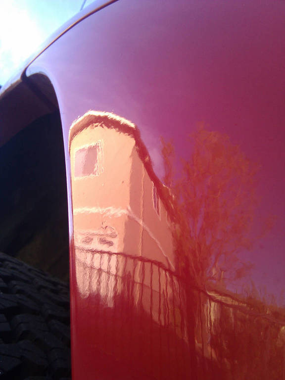

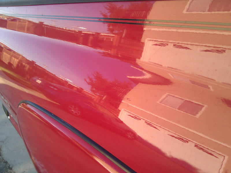

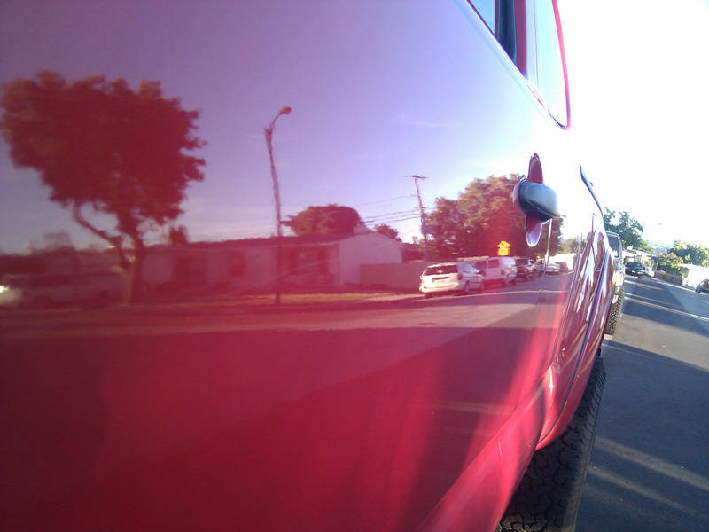

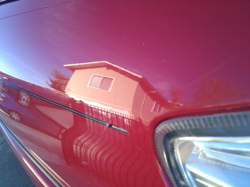

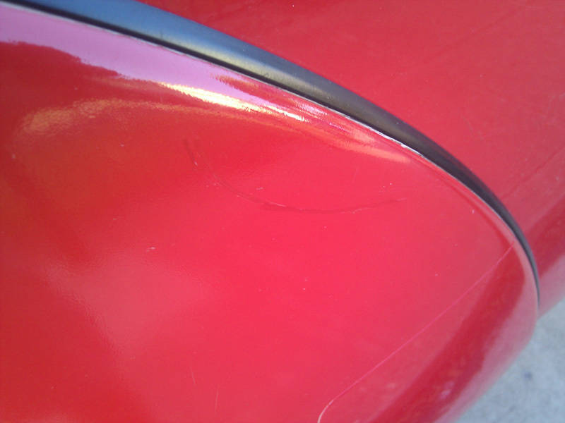

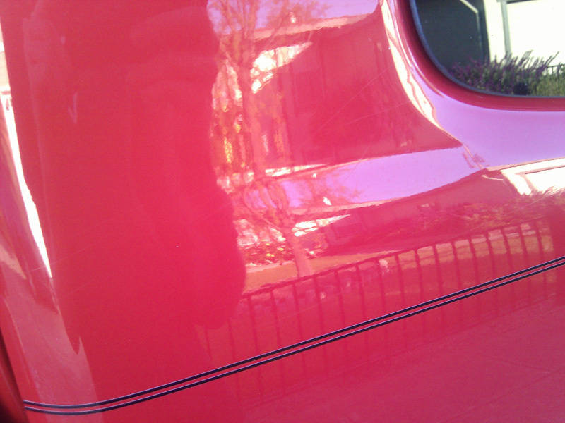

    I bought my truck used last year. And it had its fair share of scratches, chips and touch-ups. I actually noticed that part of the front bumper has been resprayed, as well as a new fender over the drivers front wheel has been installed. Plus what looks to be a new fender-flare that was painted at a shop because the paint is much thicker than my other 3. Cant see hardly any of the plastic dimpling that makes them more dull than the surrounding paint.
    What I want to do is level out the paint that has been sprayed on my front bumper. This part was pretty shitty and there are actually some drips in it.
    Also there are a fair amount of scratches, some that are only in the clear coat. Some that are deeper. mostly from trees on the trail. I tried hand polishing these and it helped a lot but i think i need a real orbital to get them to fade away even more.
    There are so many products to chose from its hard to know what is really right. I need to read more but wanted an opinion on that kit. its $225 right now with free shipping. Im sure that orbital will last me close to forever and i can use it on my older truck so i dont mind spending the money to do it right.
    Here are some pictures of the damage i want to fix:
    This last one is of some of the dripping in the paint. Its better than it was after i spend a half hour polishing this part, but I think i need to step it up. Sorry for the focus issues. Hard to get pictures of the scratches and not the reflections with my phone.

    Since you're new to detailing I'd recommend a polish and then a sealant followed by a decent wax.
    There are many different options available although I'd recommend a product like meguiars m205, then a sealant (like black diamond) and then a wax of your choice.
    Take your time, follow the instructions and use CLEAN microfiber towels. I see more people damage their clear coats by washing/drying/waxing with contaminated towels.
    The kit you posted is a great start. You can achieve great results with an orbital buffer. Just make sure to tape off any plastics before going after it.

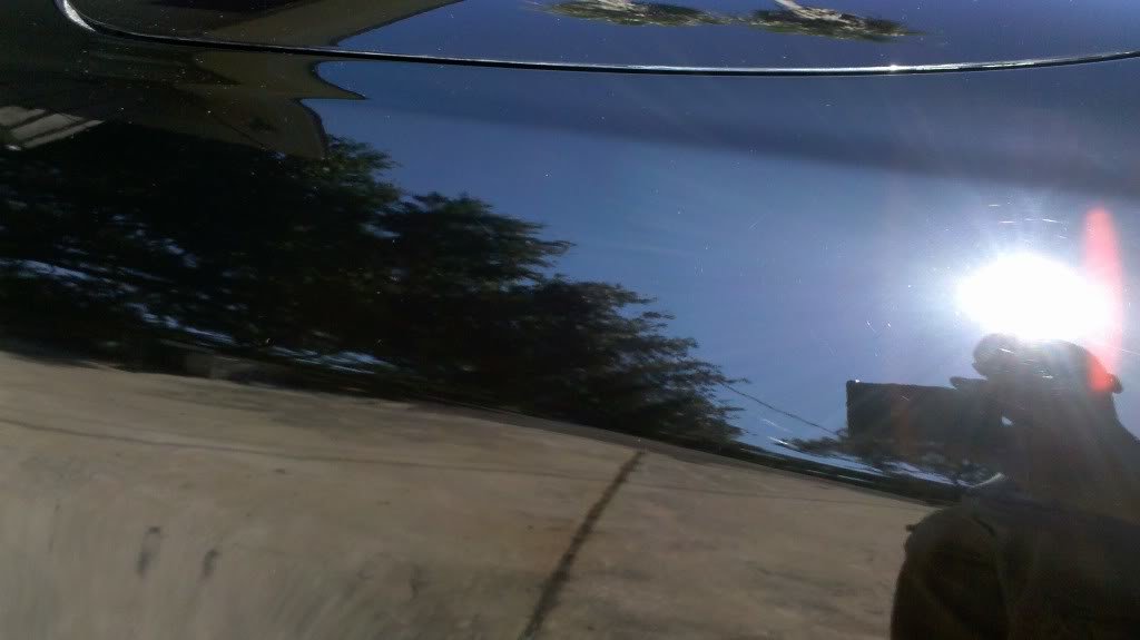

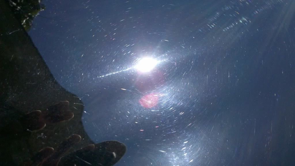

    It seems like everyone I talk with prefers a different product.
    I like meguiars m105 since its basically an industry standard. I've taken the time to work with the m105 enough so I'm pretty comfortable using it.
    Here is a CLK63 before and after. I spent over 10hours on this car to get the clearcoat back to acceptable condition...although it was far from perfect.
    After. Again, the car wasn't perfect since some of the scratches were really deep. I made the decision to stop where I did because the owner was happy with the results.
    As RoyR posted though, Klasse products are great too...it really depends on what you're looking for...and patience. Just read the directions and make sure your towels are clean!

    I guess you have a few options. You can always use up your nxt wax and try something new once your current bottle runs out.
    Finish/appearance is subjective. Not only that, but a "better" finish may not PROTECT better than a less glossy finish. example... You can load up a finish w/ oil based glazes that will look outstanding and make the finish appear to be wet and a million miles deep, but those glazes wont last very long, based on their chemical makeup. A carnauba wax or synthetic sealant will protect longer, however the appearance may not be as impressive.
    Sealants tend to outlast canaubas.
    Carnaubas tend to have a deeper, glossier appearance than sealants.
    imo, carnaubas protect better against bird droppings, etc, and sealants against pollutants.
    You can layer certain products w/ no ill effect.
    I prefer glazes and carnaubas on dark paint colors, sealants on very light colors.
    Have I made this more confusing yet? lol
    So let me just clarify by stating the ez creme glaze is not a "necessary" step in your lineup. It will add depth and it'll look great, but you could technically skip it to save you time and $.
    If you really want protection, take a look at those collinite products I linked you to. (476, 845.. or even their 915). That'll be your best bet.

    Do this...
    105 w/ orange pad (will do the large majority of correction)
    205 w/ white pad (will refine finish)
    EZ Creme Glaze or poorboys black hole, to help hide remaining imperfections (http://www.detailedimage.com/Glaze-C14/)
    Top with your choice of wax.
    YOu'll be claying the truck prior to polishing, right?
