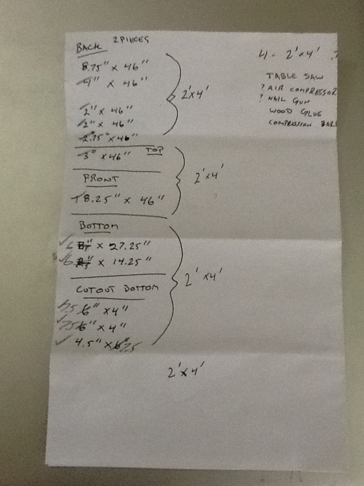

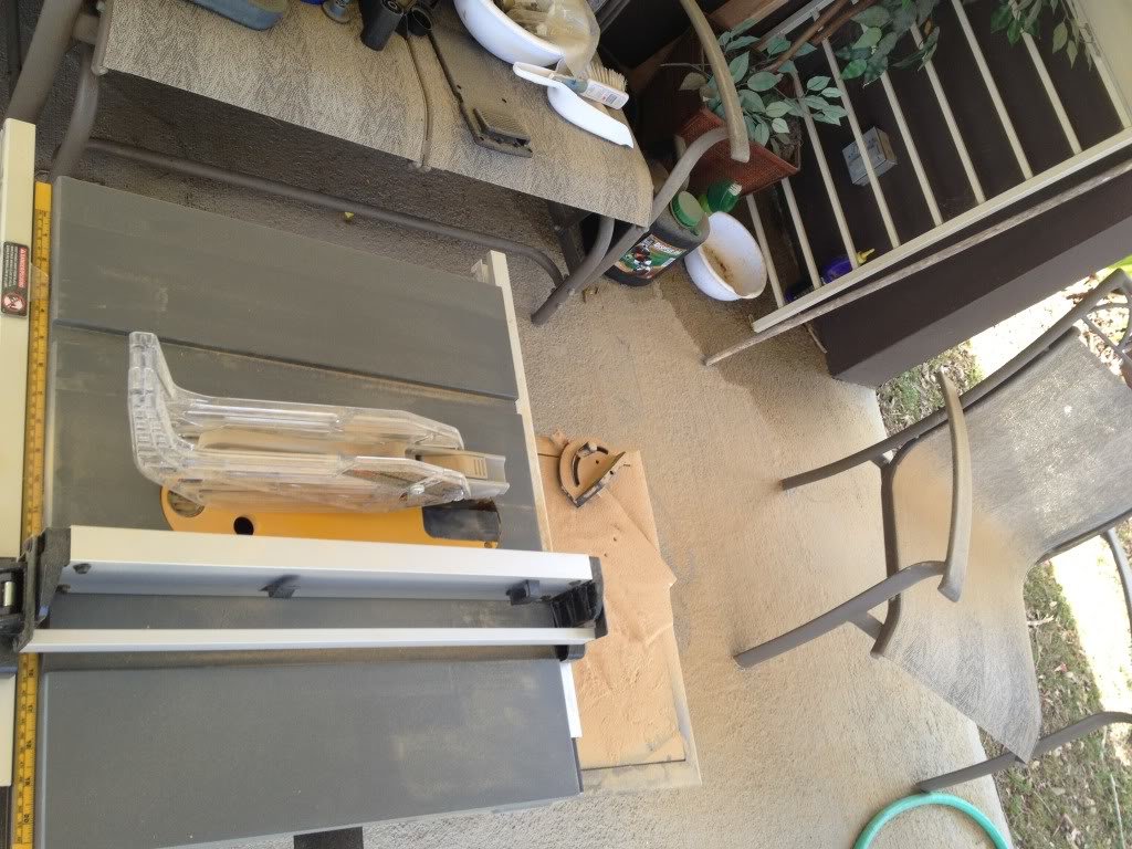

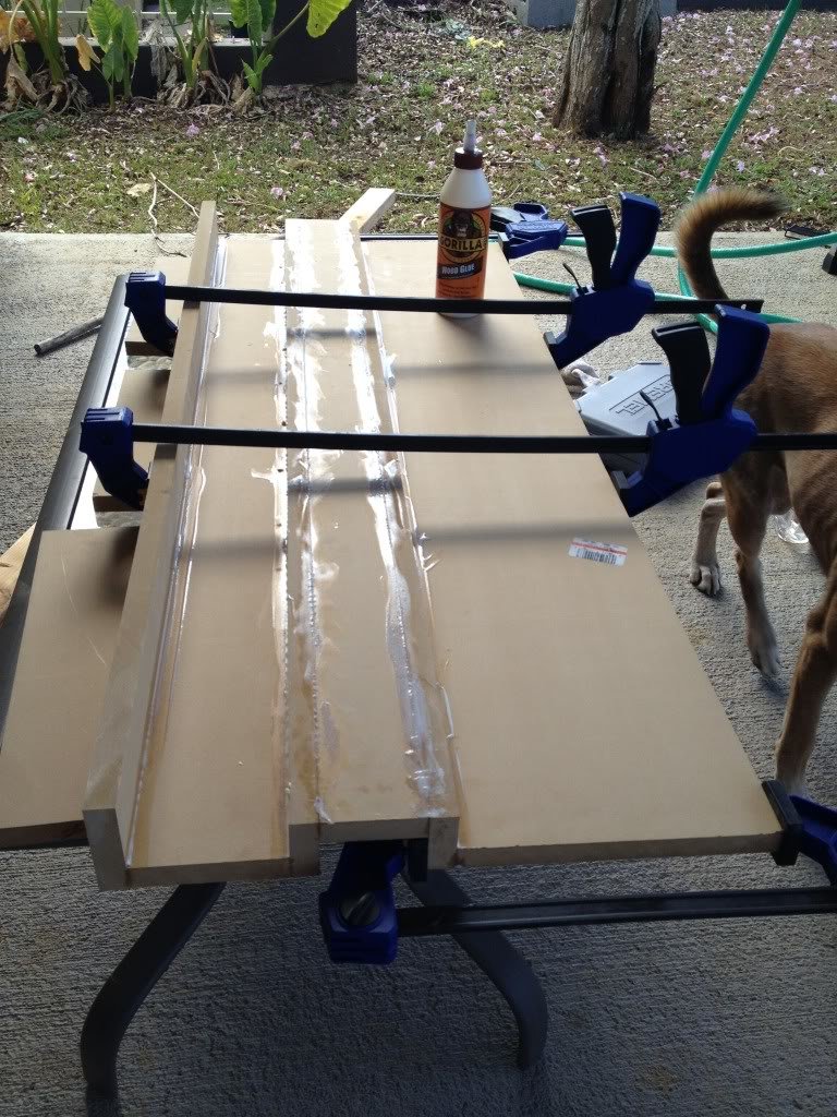

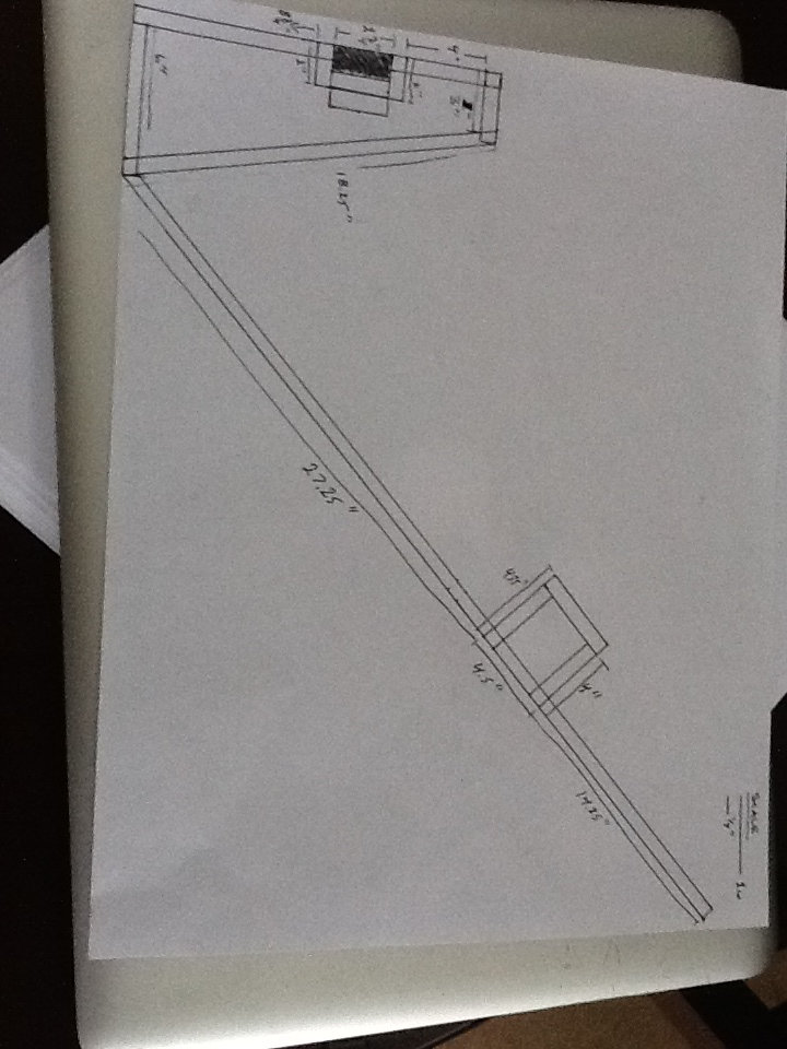

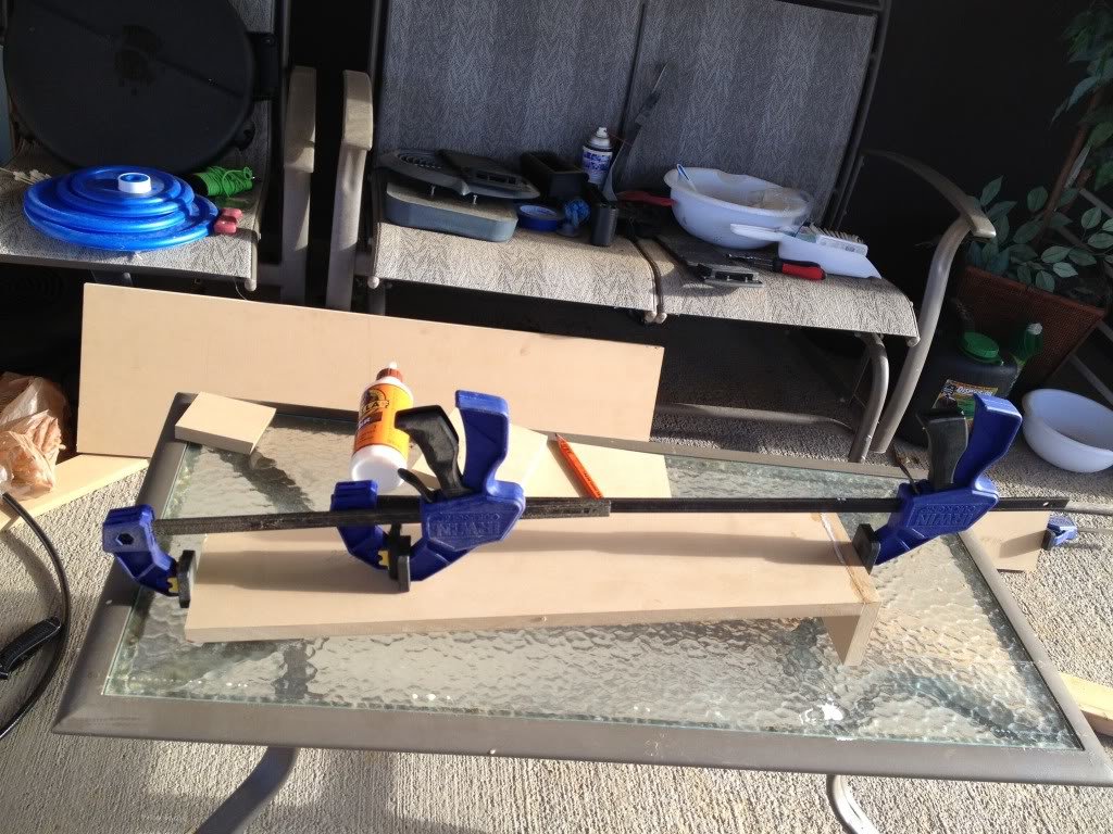

    Here's the start of what I got in Pictures.
    First off is a couple pictures of a couple of the 10 or 15 pages of drawings and diagrams I tried to draw as I thought of ideas. This is the basic jist of what it should look like when I'm done.
    The cut list so I don't screw up.
    New tools and the cut boards

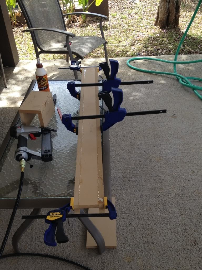

    Some goodies starting to go together.
    I'm still putting things together right now, should have the back and top connected today and make the front angle cuts so that I can get the sub holes done.

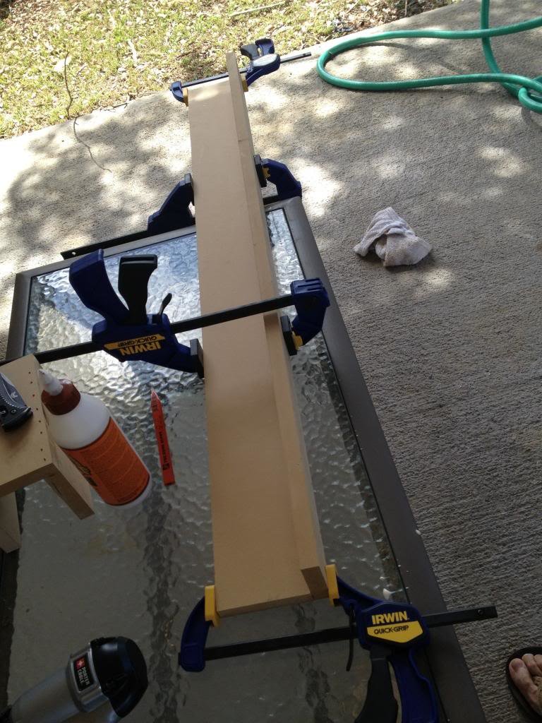

    Back is put together. Waiting for the glue to dry, then I'll nail gun the last piece that was glued and I'll be ready to verify the angle for the front cut top and bottom.

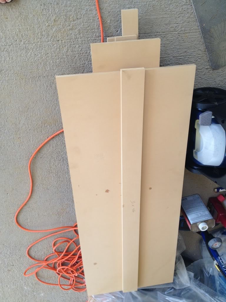

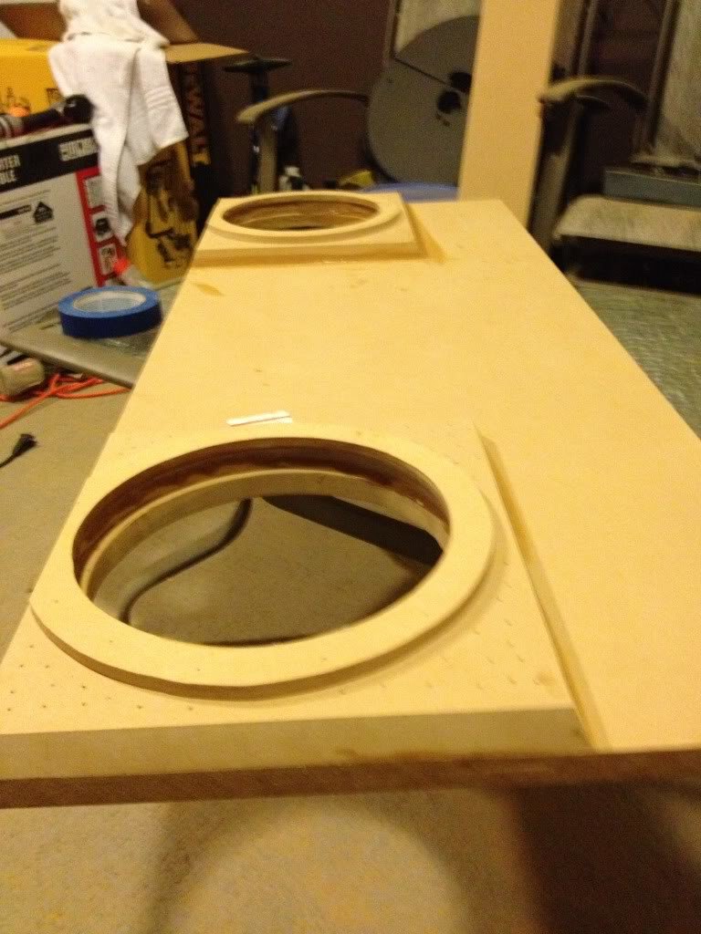

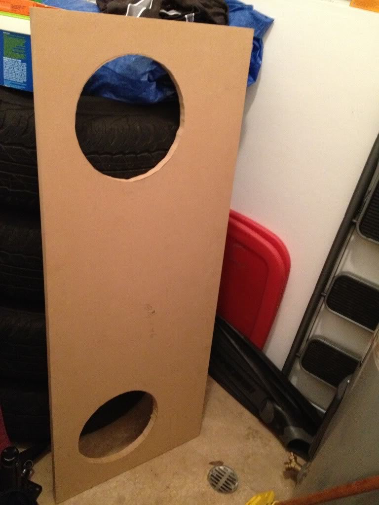

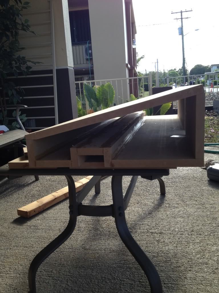

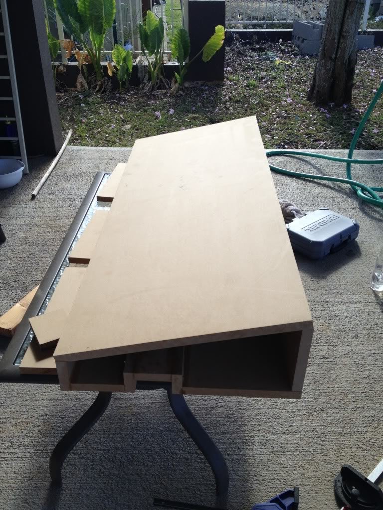

    Working the bottom section.
    Mock up for my angle cuts:
    And the rough cuts for the subs to fit in:

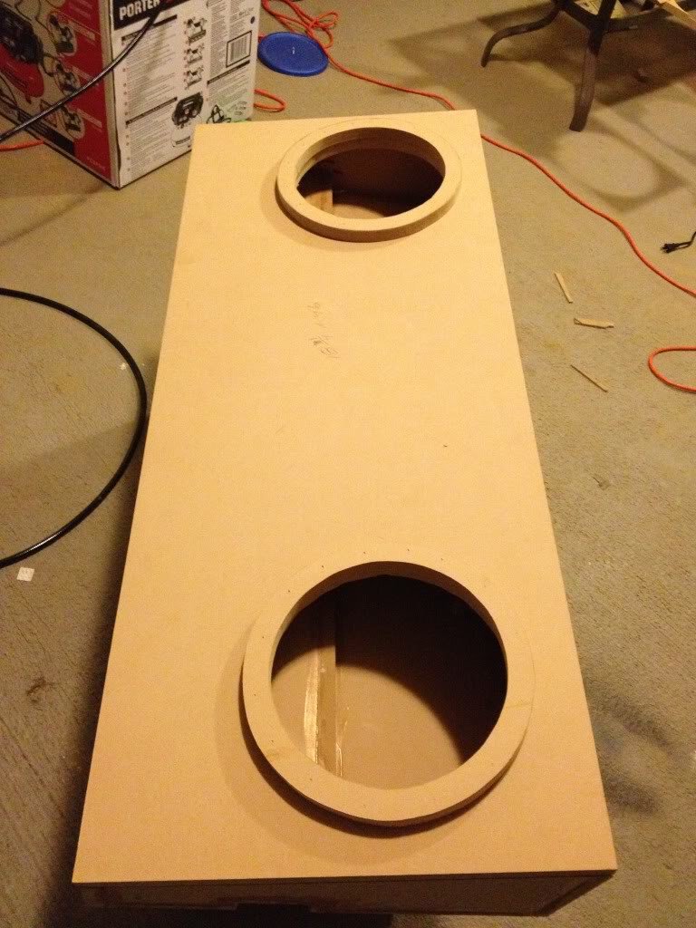

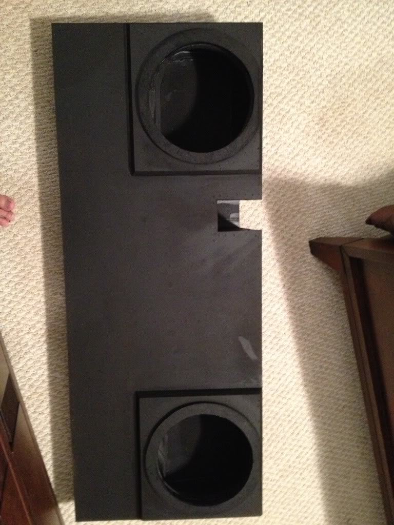

    Got home tonight and finished the dividers and installed them.
    Made my cutout rings for the subs to screw into and attached them to the face.
    The face isn't fully attached yet, that'll be tomorrow. I have to make one more run to the store for some wood puddy to fill some tiny gaps and the box will be done, minus the terminal connectors.

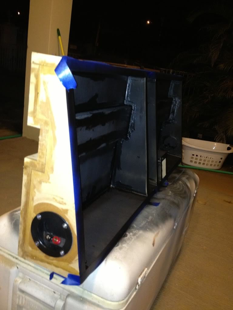

    Made a little progress today finally. I had to redo the top because of an unforeseen accident. Instead of scrapping the whole thing I salvaged it a bit and I think it came out good.
    Painted the inside after I attached the terminal connectors.

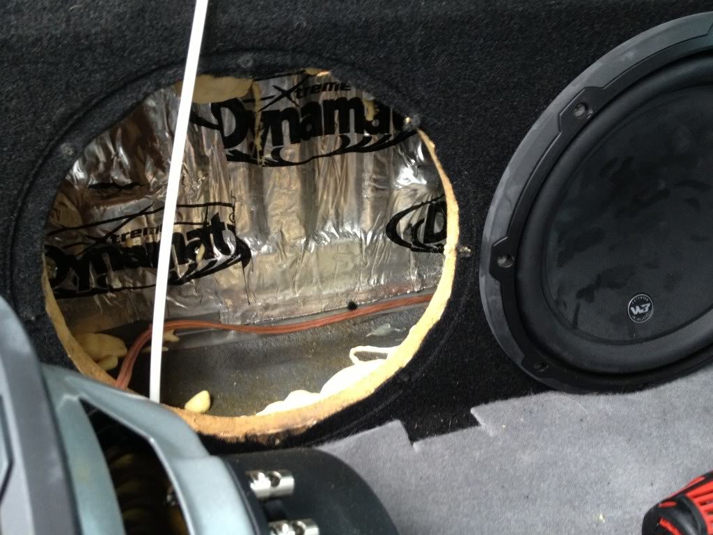

    Here's a picture of the reason I'm building a box. Three years ago I had a shop build me one and this is what I just found out they built.
    As you can see its not even a real box. That'll teach me for not learning something before I buy.
