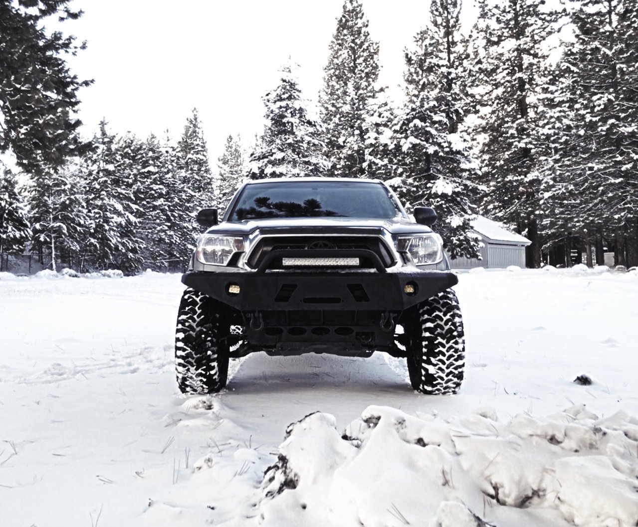

    Bilstein 5100’s Dakar CS047R Supreme Suspension U-Bolt flip kit Sumo Springs Blue ADV Fiberglass Fenders 1st Gen Snorkel DV8 Apex Plate Bumper X-Bull 13k Winch KC HiLiTES 6x9 Trail-Gear Sliders 4x Innovations LCA Skids Spidertrax 1.25” Eagle Alloy 16x8 4” BS Fierce Attitude M/T 315/75R16 Bearcat 980SSB CB
    Can confirm, 305s will fit with a standard CMC and light fender trimming near the cab mount. I offroaded a lot and had an occasional light rub. Didn’t see much flexing from rock crawling though. And of course the usual light rub in reverse.
    I had a very similar setup:
    Bilsteins at 2.5
    SPC uppers
    16x8 -11
    305/70r16 Fierce attitude
    Alignment was mostly seized in place with somewhere around 2.5° caster on each side
    Ran that setup for 5 years with absolutely no issues!
    Ccrames2018[OP] likes this.

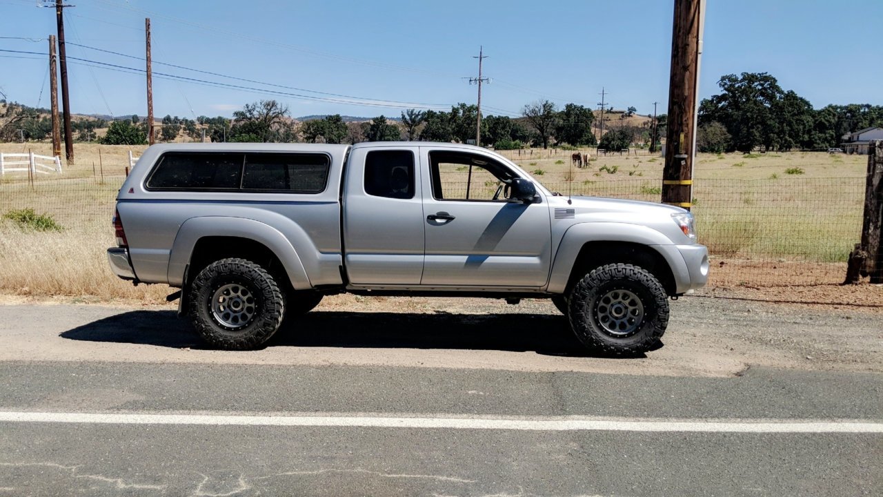

    You’ll be good with a cmc and trimming. I get some minor rubbing toward the front of my wheel well liner, which I need to trim down. But I have a 285/75/16. A buddy has 305s and it fits fine

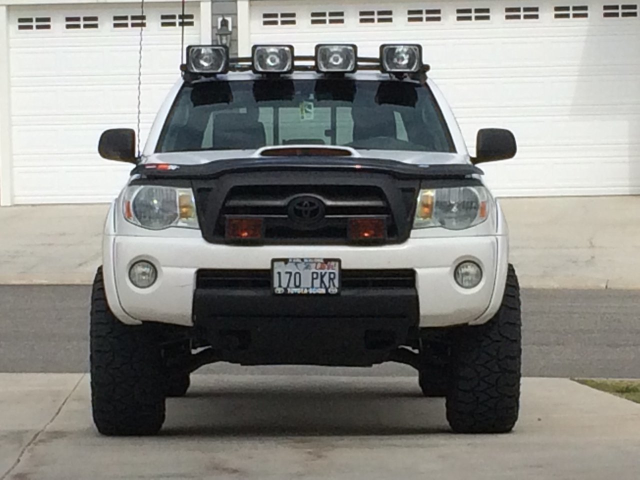

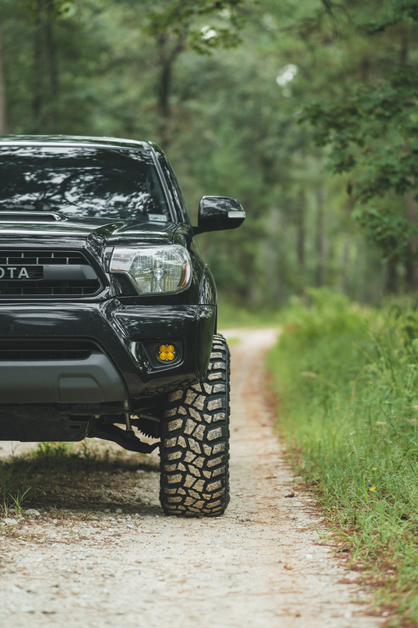

    315s with 2 1/4” lift. Cut fenders cmc etc. the only time I’ve rubbed anything was my cmc while at full lock dropping the front about 12” down a rock 984DF83B-5914-4026-9073-31B5BECFF757.jpg

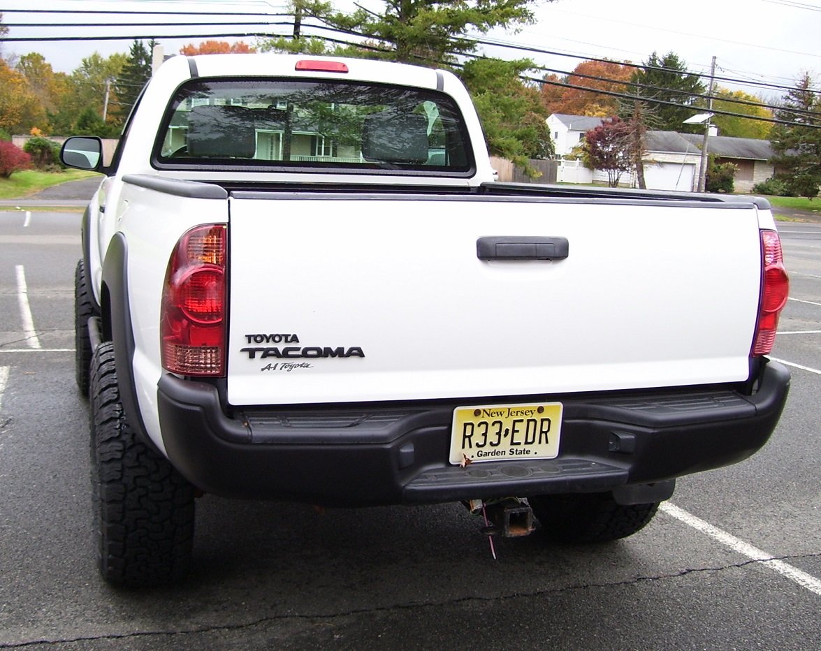

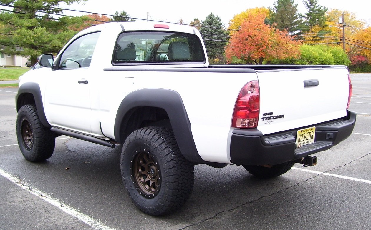

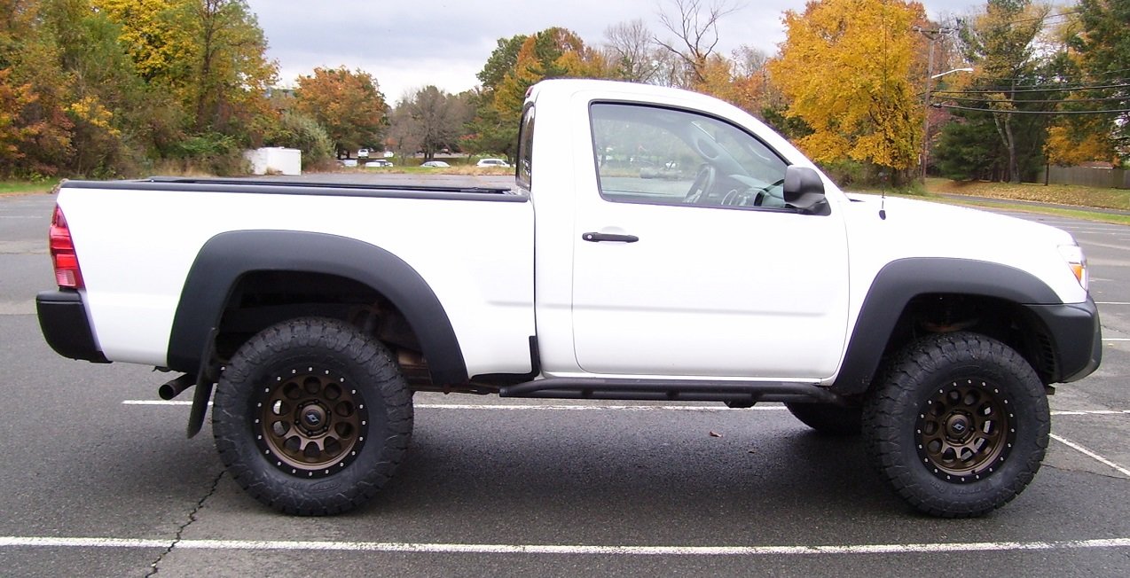

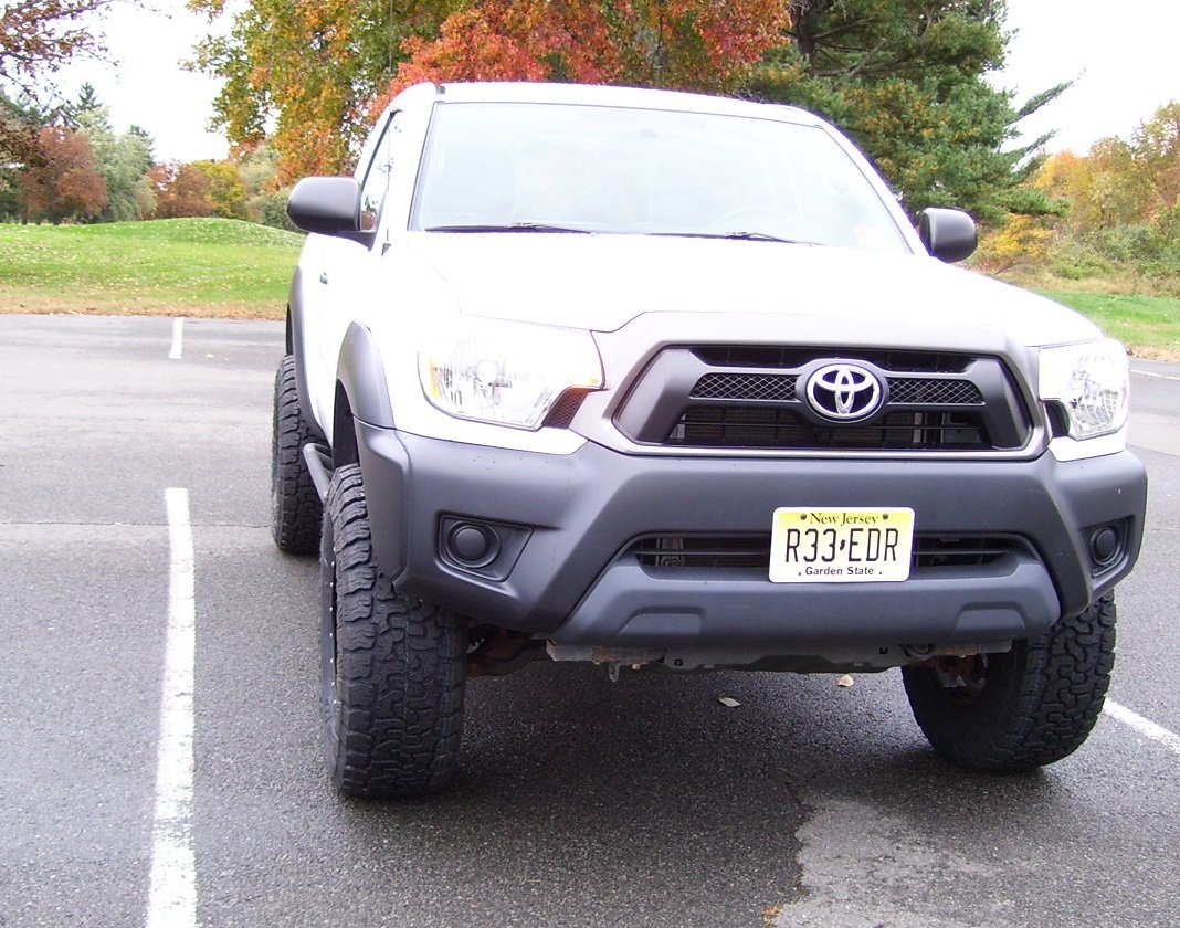

    OME 885/nitros, SPC UCA, 305/65/17, AAL
    I'm running 305/65/17 tires on 17x8.5 with -10 offset. My truck already had the pinch weld and fender trimming but no cmc. I run the SPC UCA's at position E and I get just a little rubbing at full lock usually on inclines. But the tire shape probably helps. I have the AMP AT tires and they have more of a crown to them.
    Ccrames2018[OP] and BassAckwards like this.
