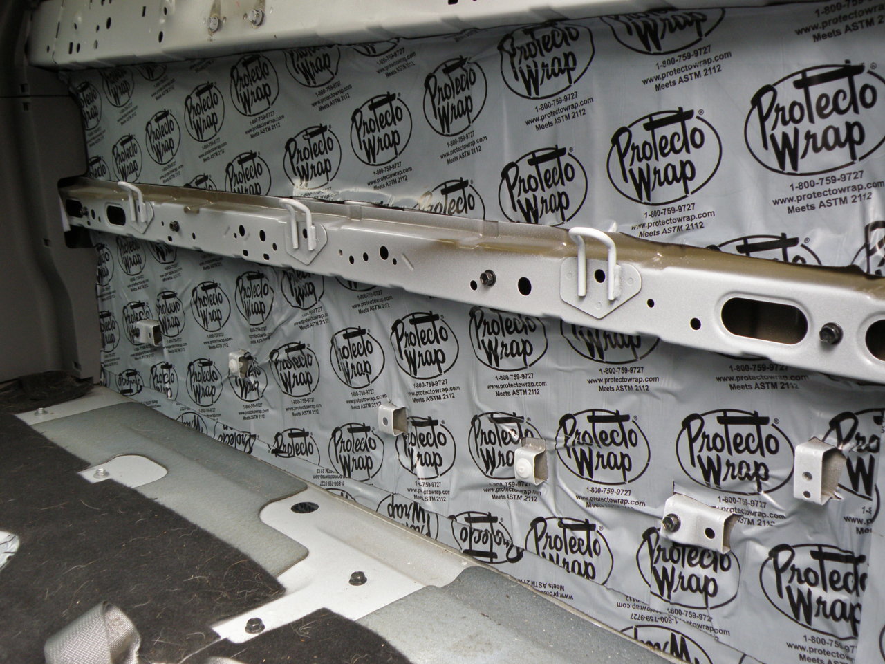

    Lots more to do ... rear wall insulation and finish, build deck with access to storage areas. Any thoughts from the group would be greatly appreciated.

    put in some sound deadening. the cabs are made out of recycled tuna can tins and you just removed two seats worth. That back wall is especially bad. I deadened my cab and that back wall was a real treat/pain to do and I'm still not happy with the results.

    I was thinking of adding 3" fiberglass behind a 1/2" plywood panel covered in carpet. Do you think that would be sufficient?

    deadening is all about decoupling resonating mass. the best way to do this is closed cell foam, mass loaded vinyl and metal backed butyl sheets.
    https://www.sounddeadenershowdown.com/
    he's retired but left all the info on the up online. just a fantastic dude. here's my odyssey: https://www.tacomaworld.com/threads/14-dcsb-sound-deadening-project.332608/
    Thinsulate automotive insulation is really good stuff. I'd do some closed cell foam, Thinsulate and then the ply.

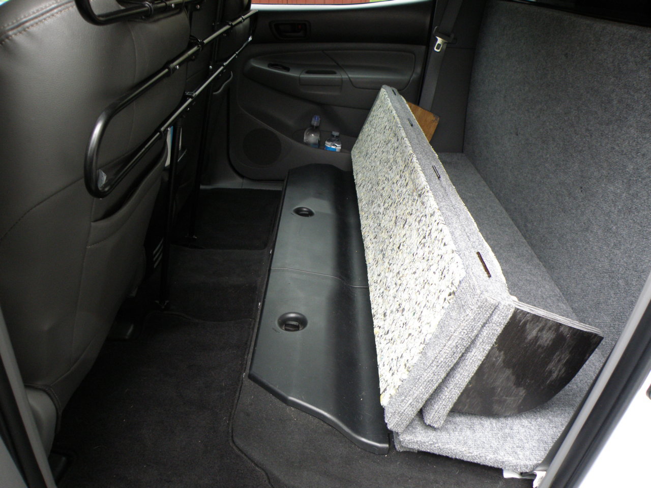

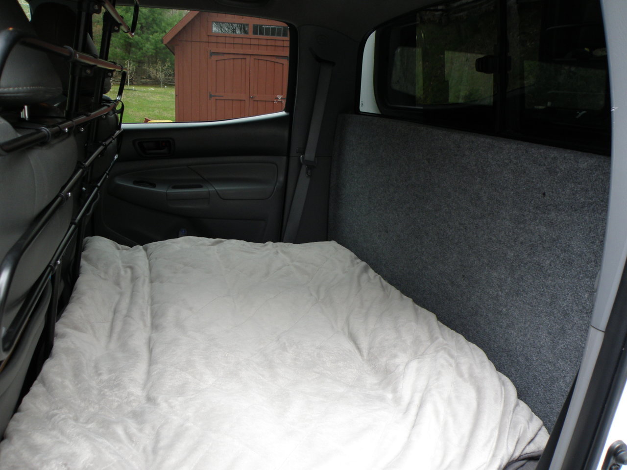

    Hi TW! Well phase one is done. In an effort to control cost I have used materials in the shop. I installed butyl self stick material that I use to weatherproof new window installs, It definitely helped. I used 1/2" plywood with 1/2" high density carpet padding glued to the back side with indoor/outdoor carpet glued to the front. I am keeping this mod reversible for future resale. I know the purest will find some issues but cost is a factor. Now to complete the deck with access to jack storage etc.. But the Big guy can climb in and ride in comfort now! Oh! Regarding the steel in the rear wall, I broke 3 new bits attempting to drill screw holes. I had to purchase a high strength bit to bore 1/8" holes for mounting screws (go Toyota).P4300001.jpgP4300003.jpg

    very nice! I dig the hinge!

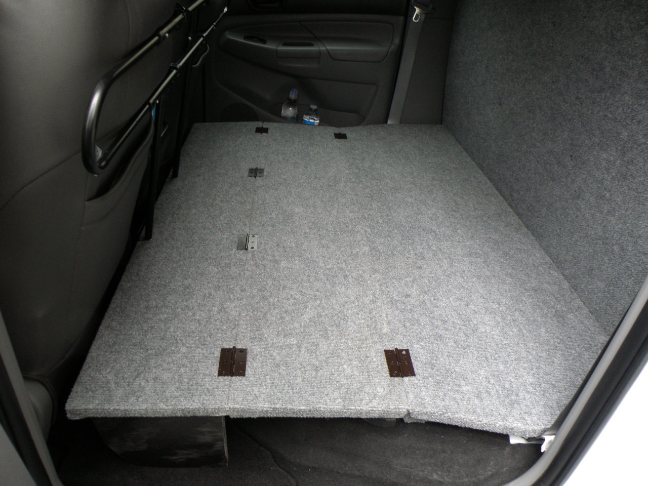

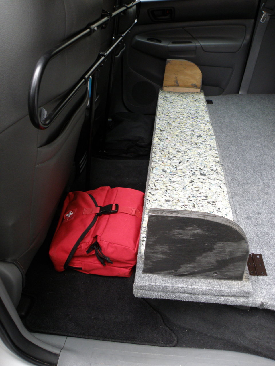

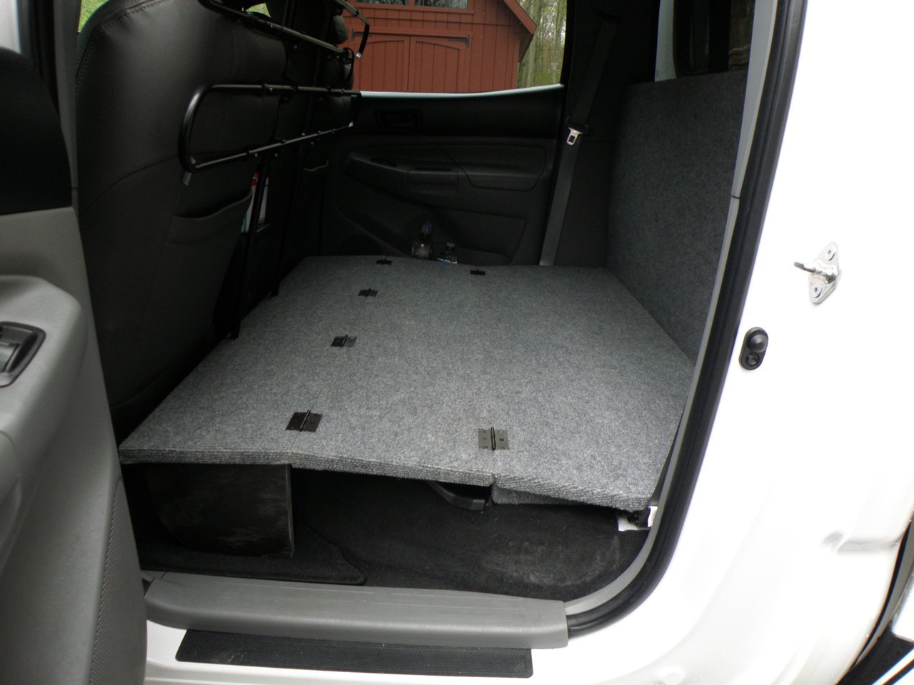

    Finished the deck today using 3/4 plywood. I decided to do a double hinged design so that I could access storage areas underneath. I ran short on hinges so off to the hardware store tomorrow. Let me know what you think. My thanks to Kasnerd for your suggestions on sound proofing, I can not believe how much quieter the cab is now.

    That looks great!

    That thing turned out mint. Great write up op! These guys would love that.
