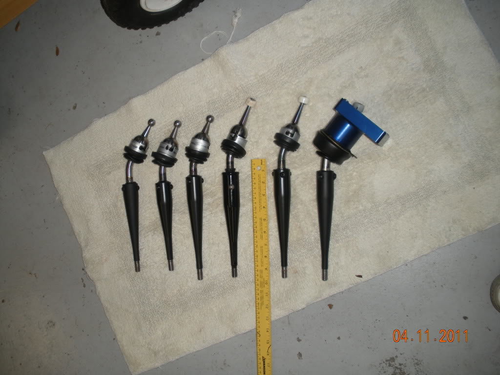

    Here is a pic of a few.
    From left to right.
    8 1/2", 8 1/2", 9 1/2", 9 1/2" TRD SS, 9 1/2" TRD SS, 9 1/2" B&M.

    Now what brand shift sticks are those, do you have a website? And are those compatible with urd SS kit ?

    Starting from the left.
    The first three (3) are stock shifters than have been cut down. These are compatiable with the URD SS.
    The next two (2) are TRD SS that have been cut down. They have a short shifter built in (notice the longer tip) and do no require the URD SS. And you can not bolt on the URD SS to make it a shorter throw.
    The last one is a blue base is a B&M shifter that has been cut down. It is not compatible with the URD SS.
