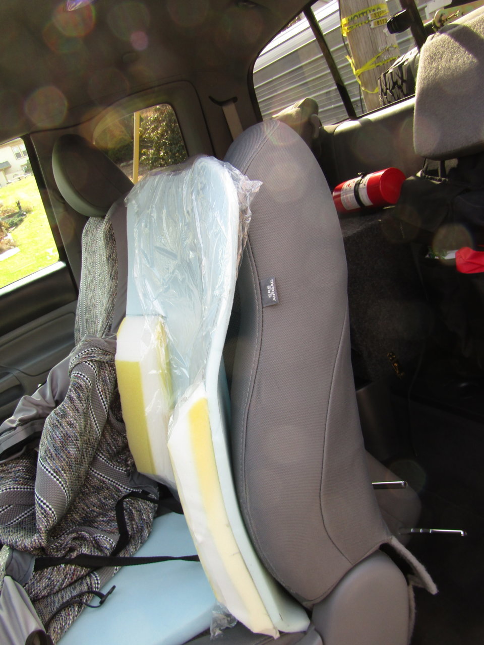

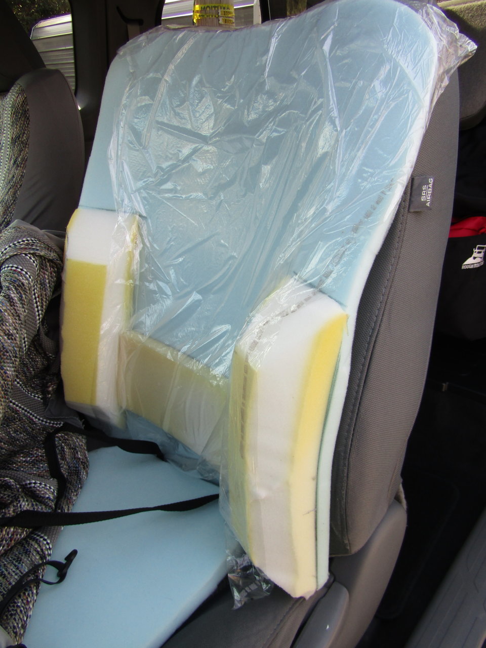

    Hate the seats in my 2015, cant find a comfortable position for any length of time....Yesterday went to the local upholstery shop, got some 1" extra dense foam and a 4" square of the same material...used the 1" stuff as a back, added the 4' up the sides about 18" long, trimmed them down with a knife , put a 1' strip midway up the back for a lumbar support....put a 1" piece on the seat and shaved the front down....put a piece of plastic wrap over the side that goes on my back, seat cover slides right over the whole thing and it stays in place....
    Hoary Crap, its almost as good as the seats in my vette were...
    next time the seat covers are off will snap a pic, unless there is any interest in seeing it now...without a doubt best thing I have done for comfort..really made a huge difference, actually cradles me in the seat. no side movement and lumbar is much better.....cheap 15$ worth of foam,

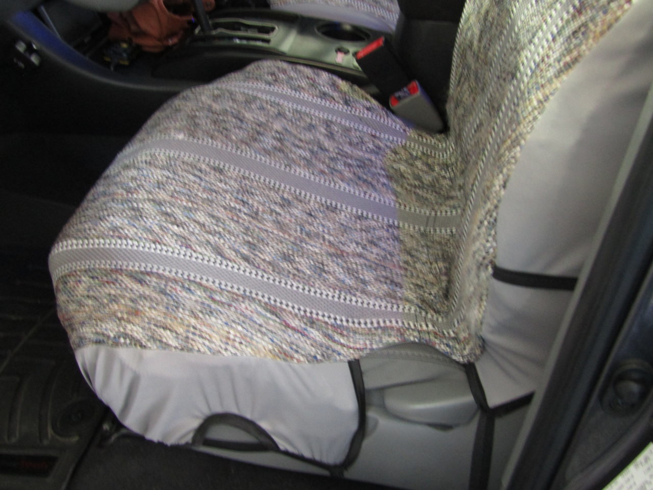

    nothing fancy but what an improvement for very little $.

    Oh SNAP! That's ingenious and with a good set of seat covers that have a little bit of oversize forgiveness to accommodate the extra foam, turns into a cockpit style seat. I'll be looking into this too.
