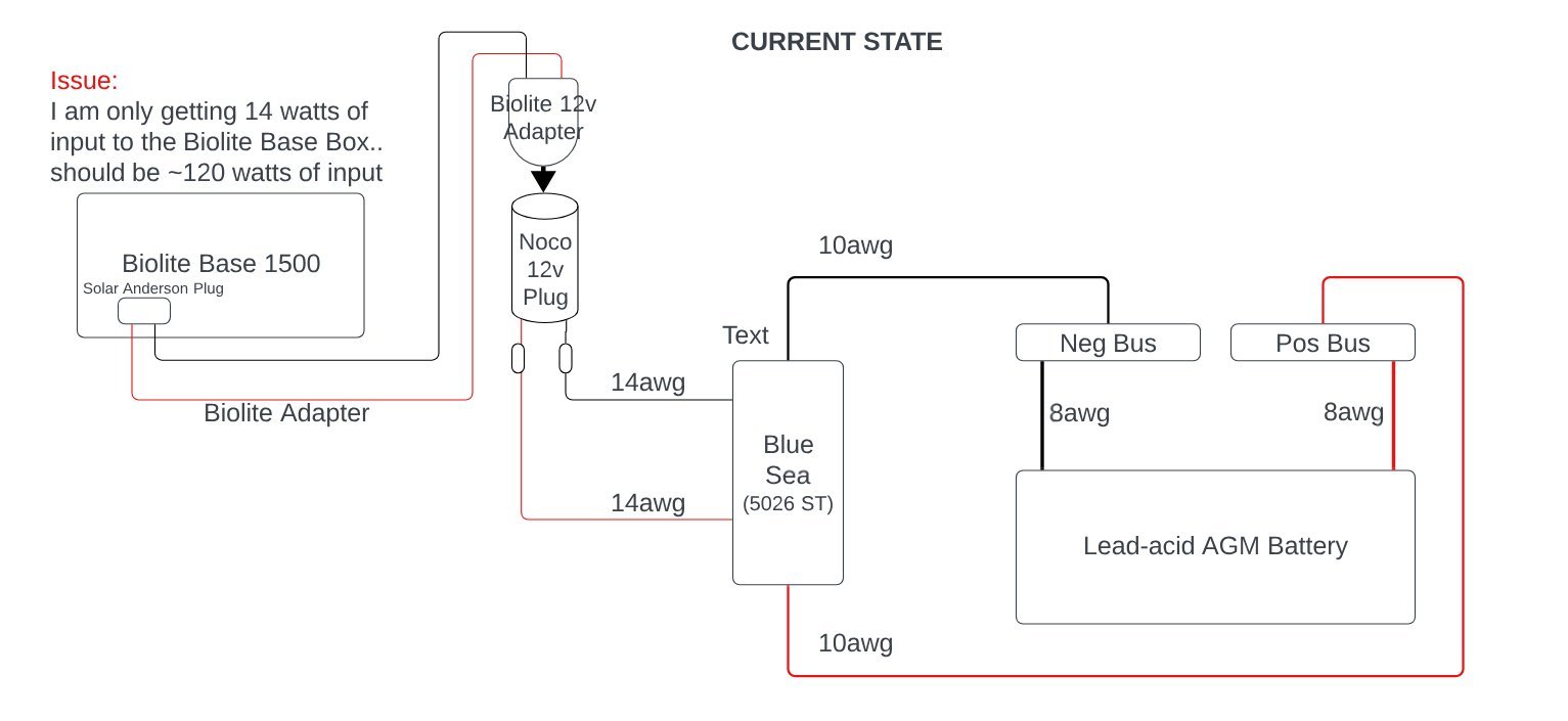

    Okay, post multi-meter voltage check update. i have checked the voltage at different parts of the system and below are the findings:
    Distribution block - 11.4v
    Blue sea fuse block - 11.4v
    Anderson plug on biolite 12v cig adapter - 11.4v
    at this point, i am even more confused. Looks like volts are passing through

  9. Jan 8, 2024 at 1:14 PM
    #29
    92se-r
    92se-r Well-Known Member
    Jan 5, 2017
    #206708
    262
    Is this with it plugged into the biolite and charging and drawing current?

    No, its without the biolite being plugged it.

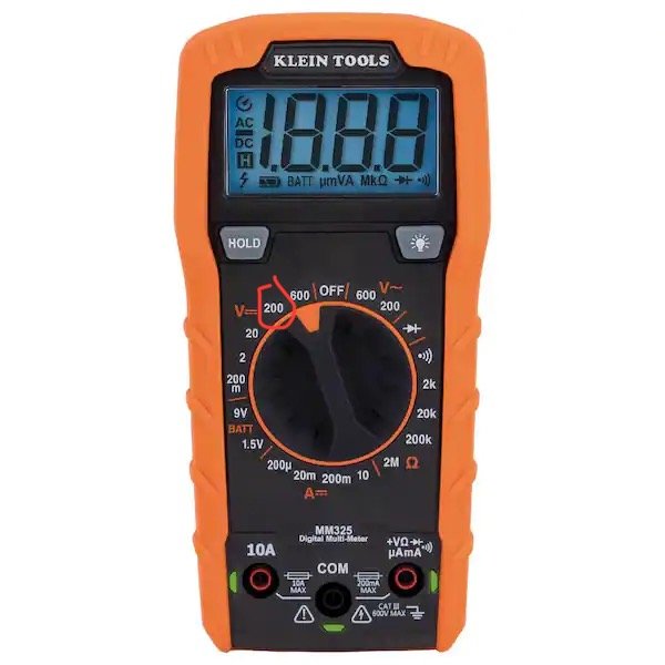

    Below is the setting i was using on the Klein MM325

    You will never read a voltage difference with no current flowing through. You need to be plugged in and reading voltage.

    Check when the engine is running. Alternator should be charging the system to 14v or more.
    You need to charge the system with a higher voltage otherwise it will do nothing.

    Is this lead acid an Aux Battery, or your truck's starting battery? 11.4 is a dead battery. Did you test at the battery by chance?

    I think my batteries aren’t being charged enough or properly by my vehicle 7 prong plug. Thus, they are depleting and thats why i see low voltage and wattage.
    I feel i need a DC/DC charger onboard my vehicle and ran to the trailer batteries. This will make charging from the vehicle (main charging source) more efficient and actually valid

    I didn't realize this was in a trailer.
    Have you thought of buying a voltage booster for your truck?
    I agree running a DC-DC on it's own circuit from Starting Battery to your trailer will be best.

    2nd Gen Tacos usually don't put out 14v unless you have a voltage booster or aftermarket alternator. Not sure I hit 14 even with my booster.
