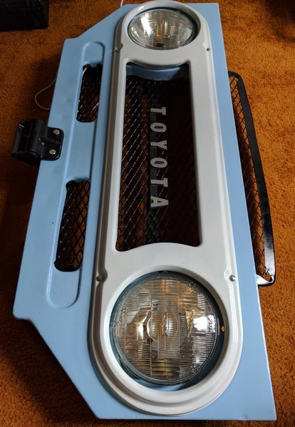

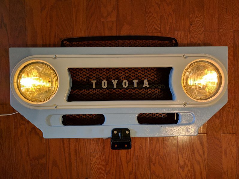

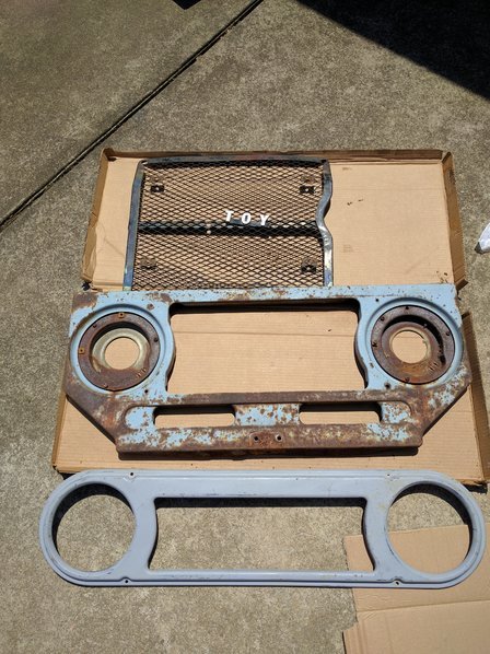

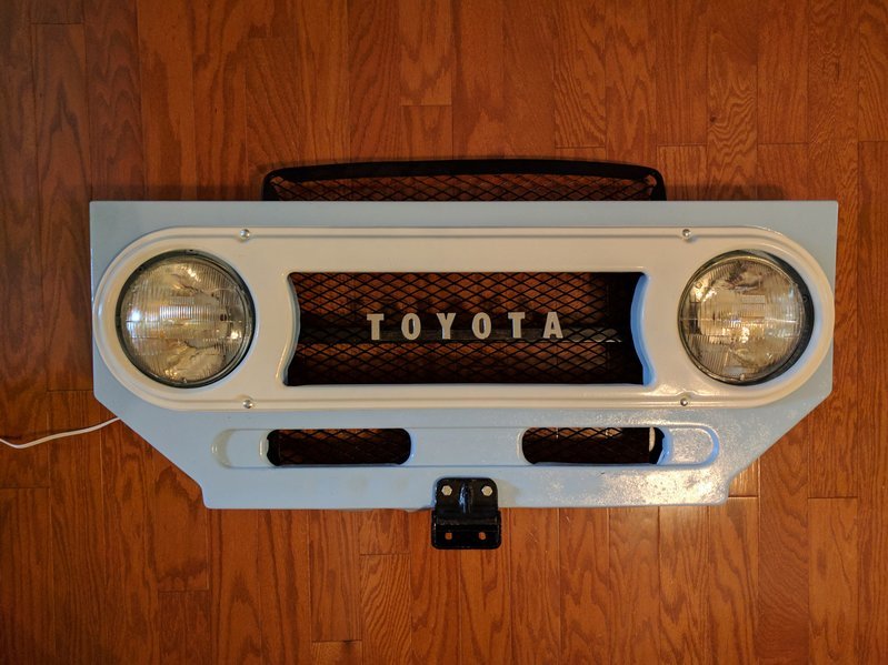

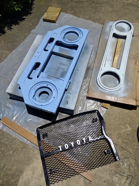

    So I began the idea of adding some Toyota stuff to the man cave that no one else has... I had the idea of an FJ 40 grill with dimable led lights. I began by sourcing OEM 1965 parts from eBay. They were in rough shape.
    Each part was individually purchased, and broken items like the Toyota emblem had to be found and replaced.

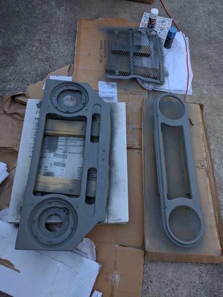

    Primed after sandblasting.
    Painted.
    Wired and completed.

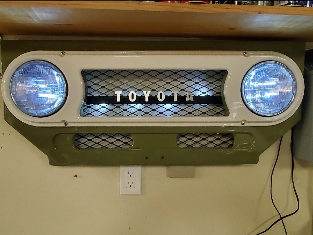

    I think it turned out better than expected. Lights are 110v LED Edison bulbs that are dimable.

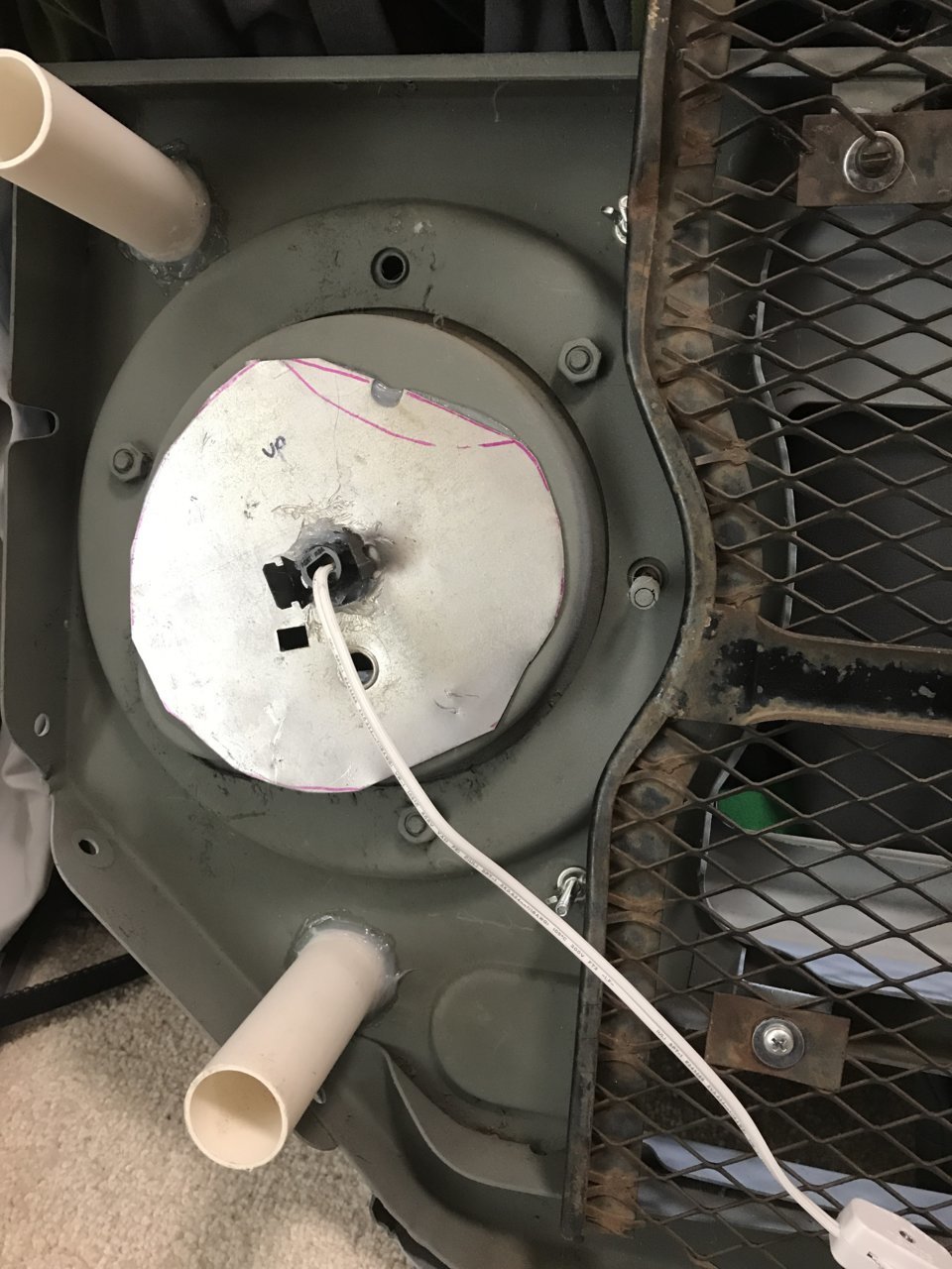

    I took an angle grinder to the back of them, cut a hole in the rear. Got some sheet metal and drilled it for the sockets, and glued them in. Wired in a dimmer so I could dim the led Edison bulbs almost all the way down.

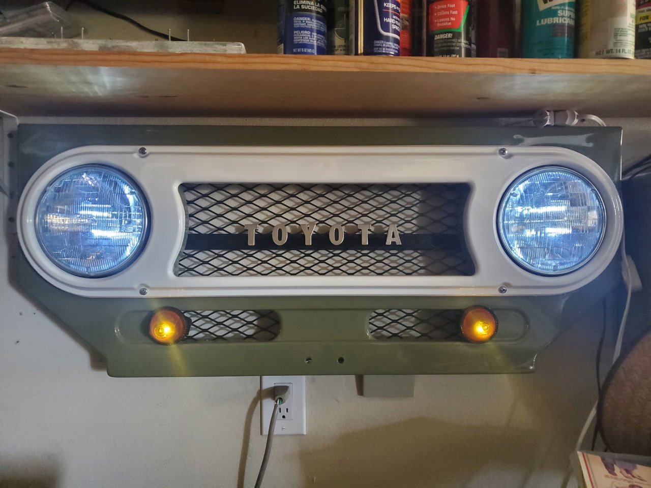

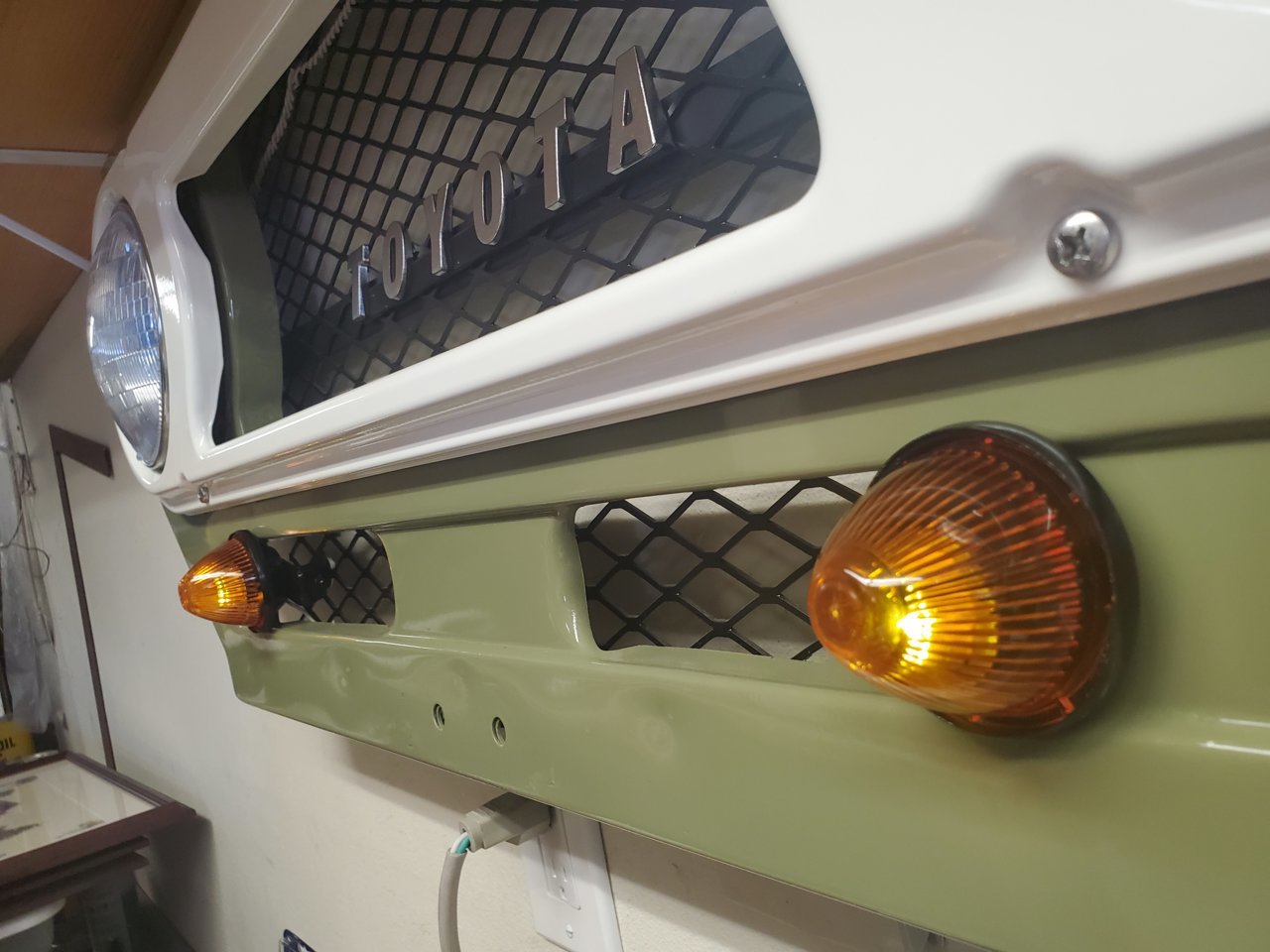

    Screenshot_20201219-153759_Gallery.jpg 20201220_112023.jpg Screenshot_20201219-153759_Gallery.jpg 16084934144935705356246147469770.jpg Not trying to hijack, but figured this is a good thread to add to.
    Finished about a year ago. My buddy painted the grill in Light Olive 6L4. A color only used in 1983 I believe. Then had bezel powder coated (an unknown) white. I rigged up a section of expanded steel with a strip of scrap wood and painted both flat black. Then installed a 69-74 toyota grill emblem.
    I then very carefully drilled 4 holes in each headlight with cheapo diamond hole saw bits off Amazon and epoxied LED xmas lights in each that are wired to come on with the garage door light.
    Getting bored and needing waste more valuable time on frivolous things I just recently added Peterson Beehive 110-15 lights and wired two of the same xmas lights into them. I mounted these to the back expanded steel, so I didn't drill into the grill.

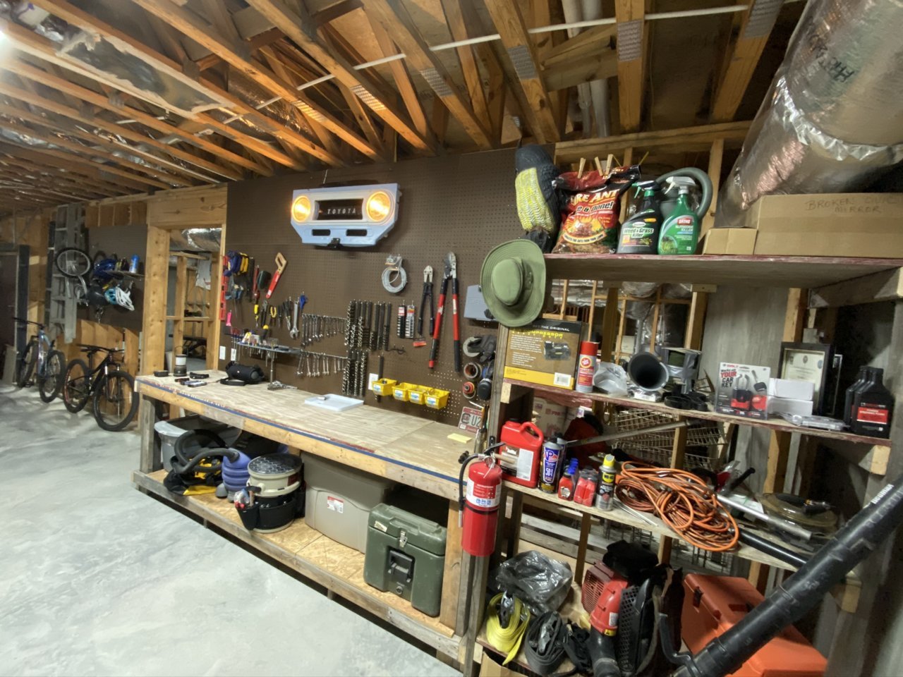

  19. Dec 20, 2020 at 12:17 PM
    #19
    AzogSS
    AzogSS [OP] Well-Known Member
    Aug 26, 2009
    #21829
    3,104
    Andy
    Soda City, SC
    2008 Tacoma / 2011 FJC
    Final resting spot, basement man cave/garage.
