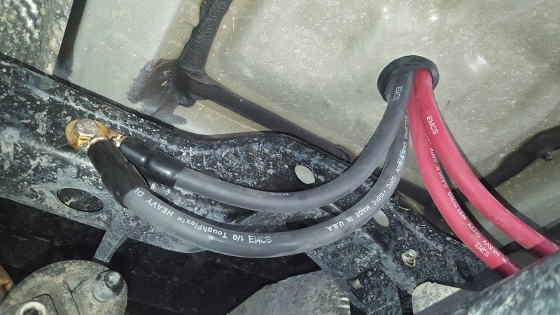

    20170614_173007.jpg love this grommet. And the ground point is already built in and threaded the same size as under hood. M8. Just need some silicone to fill the gap. All the excess length i will use for big 3 if i have enough.

    And need to ziptie the power down some more.

    :eek: Im jelly! I need to do that to my setup. I think i could drill a 1/2" hole and shove my ground through there to get to my frame. The problem is that i think my ground cable is only 1.5" long...

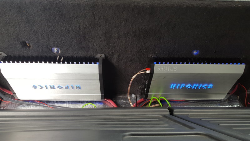

    Hmm, perhaps rework the setup or deal with a longer ground lol. Im currently having trpuble decideding what to do about my amps. Its cramped back there the way i have the amp rack mounted.. im trying to avoid drilling a hole in the body. Think ill try and utilize the seat belt bolts and make a new amp rack setup. And possibly double mount the amps 2 deep using threaded shafts and multiple nuts on them. To "stack" them. I bought 2 4 inch 12v fans made by attwood to cool them. So ill have to wire them up too. And have even more switches. Lol.

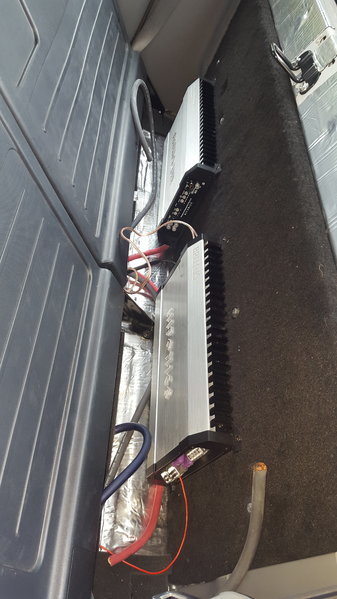

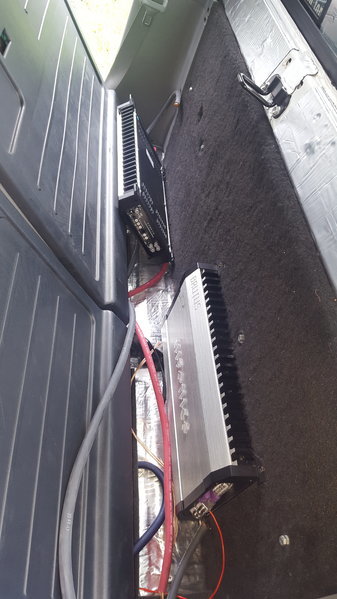

    20170616_144227.jpg looks like the second amp will sit upside down .. its okay no one see it any way lol. Shit will be symetrical doe.

    Never strapped amps before.. have to rewire the subs to series paralell. For 4k at 2 ohms
