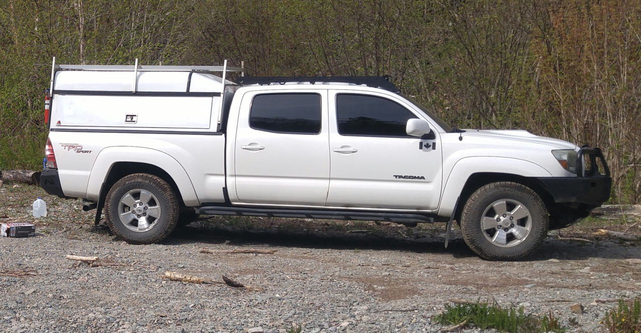

    Got this shot today, can't stop staring... She's so purdy
    What it is now vs what it was before

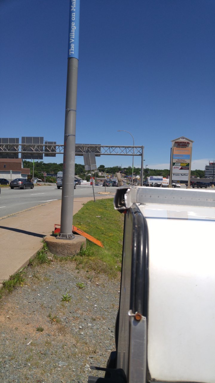

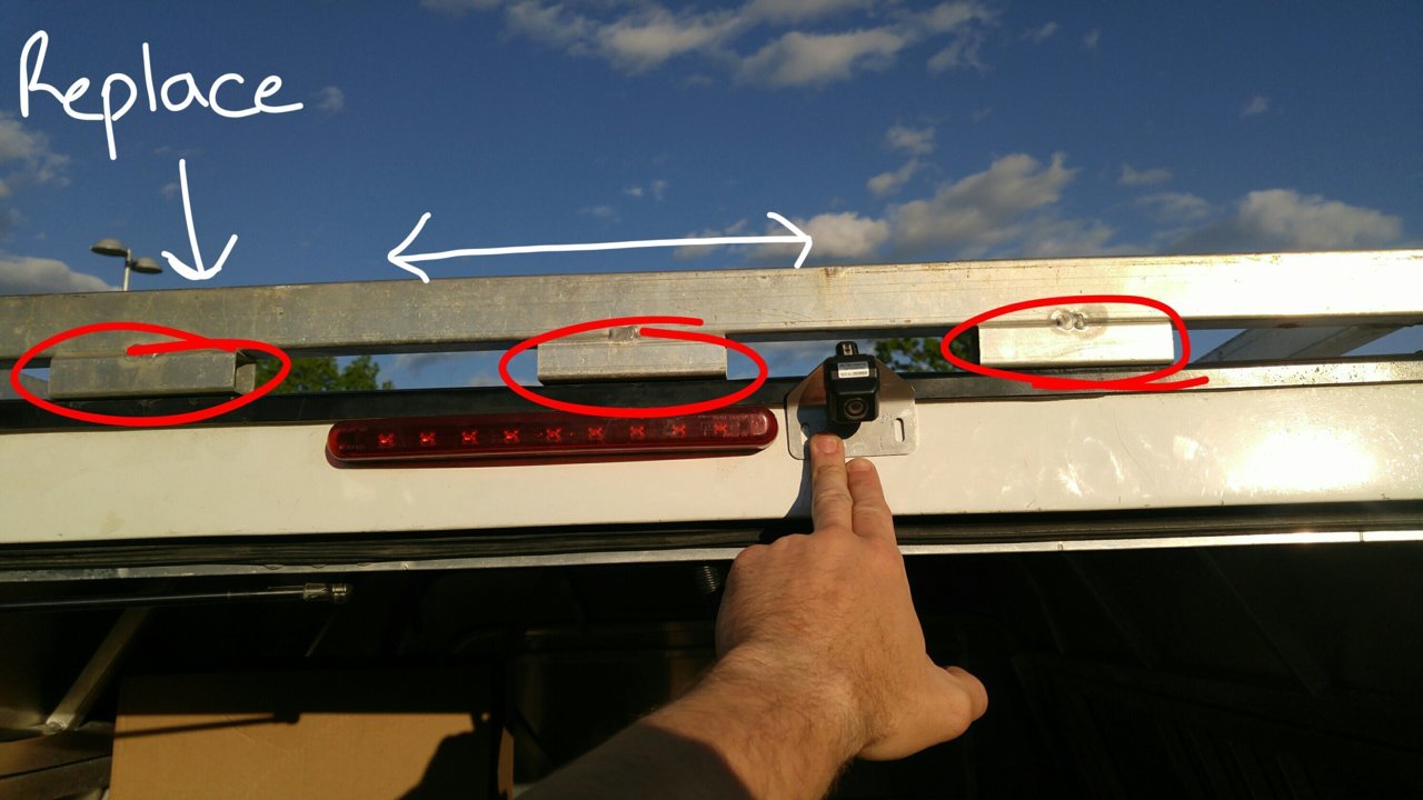

    Too much lift...happened in parking garage in Halifax Nova Scotia.

    When we installed the lift we had about 1 3/4" leaving his garage so I thought I would be fine. Took it slow enough that I didn't damage the cap I just have to really replace that last cross member and straighten out the vertical members.
    Might take the time to lower the whole thing to the roof instead of sitting on these little "bump stops". Will that fuck with my chi?

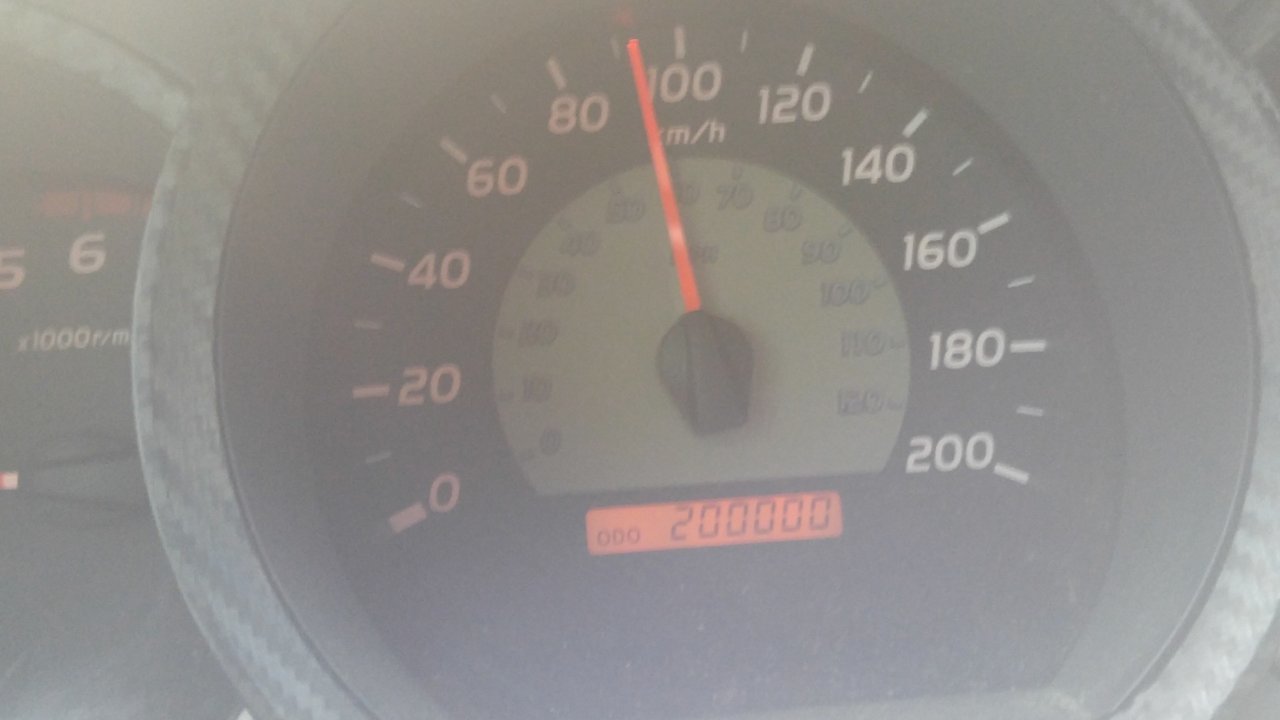

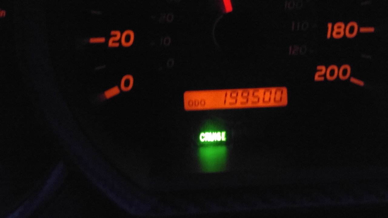

    White rhino hit another milestone today 20180708_193409.jpg 20180708_193426.jpg
    They grow up so fast

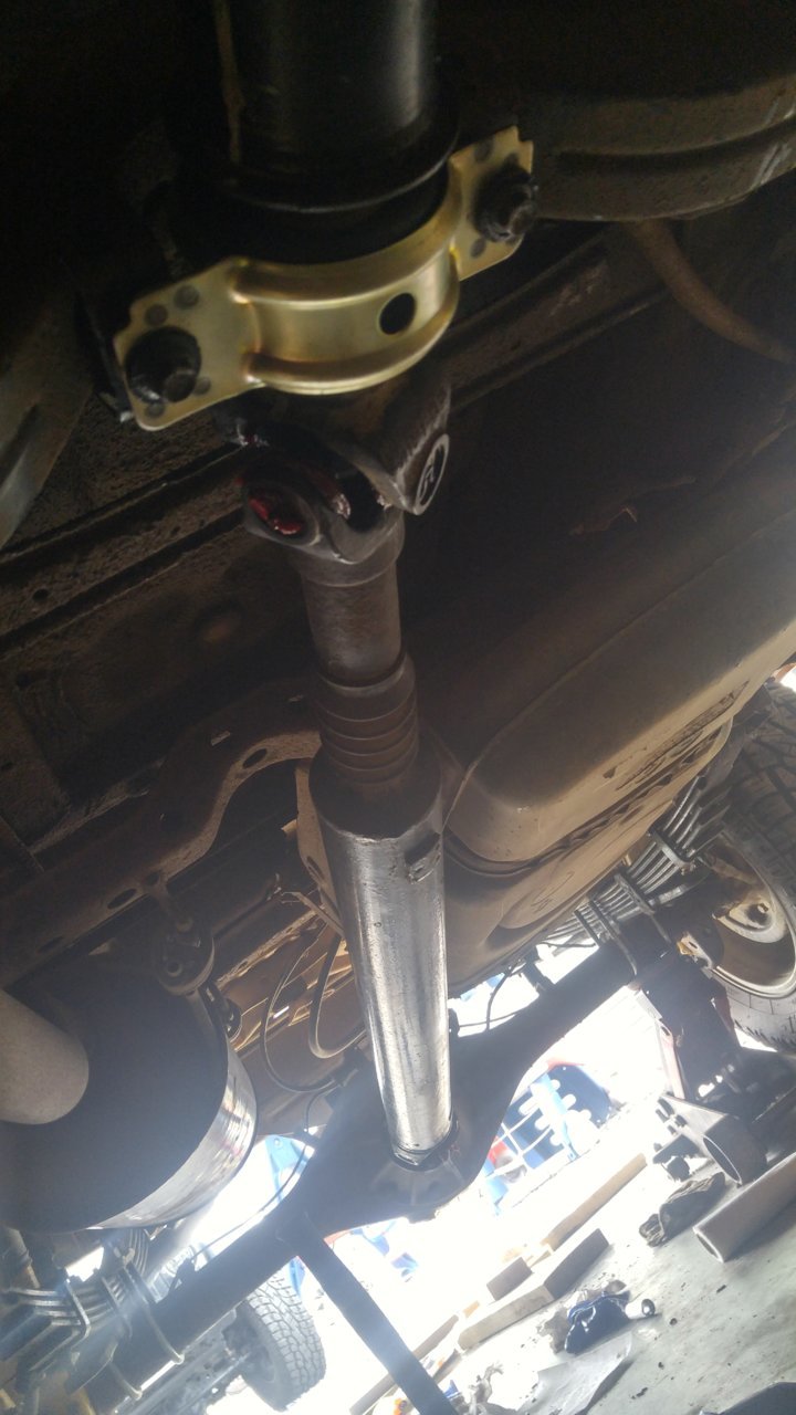

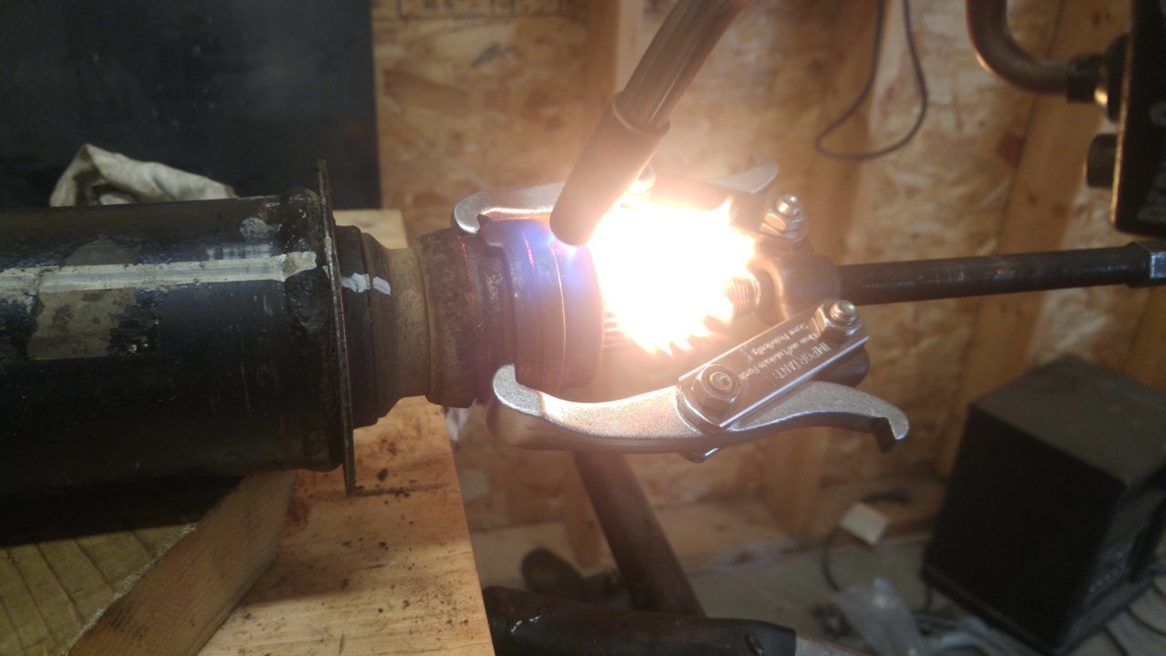

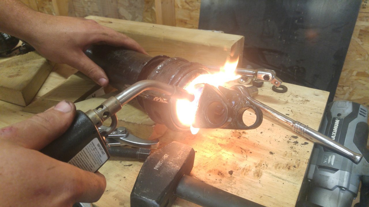

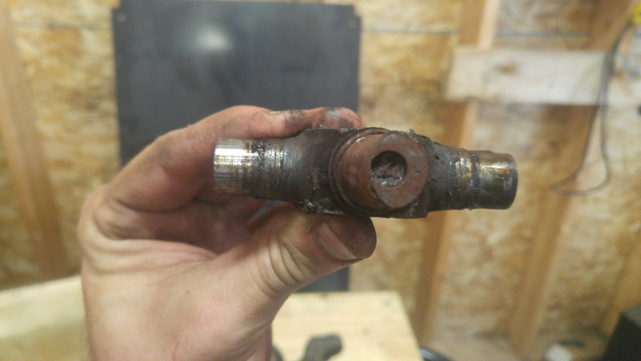

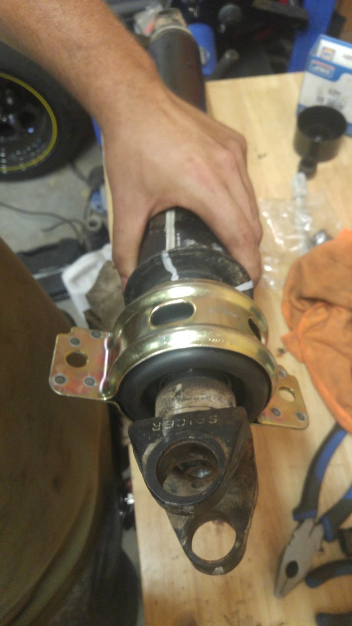

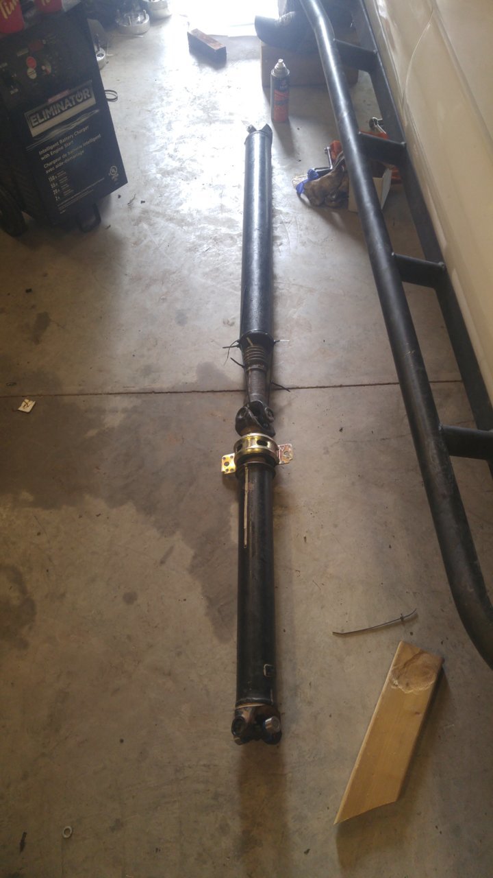

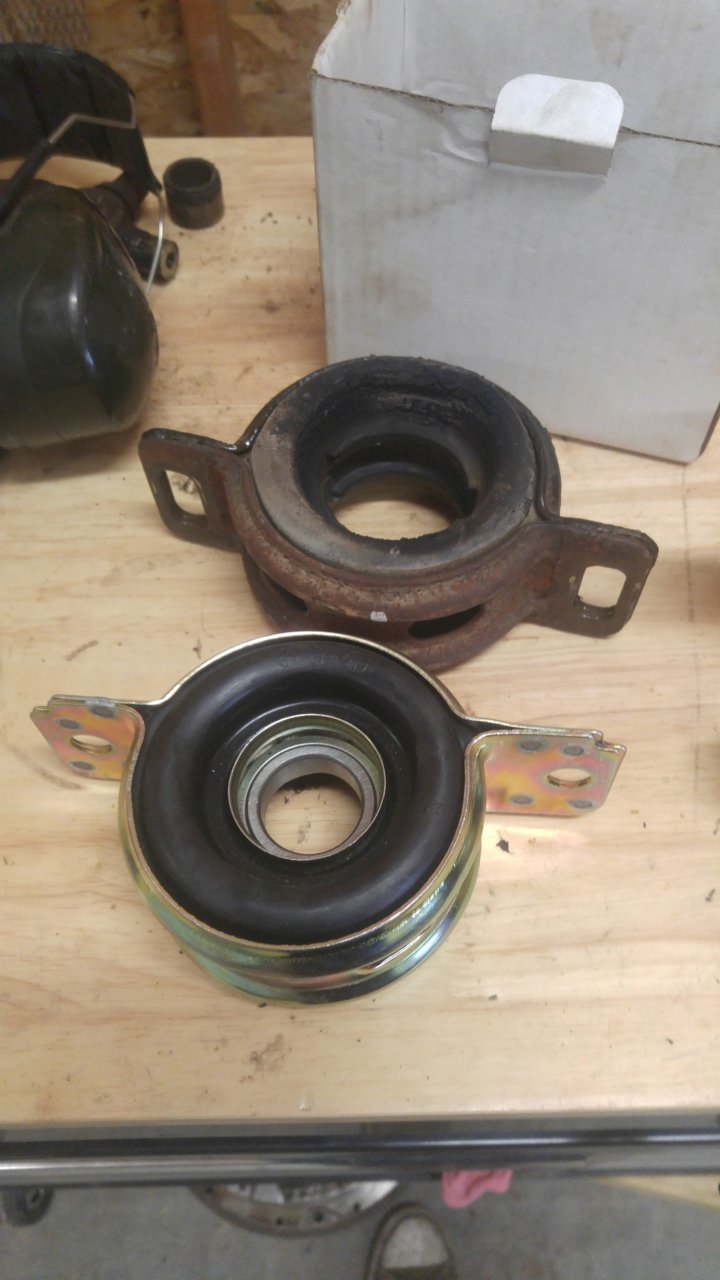

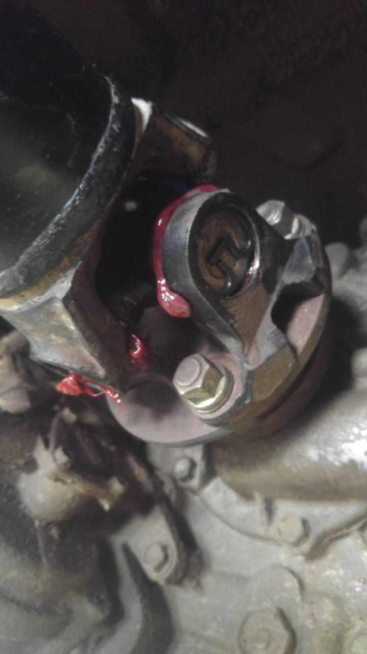

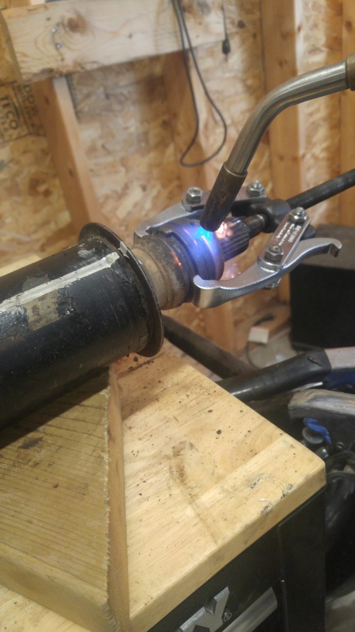

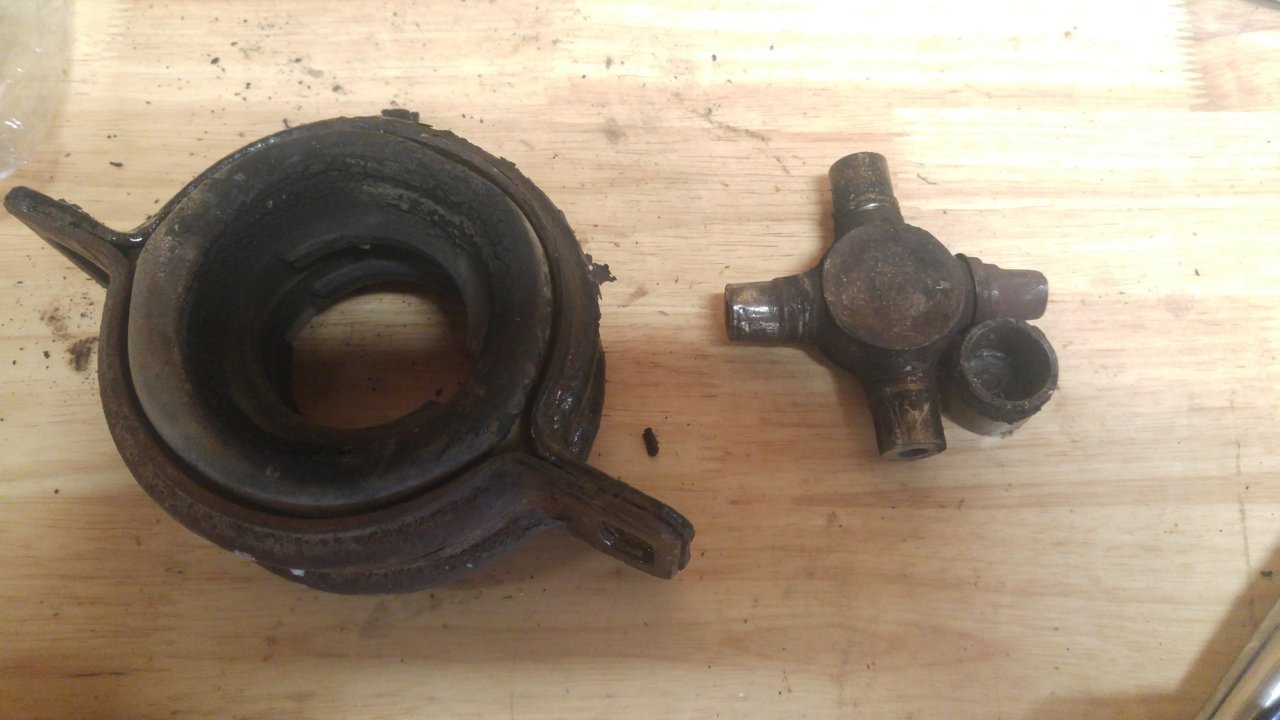

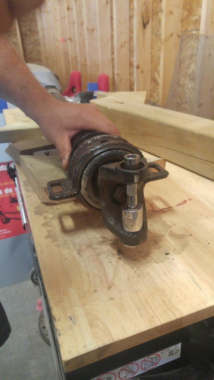

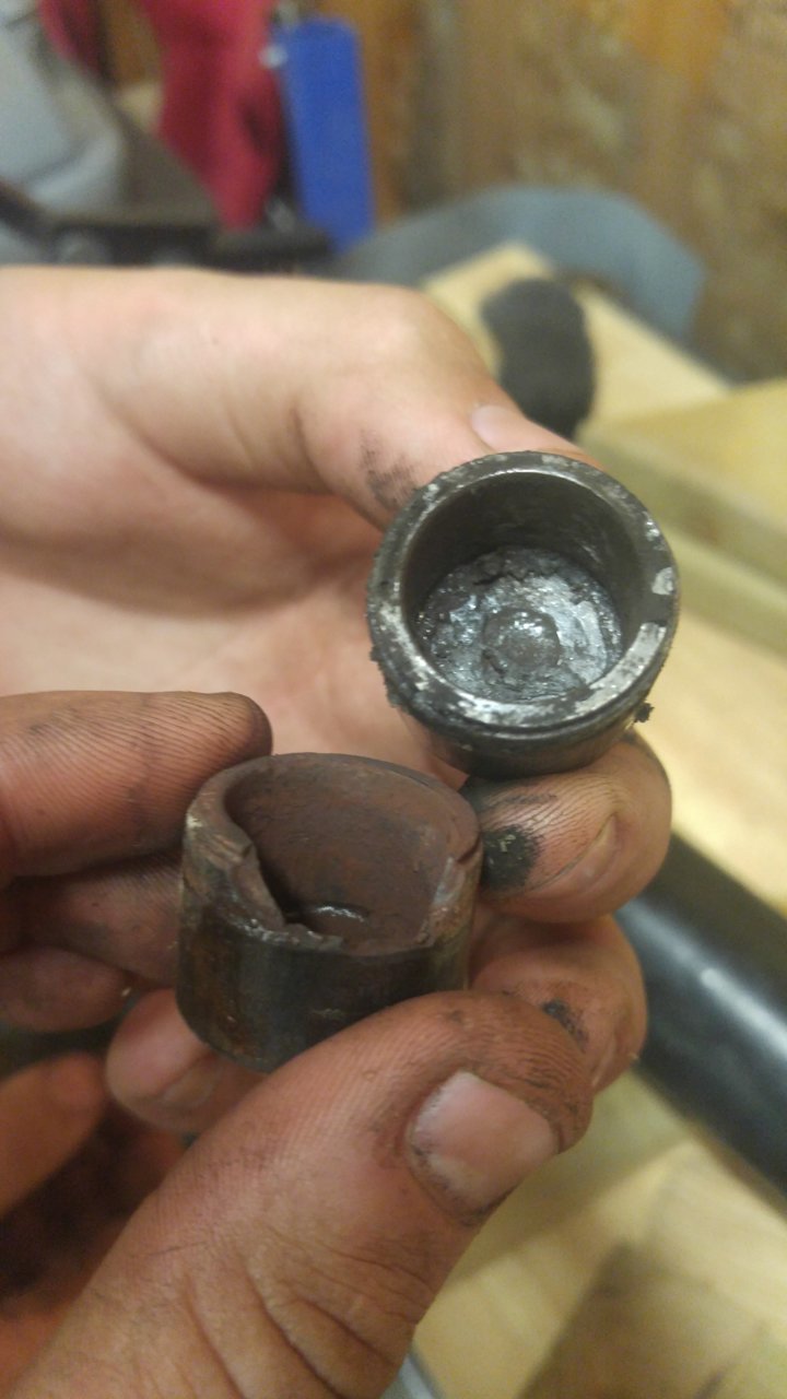

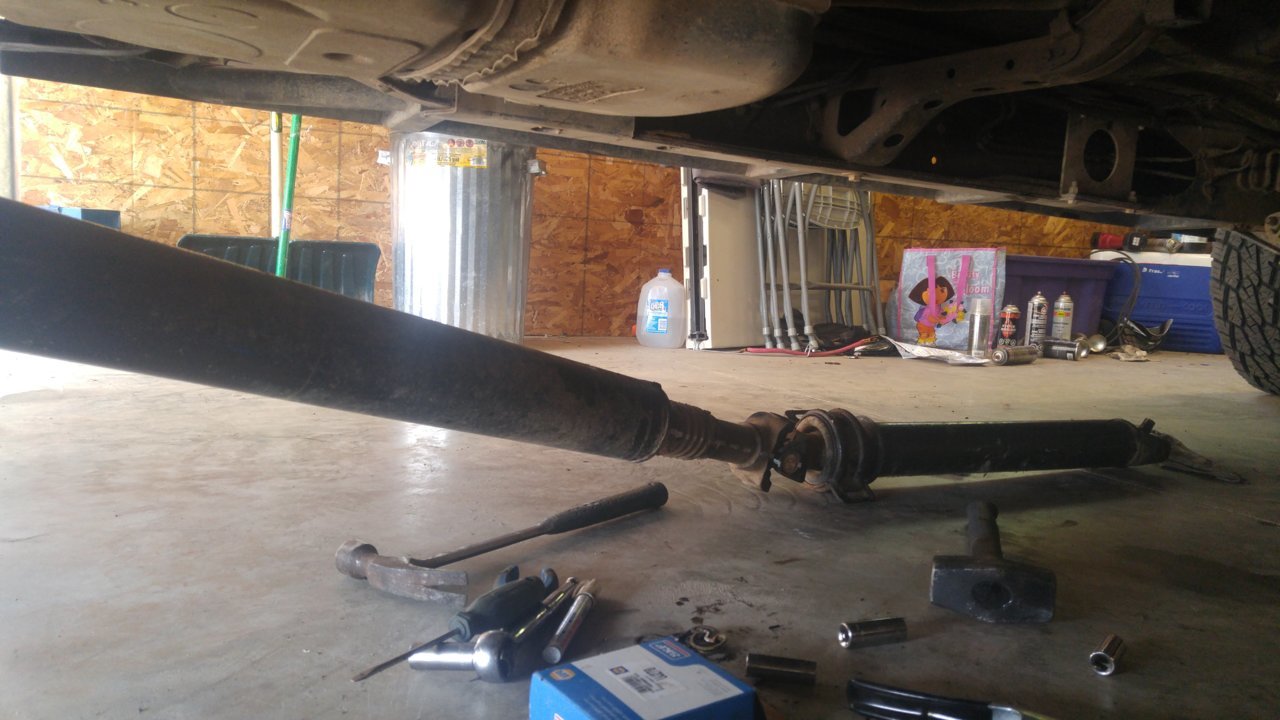

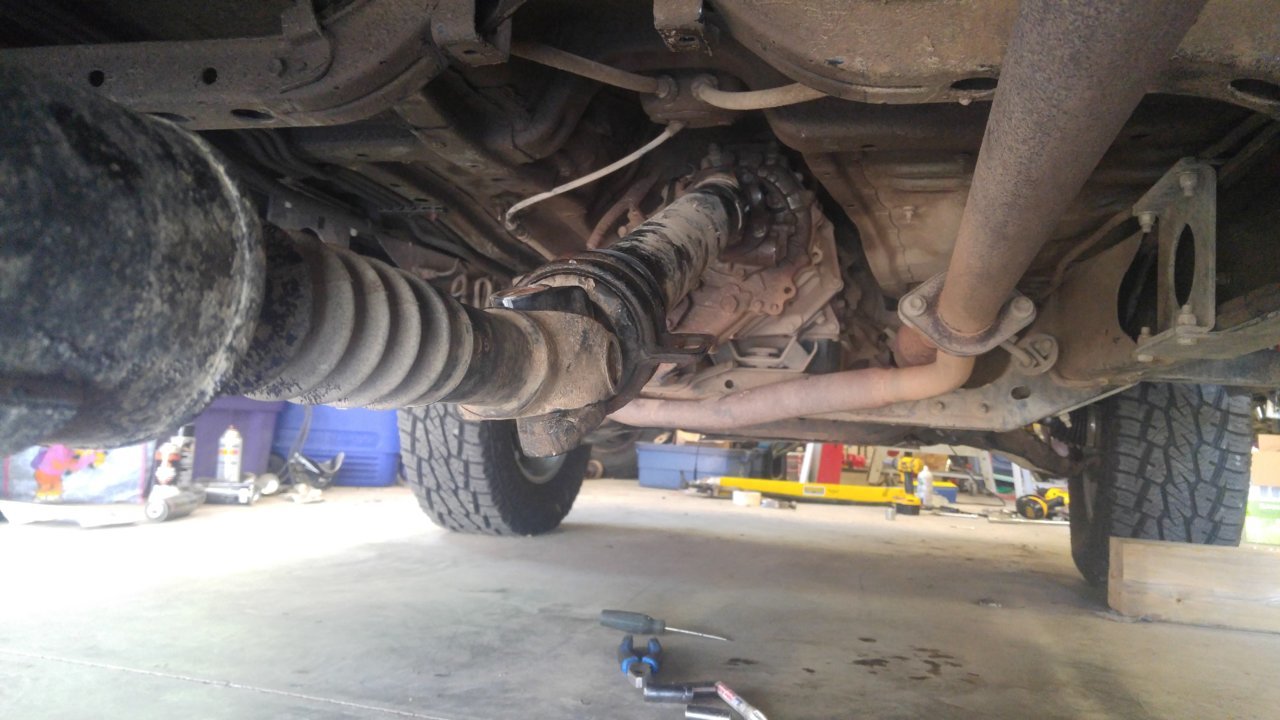

    Dropped in three SKF U270 U-Joints and a Western Star centre bearing Saturday.
    Centre bearing has been squealing for a month and thought I might as well replace the u joints while I'm at it. Went to the HD ones because "buy once, cry once"
    20180714_104436.jpg 20180714_112019.jpg 20180714_120519.jpg 20180714_121141.jpg 20180714_121349.jpg

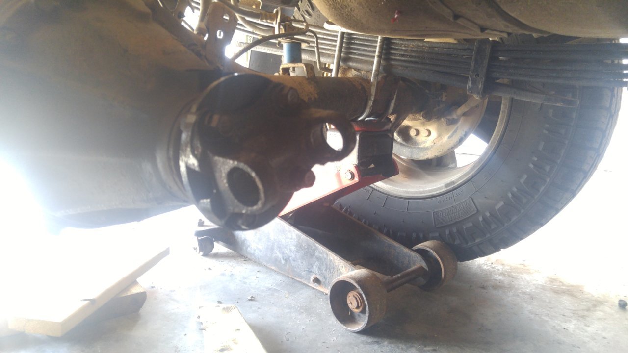

    Grease your u joints every 5000 km (when you do your oil changes) this one only has about a 1/8" of play and you will save your u joints from this

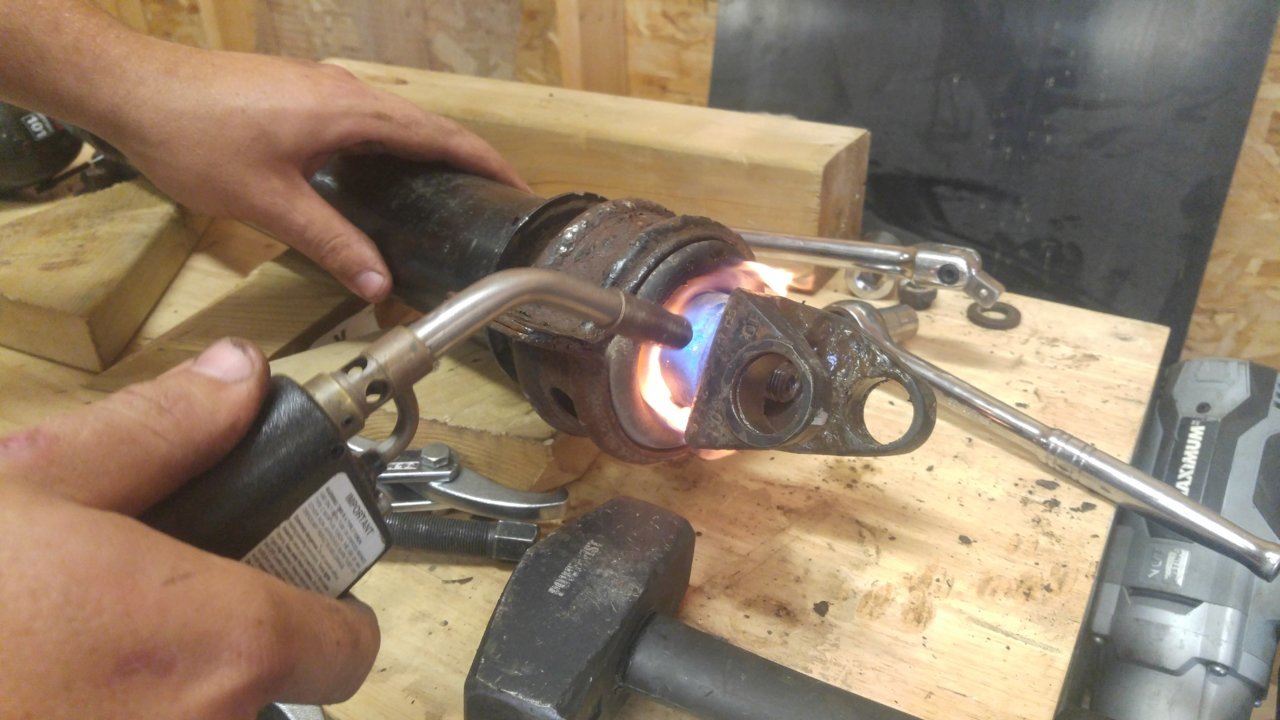

    20180714_125222.jpg FIRE
    Old 's New. The flange needed a few washers to keep it from the top but working well
    Ready to go in
    Done and done, probably too me 8 hours to do this all.
    The end was prolonged by the rear axle U Joint when they have me a cap with broken needle bearings. Swapped out two of them for the older needle bearings and packed it. 3 times the bearing slipped out of line during install which had my friend and I swearing... a lot
    Glad to be done.
