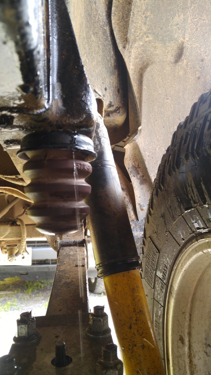

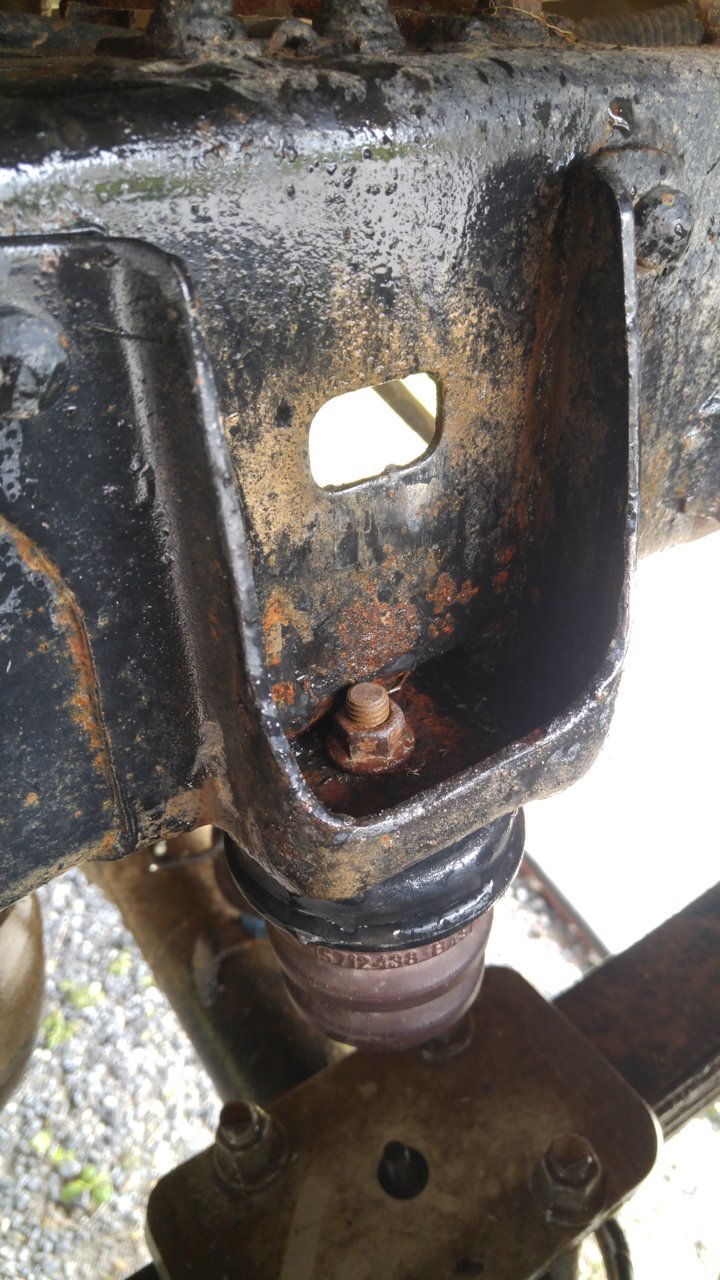

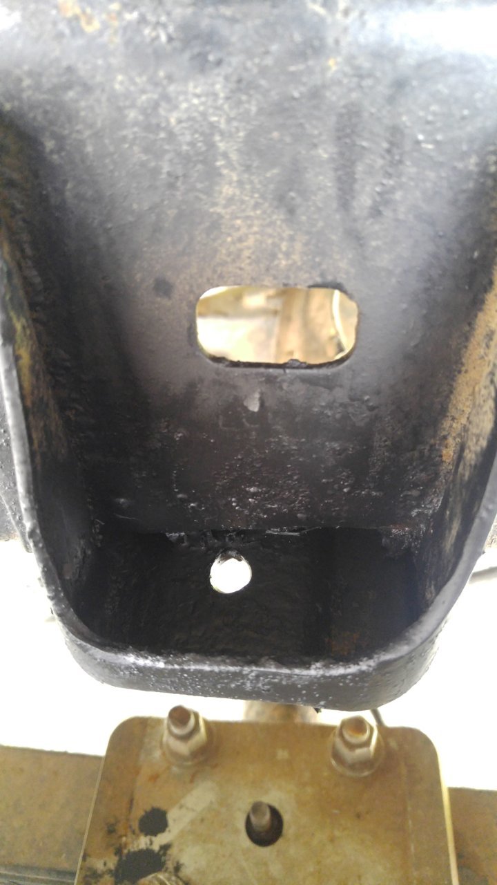

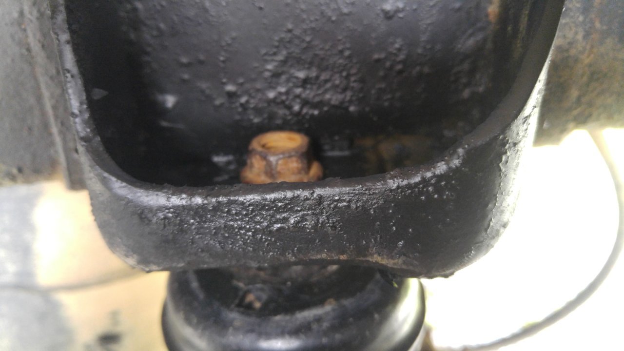

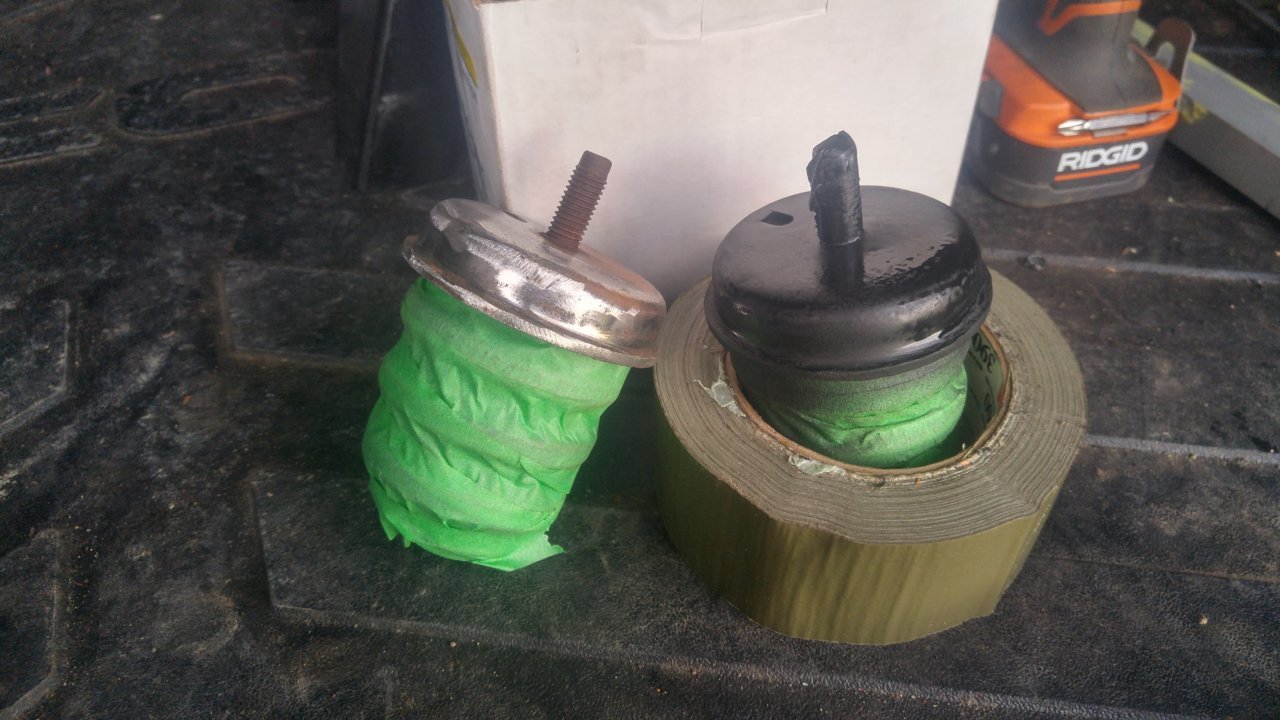

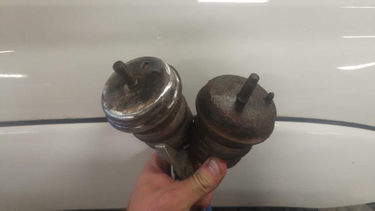

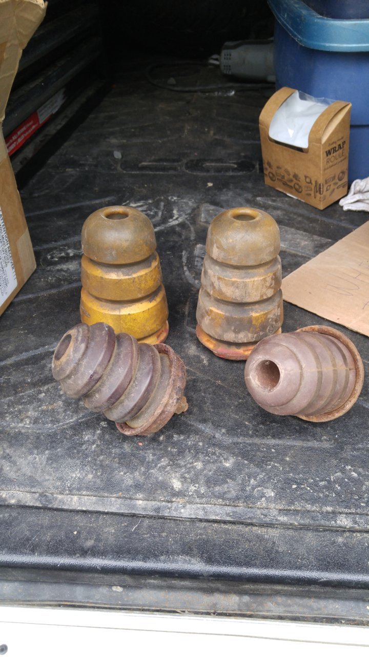

    Normally about $80+ brand new I picked them up from a local junk yard off a couple different GMCs for the price of four Med black coffees from timmies. Needed some work though
    Part number: 15712438
    Before and after some prep work. Grinded off the little nubbin.
    Just needed a 3/4" drill, some black spray paint, blue lock-tite and fluid film to seal it all off.
    An idea for bump stops brought to you @tacoma16

    An idea I got from here.....https://www.tacomaworld.com/threads/fox-2-0-deavers-1-5-aal-and-gm-bump-stops.289215/
    dont want any copyright issues :anonymous:
    glad they are working out!
    Manfred[QUOTED][OP] likes this.

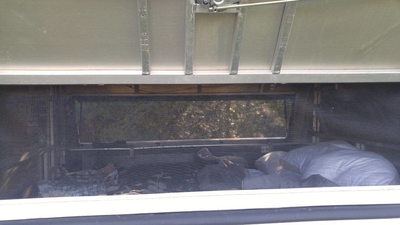

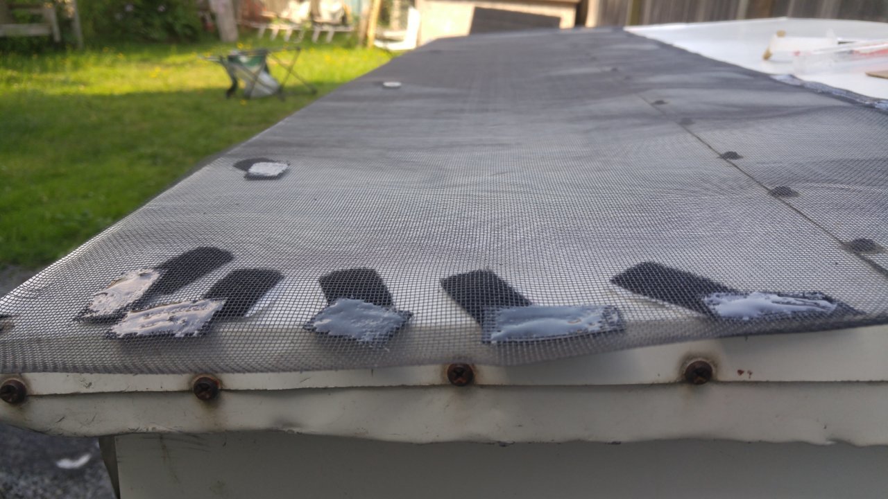

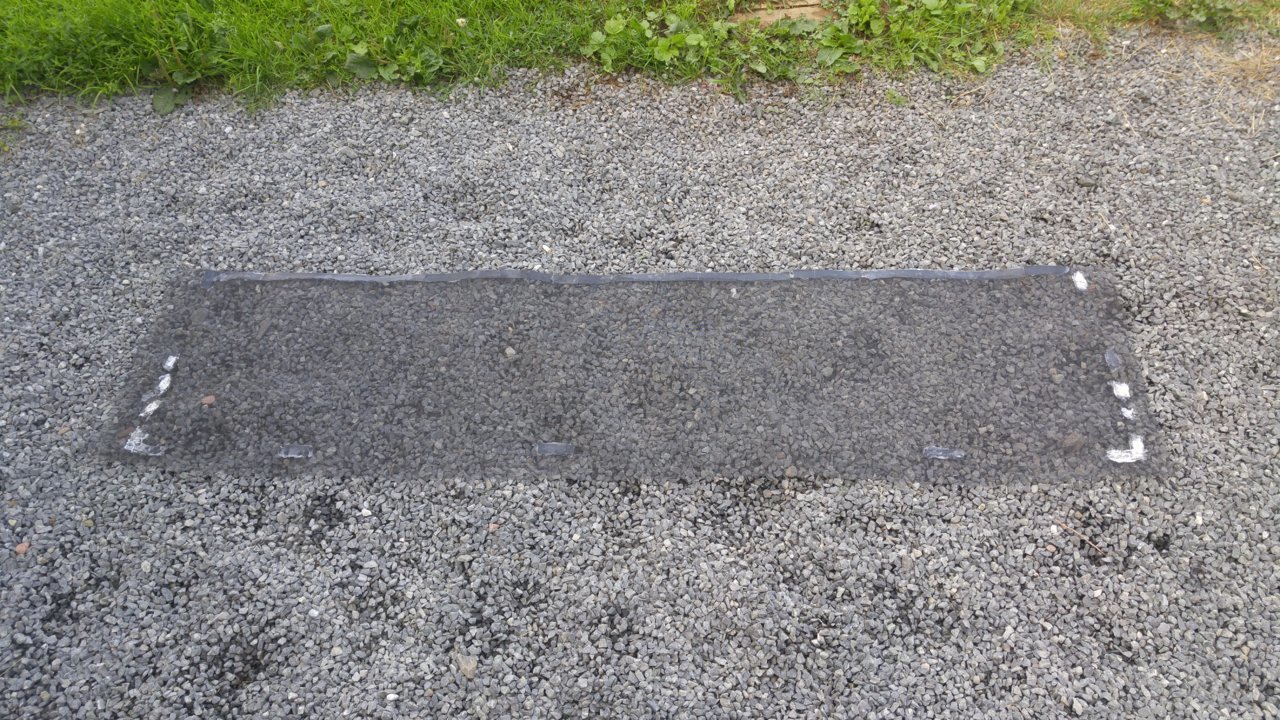

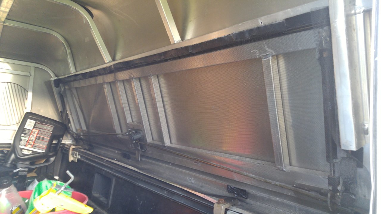

    With the windows in the camper always being open, I needed a solution.
    Something that be removed
    Something that was inexpensive
    Something that was sturdy
    20180804_184626.jpg Everbilt - 36" x 84" cut in half to make two 18" x 84" sheets
    20180804_184641.jpg 20180804_185611.jpg 20180806_094618.jpg 20180806_094623.jpg 20180806_094631.jpg Velcro pressed on, backing reinforced with some JB weld.
    Finished product. The resulting test is this coming weekend. All in all probably cost me 45-50 bucks

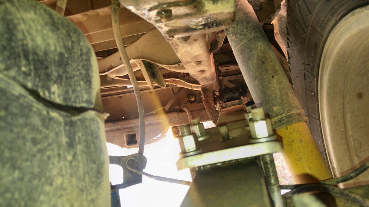

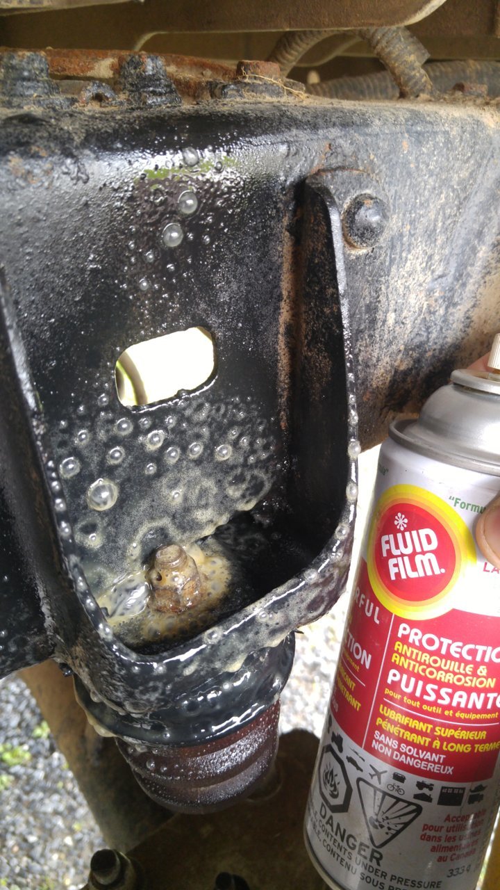

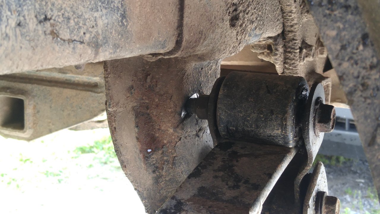

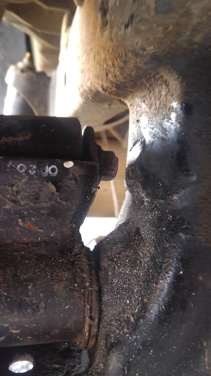

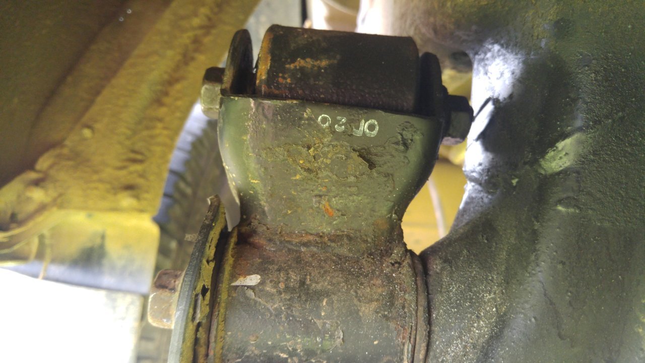

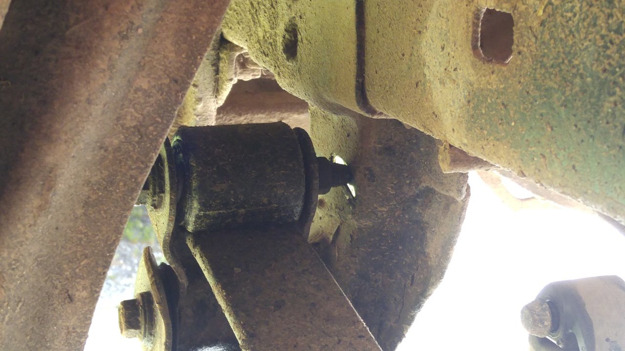

    Fixed a rubbing issue with my hangers. Lobbed the ends off of bolts. Still don't know if it was a good approach to the problem but solved it.received_10156917733522697.jpg

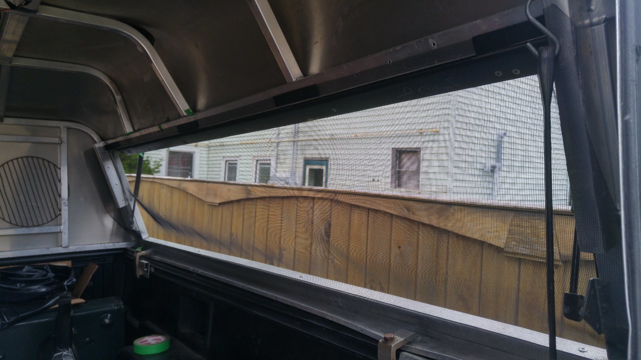

    Camping trip testing the screened windows. Worked super well.

    :bananadead: Should've just turned the bolts so they were facing the other way! You had them backwards which is what caused the rubbing.
    Manfred[QUOTED][OP] and Nimble9 like this.

    I haven't had much time for anything truck related door was a quick fix. Worst case scenario I can buy new bolts...shouldn't be too much of an issue eh?
    EDIT: I doubt I had it on the wrong way. I looked under the truck and there's no way I could have slid them through the other way. I think my issue was my stock leafs had a pair of rubber bushings that filled the void. It made it so that the nut on the back didn't have as much thread to go through before tightening commenced.
    EatSleepTacos[QUOTED] likes this.

    No I wouldn’t think it’d be much of an issue! So long as it doesn’t unscrew itself lol

    I edited my original post lol. But I followed the torque specs so I should be good to go there. No lock-tite used I'll let the rust take care of that haha
