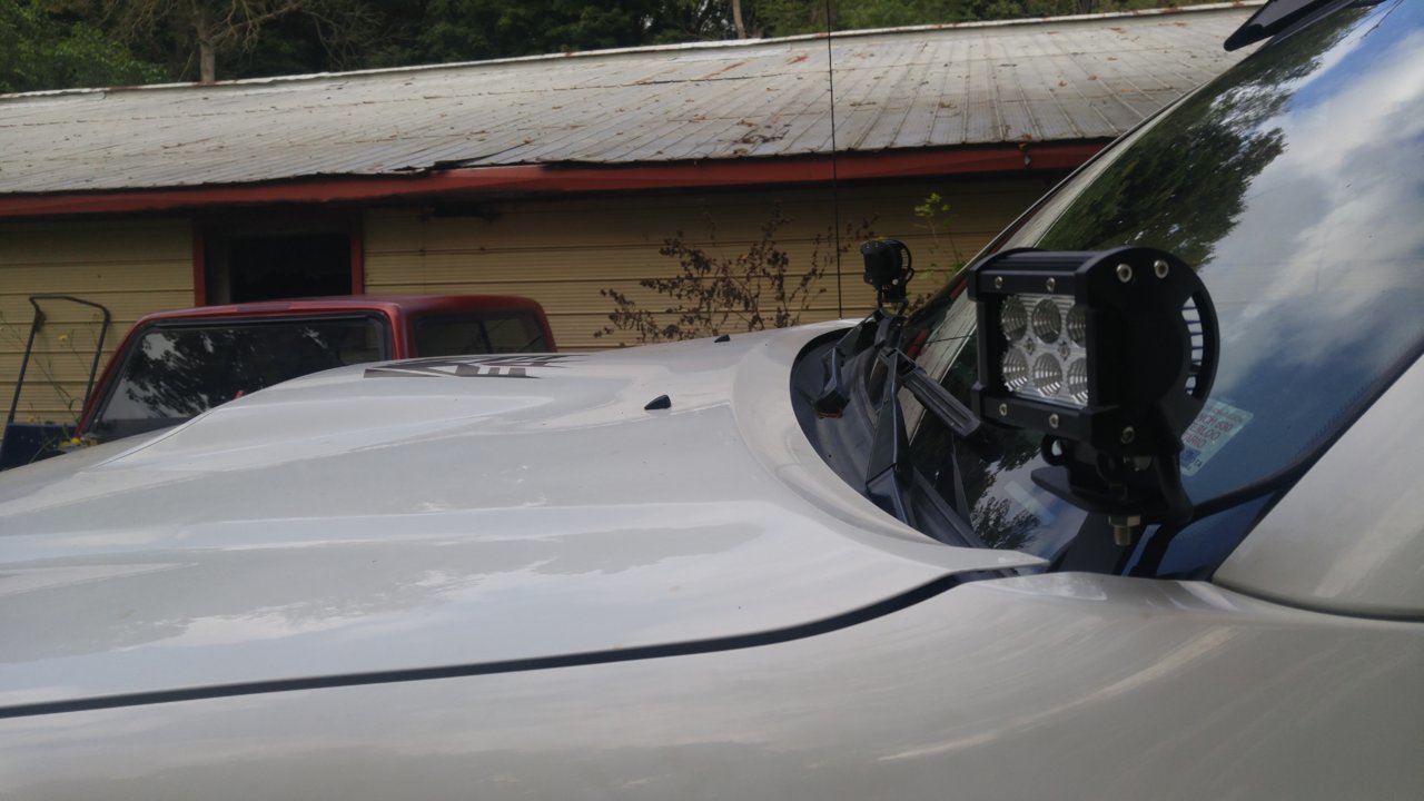

    I run these exact lights. You cant match the light output for the money. Make sure you seal all the way around, including the screws to seal them properly.
    :fingerscrossed:
    haven't had any moisture in them yet.

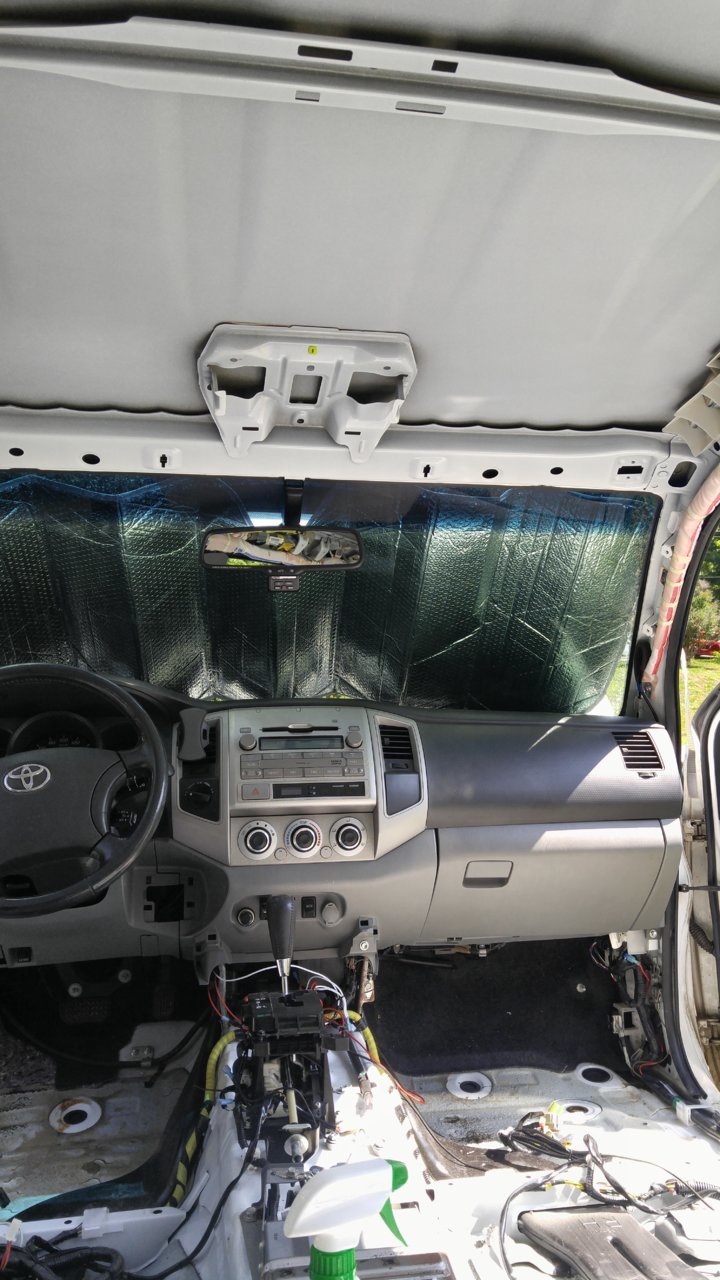

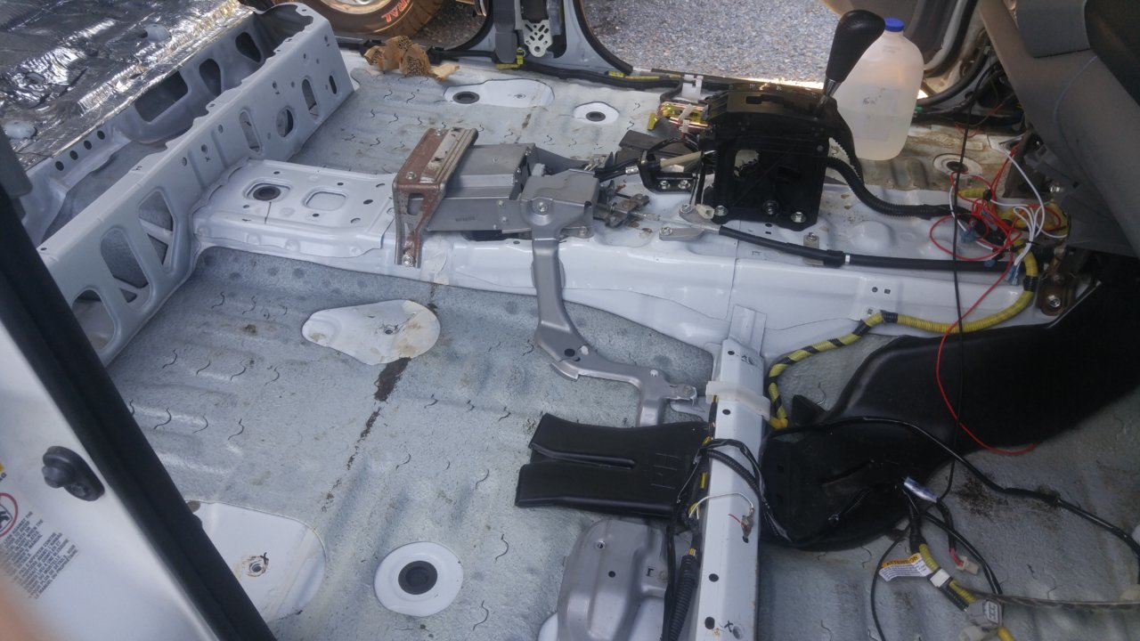

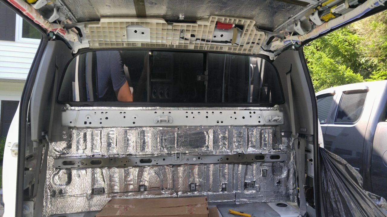

    OP Silence

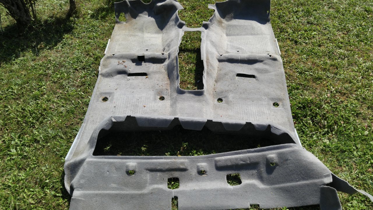

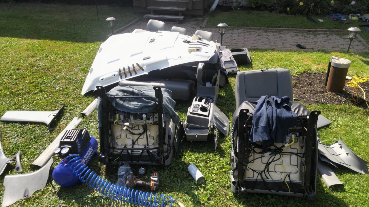

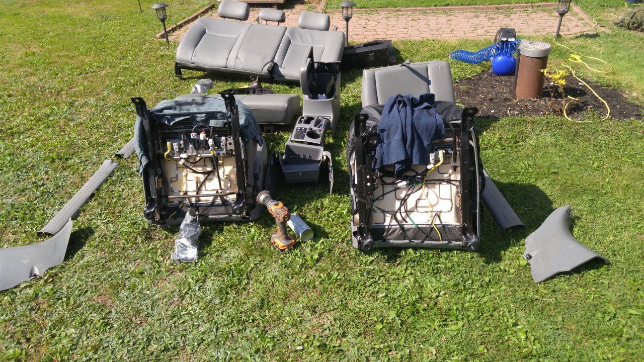

    Day 1

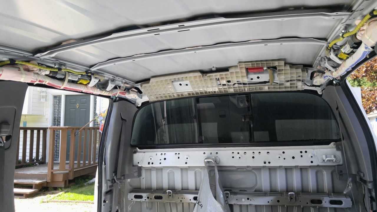

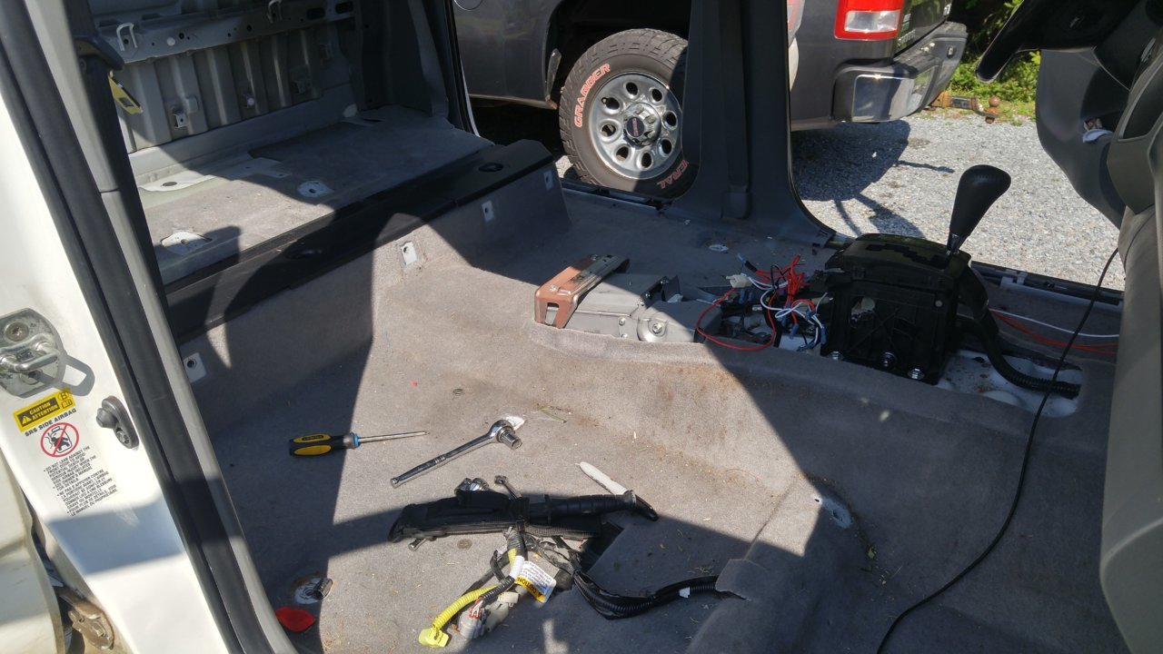

    20180829_101720.jpg 20180829_111859_HDR.jpg 20180829_111918.jpg 20180829_111930.jpg

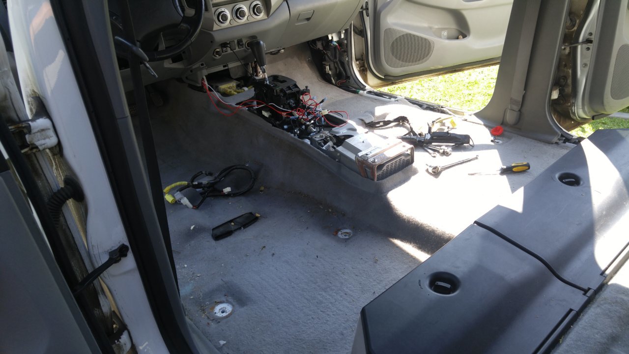

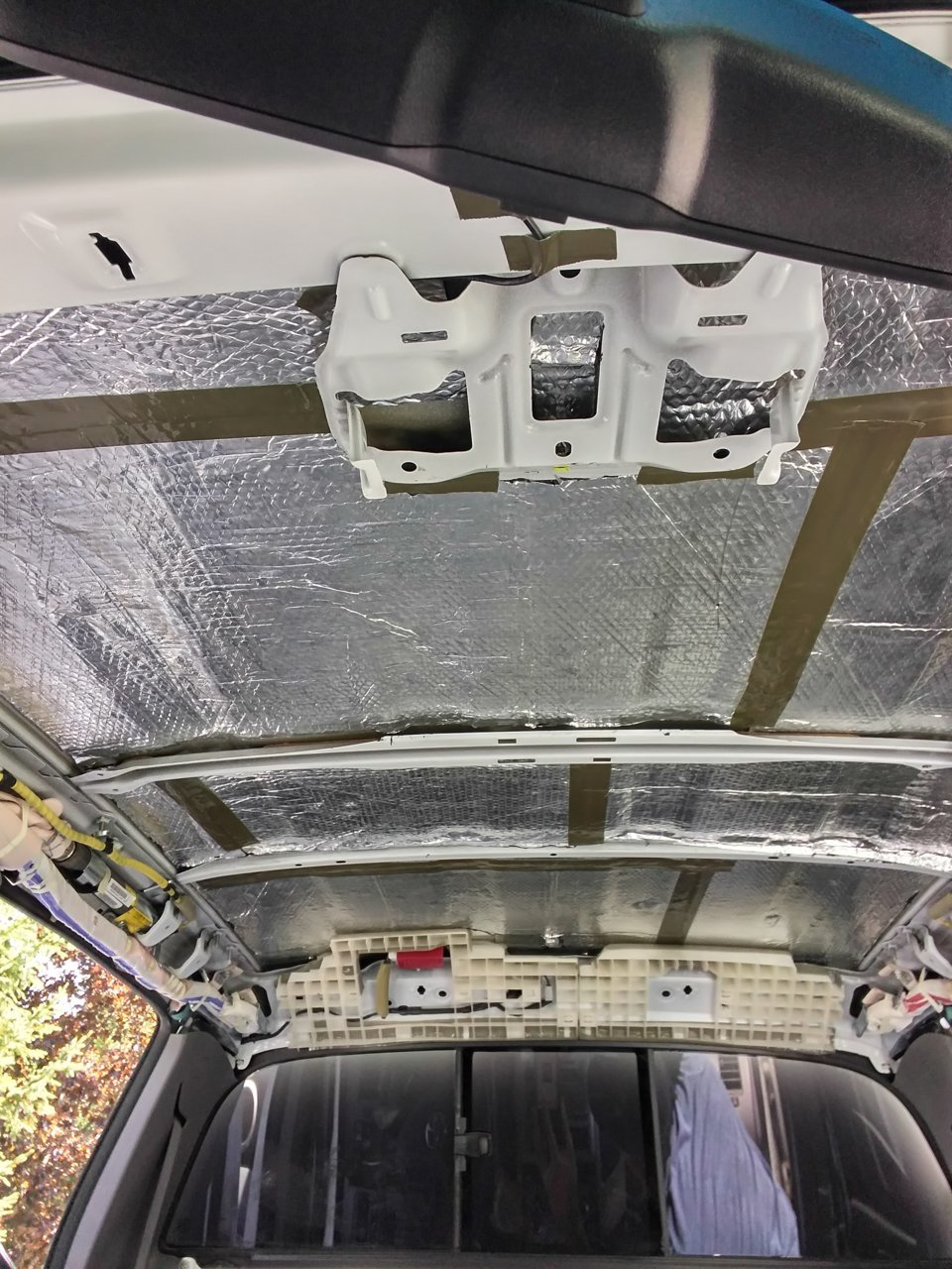

    Hoses her down. Drying all day and still going to let it dry down more tomorrow to avoid mildew smell20180829_114119.jpg 20180829_125925.jpg 20180829_125943.jpg

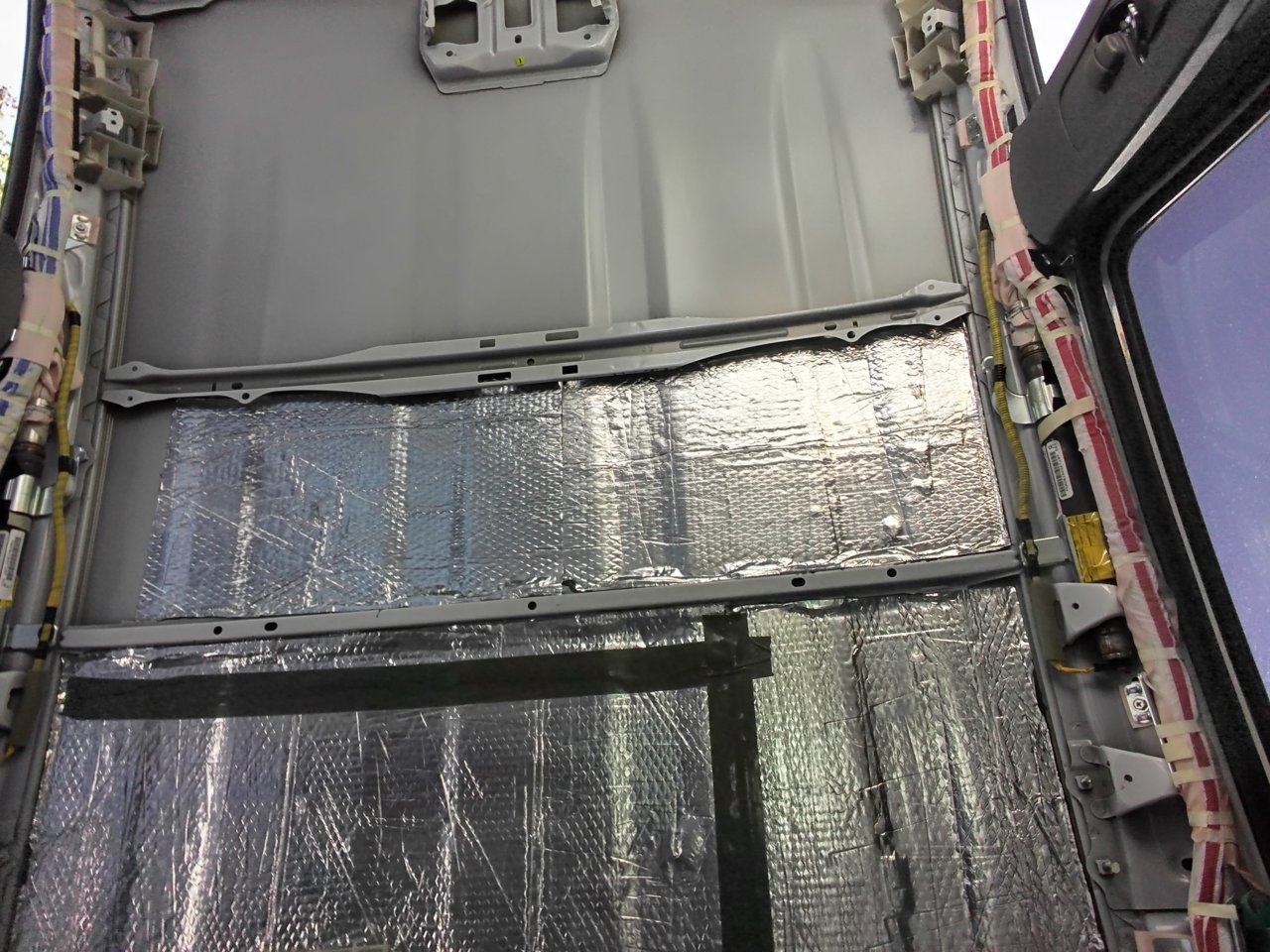

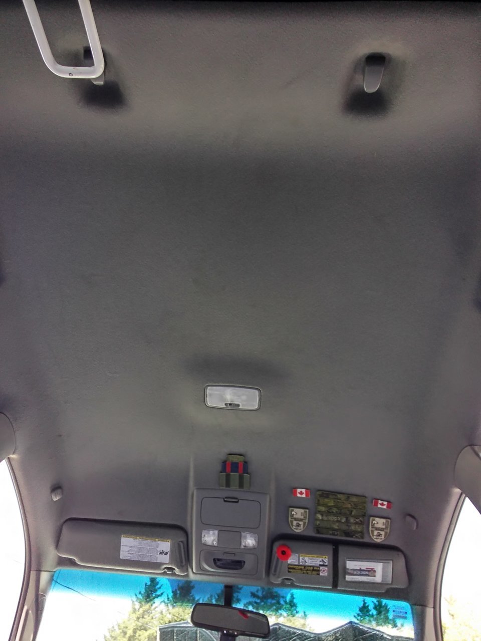

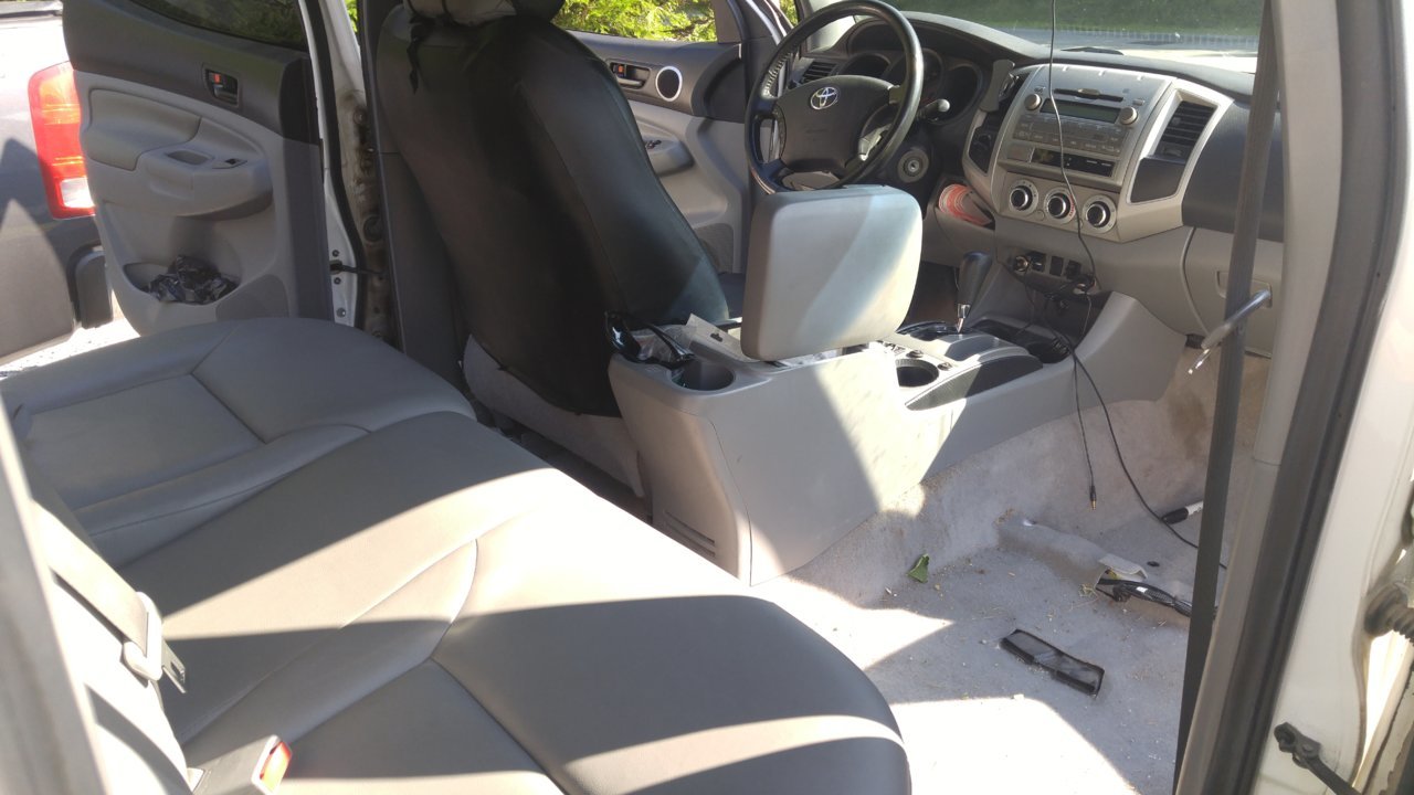

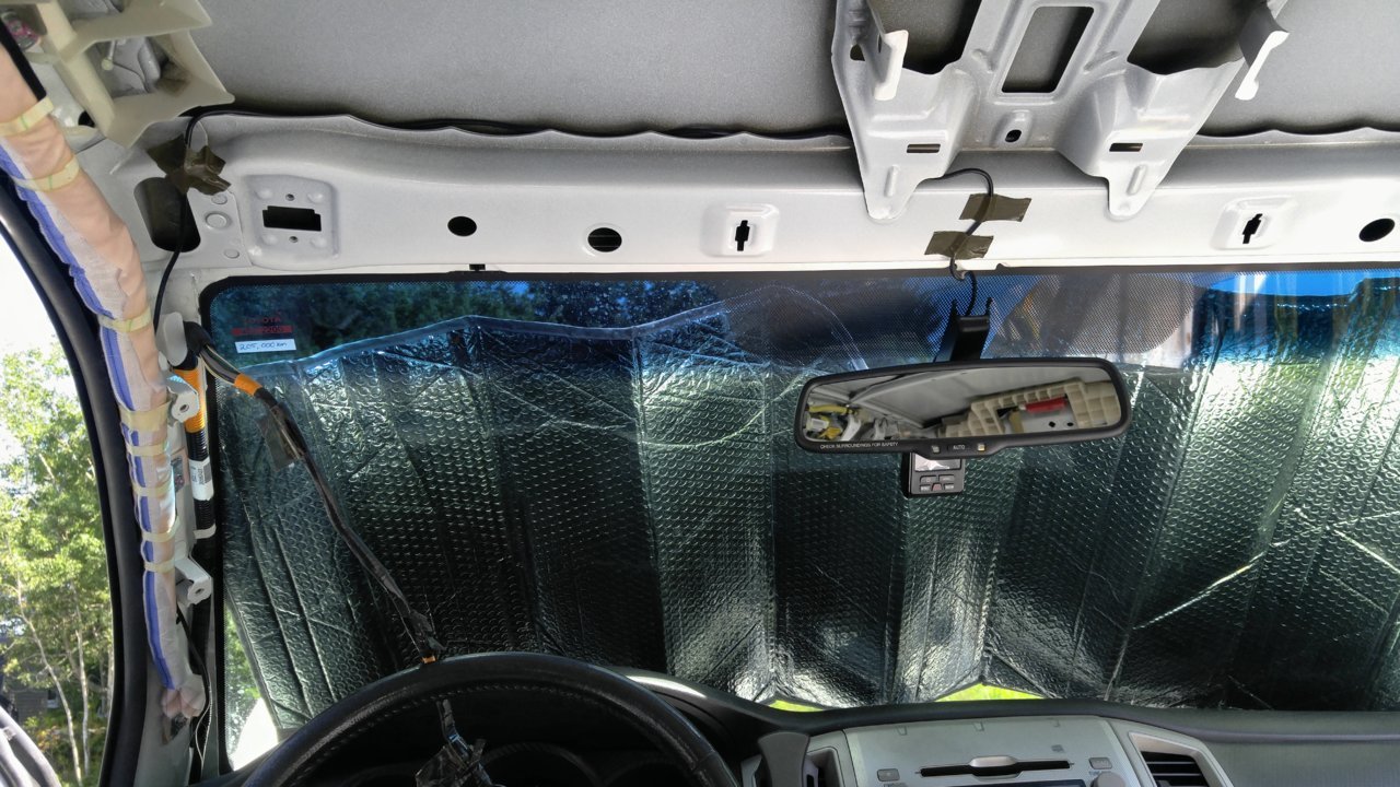

    Ran the capcitor line for my dash cam across the roof and down the A pillar.
    20180829_131101.jpg 20180829_134222_HDR.jpg 20180829_143326_HDR.jpg 20180829_143850.jpg
    Looking like a gypsy yard sale20180829_143602.jpg 20180829_143850.jpg 20180829_152800.jpg

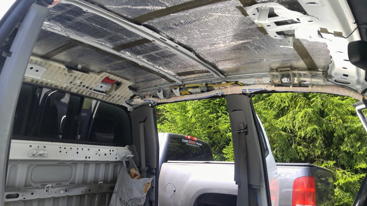

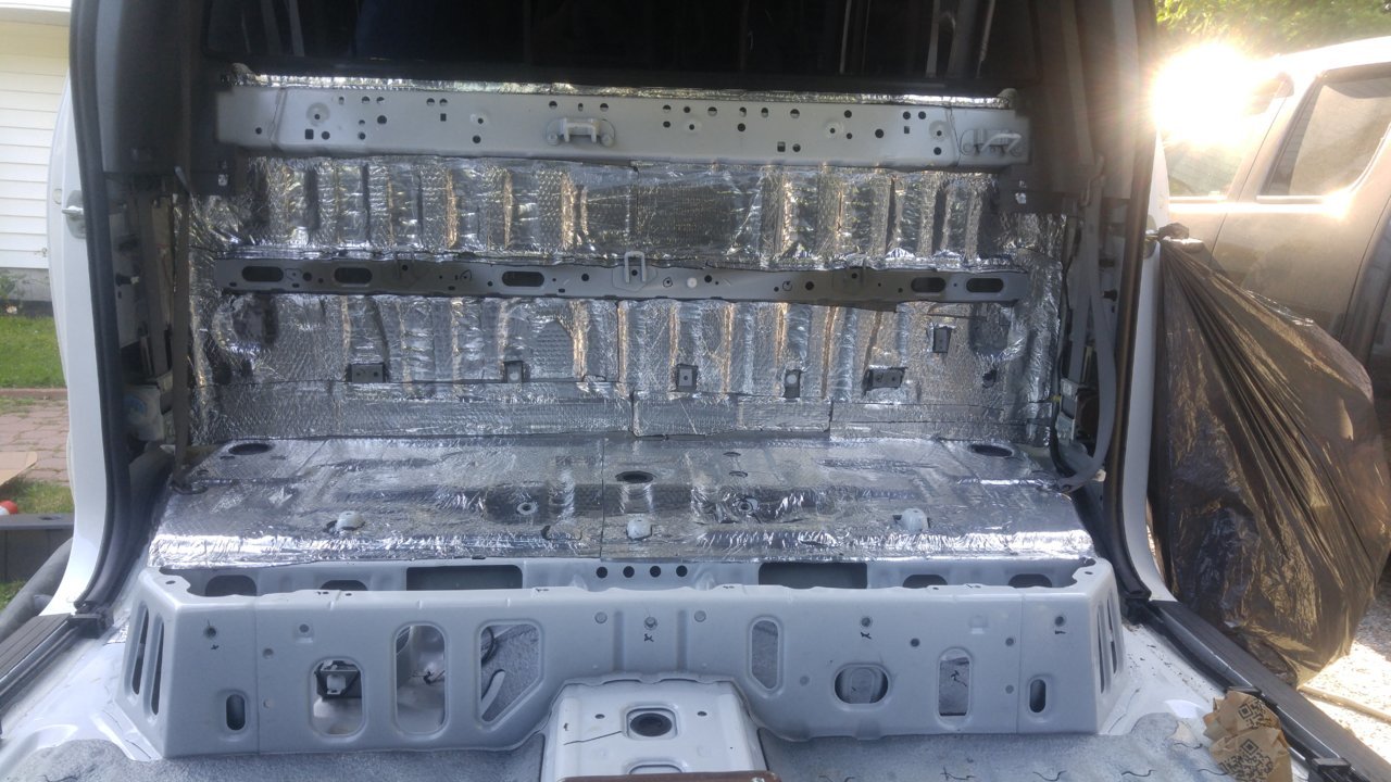

    Headliner back in. By far the easiest part of sound deadening. One 36 Sq Ft package of 80 Noico lasted me 4 doors and the roof 20180829_162544_HDR.jpg 20180829_172001.jpg

    All of them
    OP Silence
    Day 2
    Started running short on Noico so used it sparingly. All about driver's comforts amirite!?
    Have about a 1/2 of a sheet left, ill use the remainder on the door skins.
    Two days of drying and checking for moisture on the carpet floor to prevent that mildew.
    Everything went back together swimingly except I may have stripped one bolt. Not an important one mind you.
    Plans to add some sort of Mass Loaded Vinyl (MLV) when the funds allow it. For now I'll roll with this and keep everyone updated.
    Pre-deadening:
    Highway travelling (approx 100-120 km/hr) an hour averaging 56 DB with Windows up. Low 35 DB (probably at an idle) 80 DB with Windows down.
    EDIT:
    In city driving is so quiet now. Highway is a bit better but no luxury car quality. Happy withthe results

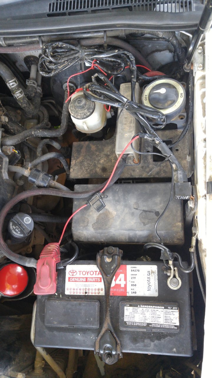

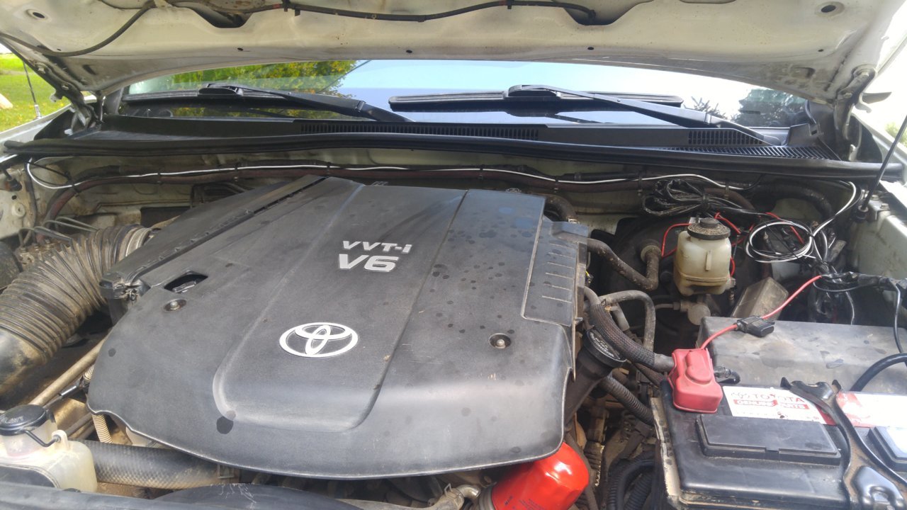

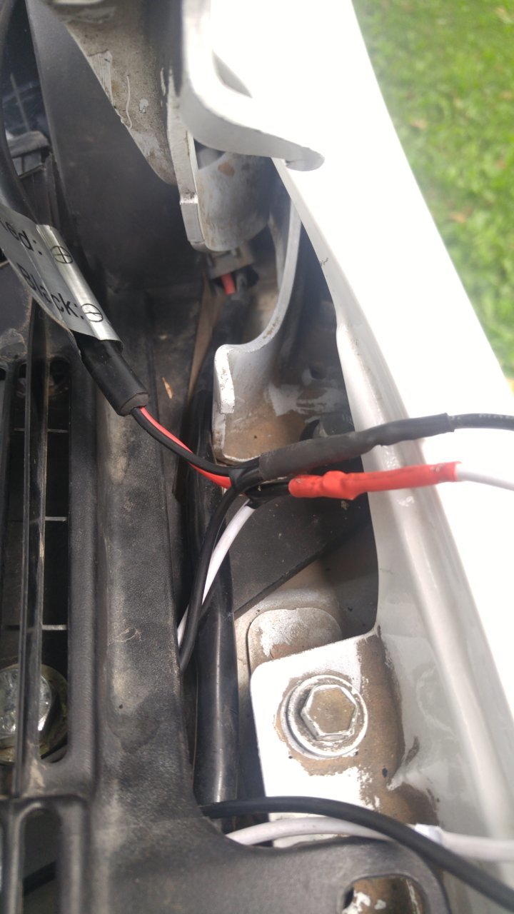

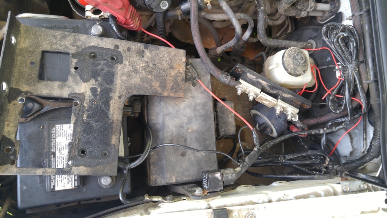

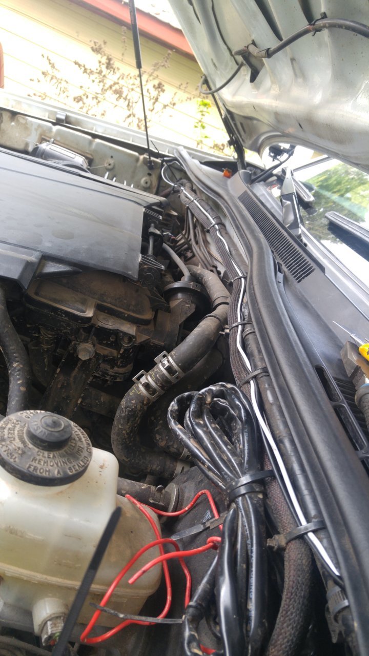

    Took apart the electrical and getting ready to add a 12 pin blue sea fuse box

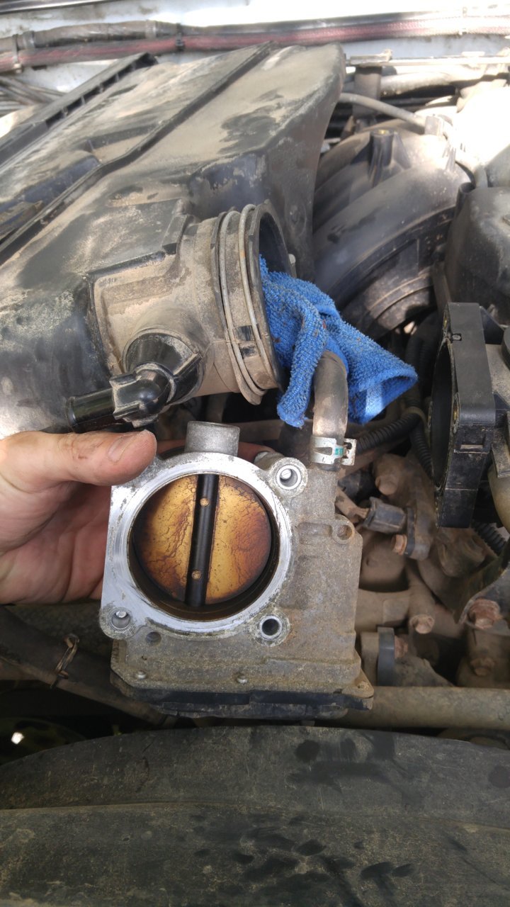

    Cleaned the air intake. Before below. After is much better.
    Master power removed for now, should be relocated but designing a platform for the 100 amp fuse, master power and house sea fuse box.
    Edit:
    @Norilsk I picked up some dielectric grease and applied it to the terminals. I was about to apply it to the maf and aIr intake connectors and was reading a lot of conflicting results saying it's more of an inhibitor. What's your counter arguement?

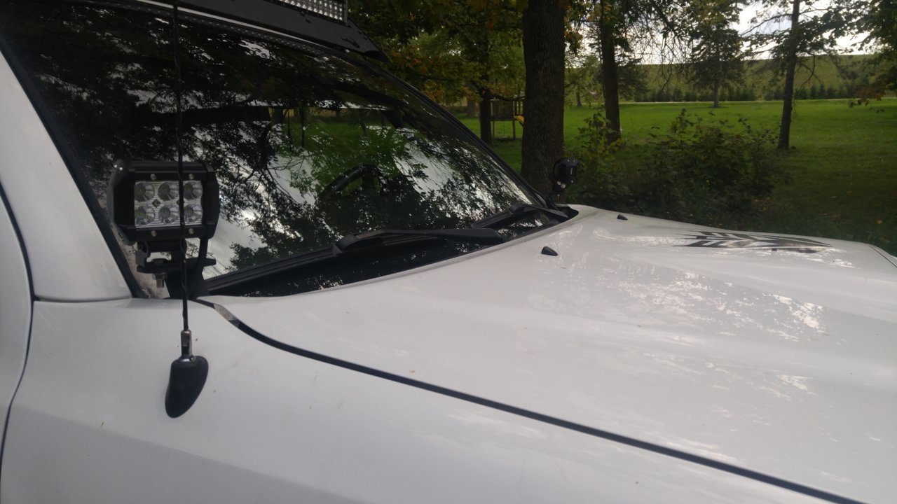

    Wired up ditch lights, just needs the Blue Sea Box
    still have to position them properly after they're hooked up.

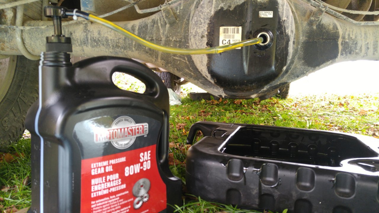

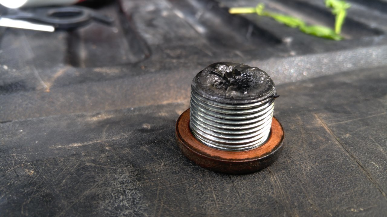

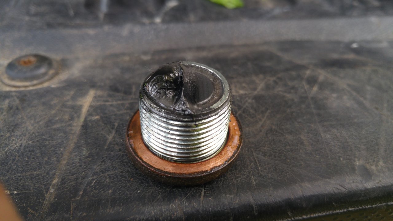

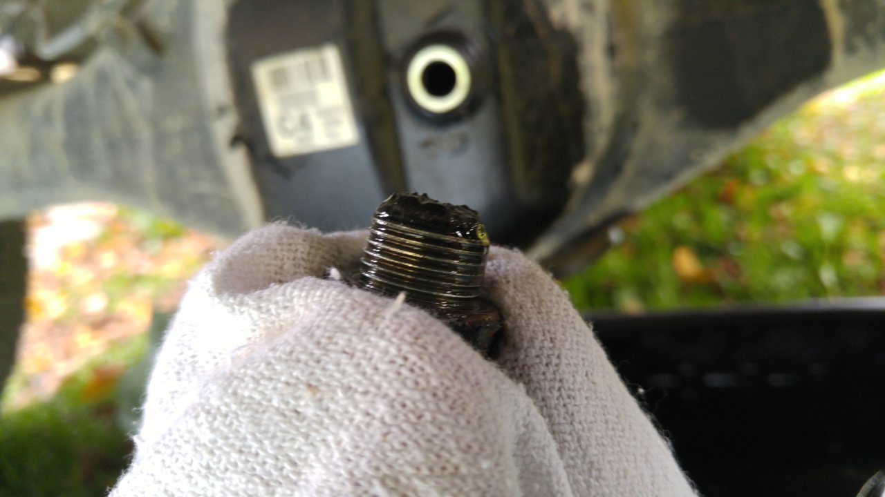

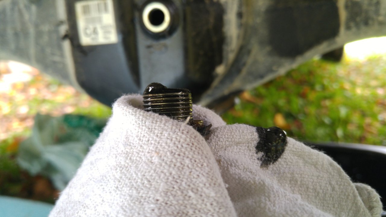

    Kept putting it off for some reason, but finally swapped out both differentials and transfer case fluids.
    Should have done this earlier. Thats about 123 000km of shavings....yea

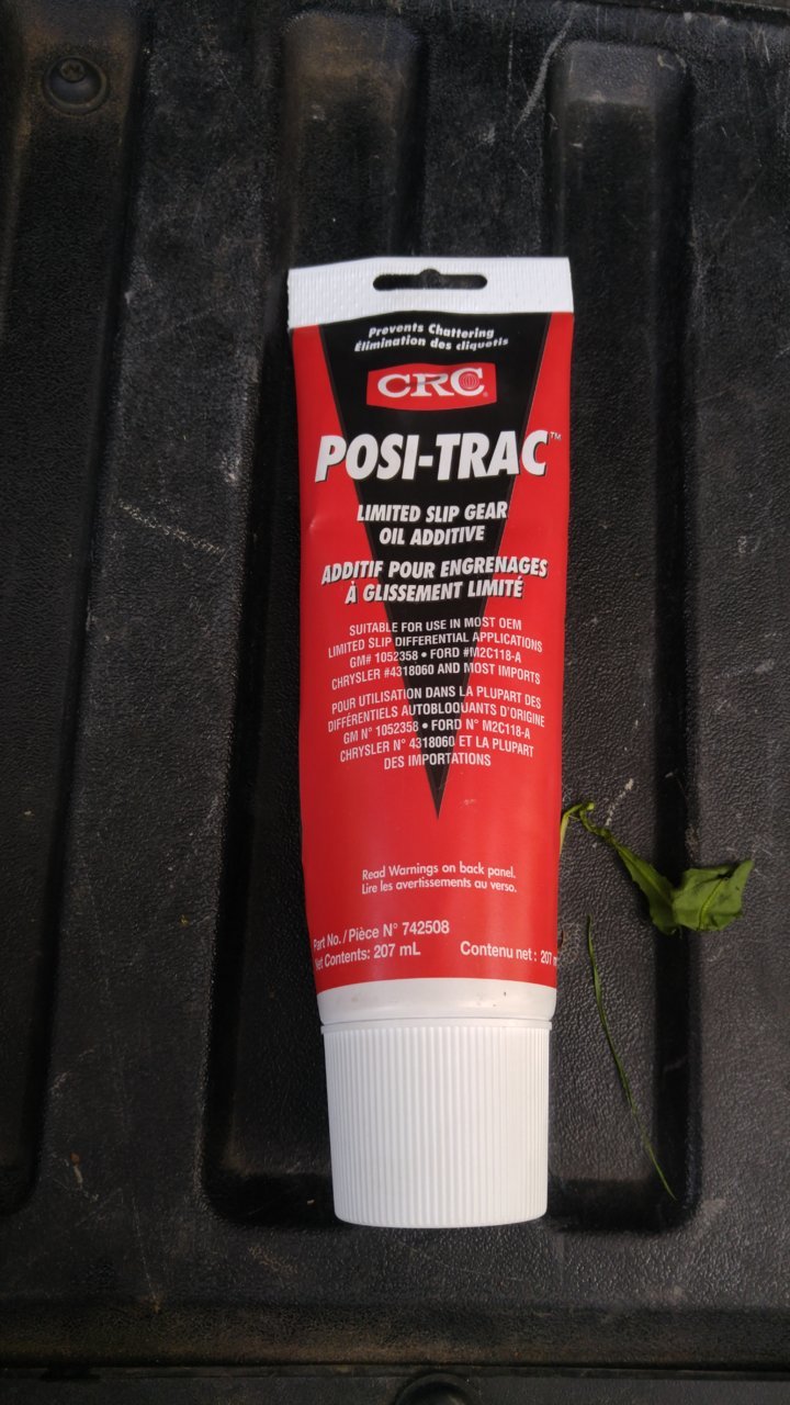

    Made sure there was some LS additive in there, as well it said to not use for auto trans? so if i dont blow up my diffs ill call it a success

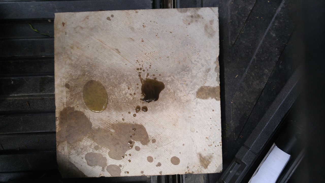

    Old vs New all but the T Case were good to go

    You don’t need the LS additive, but I doubt it’ll hurt anything! It’s only needed on the 05-08 that had a mechanical LSD. I’m 09 they switched to a “simulated” LSD to where its all brake controlled. Just thought I’d let you know.
    Manfred[QUOTED][OP] likes this.

    honestly I had no idea, dont even really know what it does if im willing to admit lol

    It has something to do with helping the clutch packs in the mechanical LSD. That’s all I know!

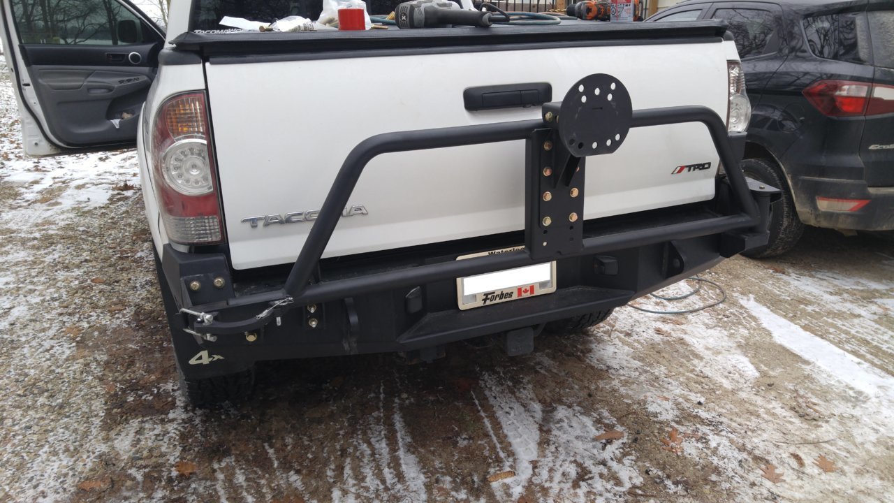

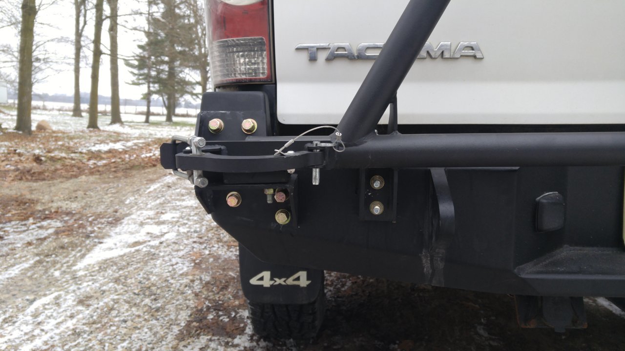

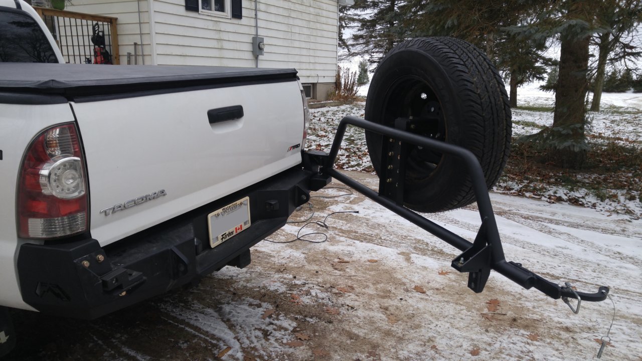

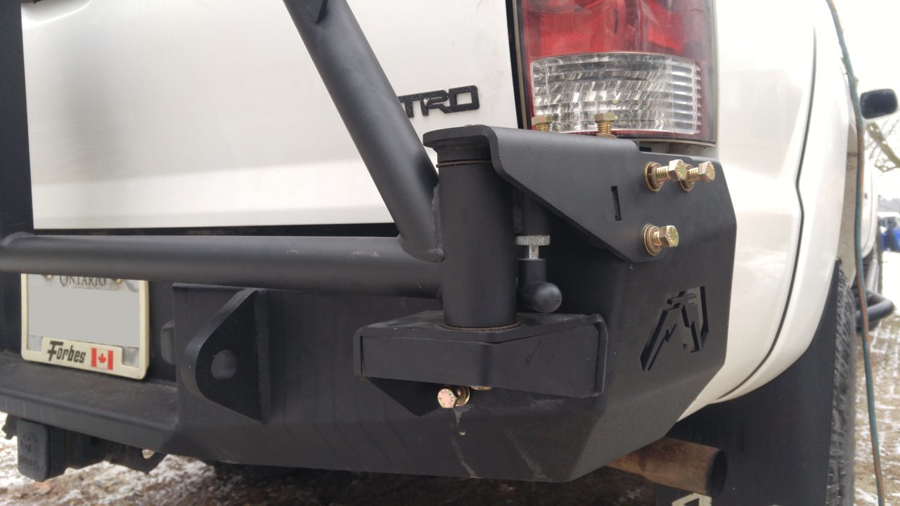

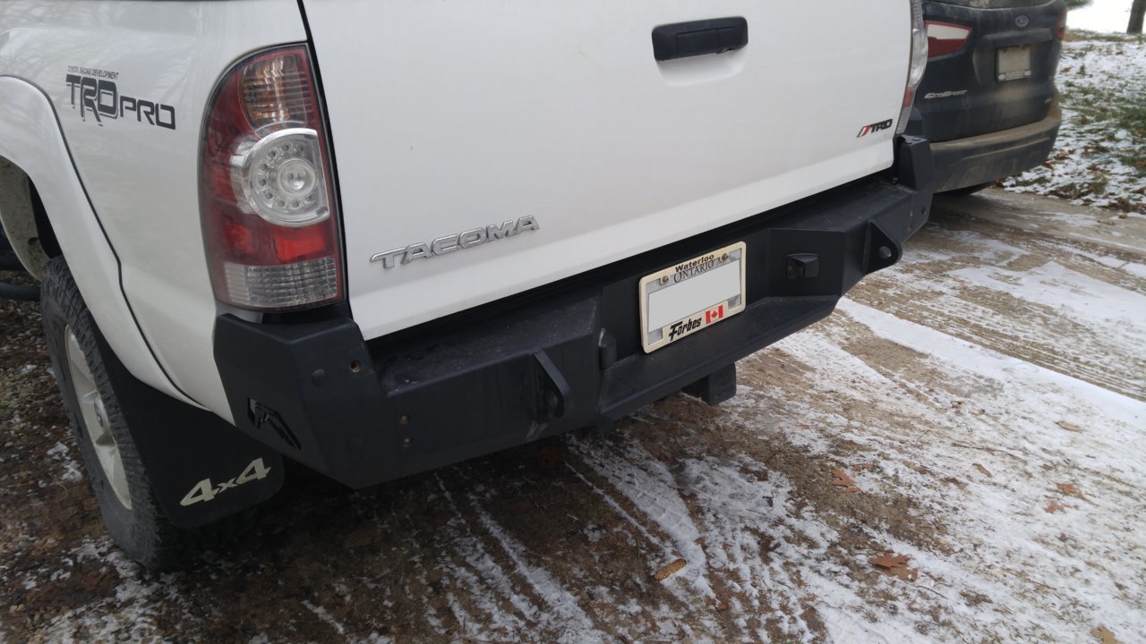

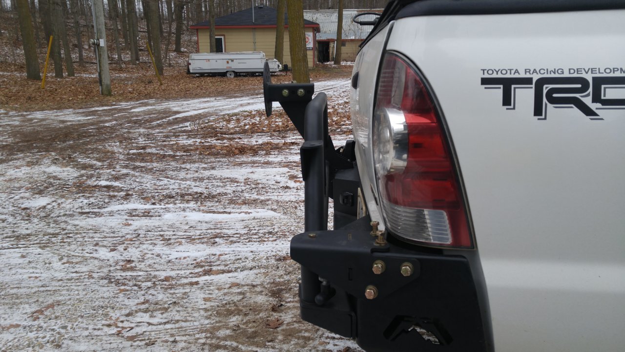

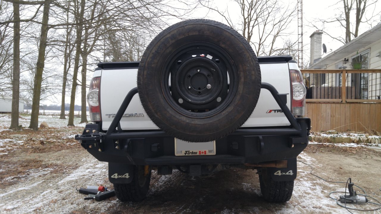

    Fab Fours Tire Carrier install. Just need some locking lug nuts and everything will be set. Plans to add jerry can holders in the works, opting for left and right of the spare.

    Oil change
    U-joints greased PSA: Do it now!
    New wipers.

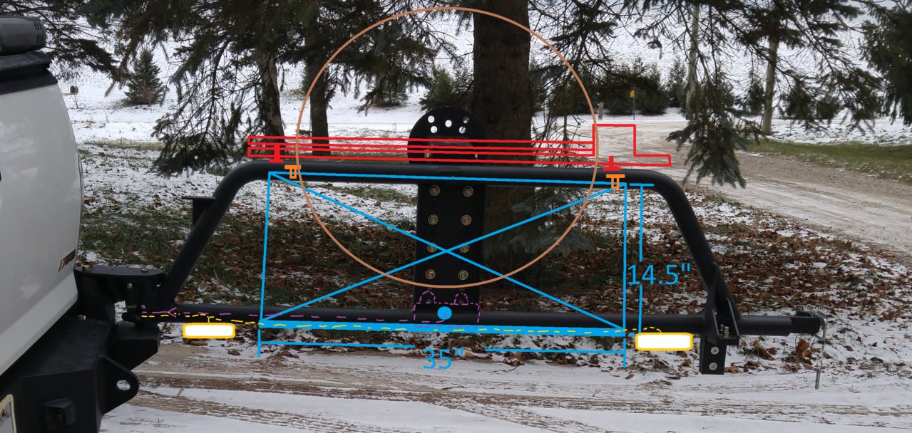

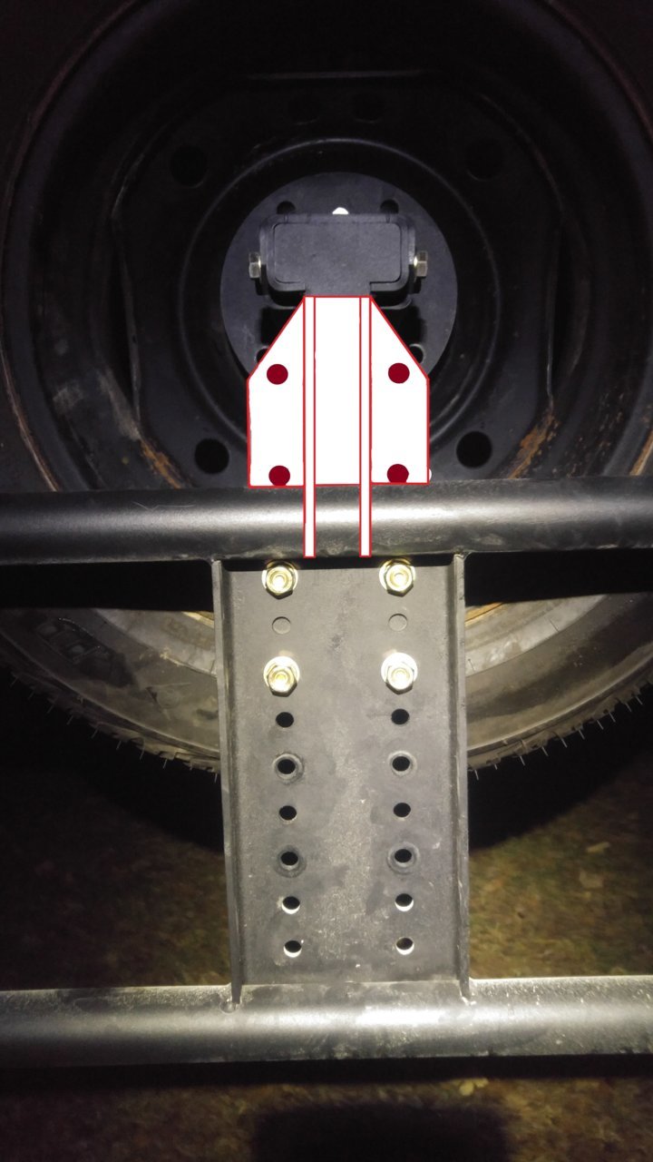

    Plans in the works to beef up the tire carrier, add points for a hi lift (future), mounts for jerries and a point for back up camera
    EatSleepTacos and tacoma16 like this.

    I will save you time, scrap that idea, just get a good floor jack. Hi-Lift is more sketchy that doing this (below) in my opinion :anonymous:
    Something like this in my shopping list: https://www.proeagle.com

    Oh wow. Thats a beefy jack, bit pricey but ill just let you get it and trail with you haha. scrapping that idea will save me from having to weld on those points

    Yeah, after having hi-lift, then always leaking (you have to store it vertical, but it always tips and leaks :annoyed:) hydraulic jack, I settled for an OEM jack, that as you can see served me well!
    Some guys have this jack and we used it already, quite useful, but takes a lot of space and must be stored vertical too.
    https://www.amazon.ca/Powerbuilt-64...F8&qid=1545165456&sr=8-7&keywords=jack+stands
    My old garage floor jack is going to die soon, so next summer would be a good time to get that off-road jack :spending:
