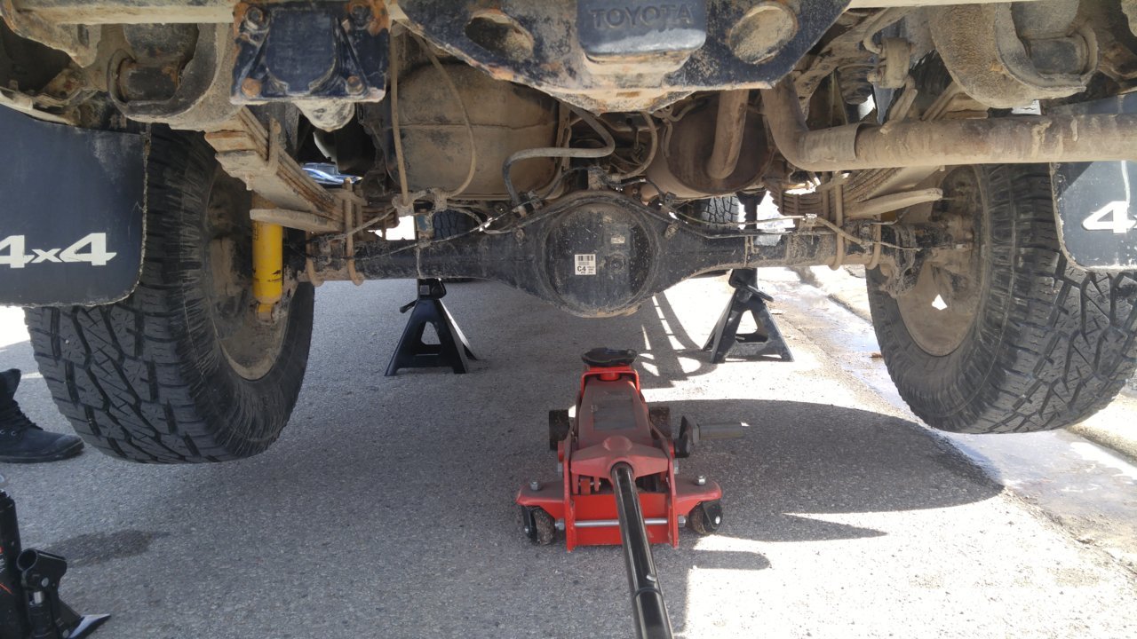

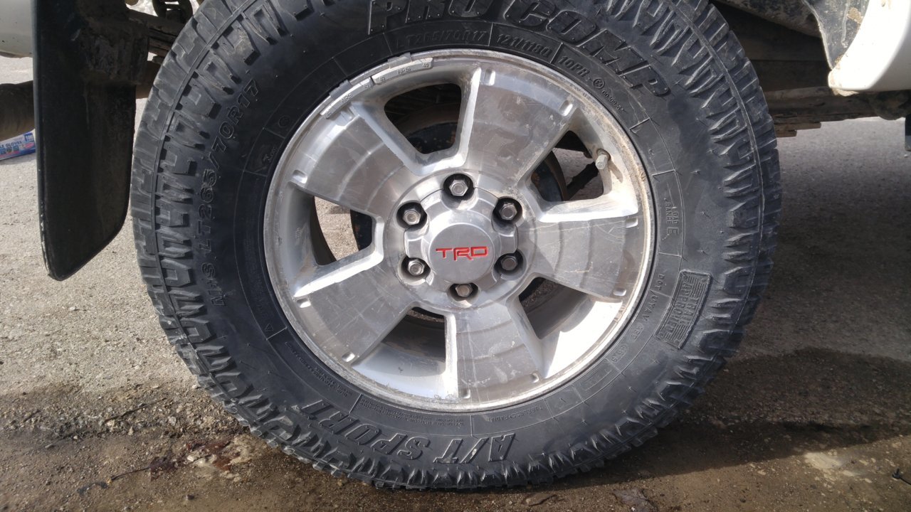

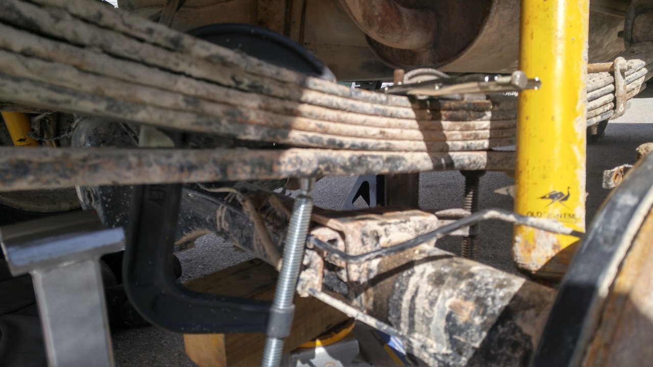

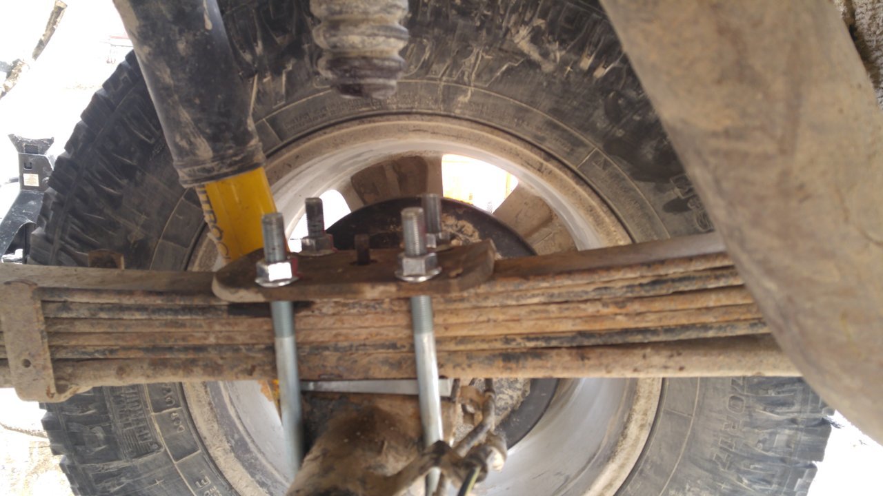

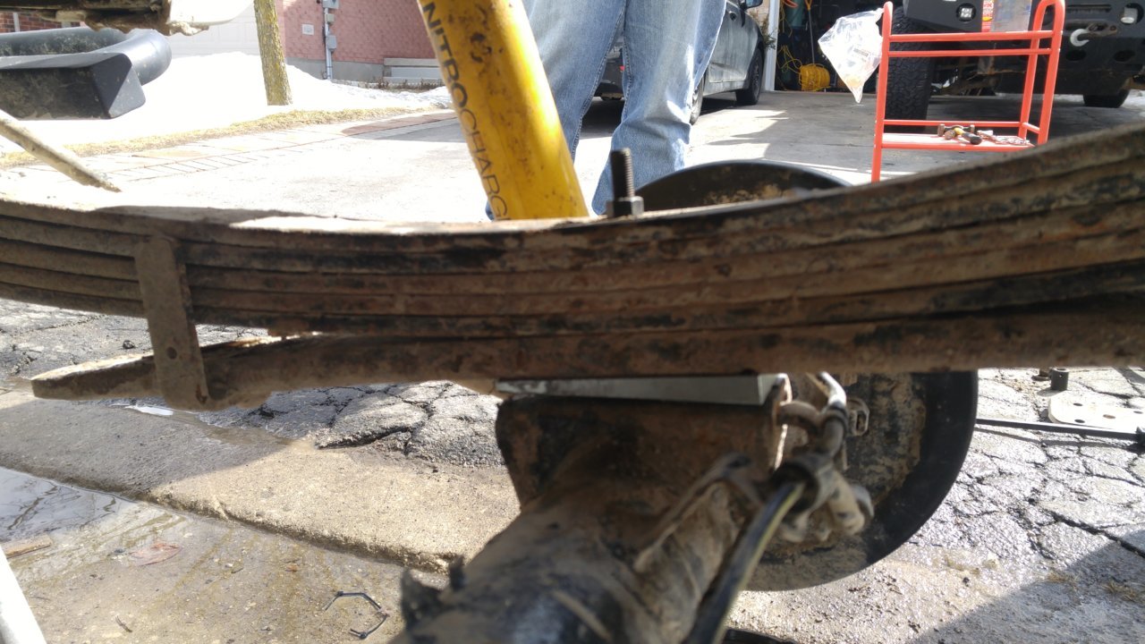

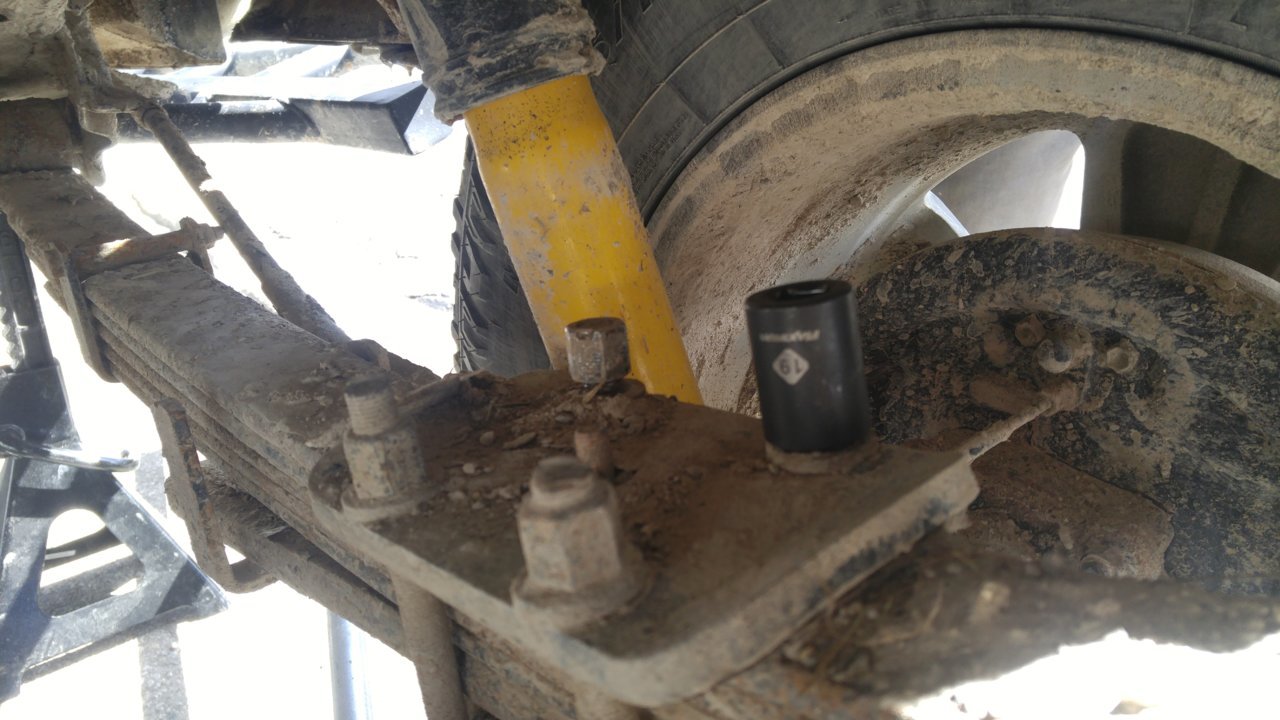

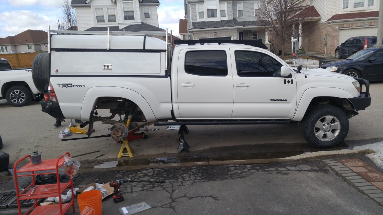

    Finally! Enough good weather to throw on all pro axle shims. Big thank you to @tacoma16 for all the tools and help. Also a thank you to @Norilsk for those centre caps. You saved the day!
    Driveline vibes are non existent which is great because I've been putting up with them since July when I dropped my lift in.

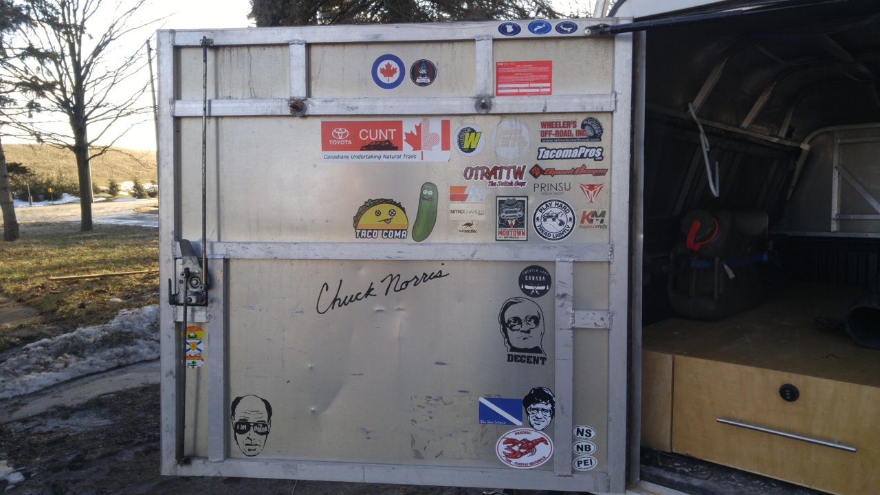

    The sticker collection grows

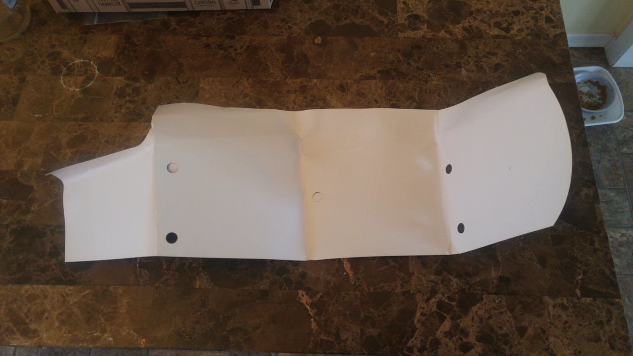

    @EatSleepTacos this is my template. So I may go with the old grease method. Wish me luck.

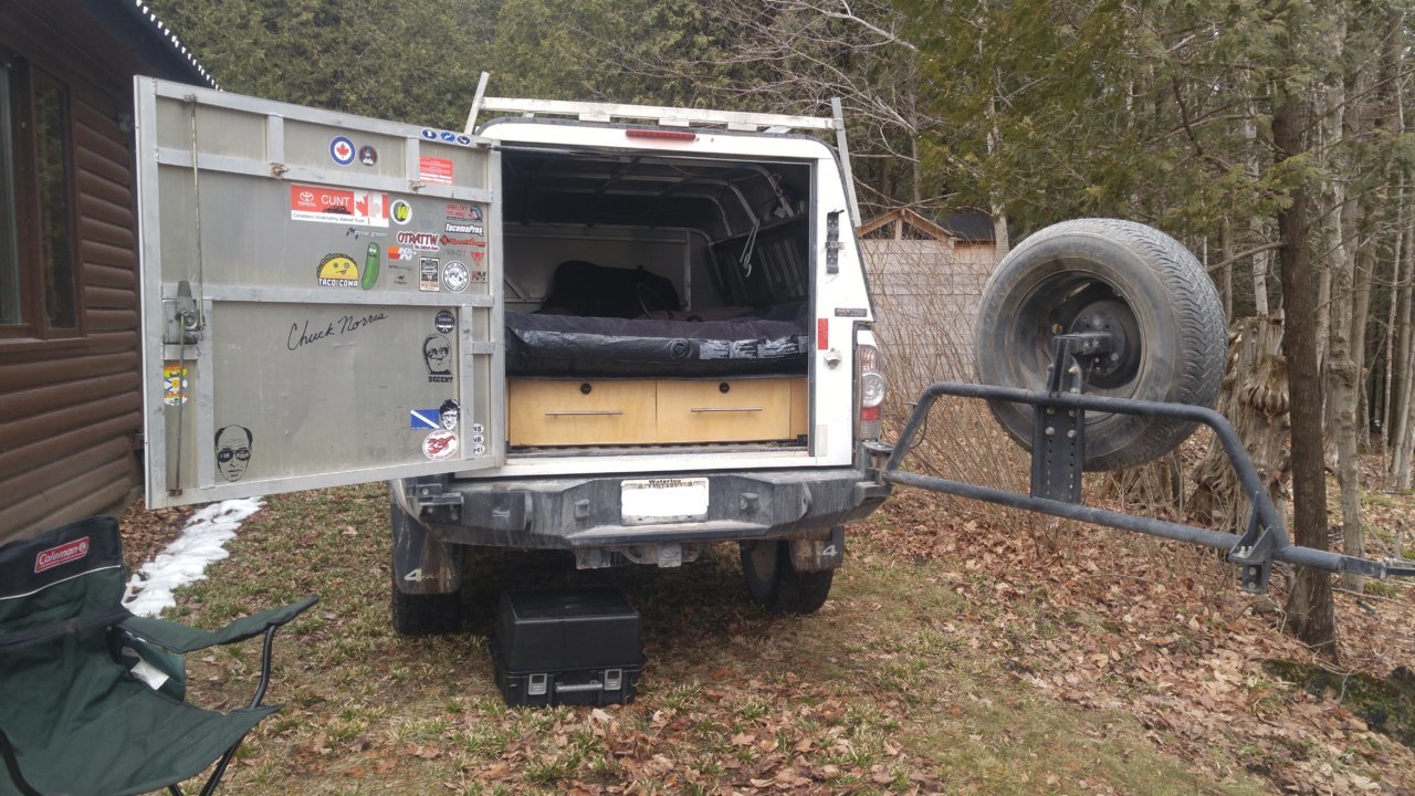

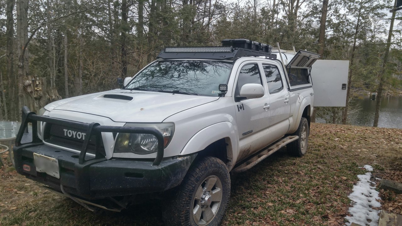

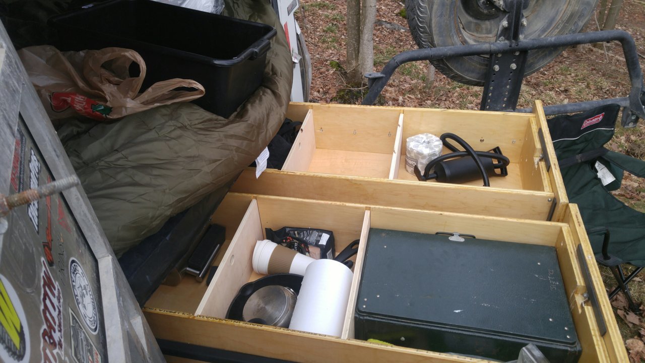

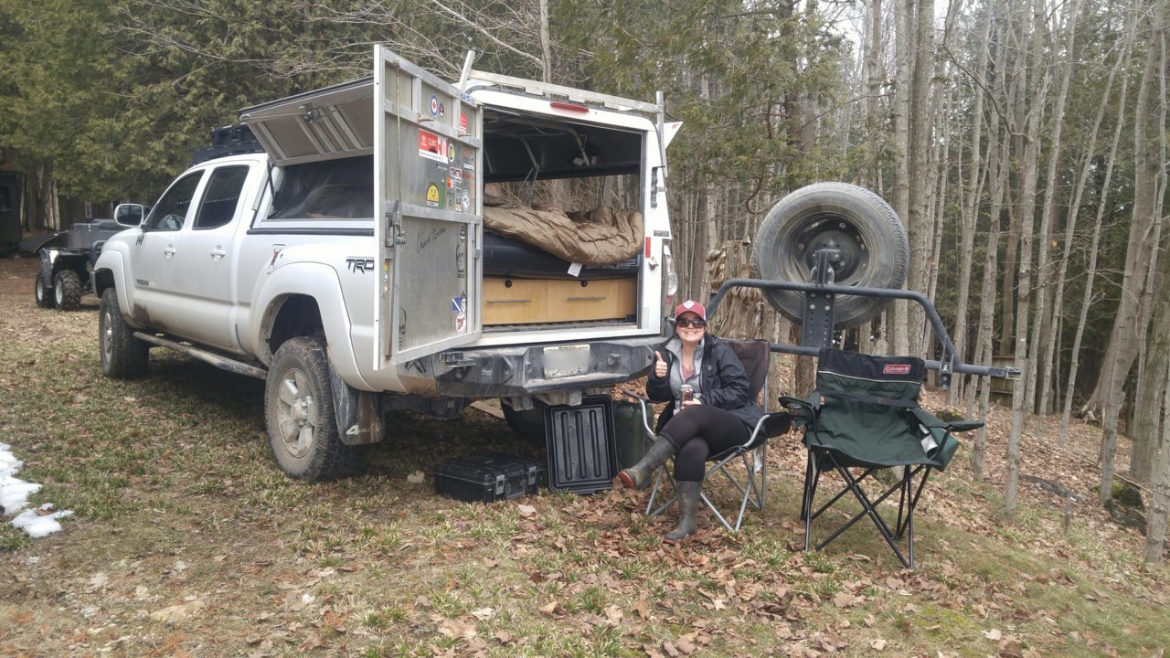

    First camp out. Need to:
    Work on my organization of the drawers
    Leave the truck bed mat at home.
    Swap my air mattress for two single or double memory foam pieces.
    Build drop down table for tire carrier
    All and all a good time. Quick set up
    2019-04-07_13.39.16.jpg20190406_120759.jpg 2019-04-07_13.38.21.jpg 2019-04-07_13.40.57.jpg 2019-04-07_13.39.56.jpg 2019-04-07_13.42.07.jpg

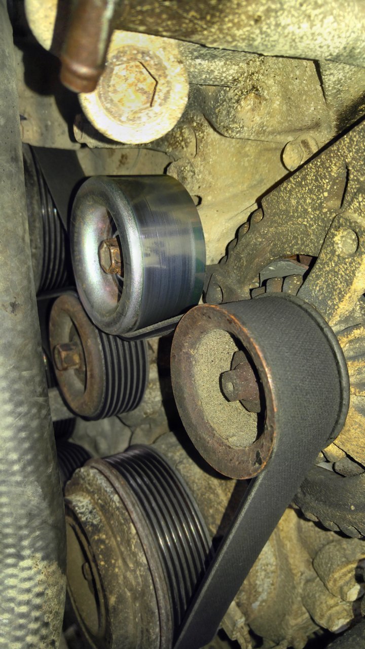

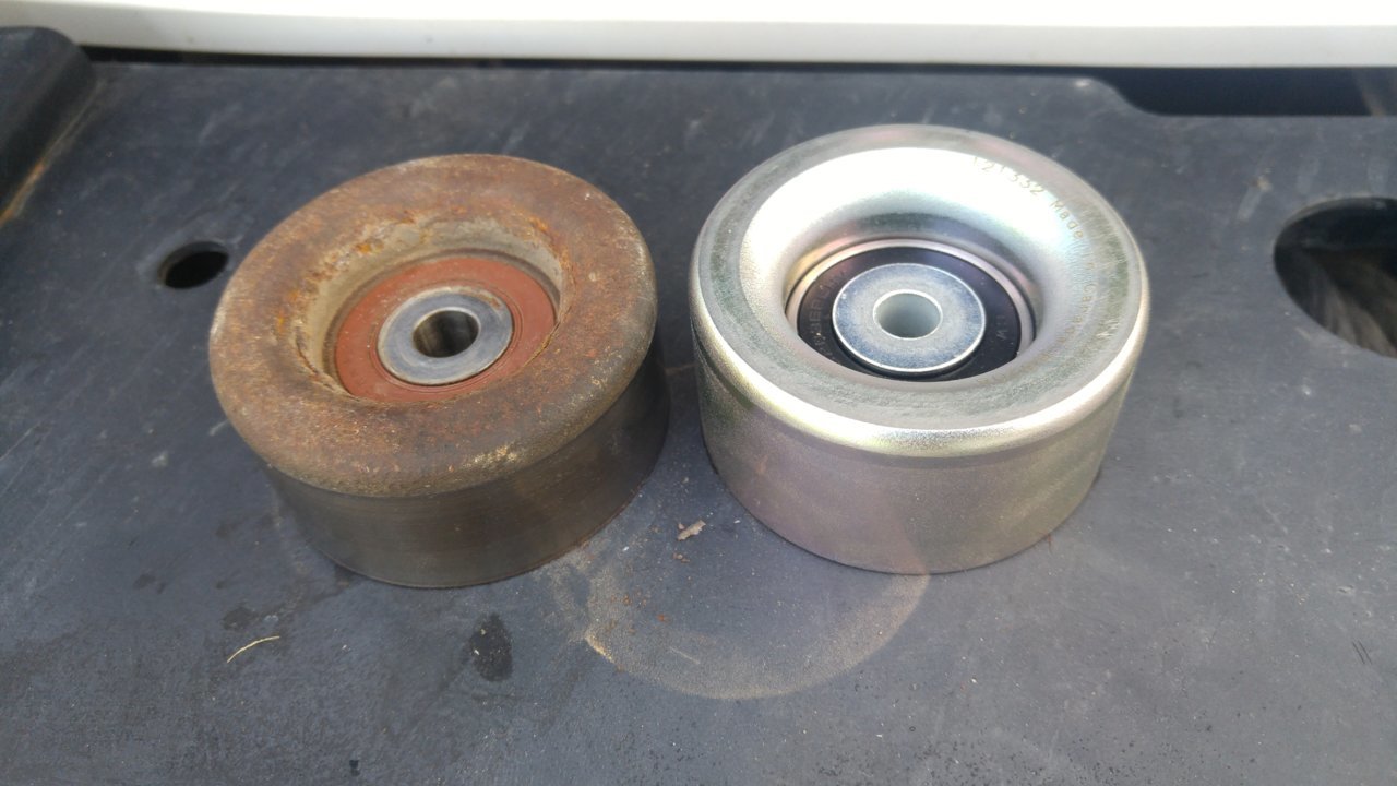

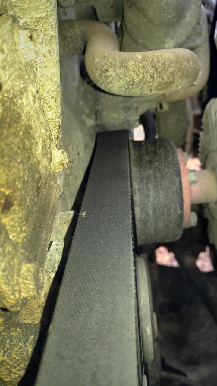

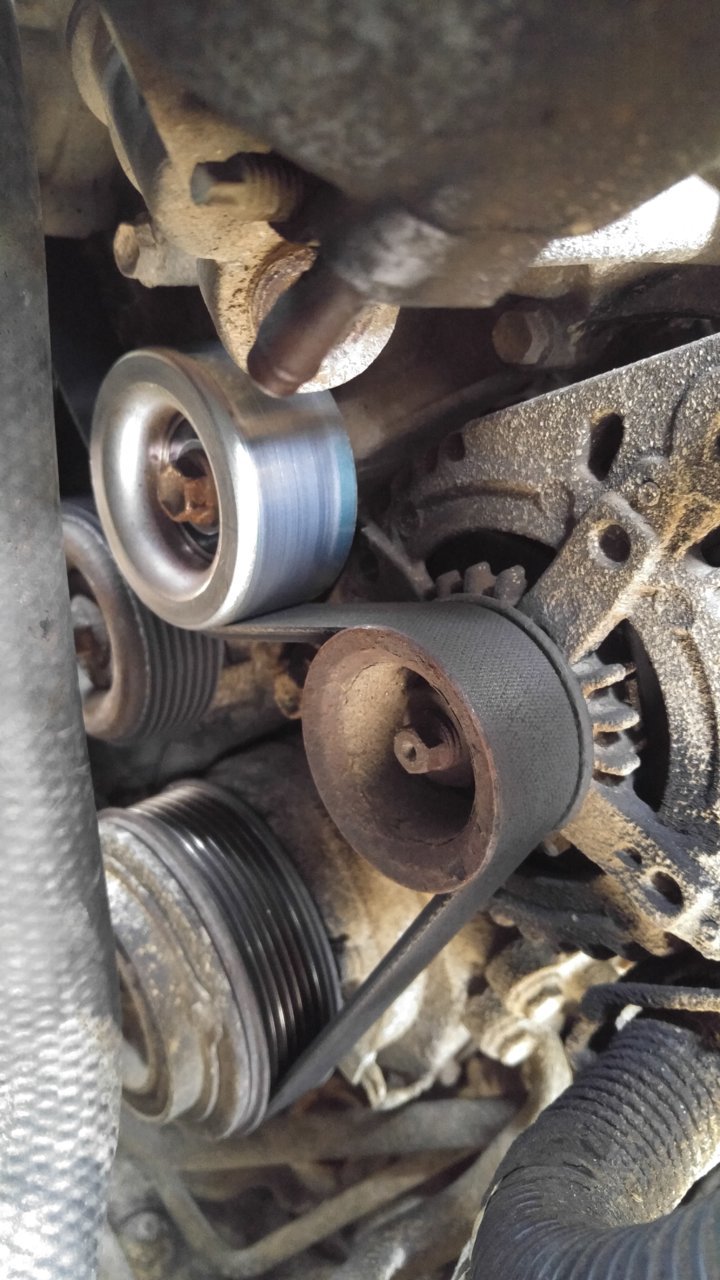

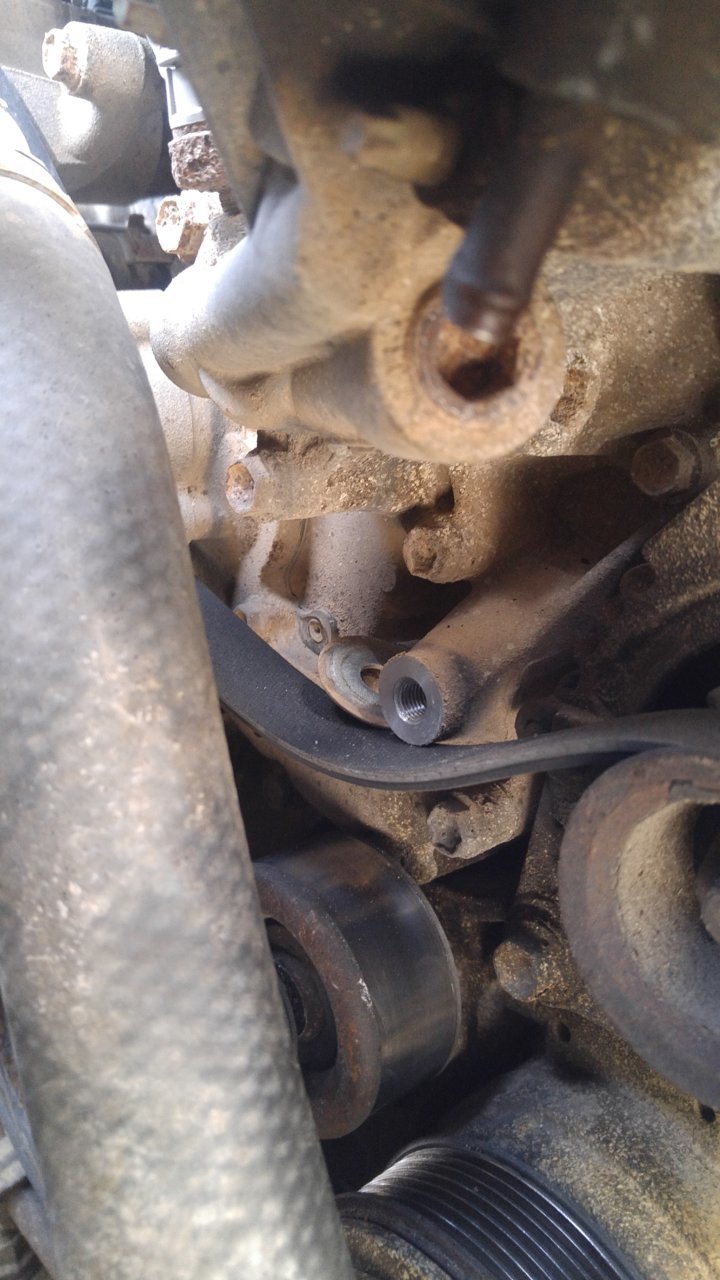

    No 2. Idler Bearing replacement.
    make sure the belt placement is correct or itll end up screaming like a banshee in heat
    20190408_190731.jpg 20190408_190816.jpg 20190409_173708.jpg 20190409_174833.jpg 20190409_180035.jpg 20190409_180059.jpg

  16. Apr 9, 2019 at 4:32 PM
    #336
    Atlas86
    Atlas86 Well-Known Member
    May 28, 2017
    #220140
    778
    Ontario
    2012 Tacoma TRD Sport DCLB
    How bad was it to do?
    Manfred[QUOTED][OP] likes this.
  17. Apr 9, 2019 at 4:40 PM
    #337
    Manfred
    Manfred [OP] Well-Known Member
    Jun 25, 2014
    #132699
    2,246
    Manfred
    Great White North
    2010 DCLB
    All of them
    funny you should ask. Went to @tacoma16 's place thinking I was doing idler bearing, he thought wheel bearing so when I got there we were both unprepared. Took us maybe 30 min, and that included double checking torque specs. Just a simple loosen the tensioner, take off the bolt to the idler bearing, new one on with a small bit of anti seize, tighten, torque, tensioner back to home position done.
    Now I just have to diagnose a whine Ive been dealing with since July of last year when I went in the puddle. Either Water pump which I hope to Christ not, or a alternator pulley.
    tacoma16 and Atlas86[QUOTED] like this.

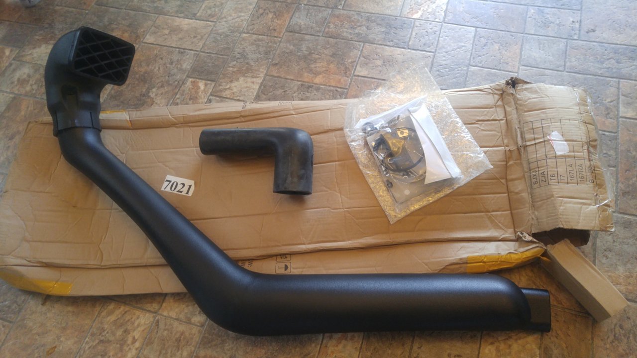

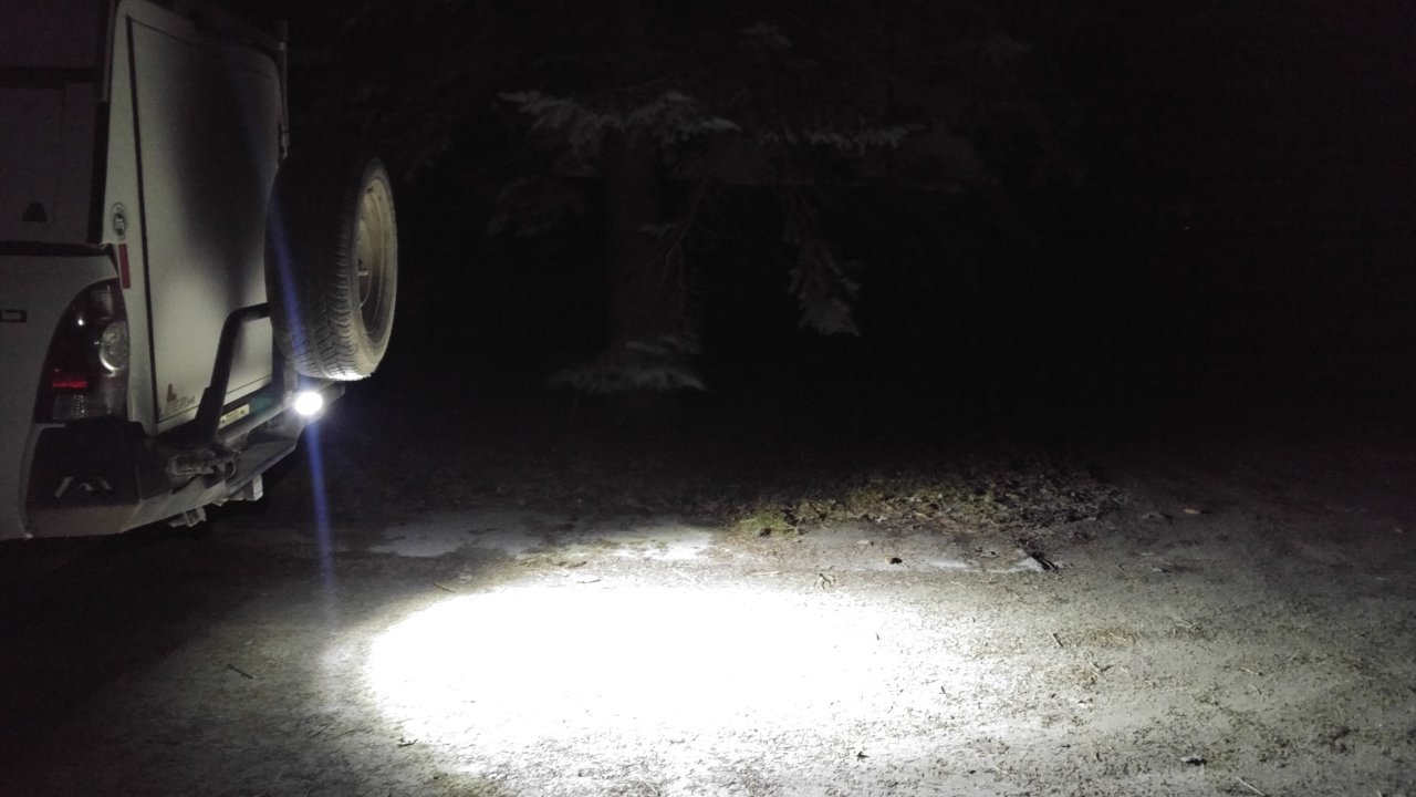

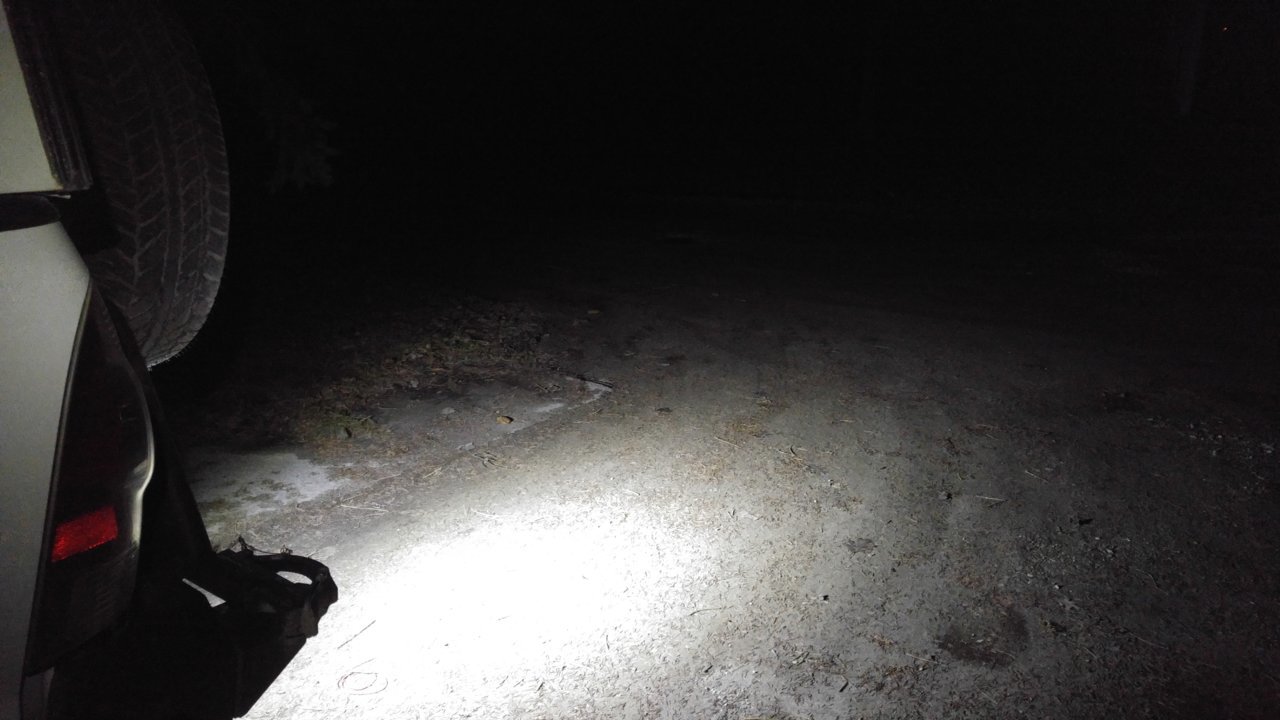

    I did a thing!
    Maybe a diffused light would be work better, it's pretty concentrated.
