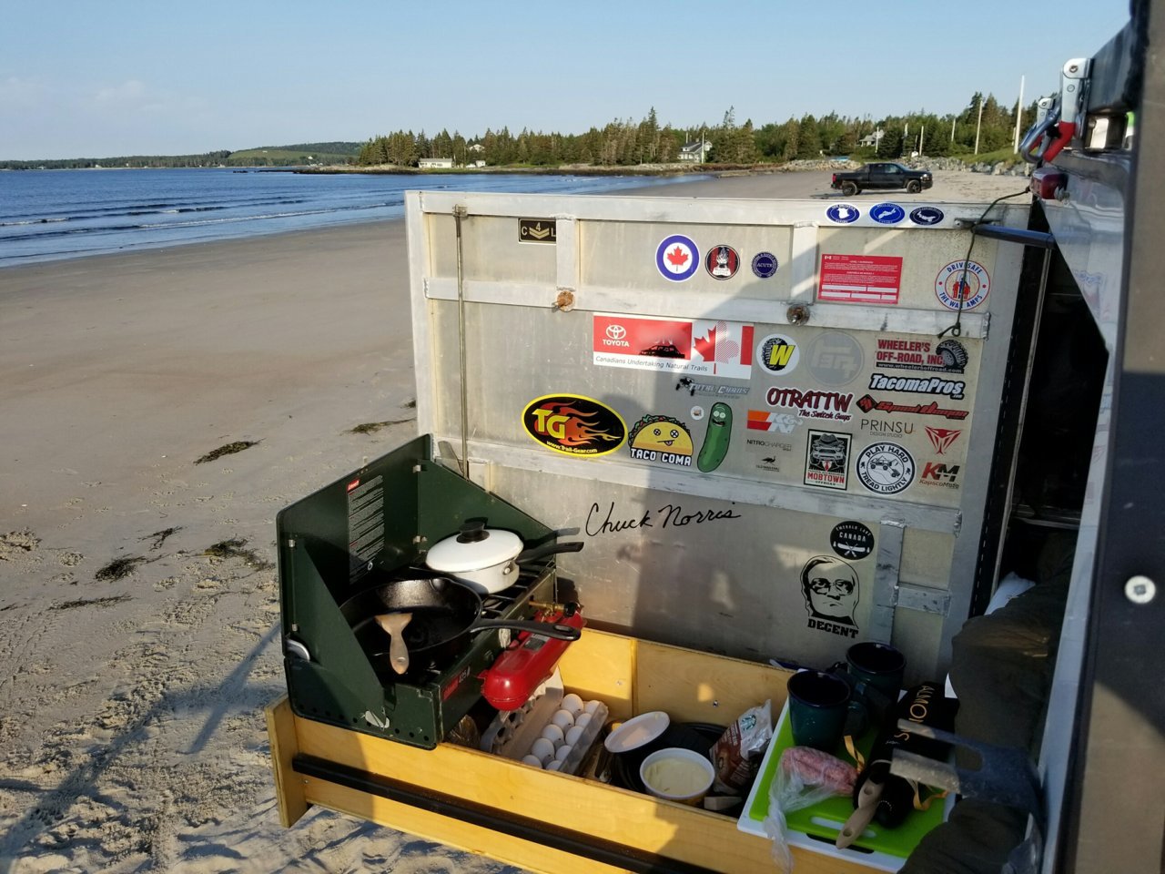

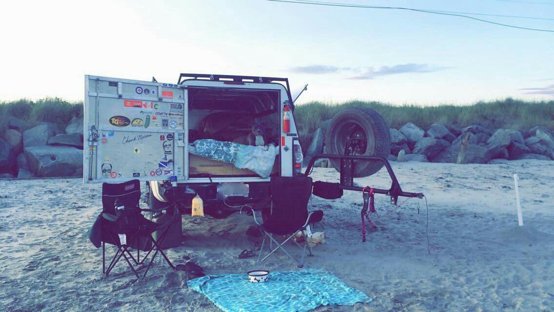

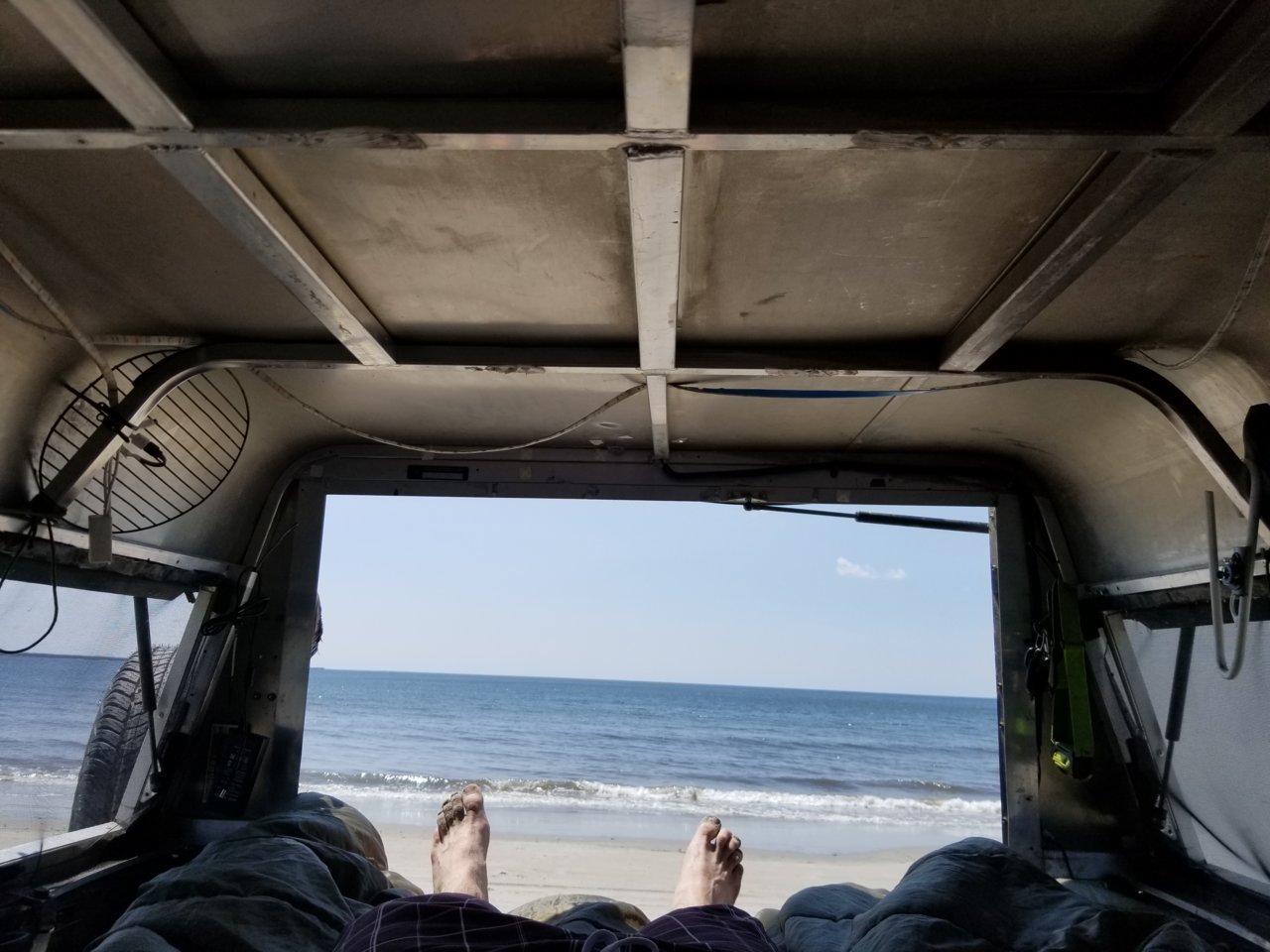

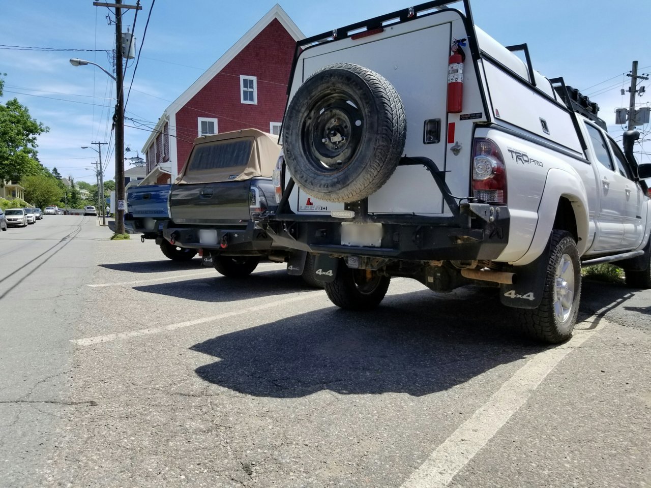

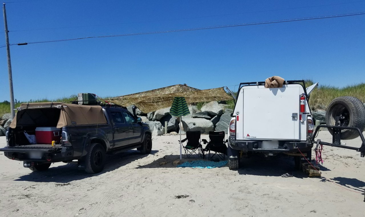

    Back from a two week trip travelling the east coast with the Mrs, the dog, @Atlas86 and @Canadianguy91.
    Truck took a beating but learned a lot on what I need to bring vs nice to have.

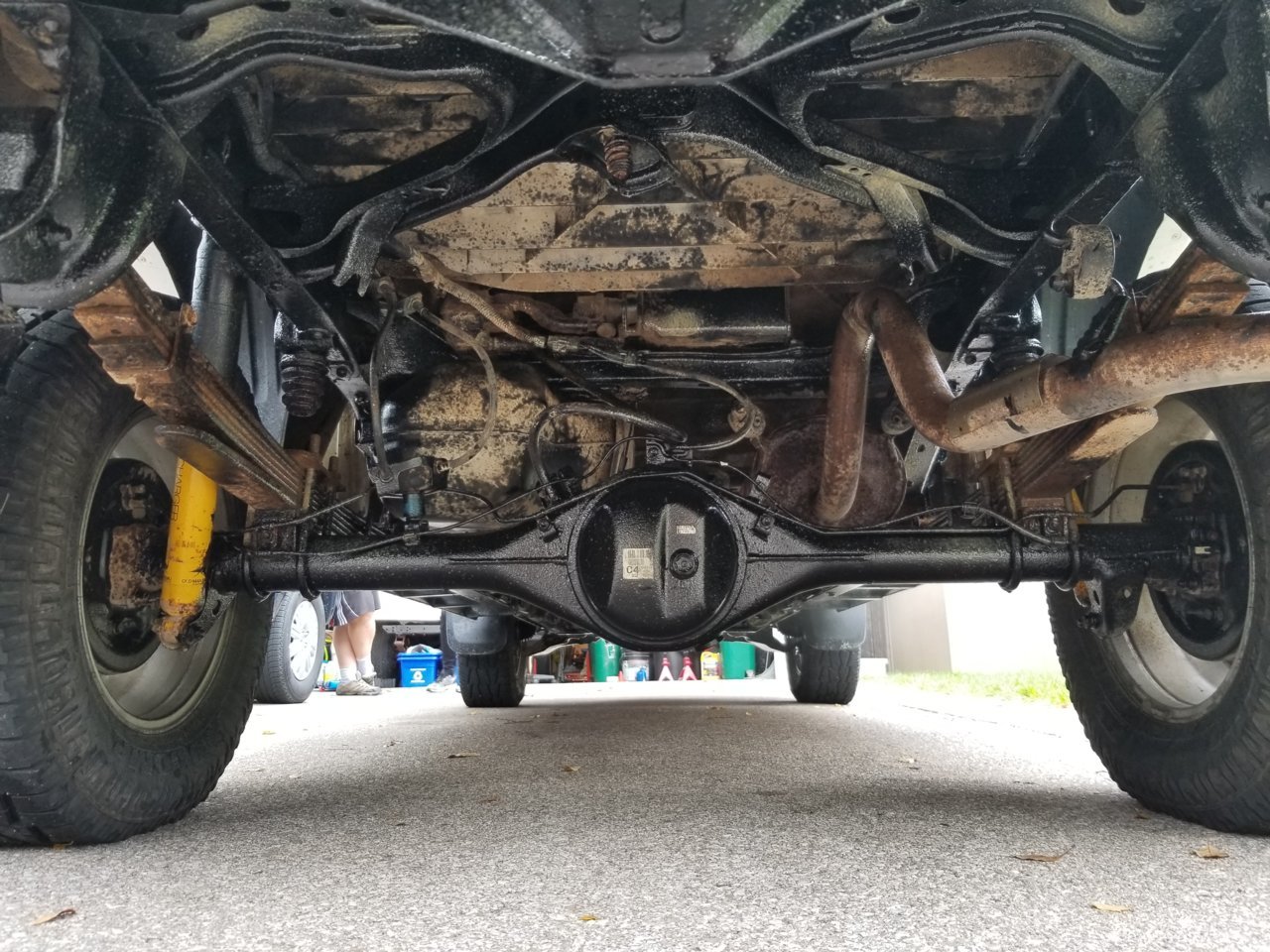

    received_2533572123320794.jpg 1st trail run
    Gasket and some bolts to bring it closer but just a bandaid solution.
    2nd trail run

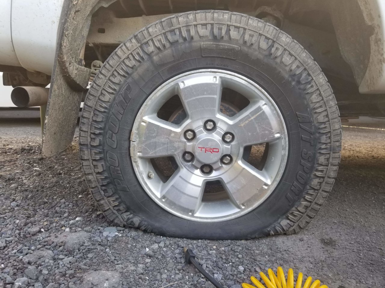

    Flat tires hurray!
    Crescent Beach, Nova Scotia

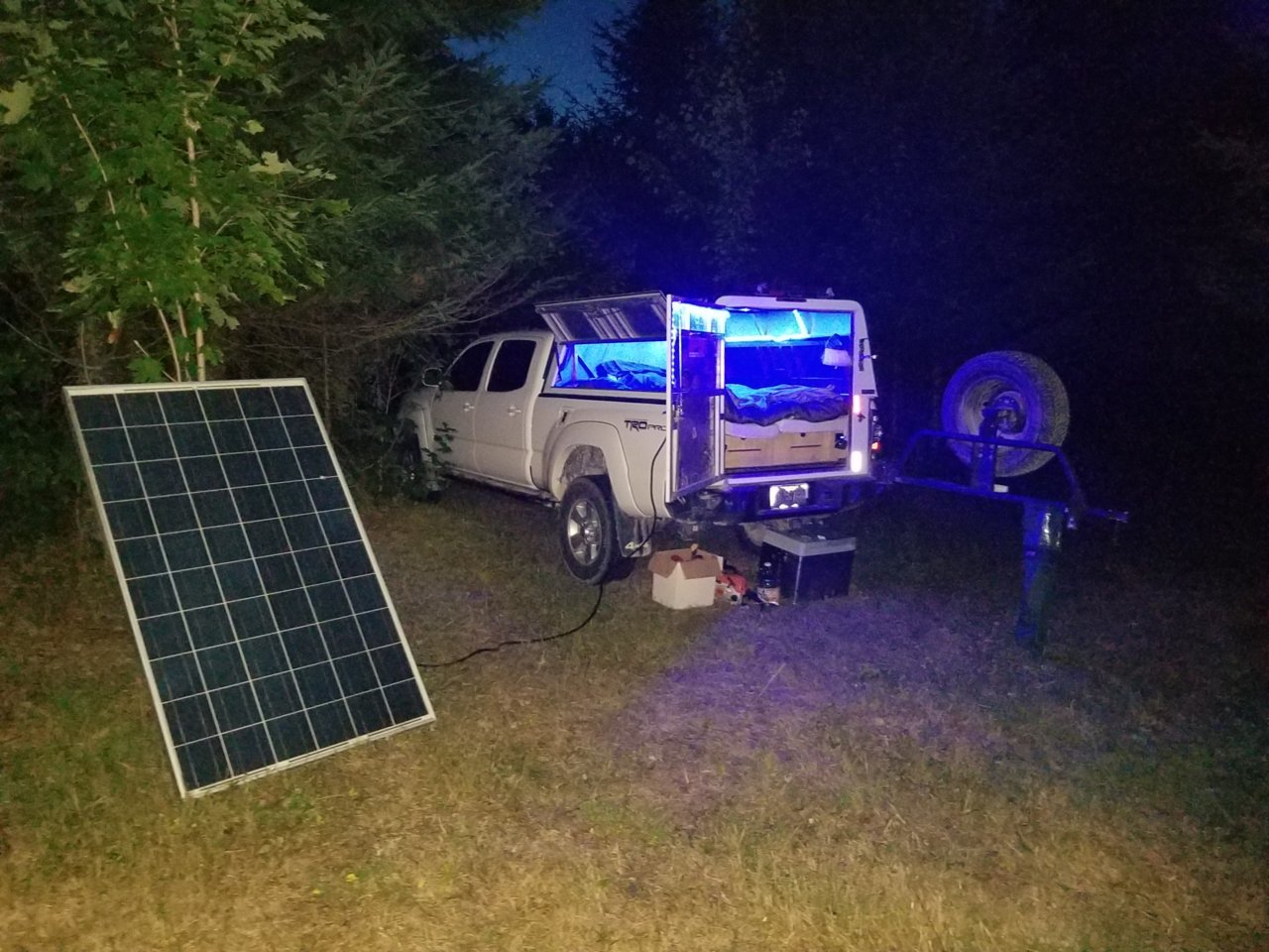

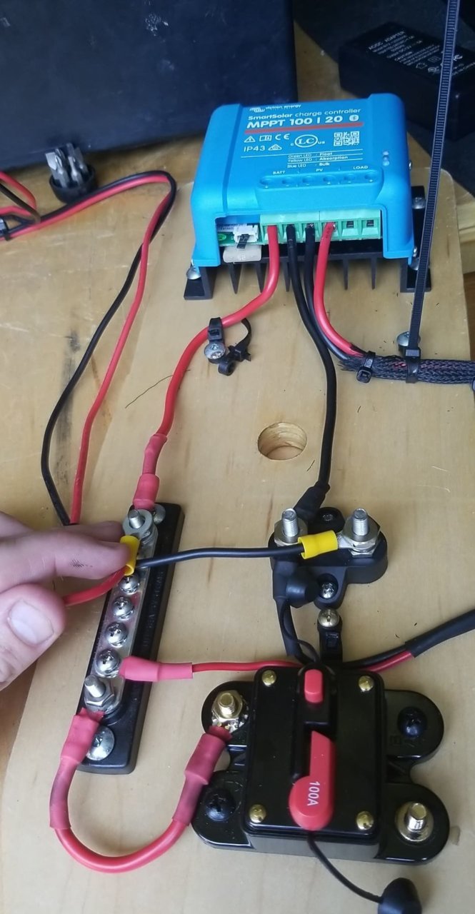

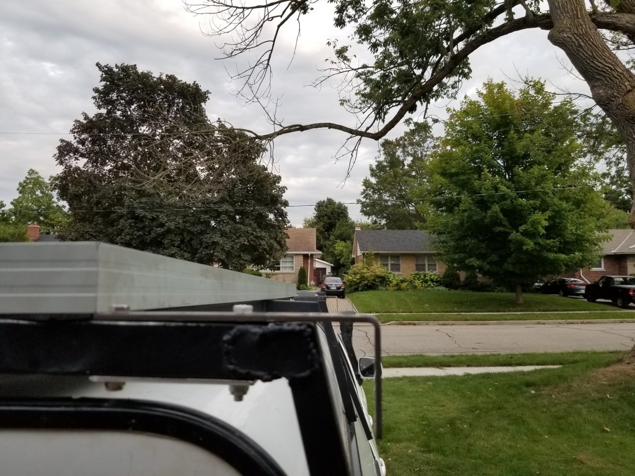

    Solar set up 95% complete. Repositioning the battery to the undercarriage and should be fabbed up soon.

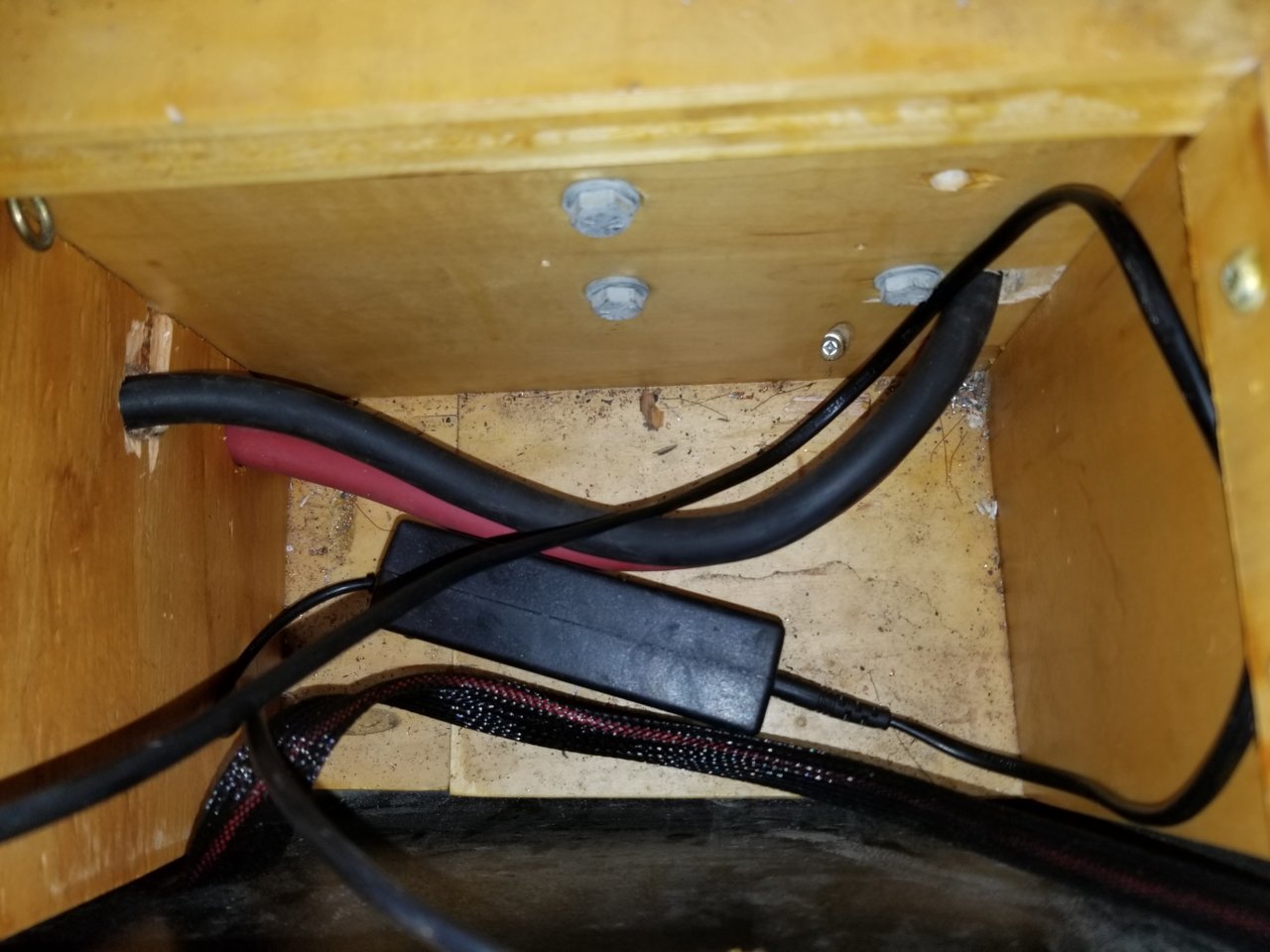

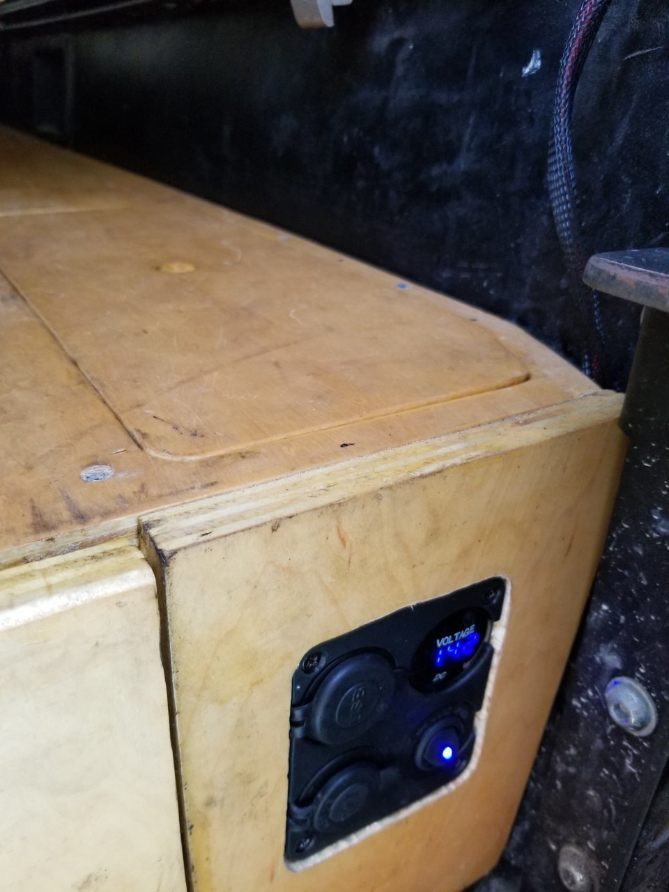

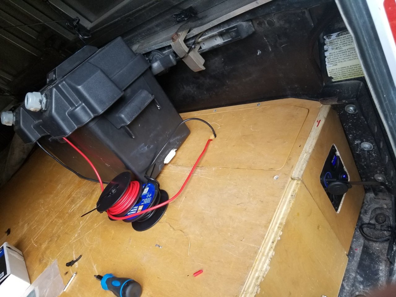

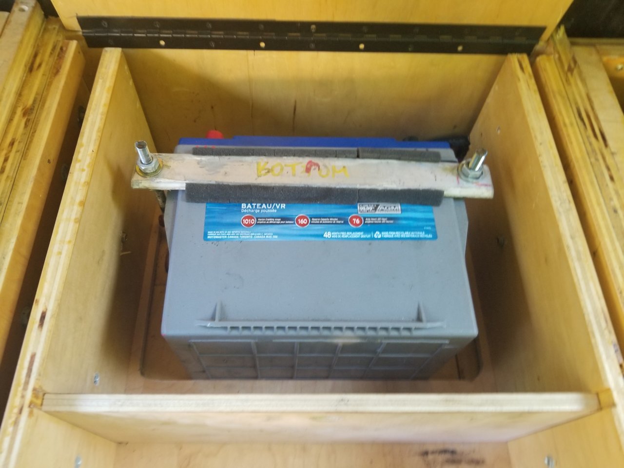

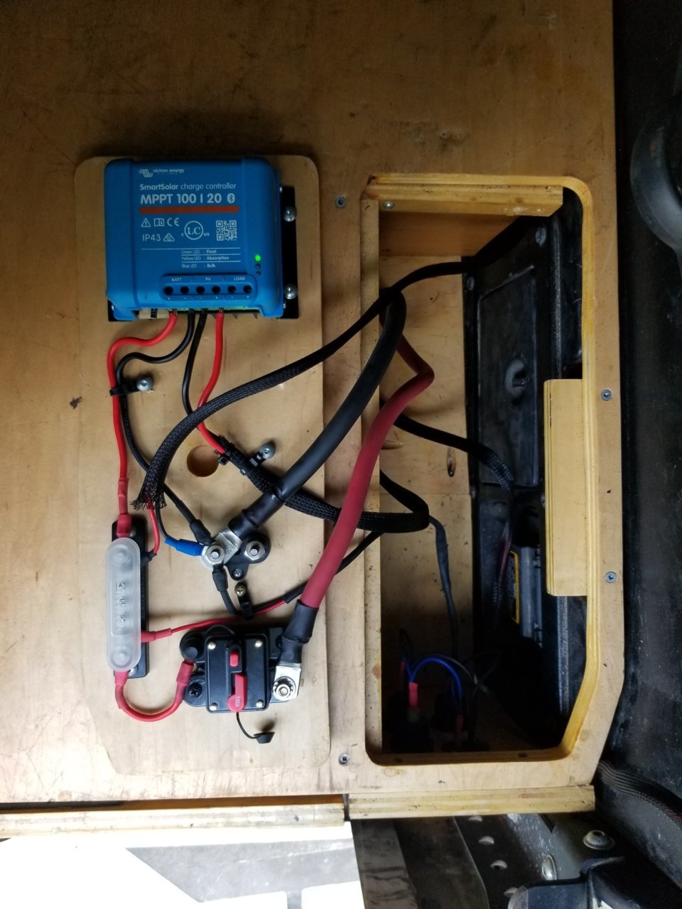

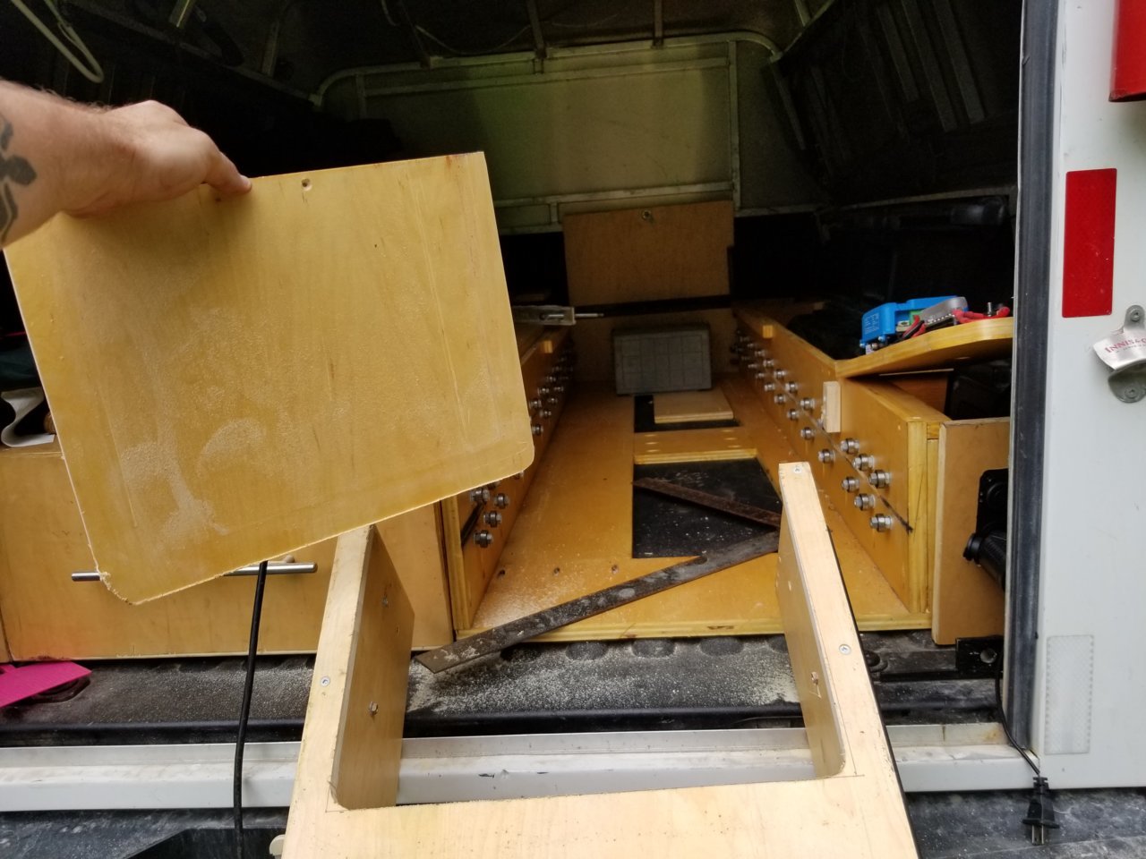

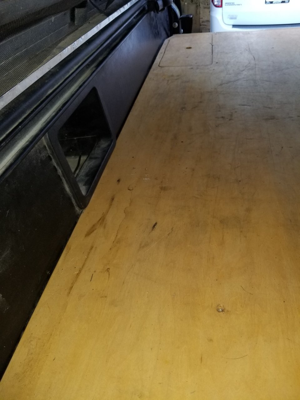

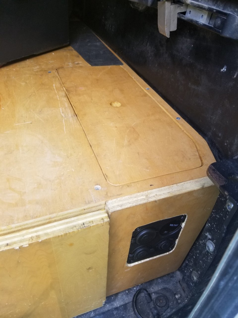

    Locating the second battery was a toss up
    A) underneath where the spare tire sits. Would need lots of fab work and couple holes through the bed. Could be prone to mud and water.
    B) In the bed drawer. Would lose a drawer of space. Fab work less.
    Opted for in the bed for being able to remove it during the winter months if necessary.
    20190806_172514.jpg 20190807_102757.jpg 20190807_171907.jpg 20190807_172107.jpg
    still need to crimp the 1/0 and wire the small 12v and USB closer to the front end of the cap where the lights will run and phones charge for the night.
    Need some ideas for storing misc crap (phones while charging) around the cap without losing space

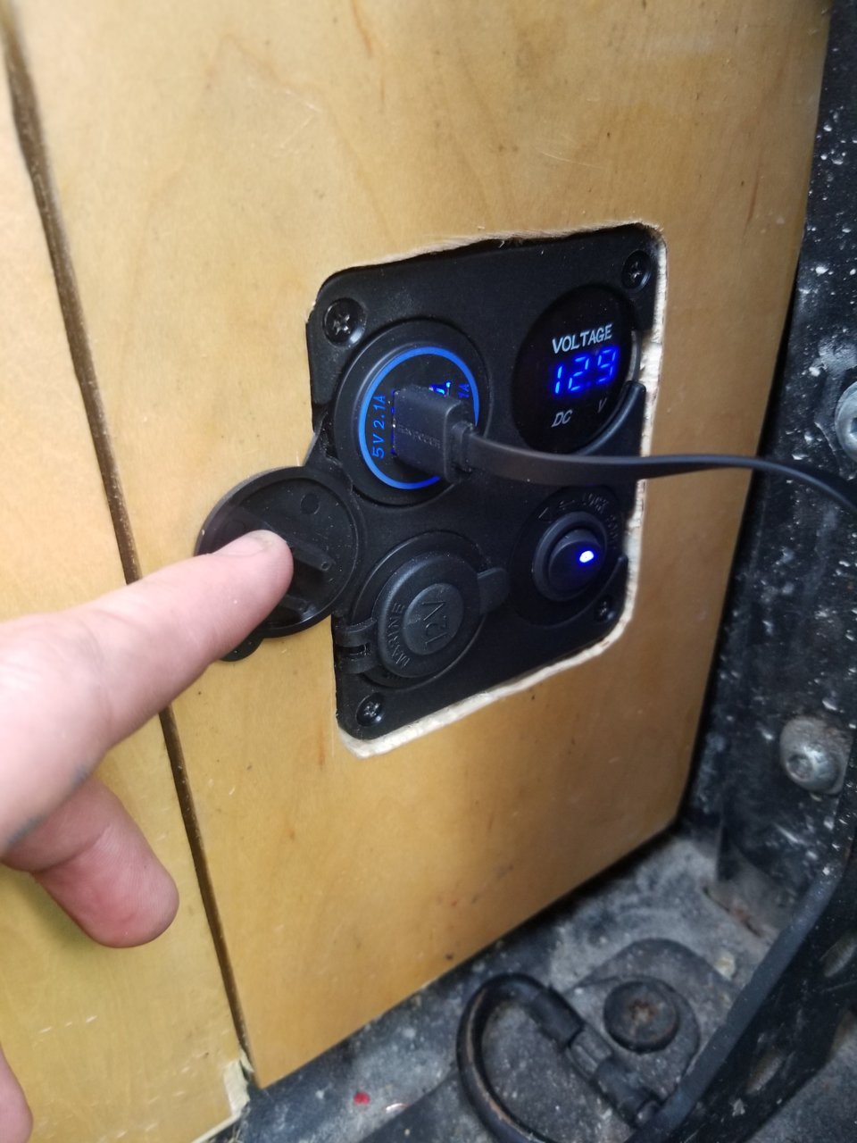

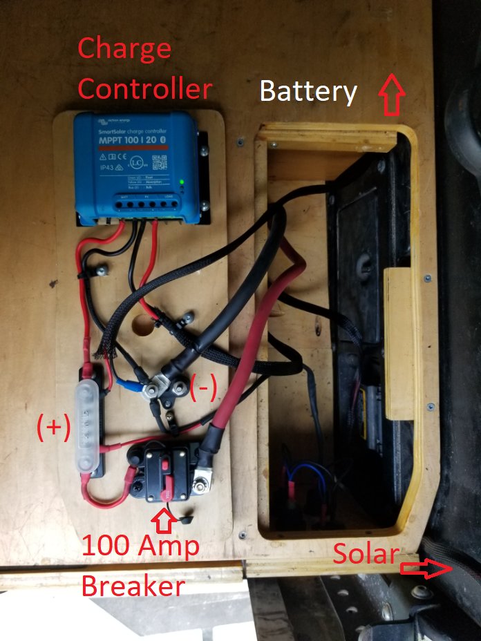

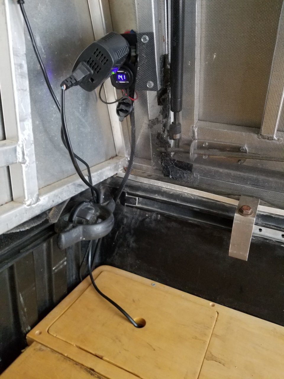

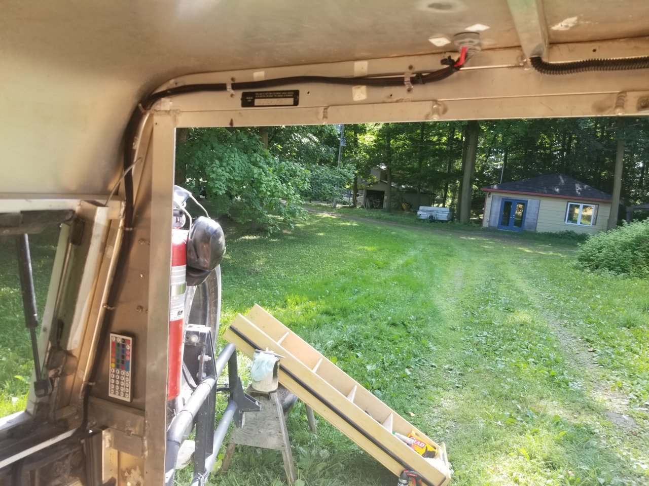

    Full solar walkthrough
    Batt runs through the cubbies
    Connects to positive and negative terminal with a 100 amp cut up. Amp breaker

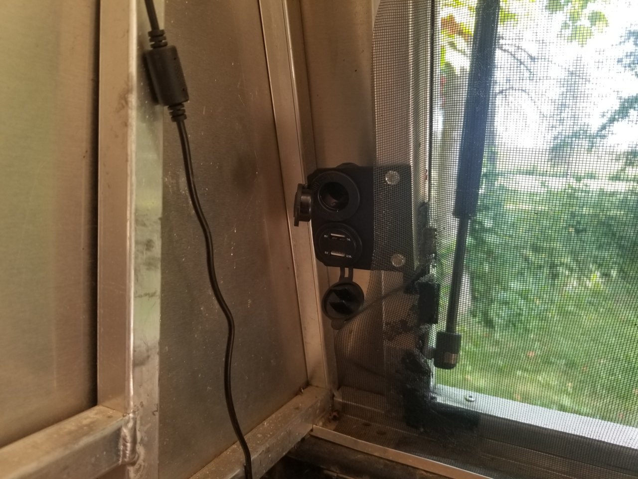

    All of that shenanigans powers these two banks. One located at the aft of the vehicle, one located towards the head of the cap, each have one 12v outlet and one 2x USB charging port.
    Next step would be an inverter of some degree. 1000w would be ideal. Future fridge in the works

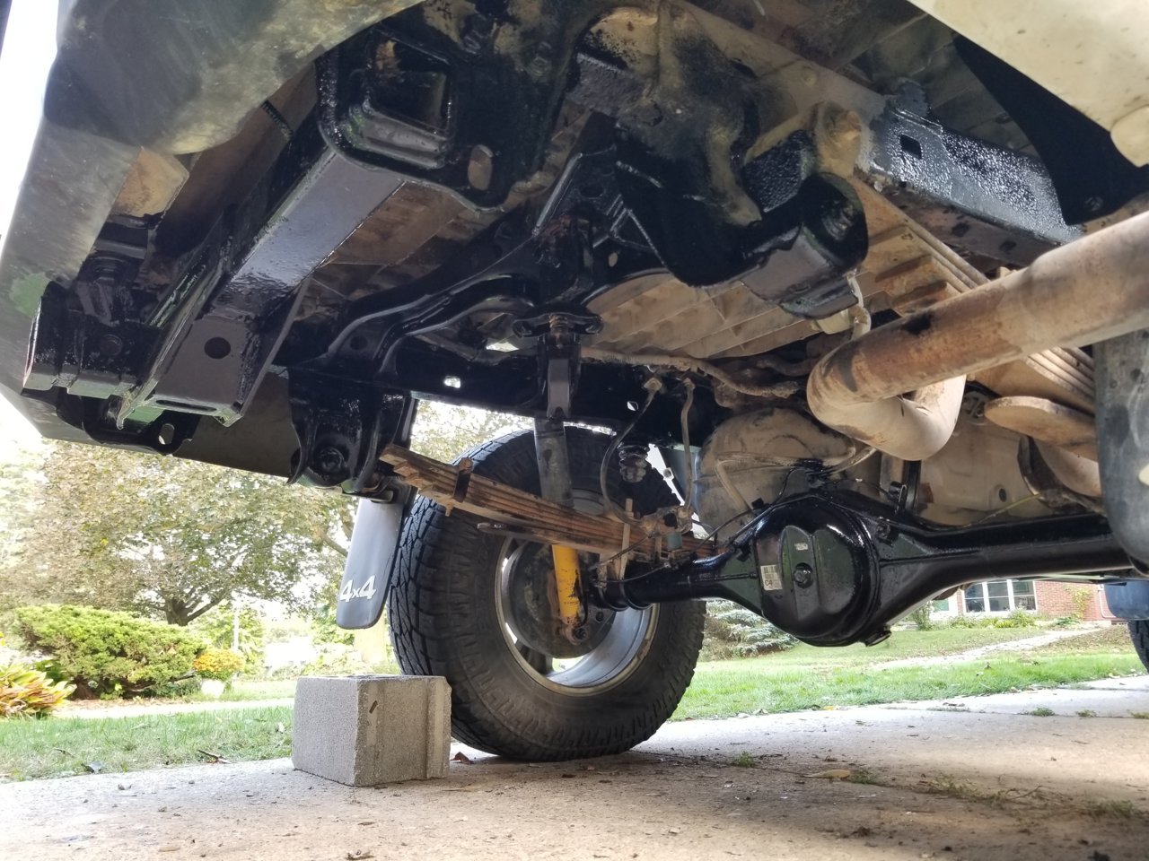

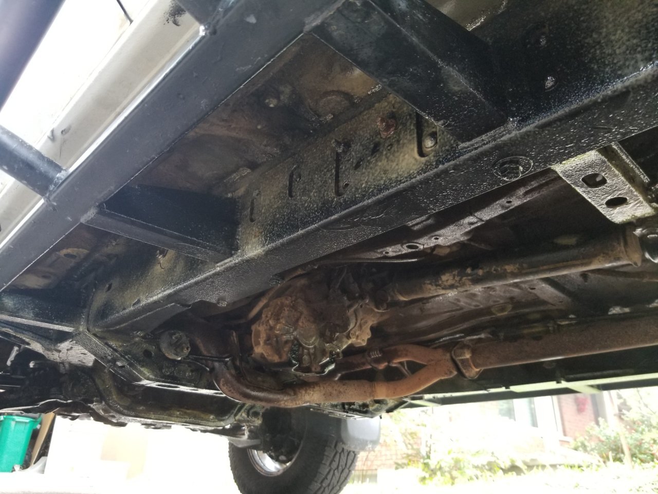

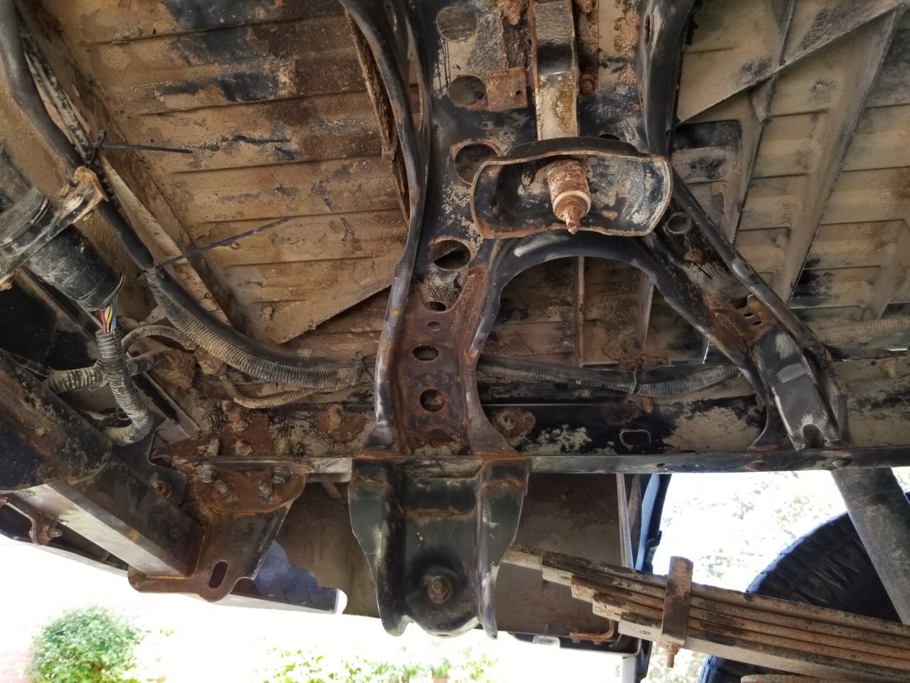

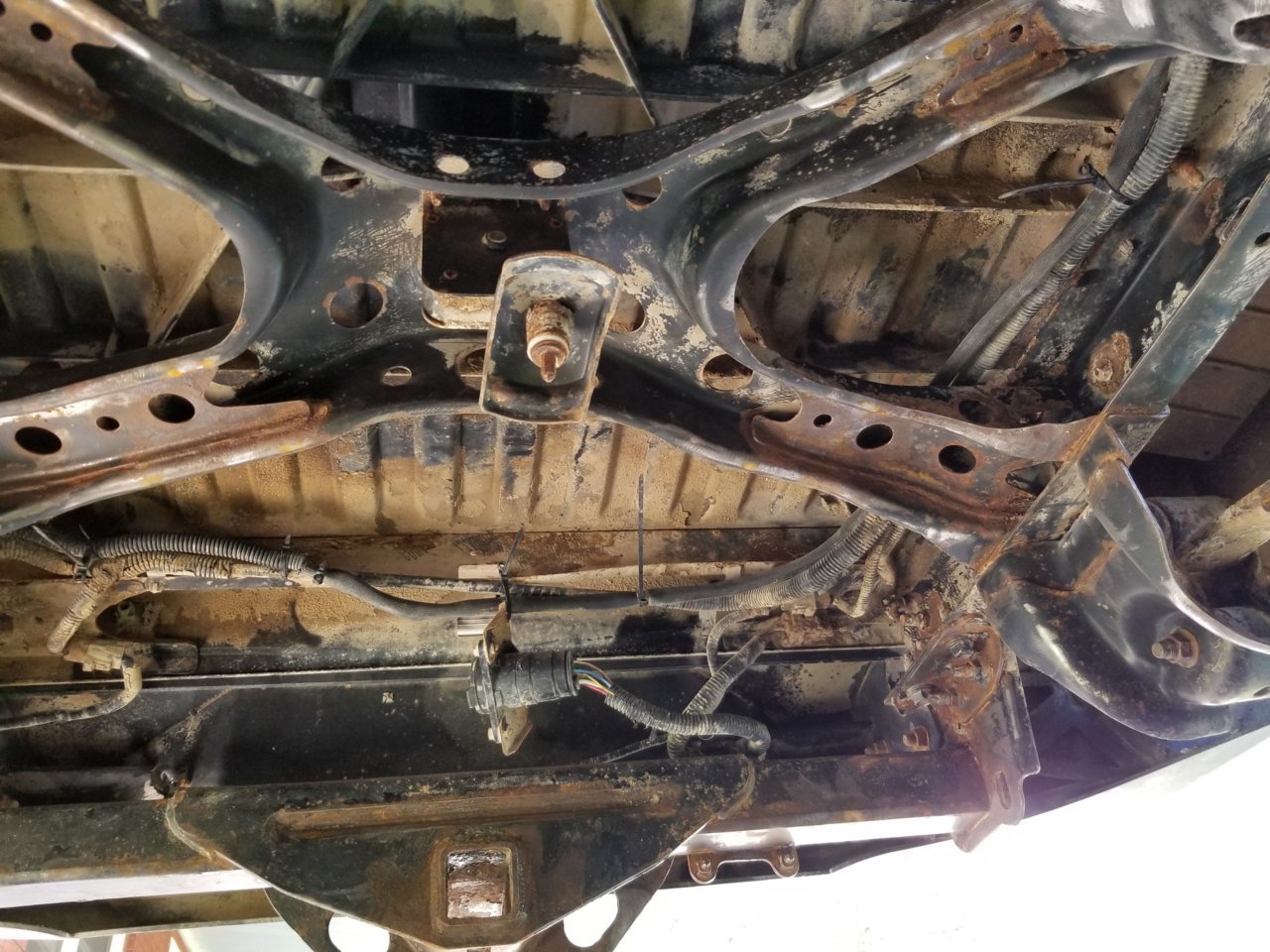

    Some much needed POR-15 pre winter prep before a fluid film party
    Work in progress...and a lot of work at that

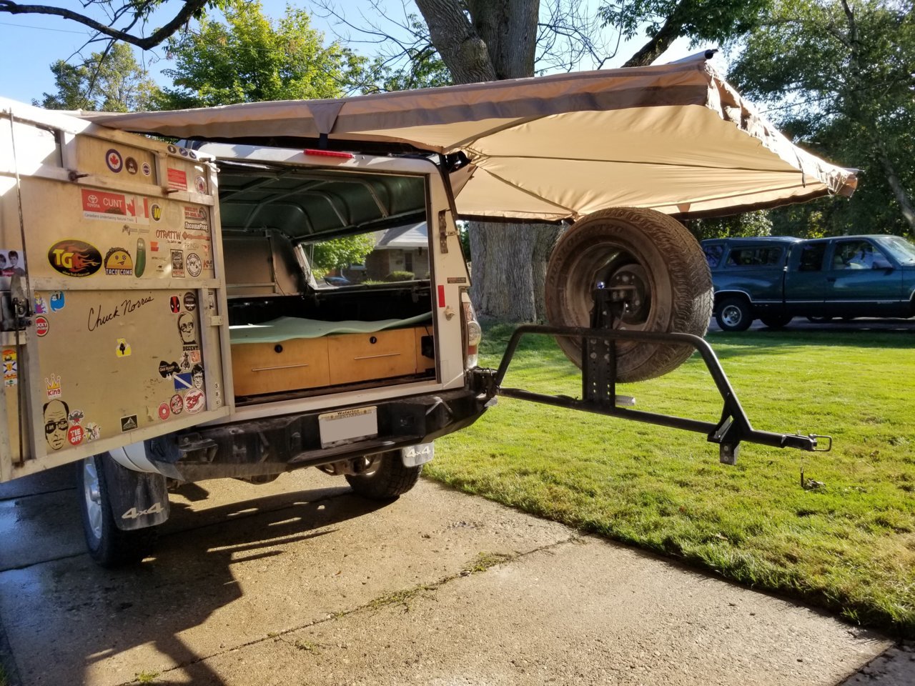

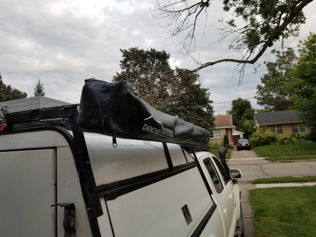

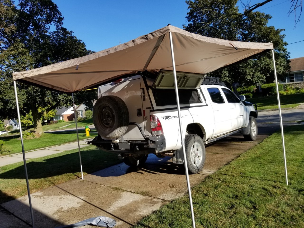

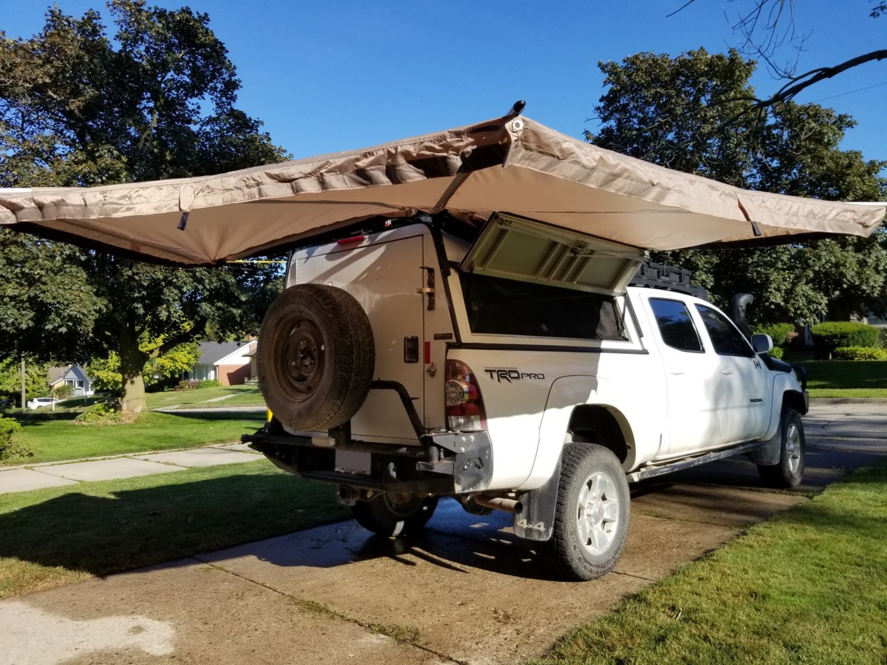

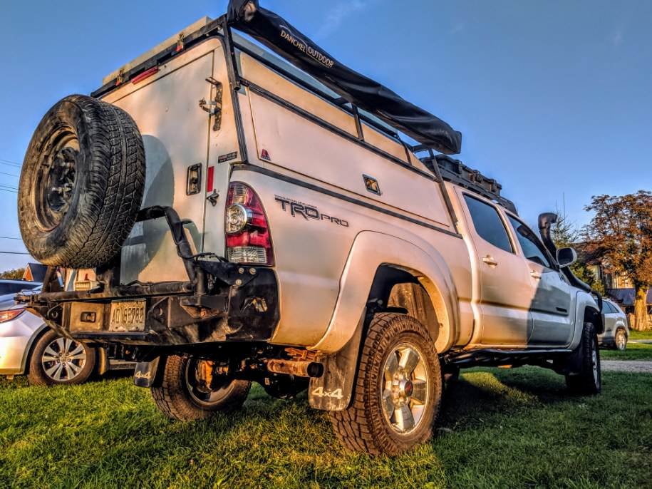

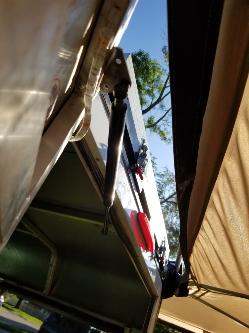

    Awning install.
    Happy with the results but have yet to cook under it.
    Bit of a gap towards the door but overall great coverage.

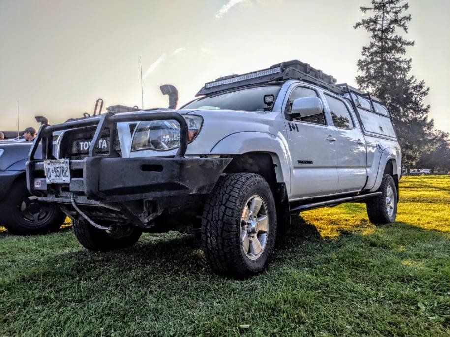

    In case you dont follow me on the gram, good little meetup today.
    Manfred.Taco

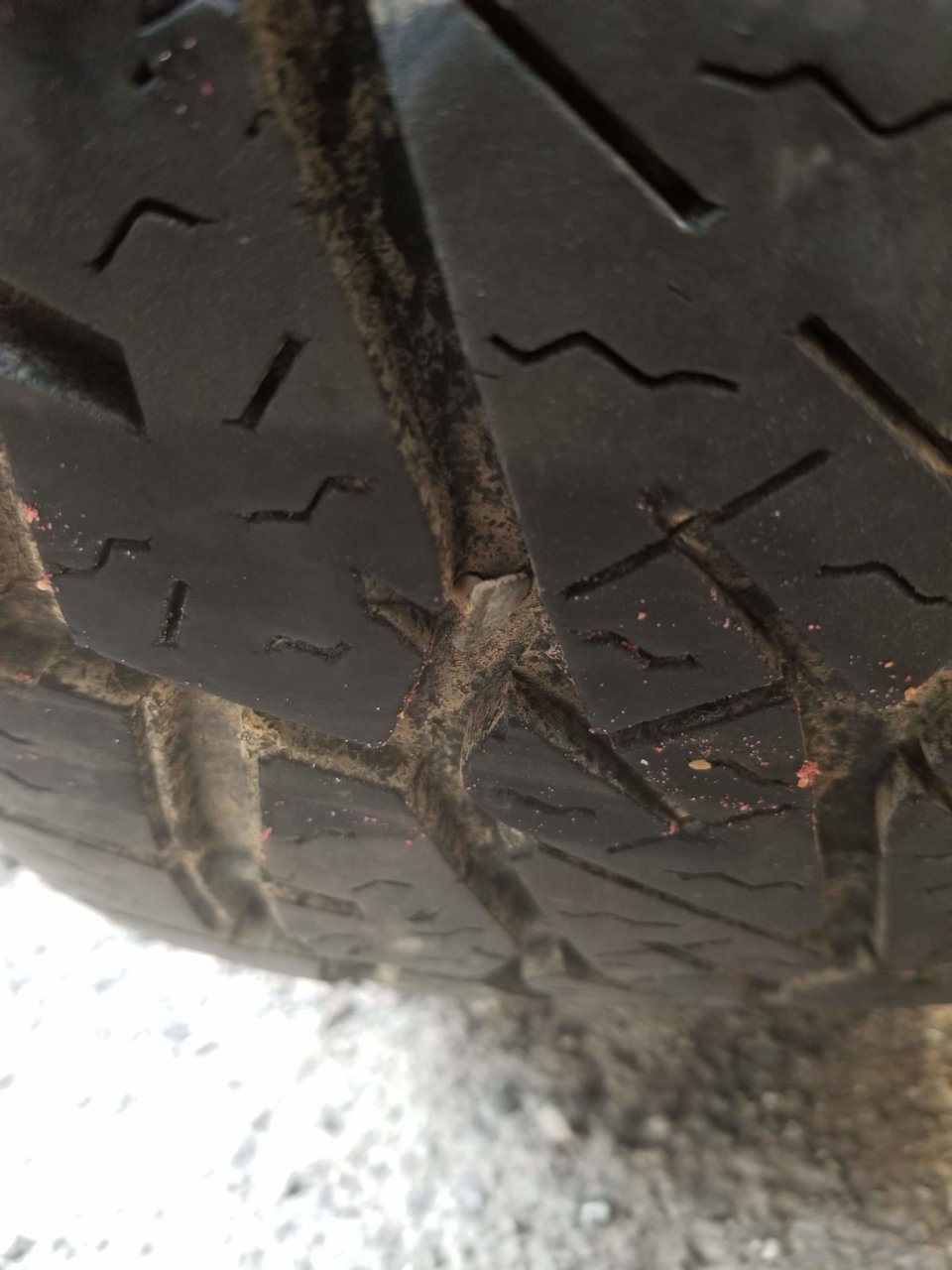

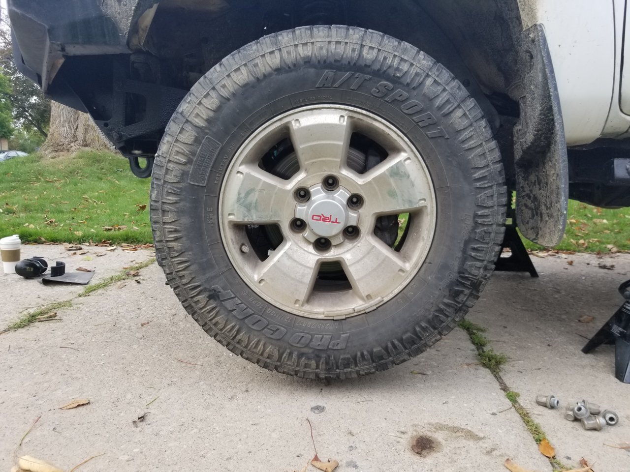

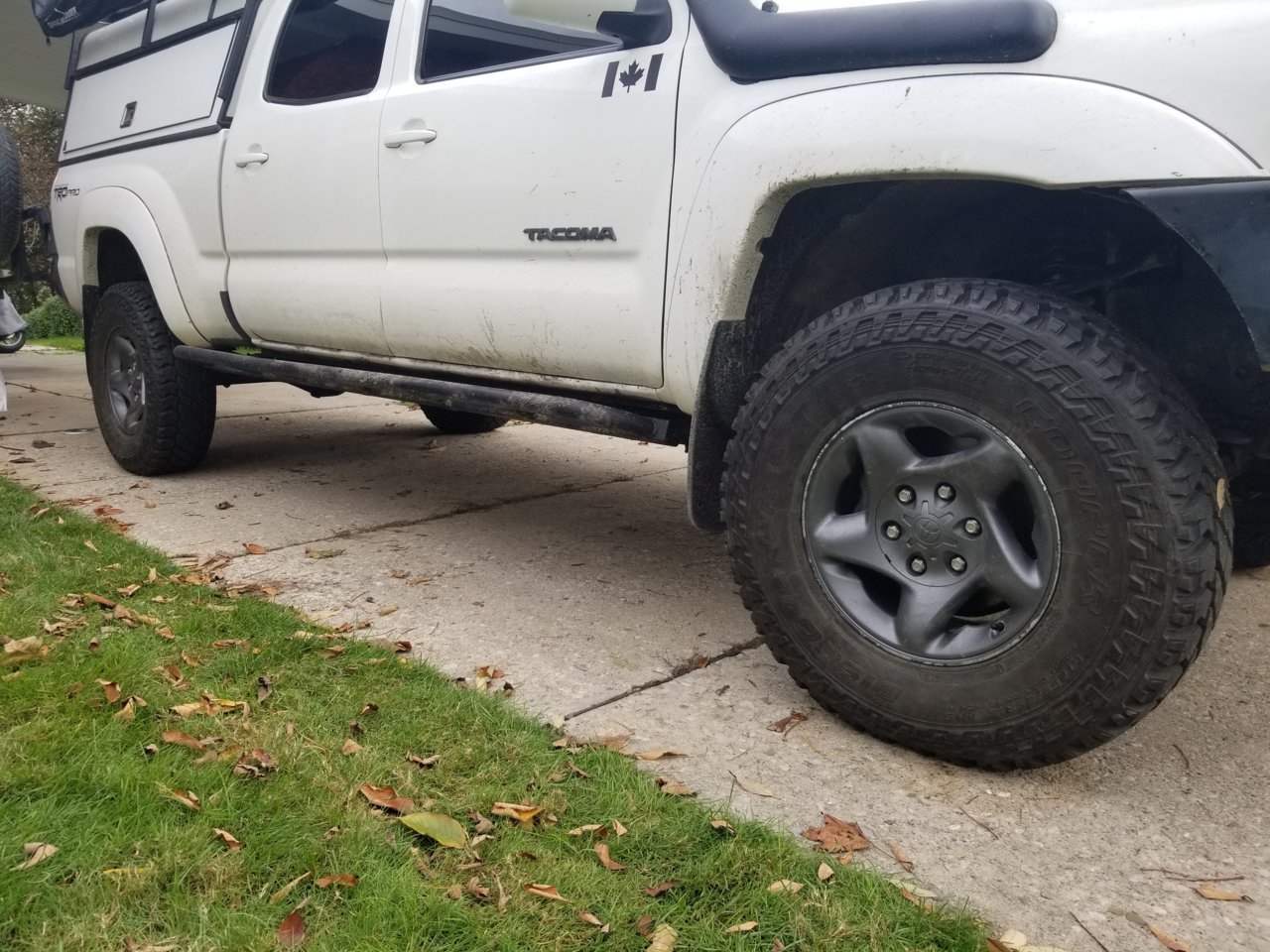

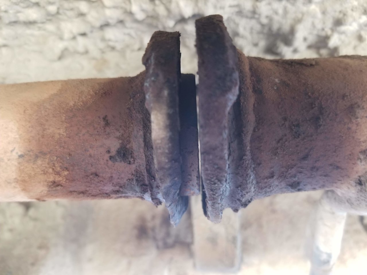

    New (ish) shoes with some rub. Thinking it's on the UCAs due to the height of the lift.
    20191007_100323.jpg 20191007_100611.jpg 20191007_100413.jpg 20191007_112440.jpg
    Need to re apply some fluid film after ardbeg towards the front end (@Norilsk you were right) and start the winterizing of the camper.
    Battery out, solar off, awning stored and possible removal of the cap in place of my tailgate and tonneau cover

    llamasmurf
    llamasmurf Herpa Derp
    Mar 1, 2016
    #179866
    5,187
    Wes
    Northern Ontario
    '15 Matte Black TRD AC
    FJ t-case with twin sticks, UTE bed, some other things :D
    Love them Coopers!
    Dont think I could have picked a better tire and size for my 1st set after I realized what garbage the stock rugged trails are.

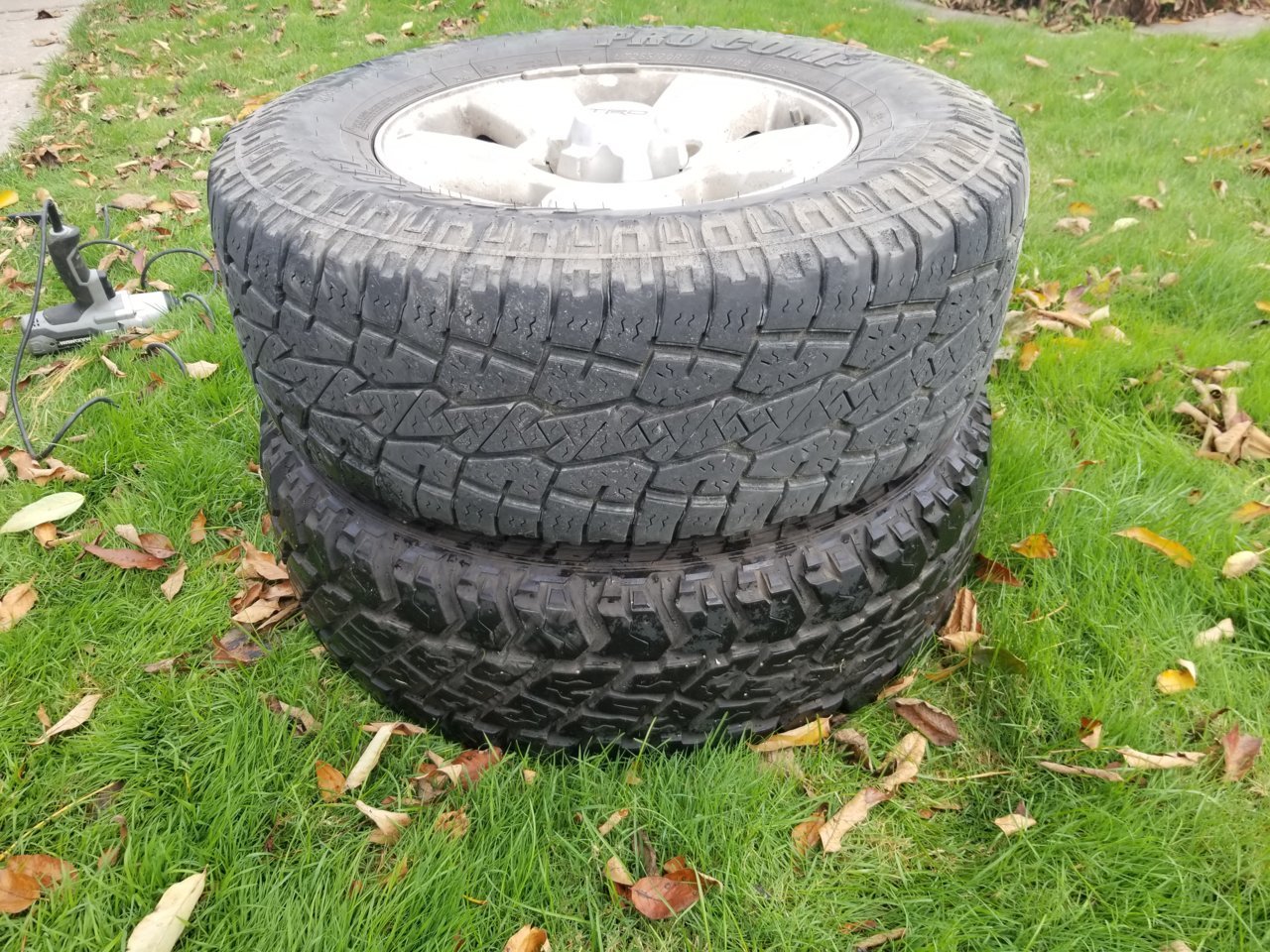

    Well I'm thinking about switching my 17s to a passenger highway tire and have these 16s as a dedicated trail tire. Might be over doing it

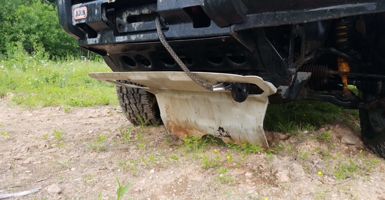

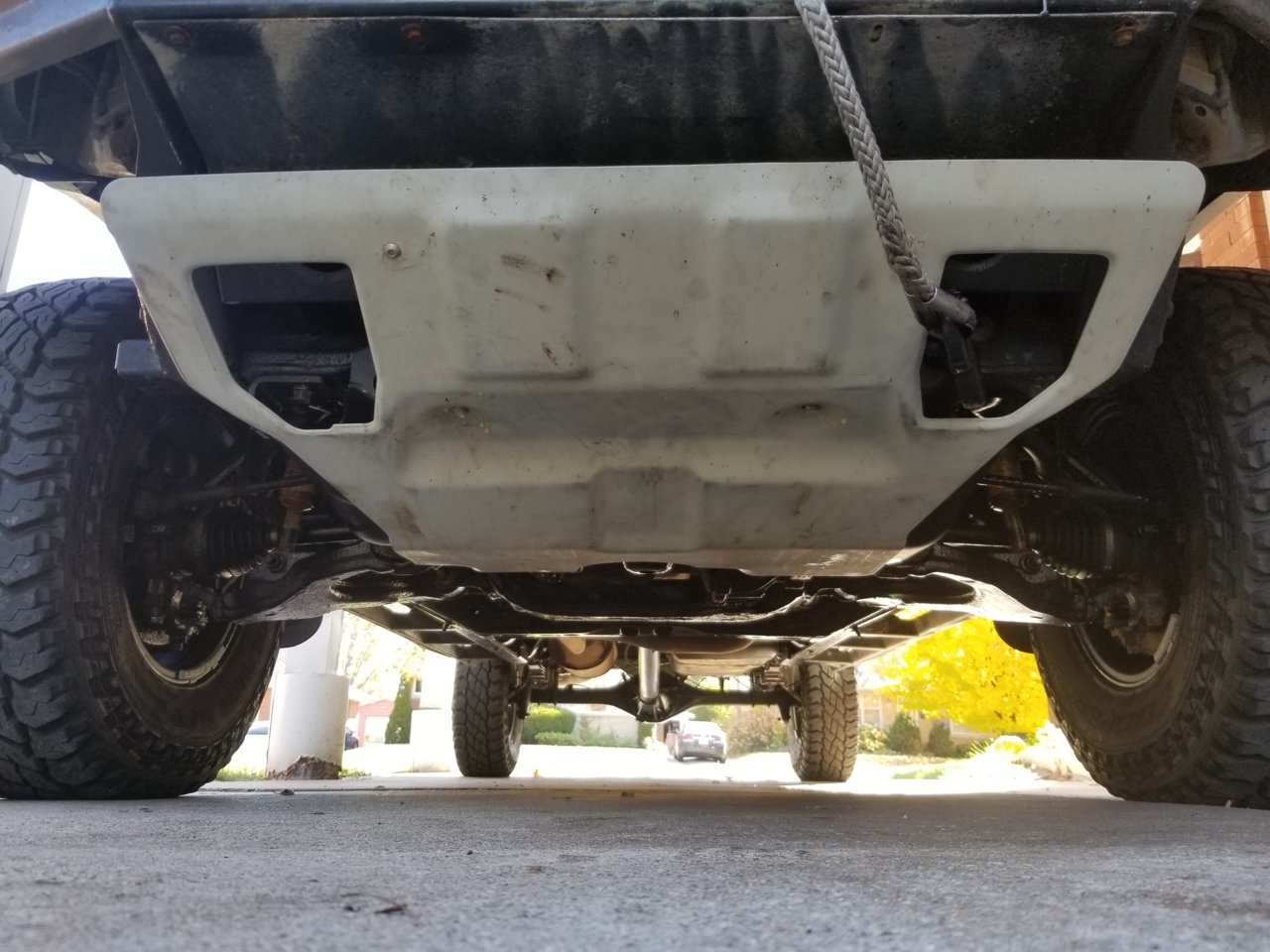

    Skids back on thanks to @bigmw for the hookup
    Still looking for a well priced full set in steel and have to deal with some CB shaft shudder but that's a later problem.
