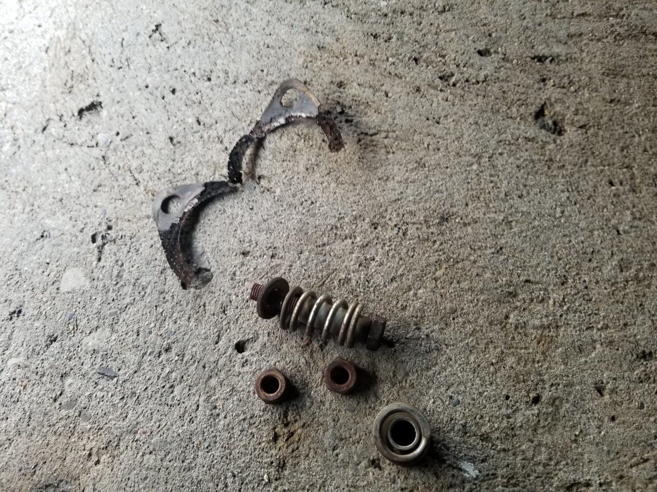

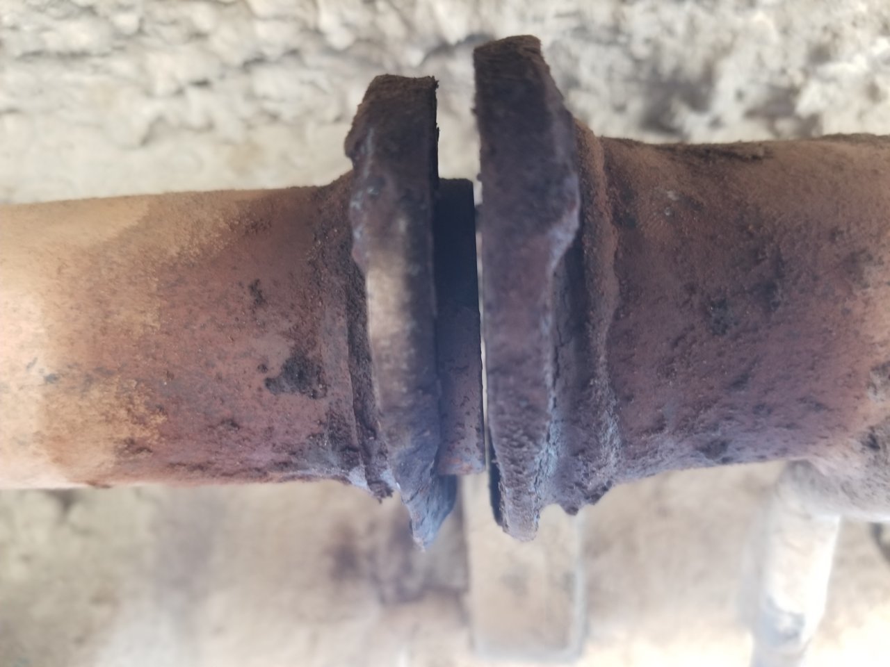

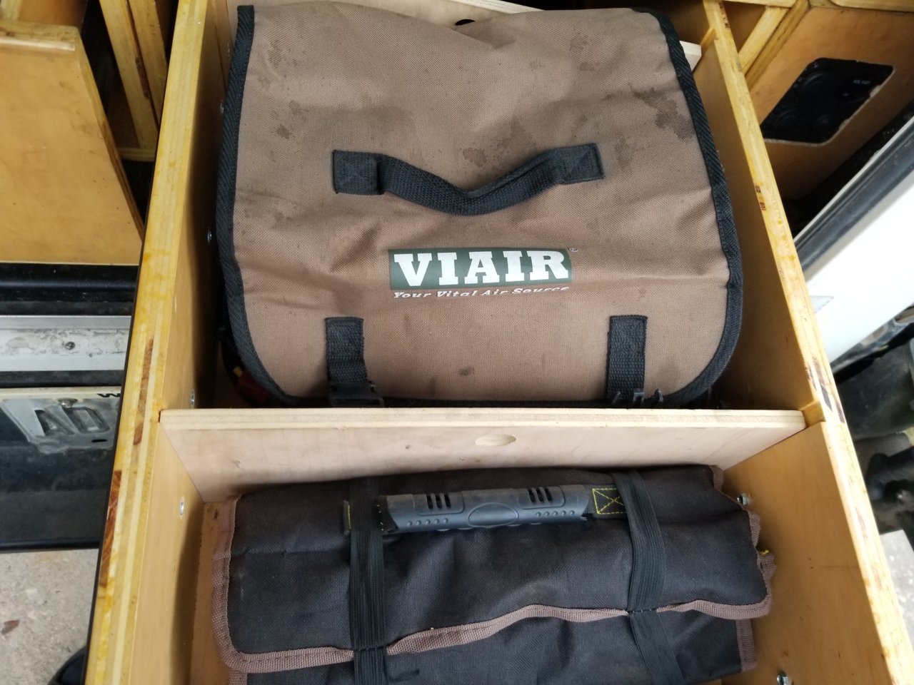

    Added Vlair 88P compressor to the recovery equipment list via a former member @Therby thanks again

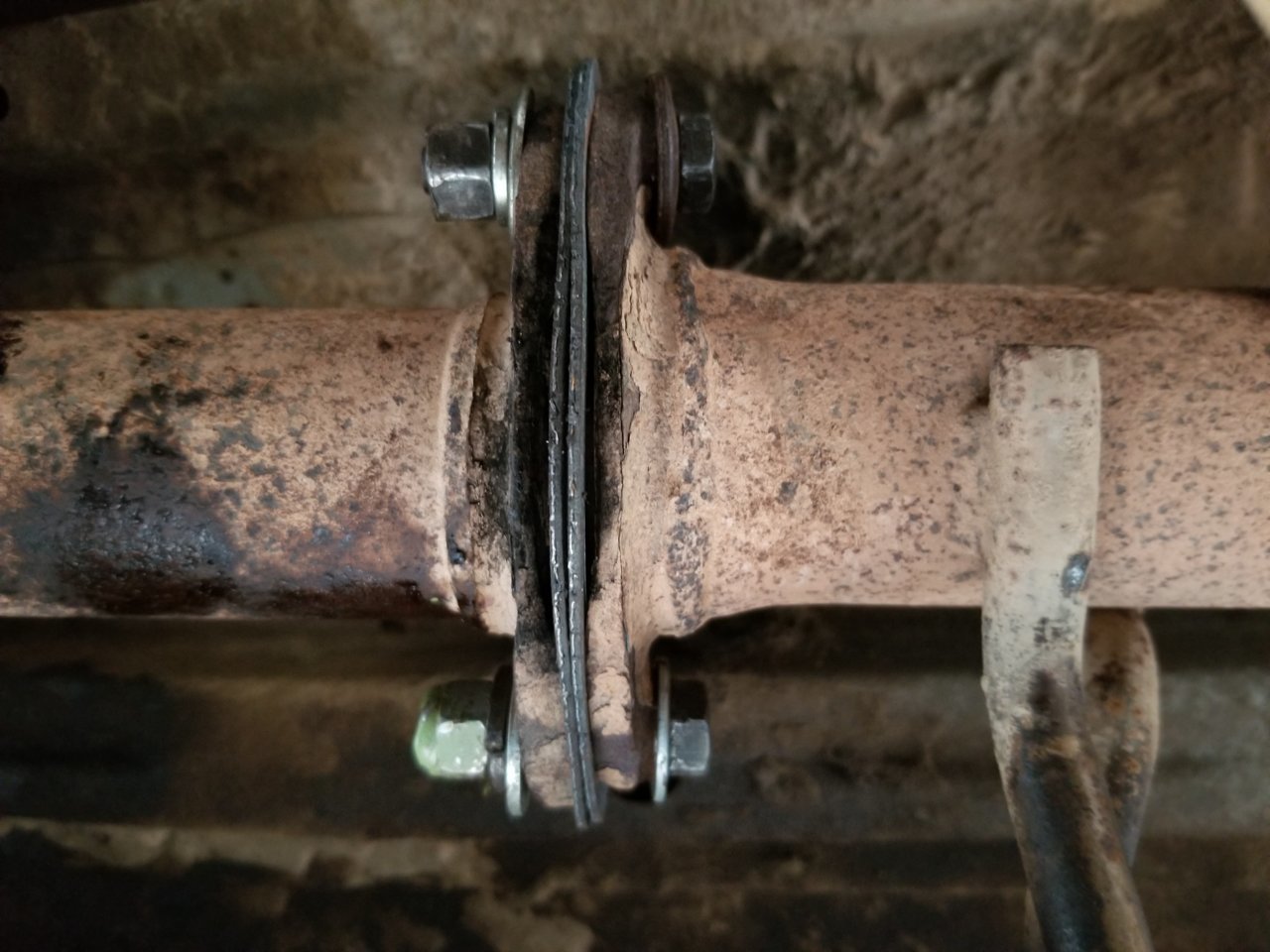

    Doubled up on gasket replacement but still pumping out some loud sound so I'm out of ideas.

    Checked the headers or muffler? I say just straight pipe it....most logical solution. BRAP BRAP:mudding:

    The sound is definitely coming from there. Can hear and feel that output of air slipping past the gaskets like a fart.
    I could brap brap but repairs would be a pain in the dick. Ever heard of high temp gasket maker? Someone else suggested that

    Have you cleaned the surfaces prior to using the gasket?

    Well ya. Some 80 grit but even still this is the mating surface in question

    Mating surface? Not much of that left lol

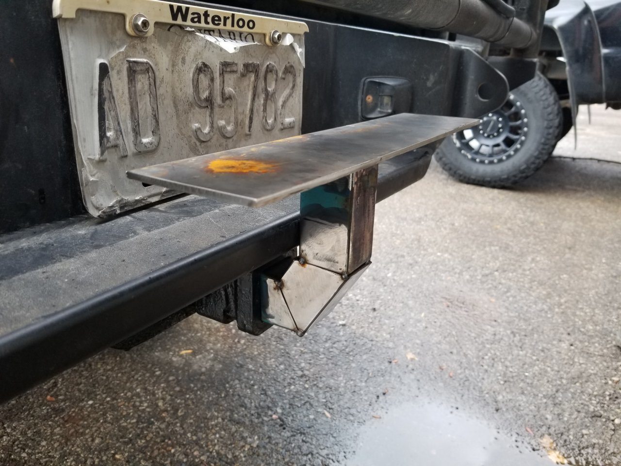

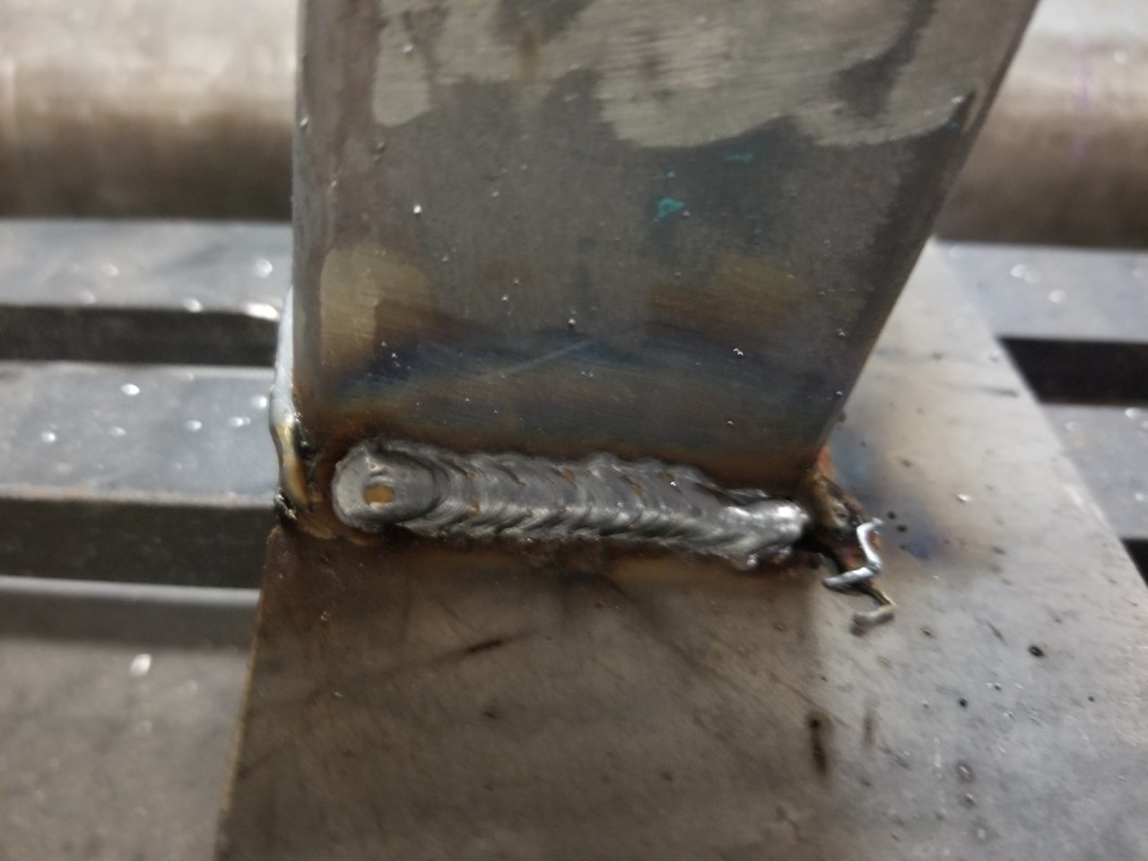

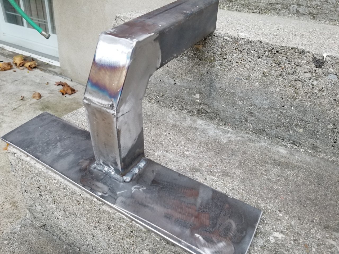

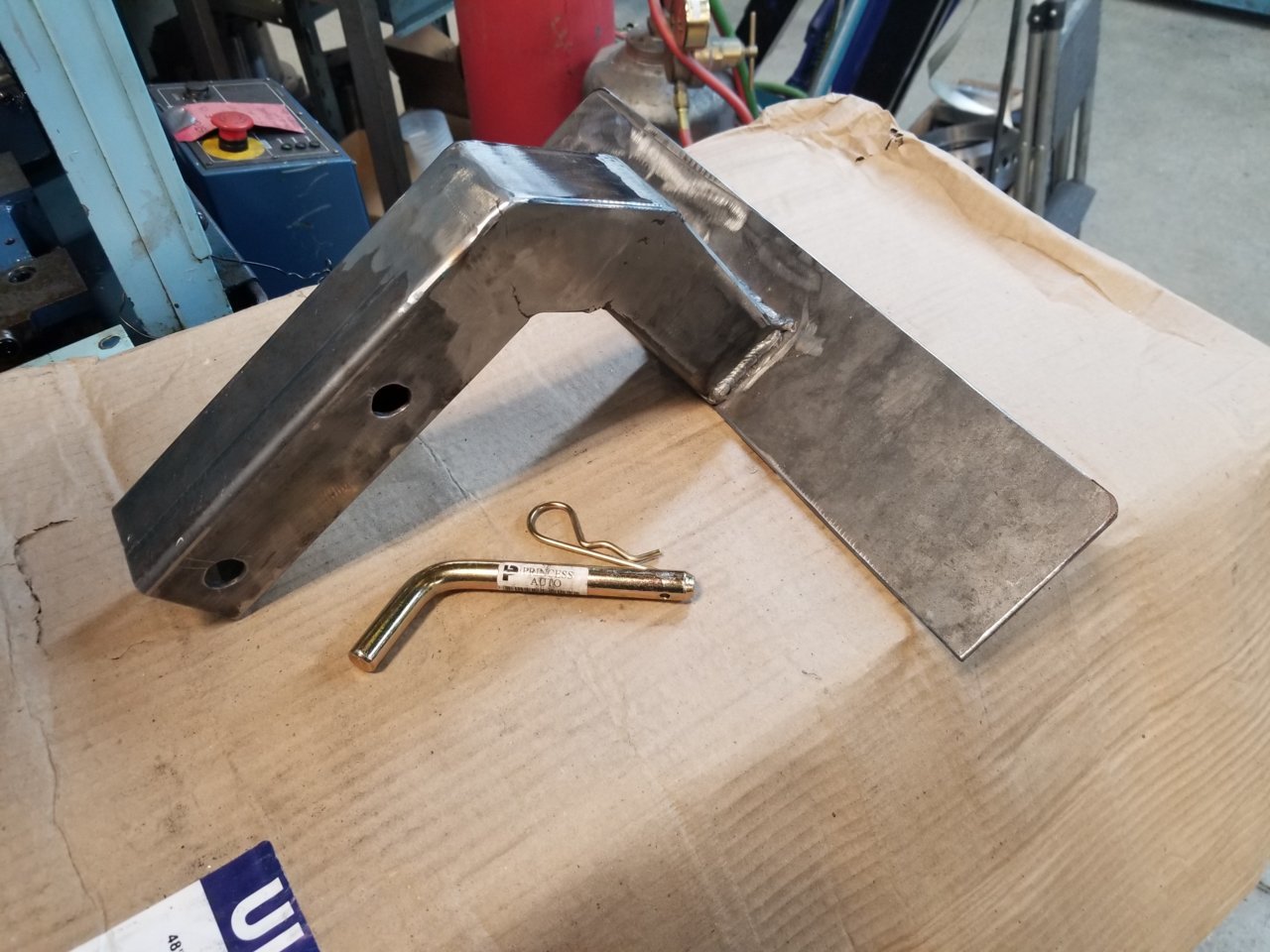

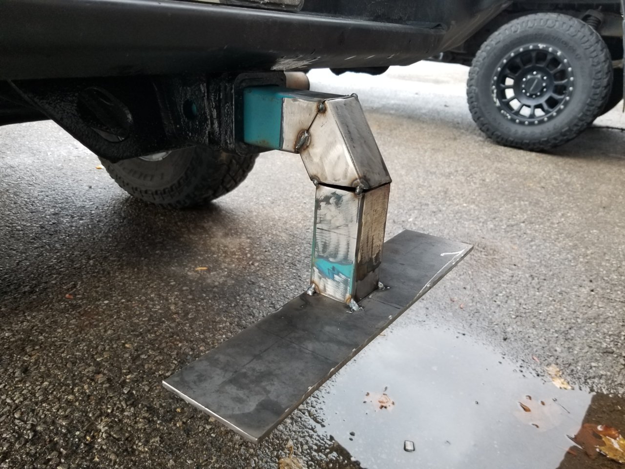

    Quick fabbing of a hitch step with @tgelata who I borrowed the idea from @Canadian Joe
    Leaving it tacked for now to see if I should change anything, like lowering the base plate in line with the bumper as it's a little high up.

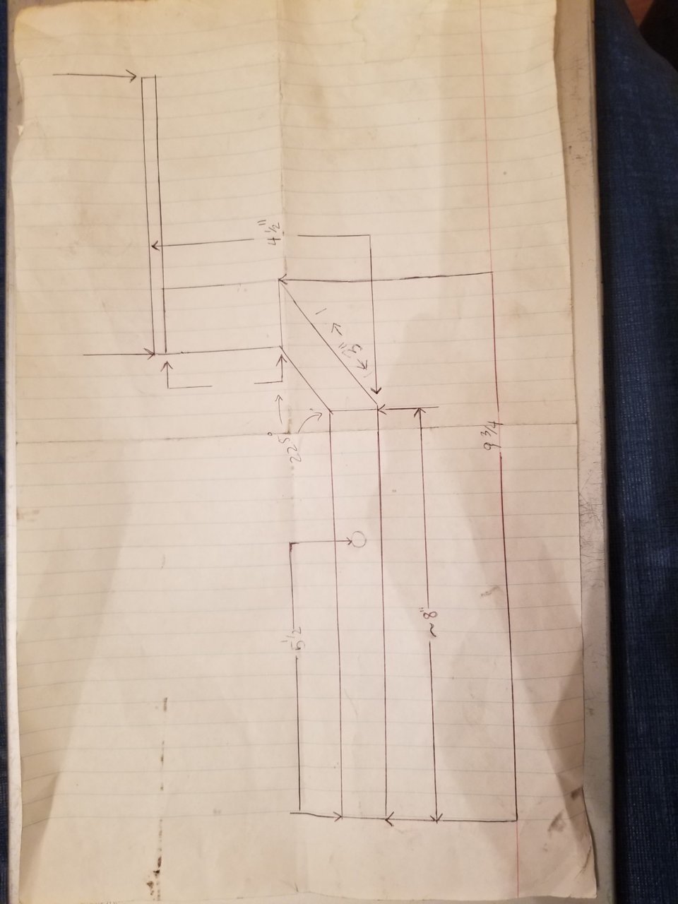

    Plate made out of 3/16" and 2" scrap tubing.
    If anyone wants to use these measurements, go to town. Angles are 22.5°

    Right! I'm thinking the pipe is just rotten lol

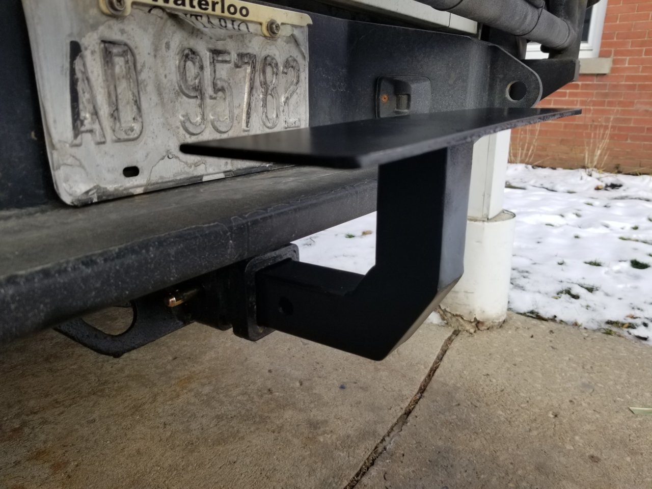

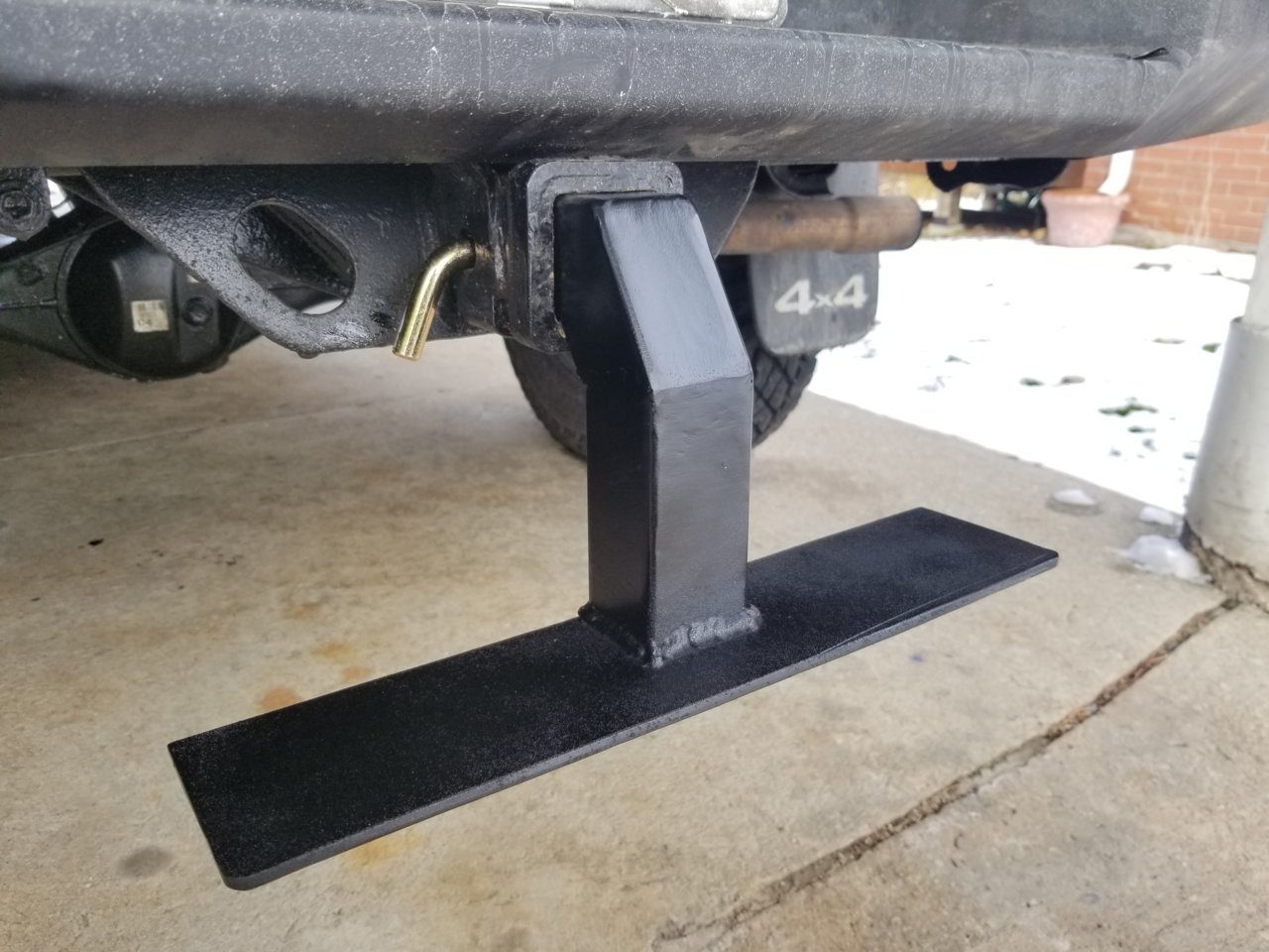

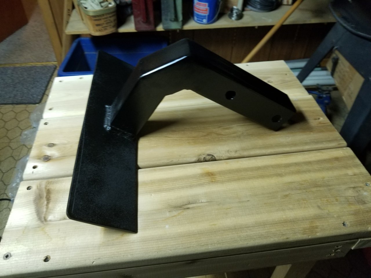

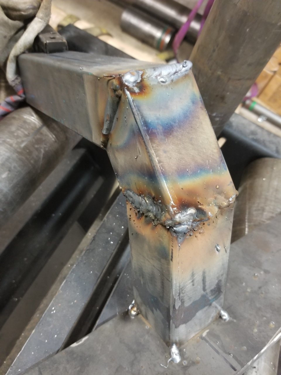

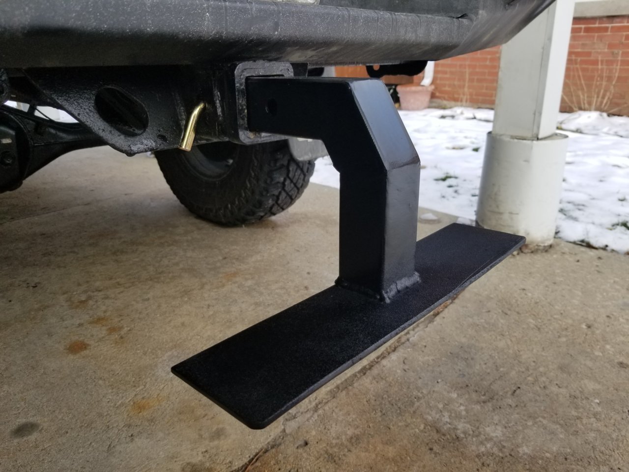

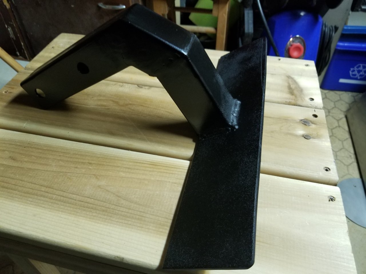

    Inspired by @Canadian Joe I used some scrap metal from work thanks to @tgelata
    IMG_2565.jpg 20191102_151816.jpg 20191102_151830.jpg 20191104_171328.jpg 20191104_171340.jpg @tgelata did these:anonymous: just saying... I did the rest lol
    the 225lb test
    20191110_153633.jpg 20191115_171117.jpg 20191115_185442.jpg 20191115_185454.jpg
    Added some sandblasting sand with paint for a donut yourself grip tape 20191115_185529.jpg 20191116_133109.jpg 20191116_133143.jpg 20191116_133200.jpg
