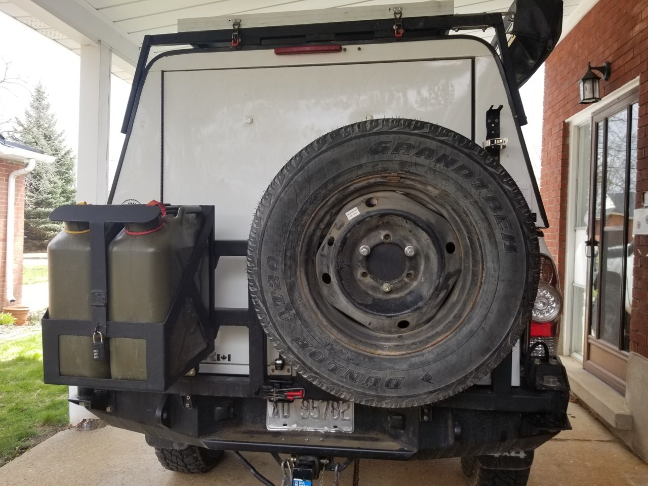

    All of them

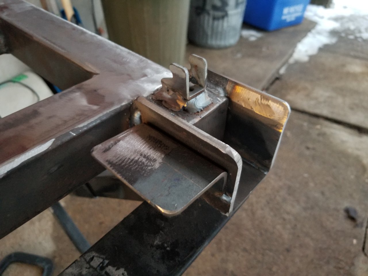

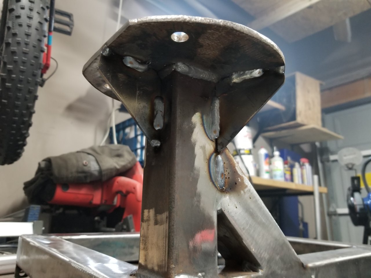

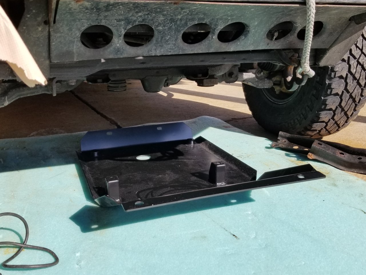

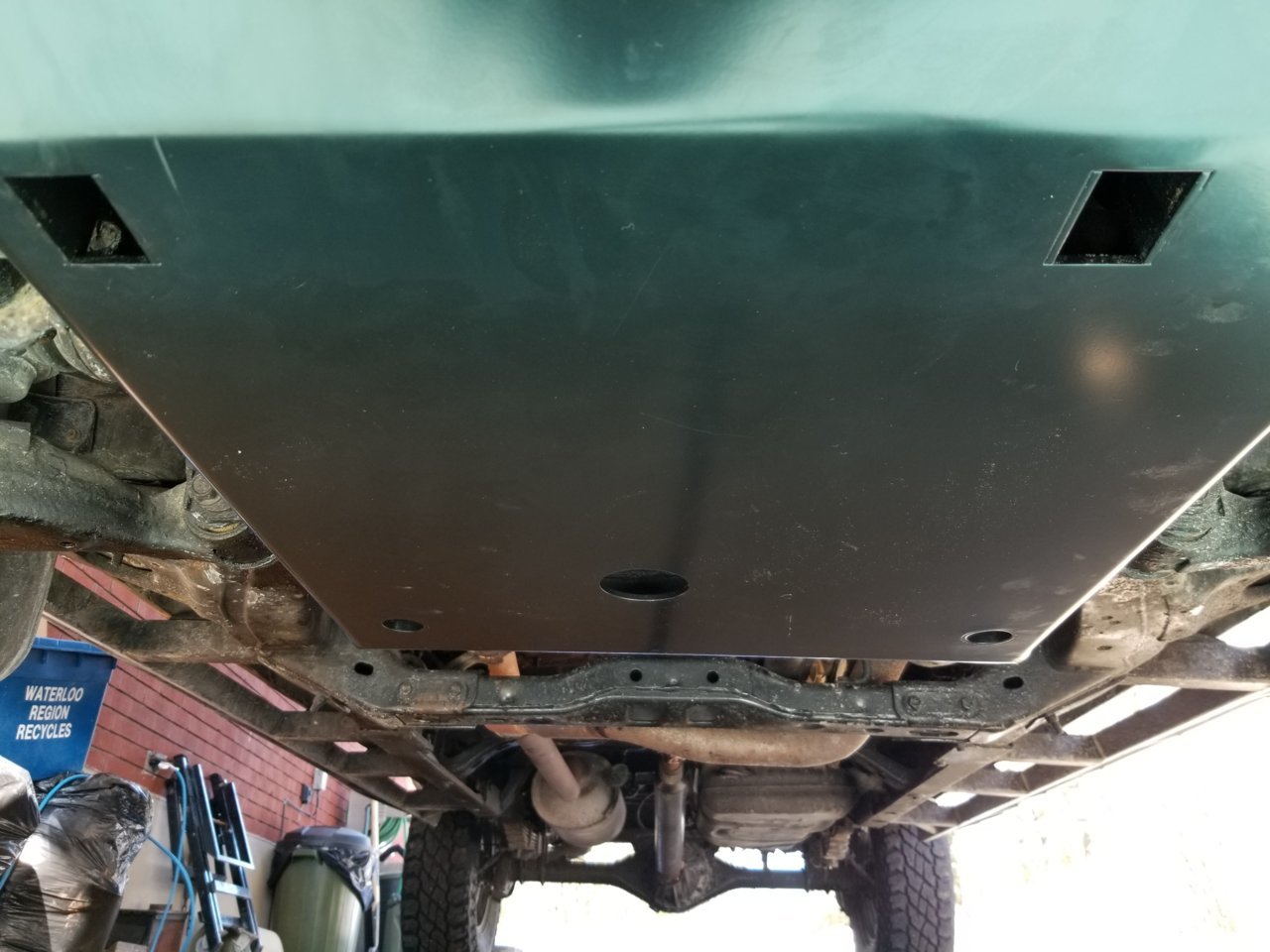

    New skid who dis?

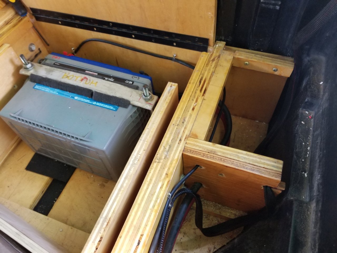

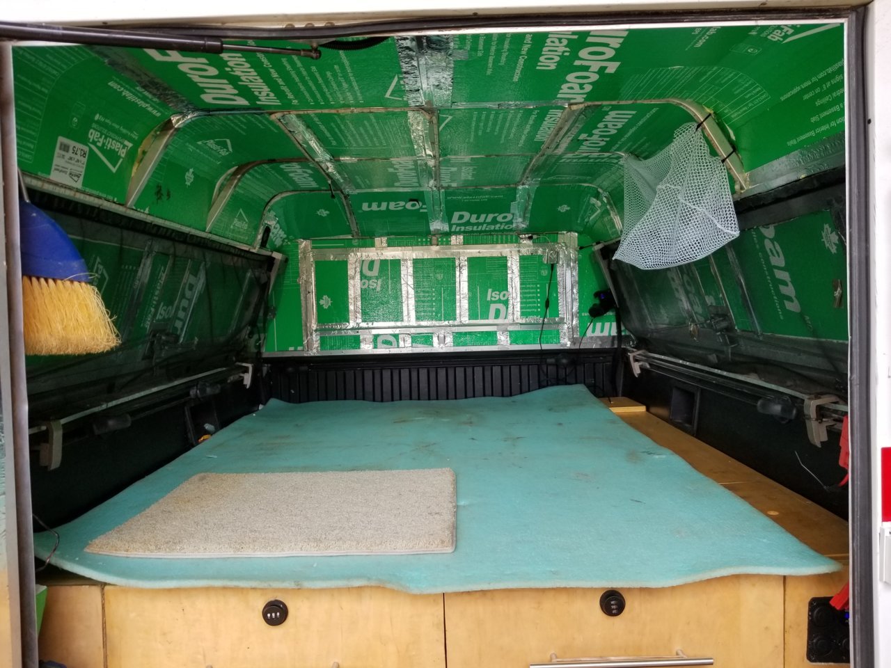

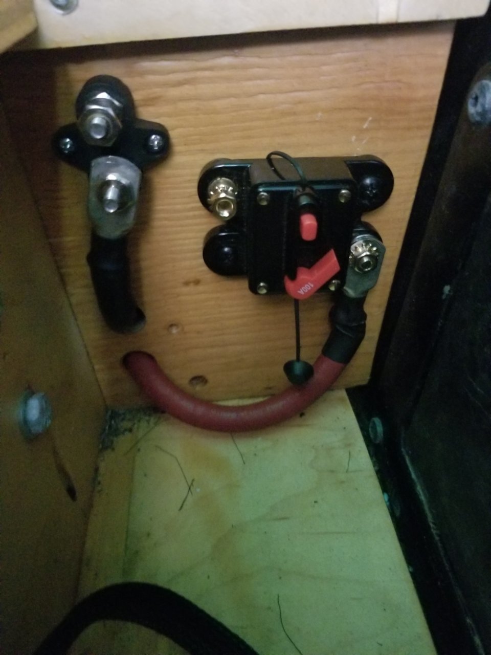

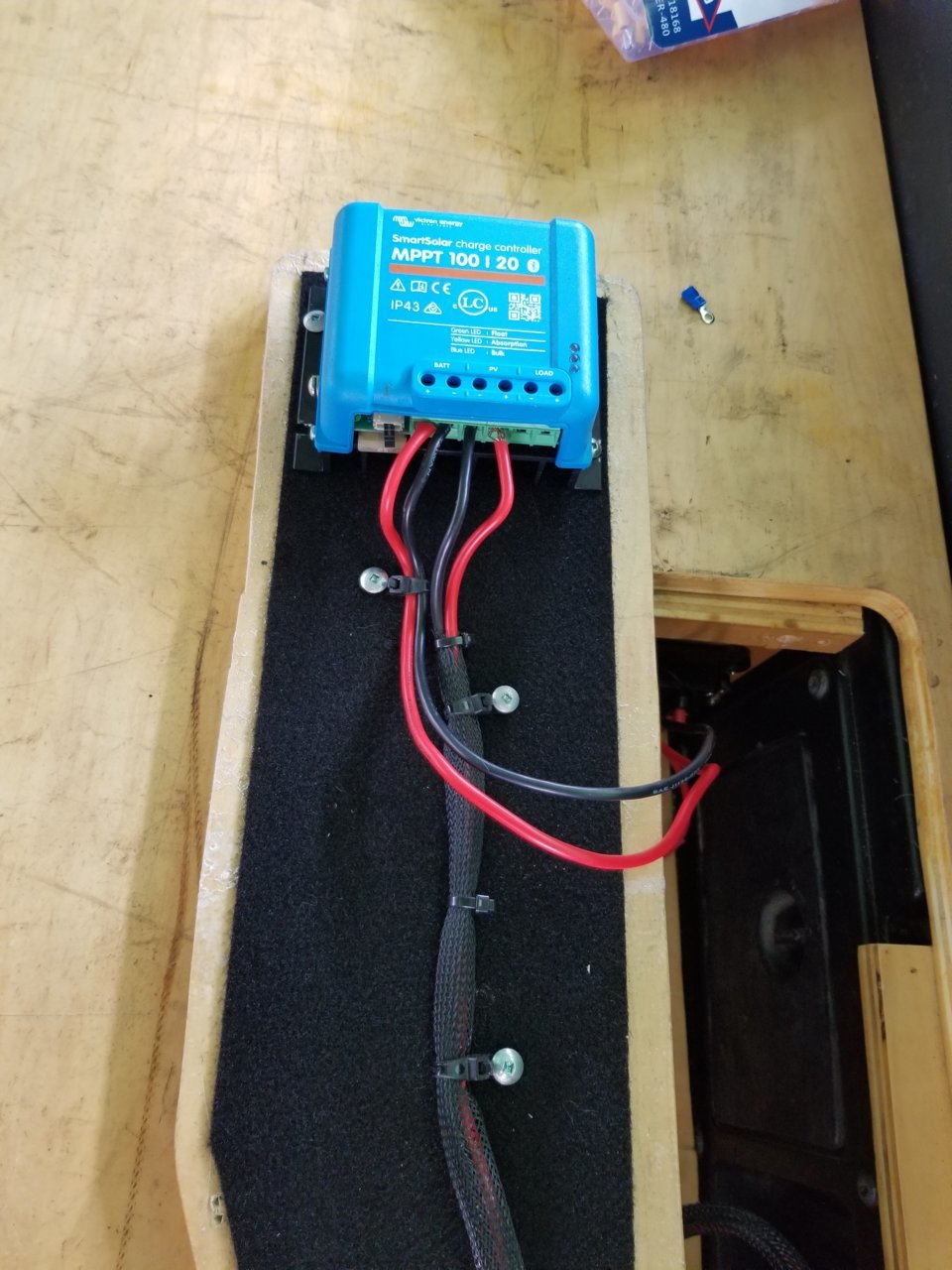

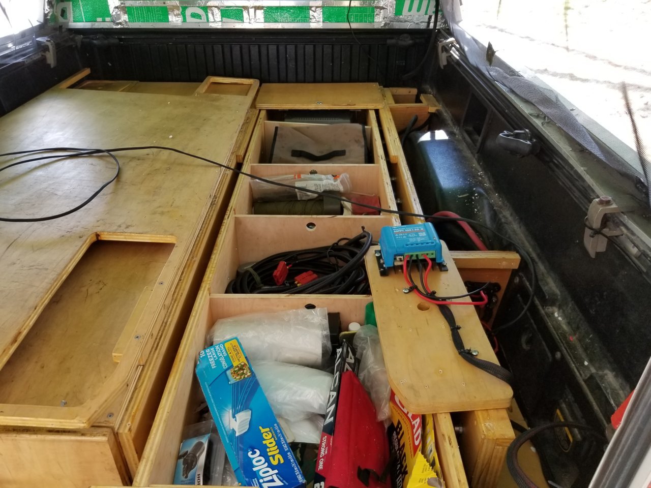

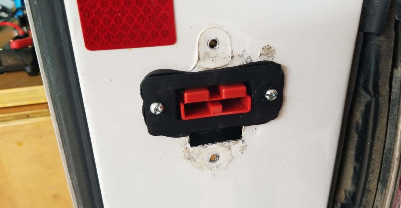

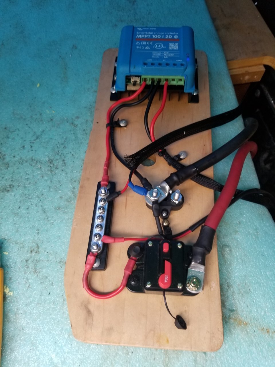

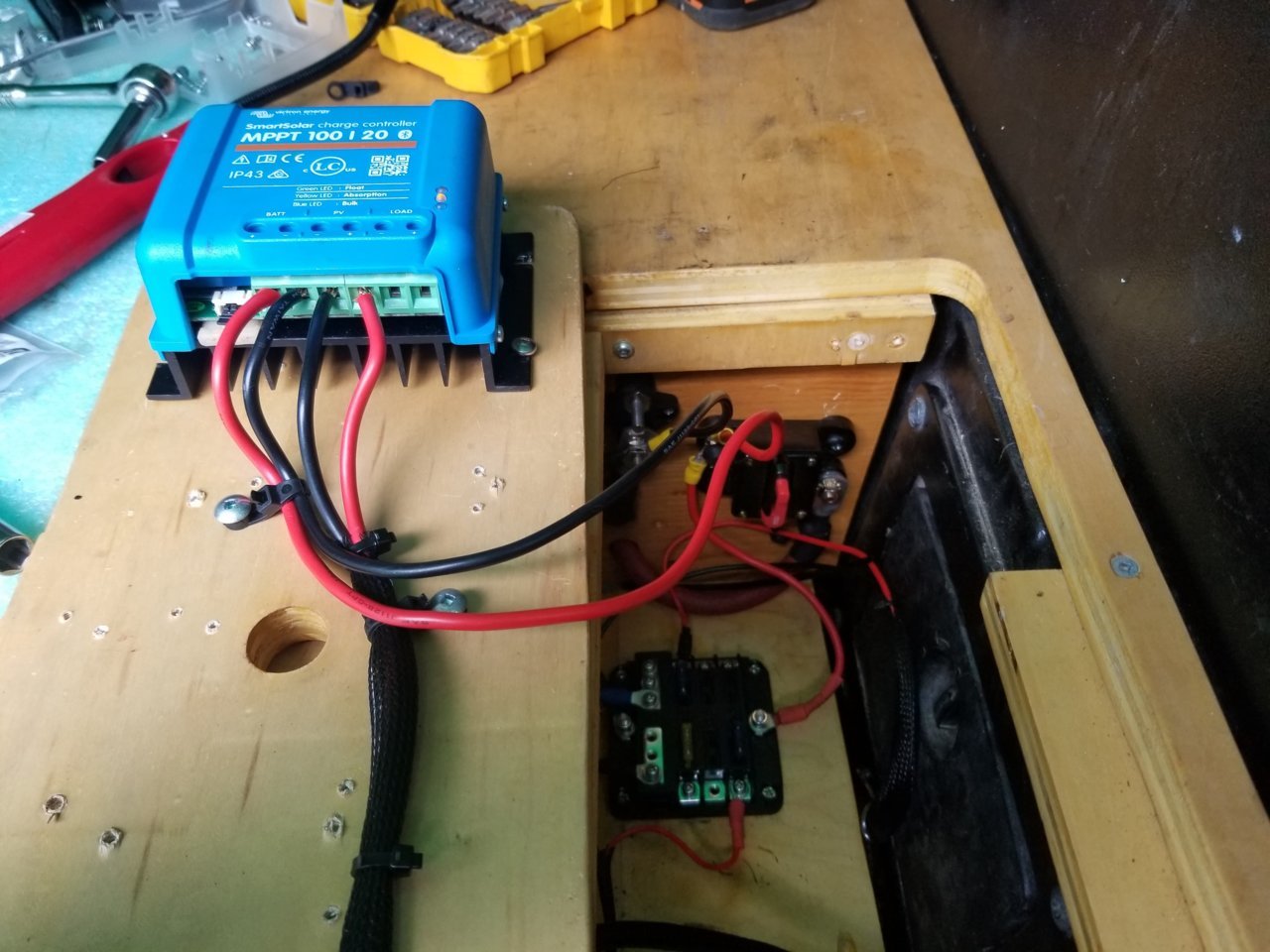

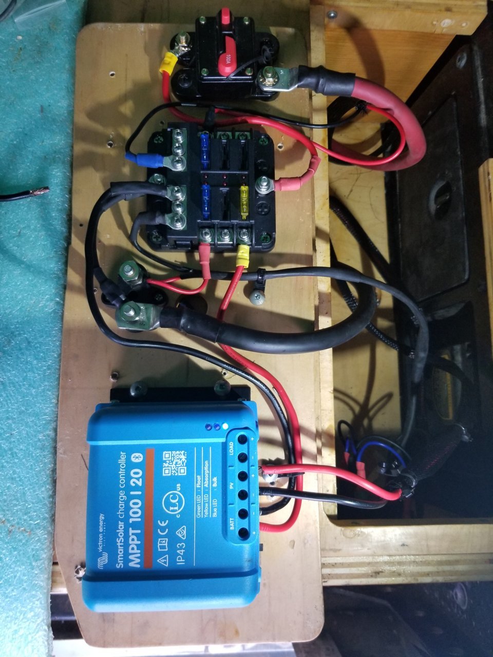

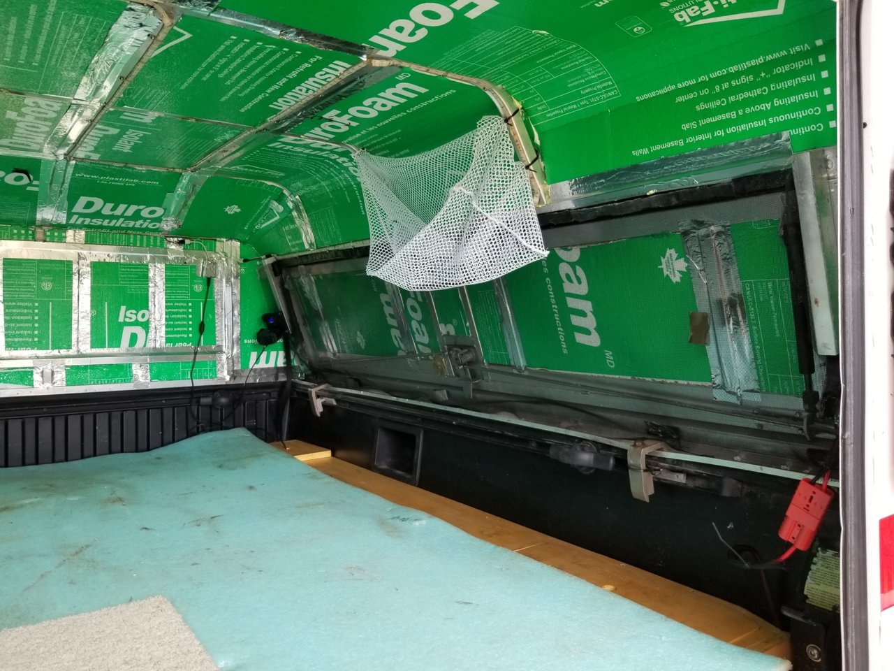

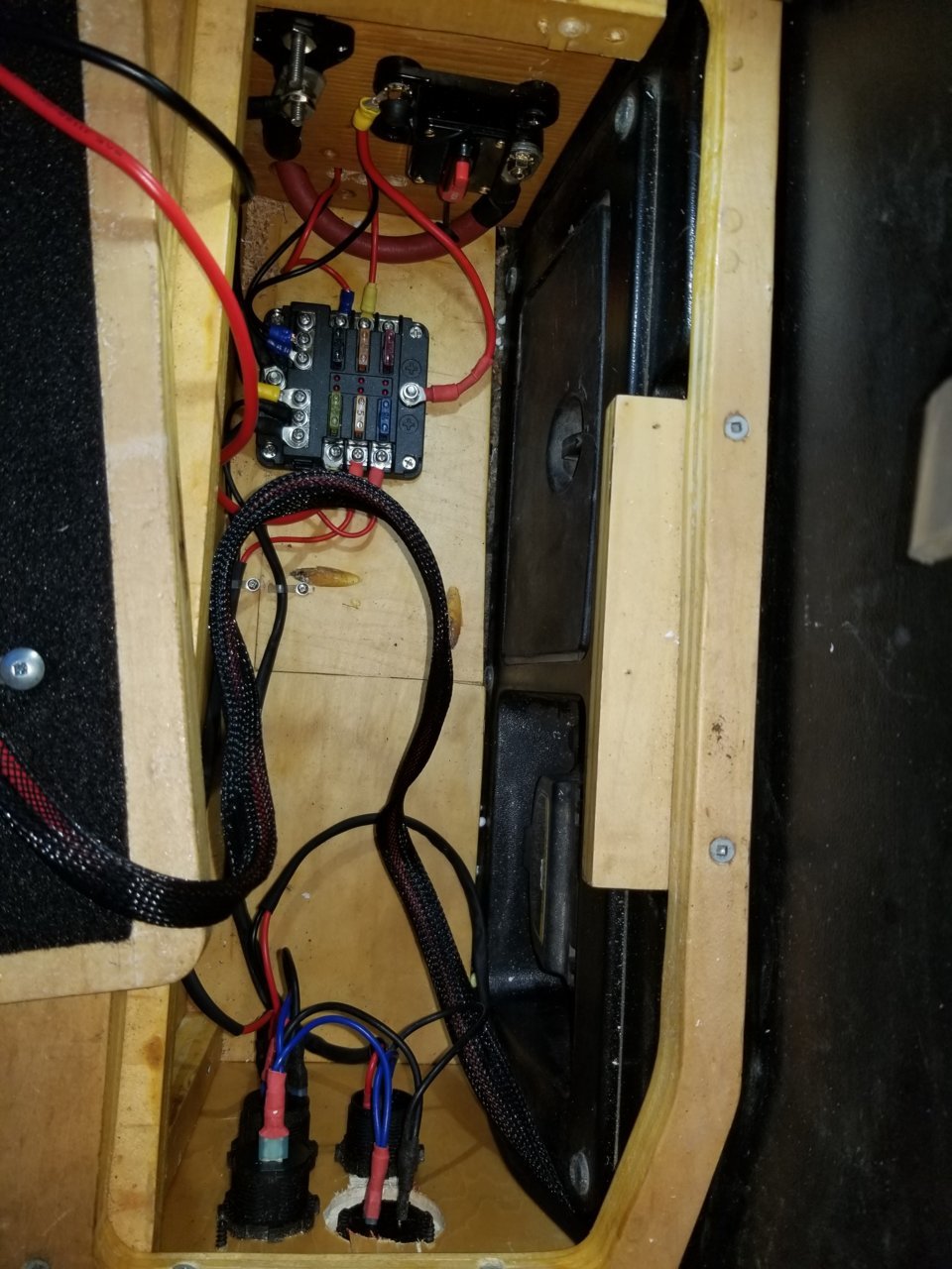

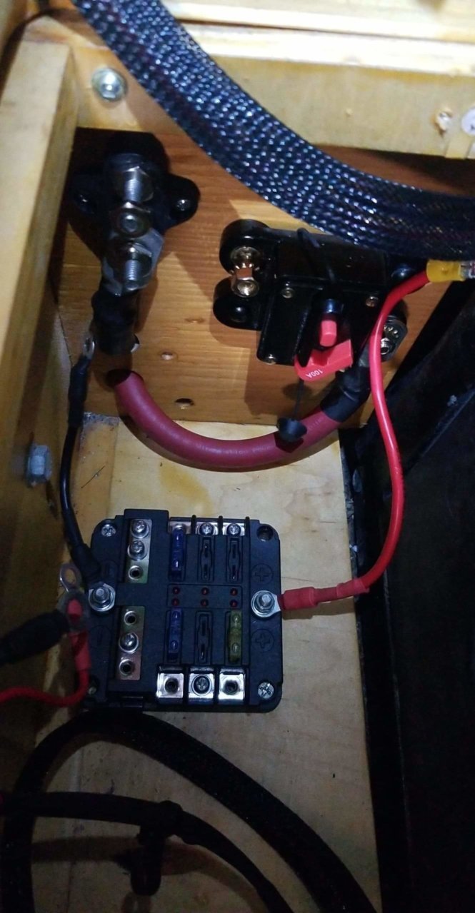

    Working on some insulation and electronic relocation for the cap. Full time habitat? who knows ¯\_(ツ)_/¯
    Before:
    It worked...until it didnt (changed it up) :
    After:
    In between:
    solar extension hook up
    tacoma16 and srspicer like this.

    Wish I wasn't rubbish at electrical. Looks awesome!

    I'm really not that good.. at all
    I ran short on heat shrink tubing and had it all hooked up initially. Didnt work with the 1/0 cable because was too rigid and wouldn't allow it to flex back cover up the cubby, so had to complelty change.
    Also @tacoma16 taught me. I'm electrically retarded lol

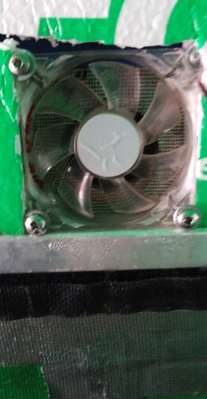

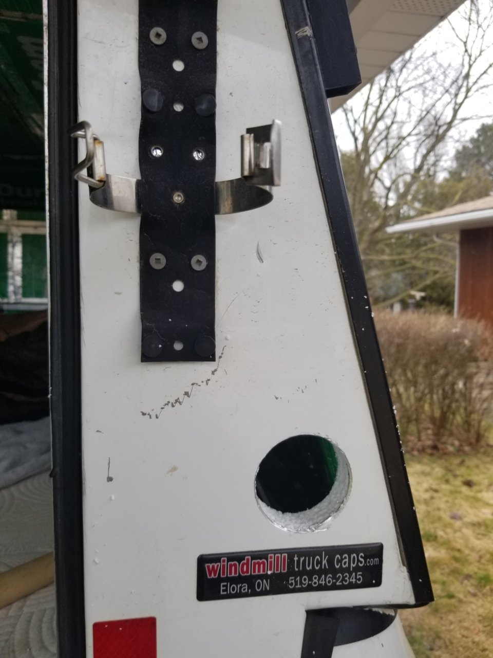

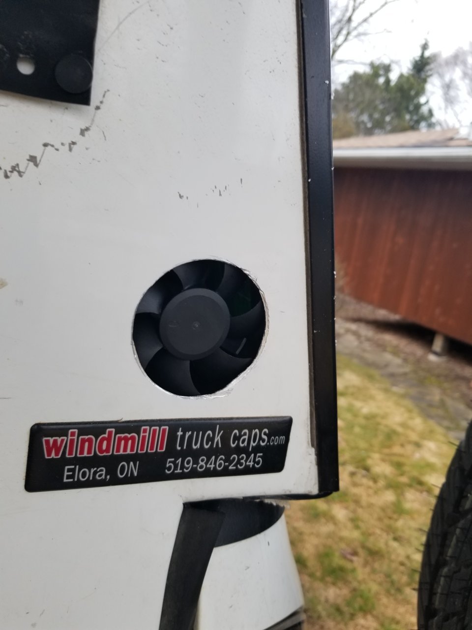

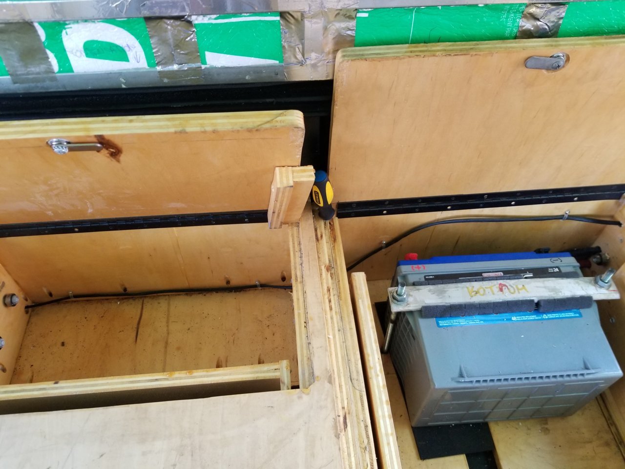

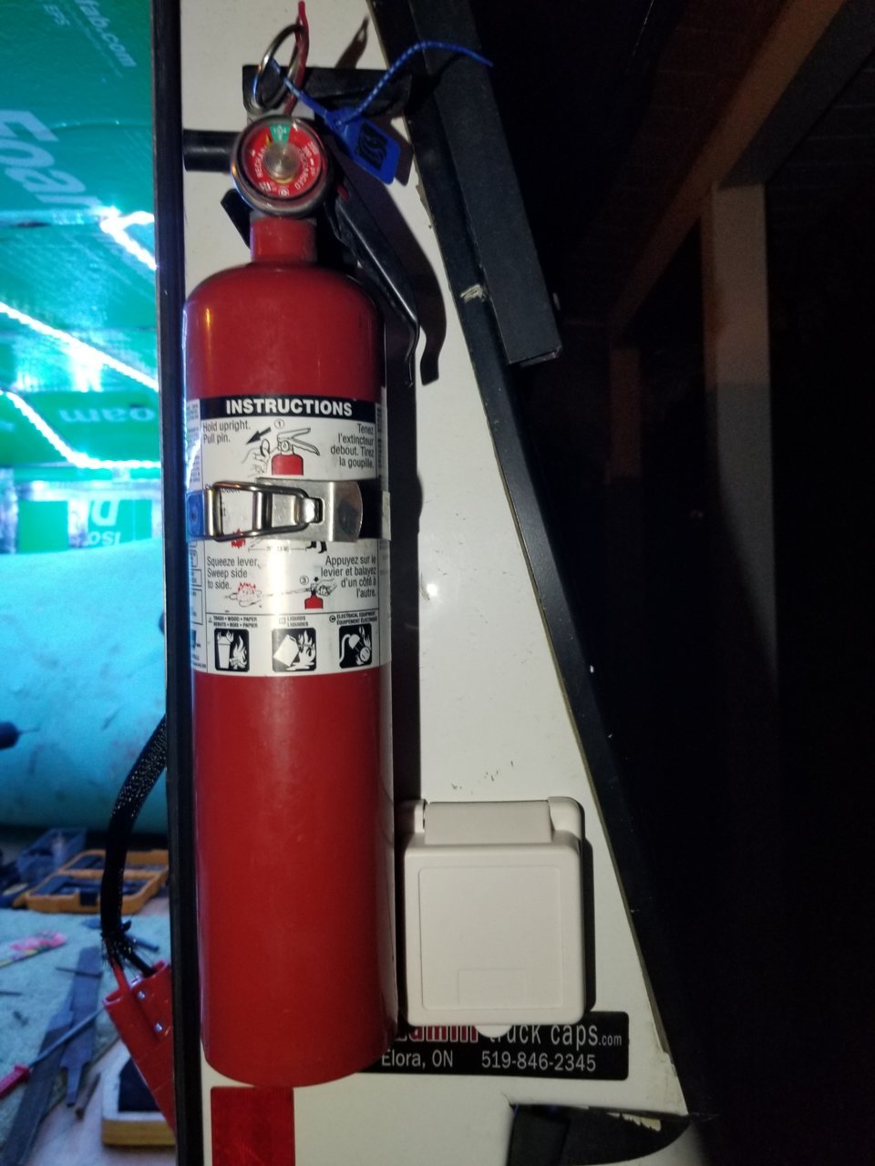

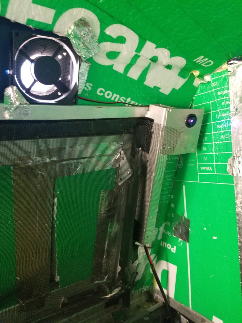

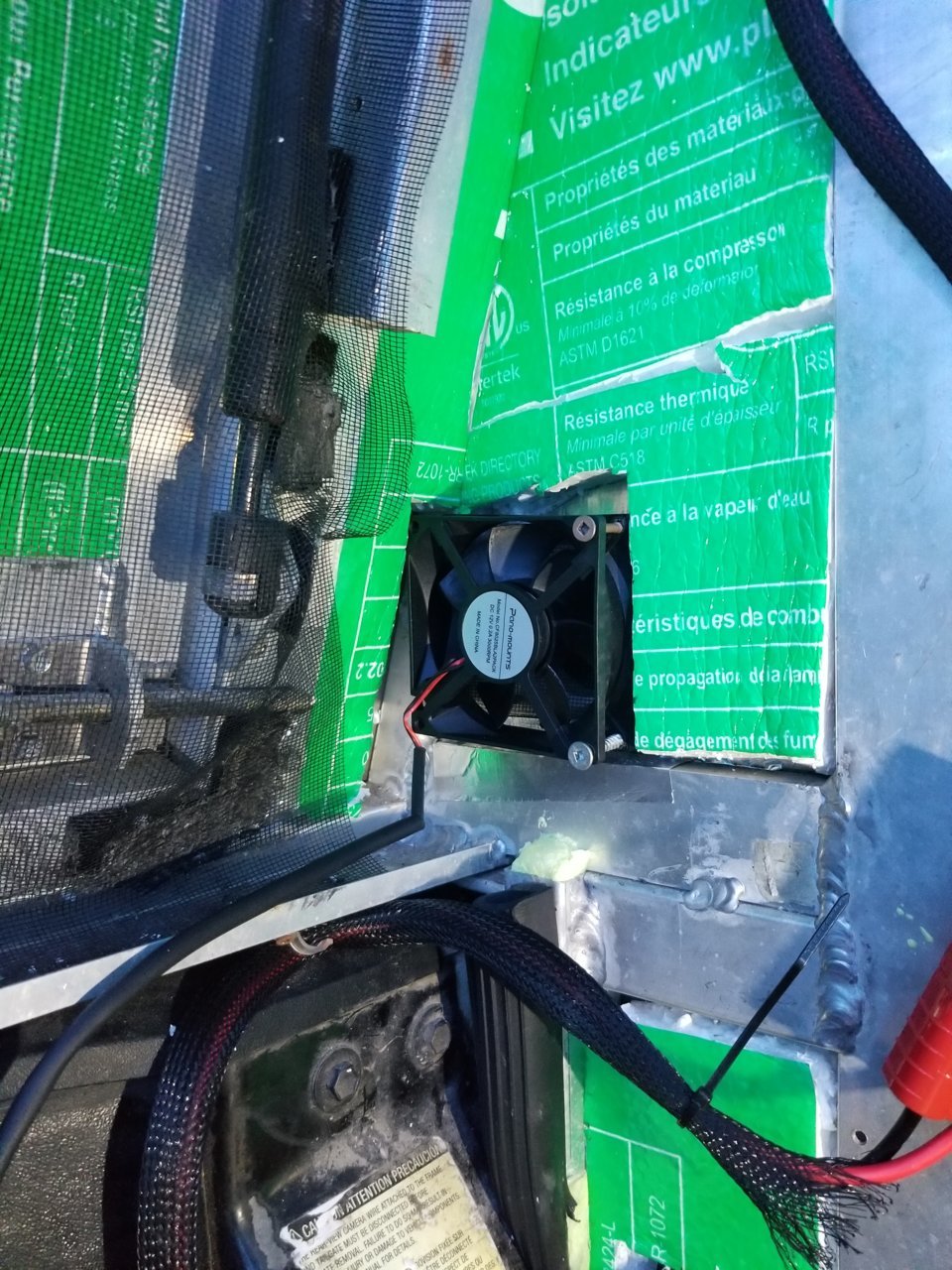

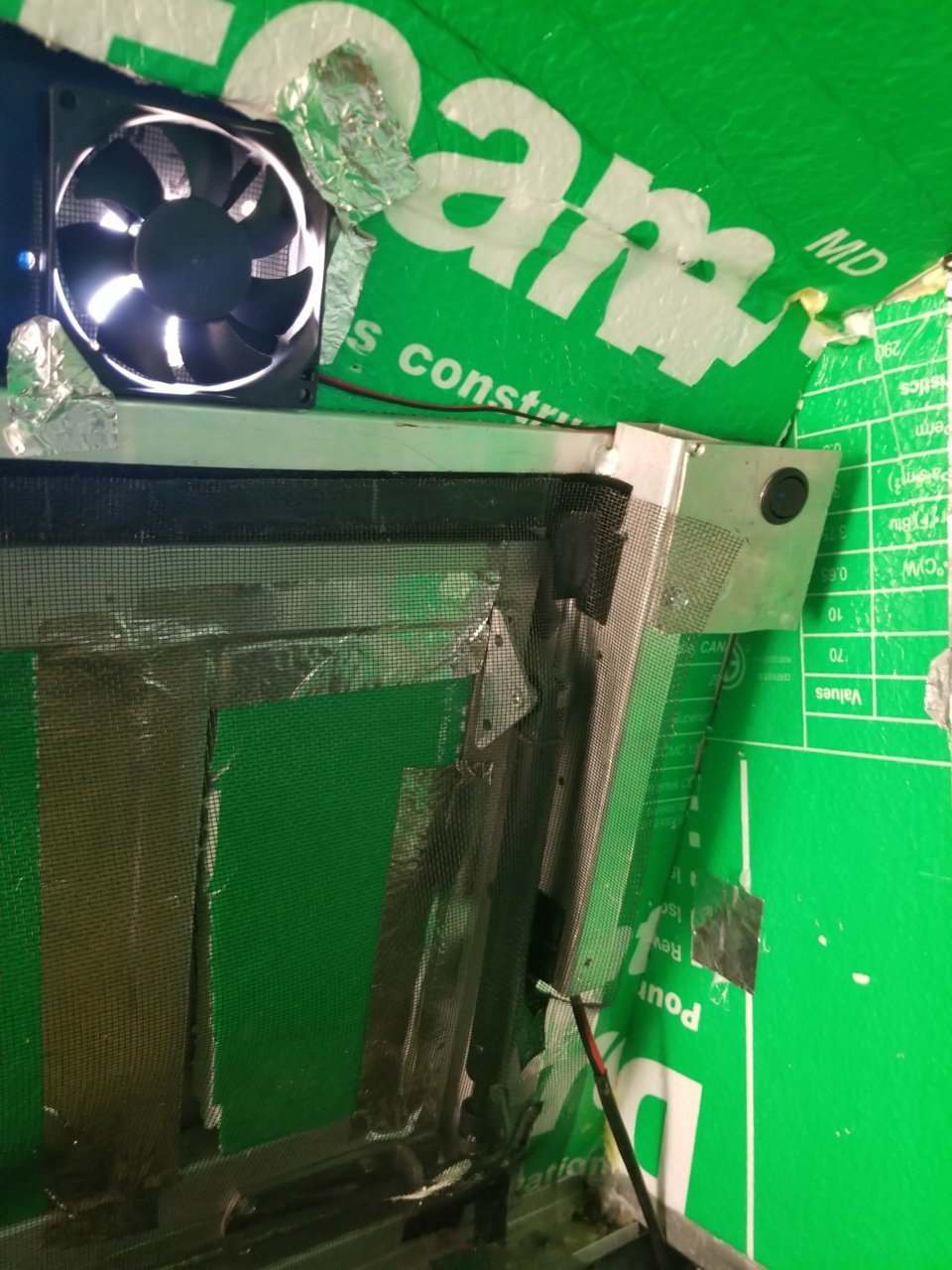

    With some new in cap construction taking place I had to run another (+) and (-) to the rear so i could use a rocker switch to control a fan for ventilating the back while sleeping. Condensation issues arise easily with the aluminum cap so I need to find a way to mitigate this. Ive come up with the following:
    Night 1: 1x 80mm x 80mm cpu fan with air blowing out
    Night 2: 1x 80mm x 80mm cpu fan with air blowing in
    Night 3: 2 fans with one blowing in and one blowing out?
    20200324_124814[1].jpg 20200324_133450[1].jpg 20200324_133459[1].jpg 20200324_133514[1].jpg 20200324_142138[1].jpg 20200325_115555[1].jpg 20200323_090201.jpg 90420064_542243063370385_1886391817277014016_n.jpg
    tacoma16 likes this.

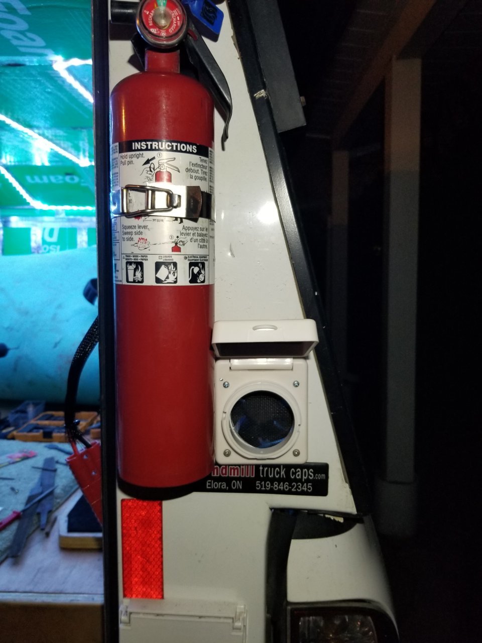

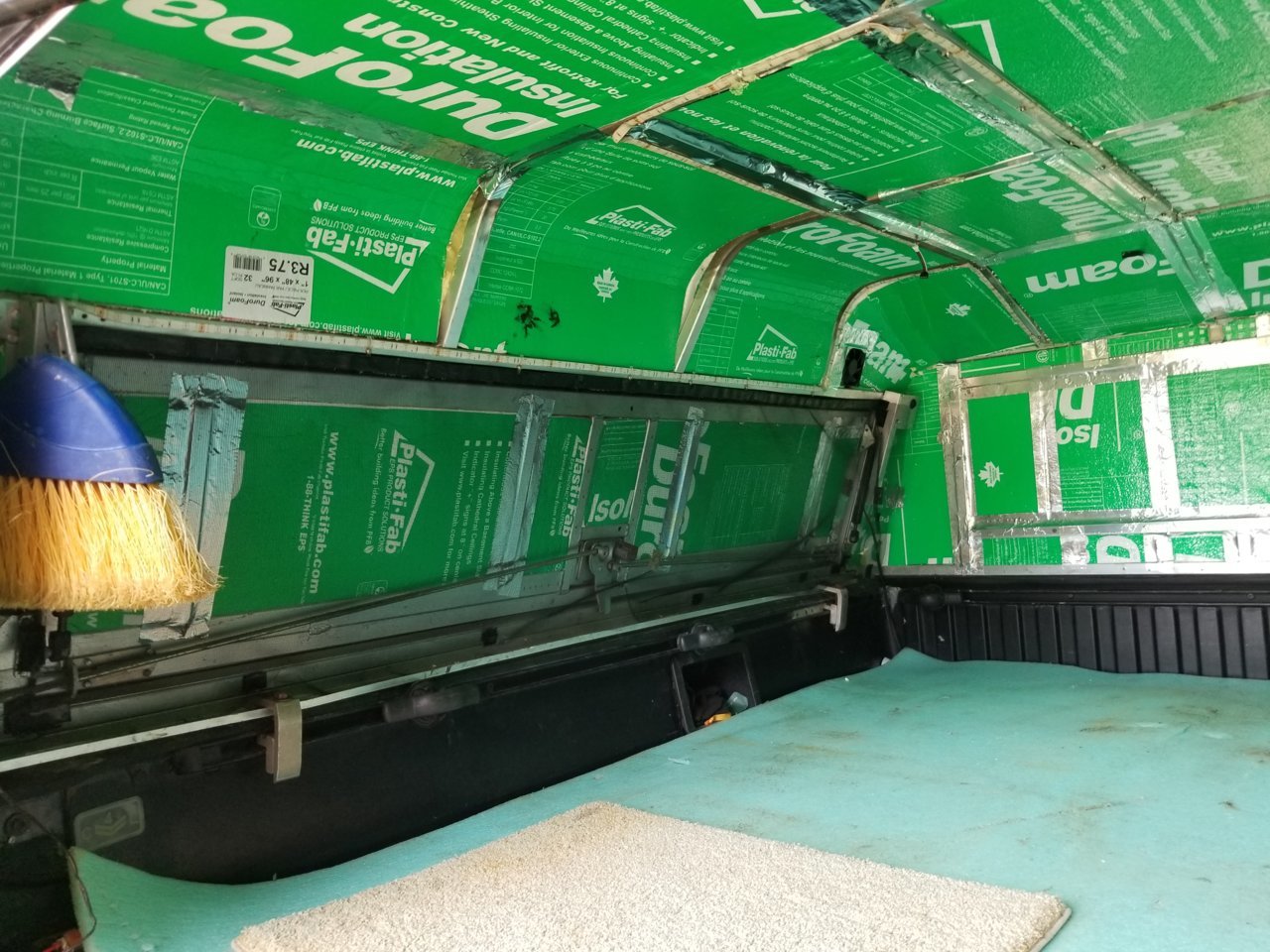

    More updates from ventilation side of house.
    Towards the head, vent for extraction 20200327_134044.jpg 20200327_134048.jpg 20200328_145234.jpg 20200328_145238.jpg 20200328_145231.jpg20200331_170713.jpg 20200331_171116.jpg 20200331_172604.jpg 20200331_194159.jpg 20200331_204428.jpg 20200331_204433.jpg 20200331_204438.jpg
    need to relocate the lights and get carpet put in.

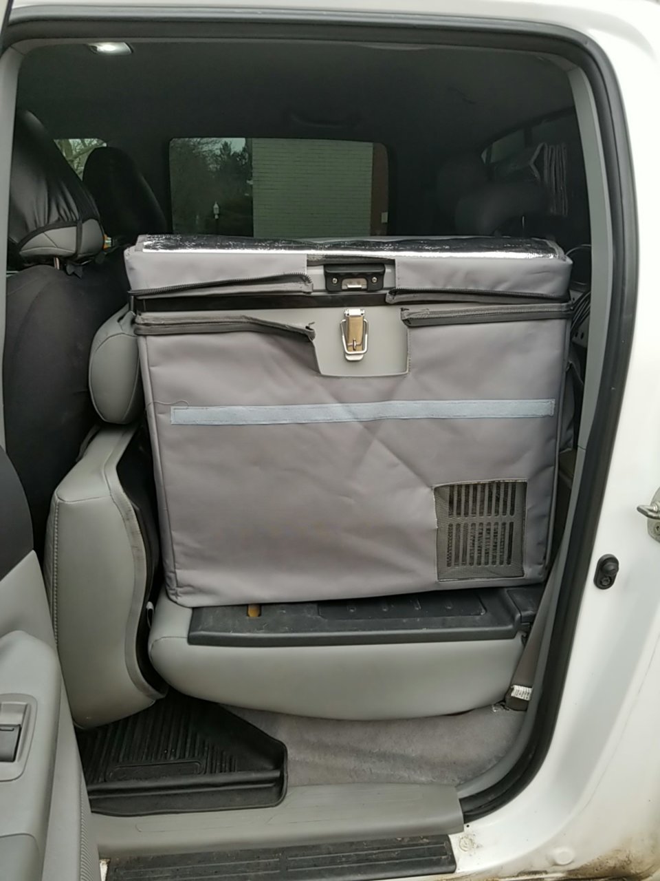

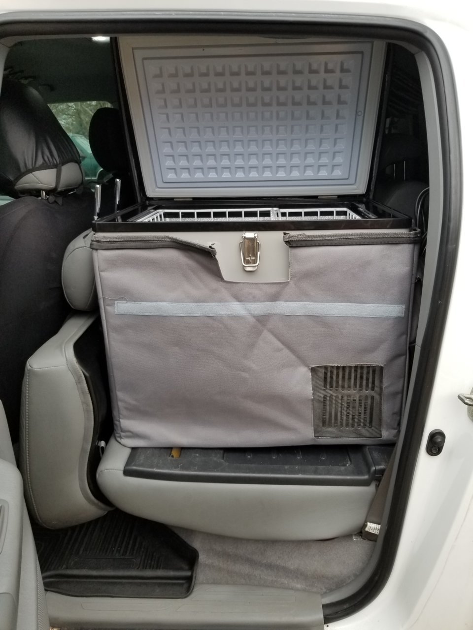

    also got me-self a Whynter FM-45G 45-Quart Portable Refrigerator/Freezer. Will be running the wire to inside the cab to have either truck fed power, or solar fed power depending on the weath. More to follow.

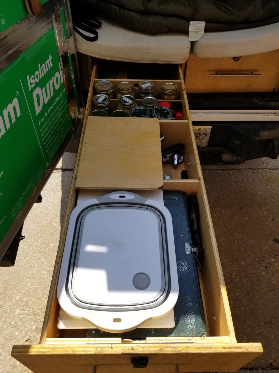

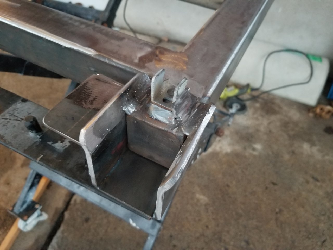

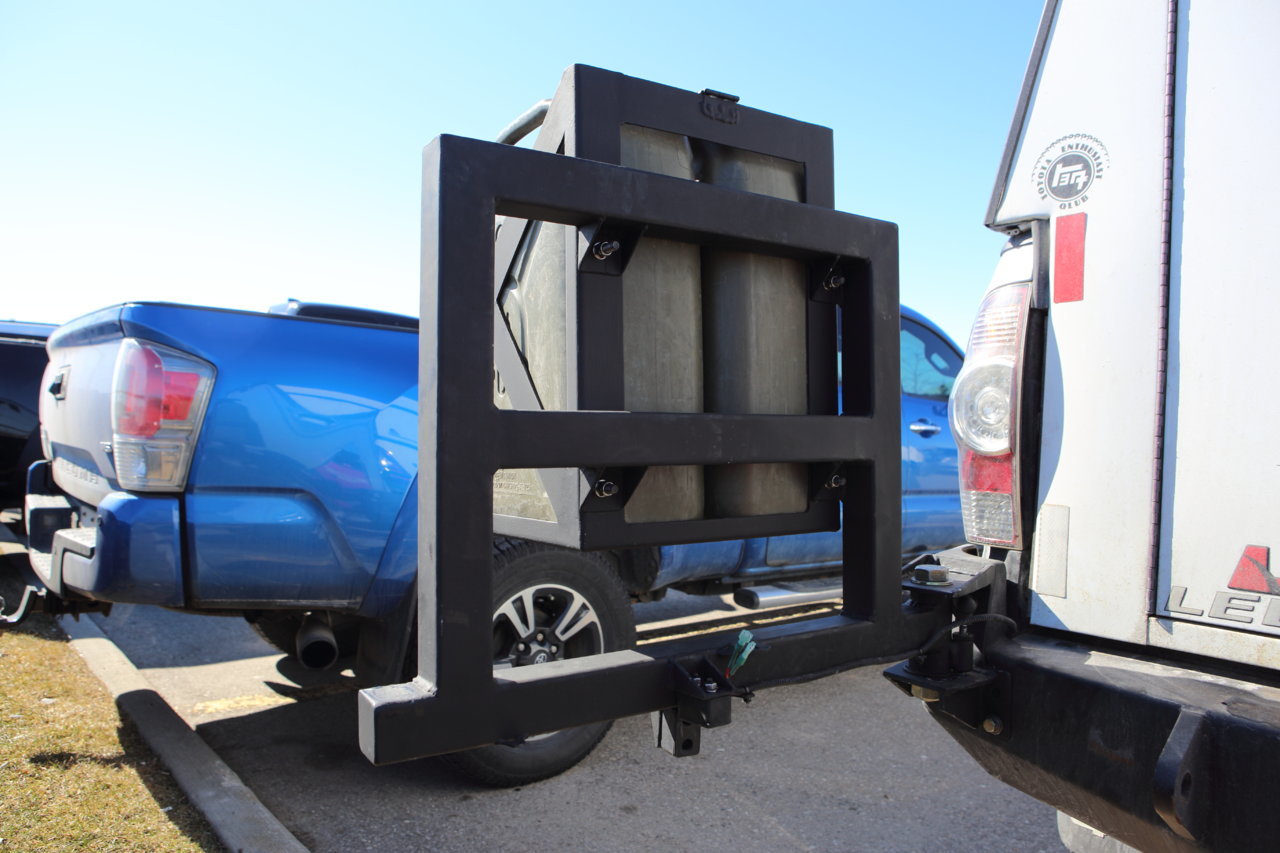

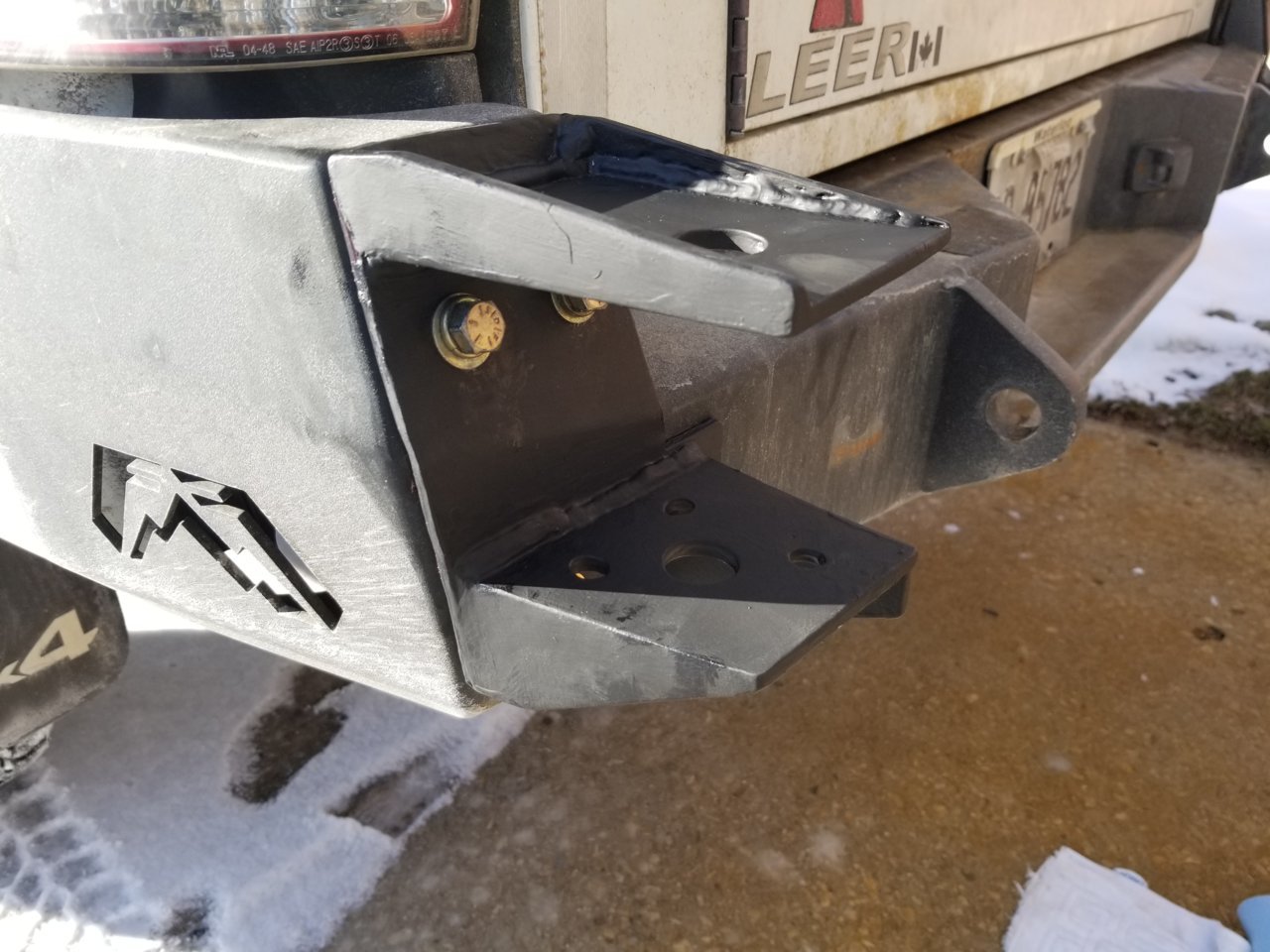

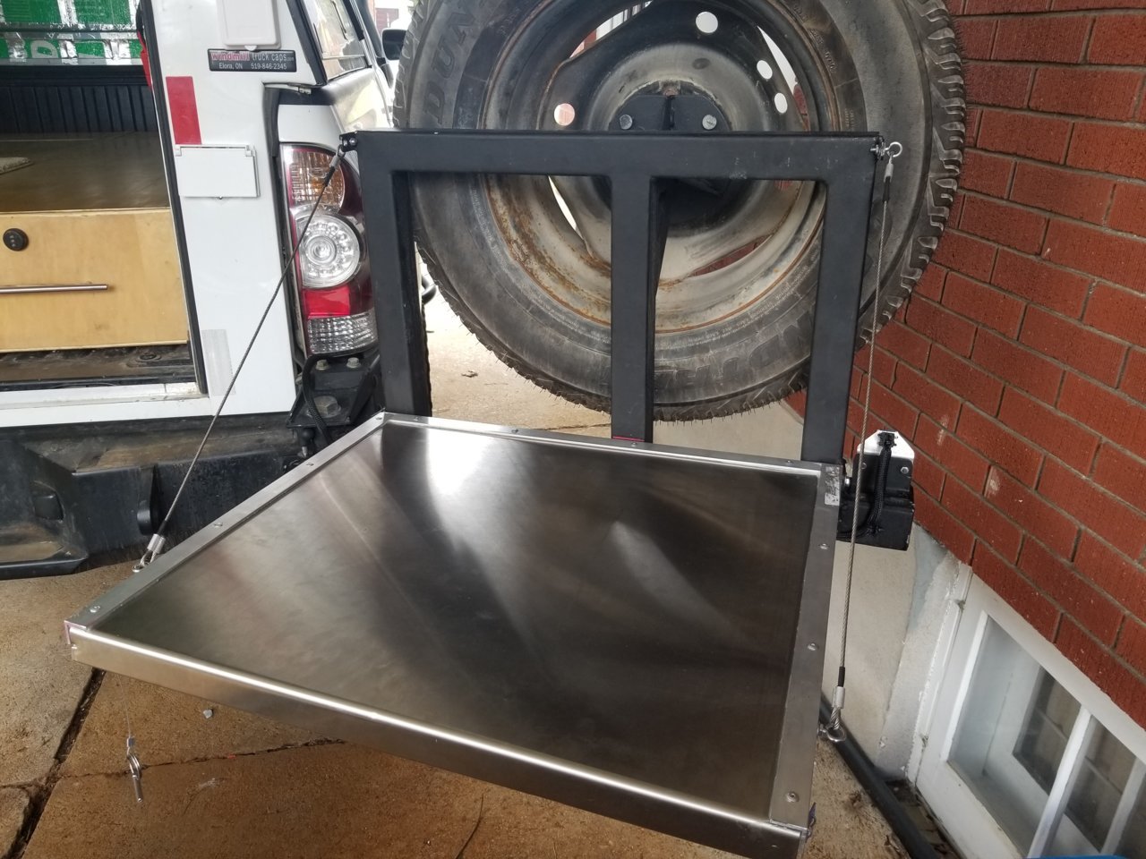

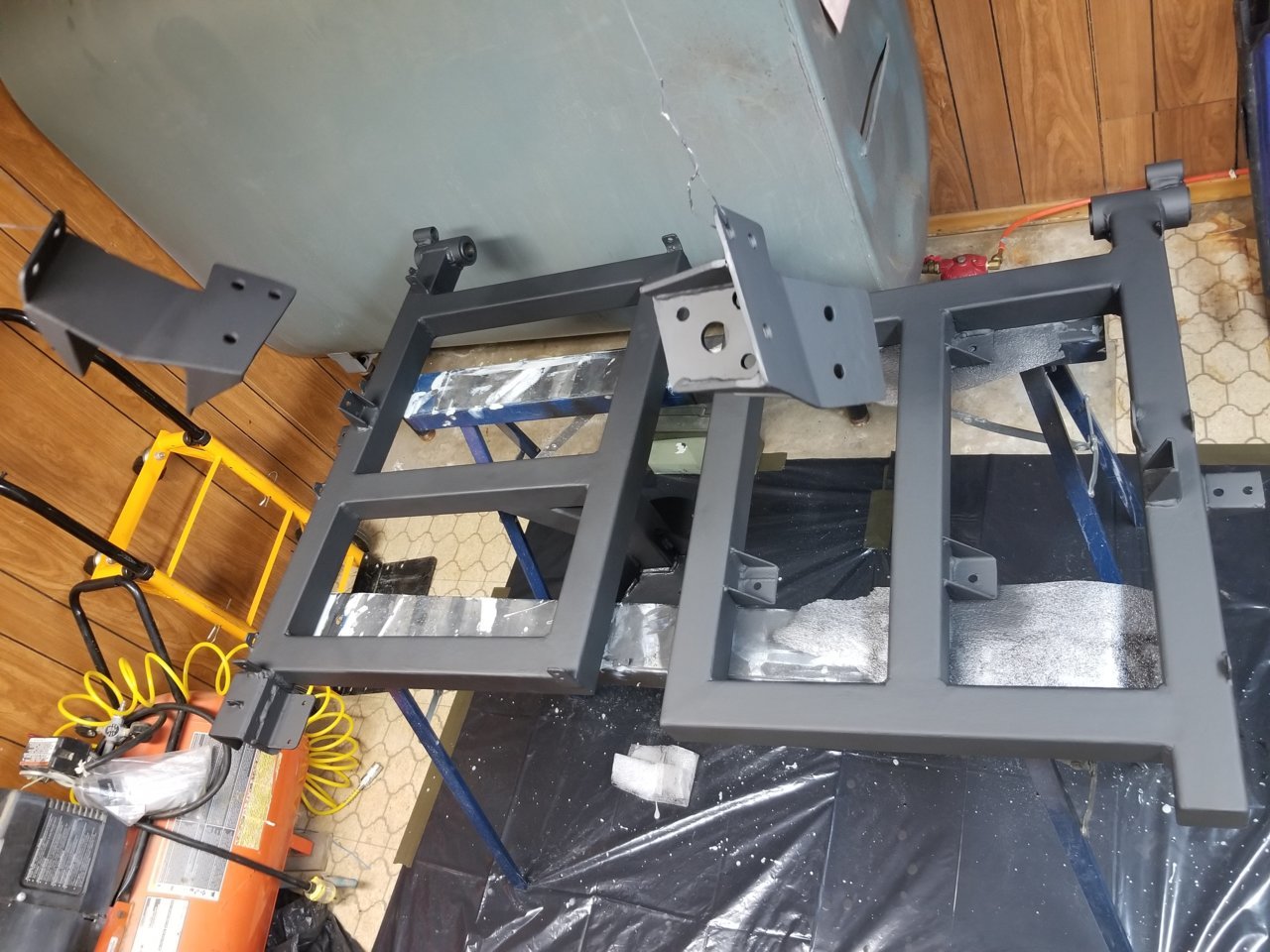

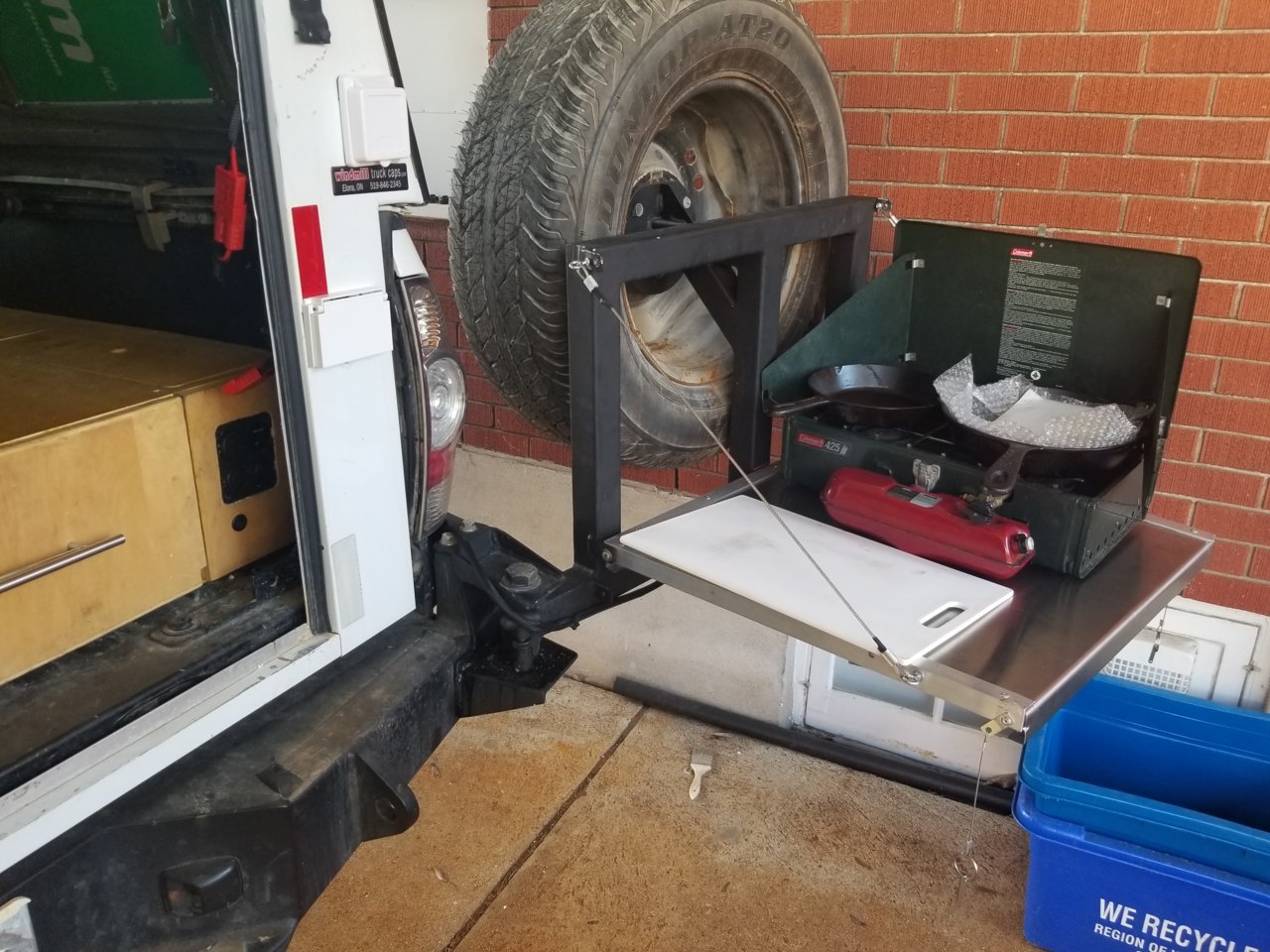

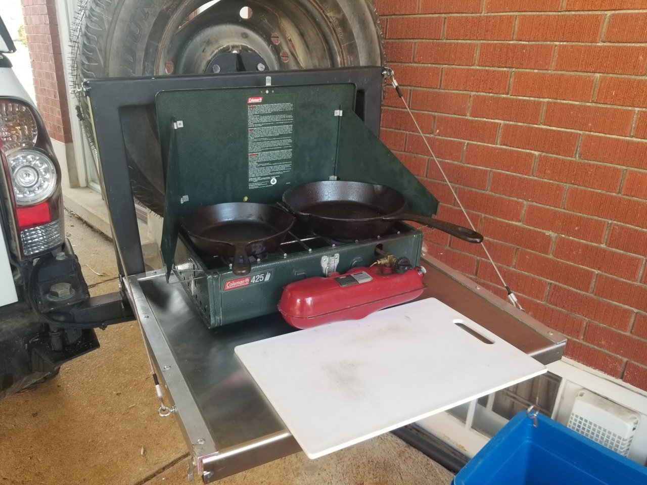

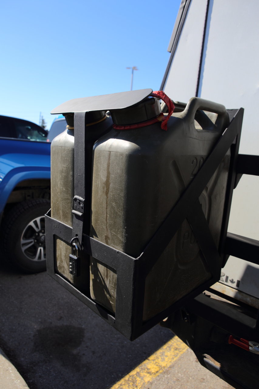

    Drop down table. Its finally alive!
    20200422_181047.jpg 20200422_180940.jpg 20200422_135829.jpg 20200422_135916.jpg
    Woop woop!:yay:

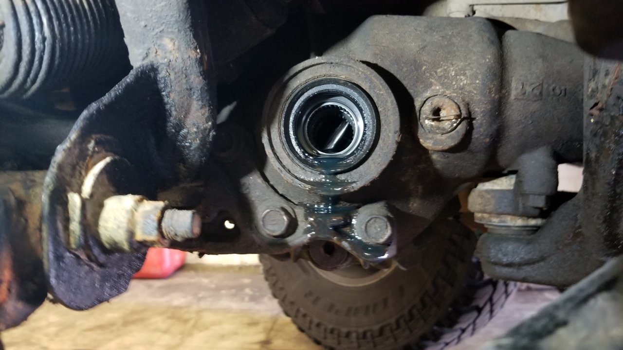

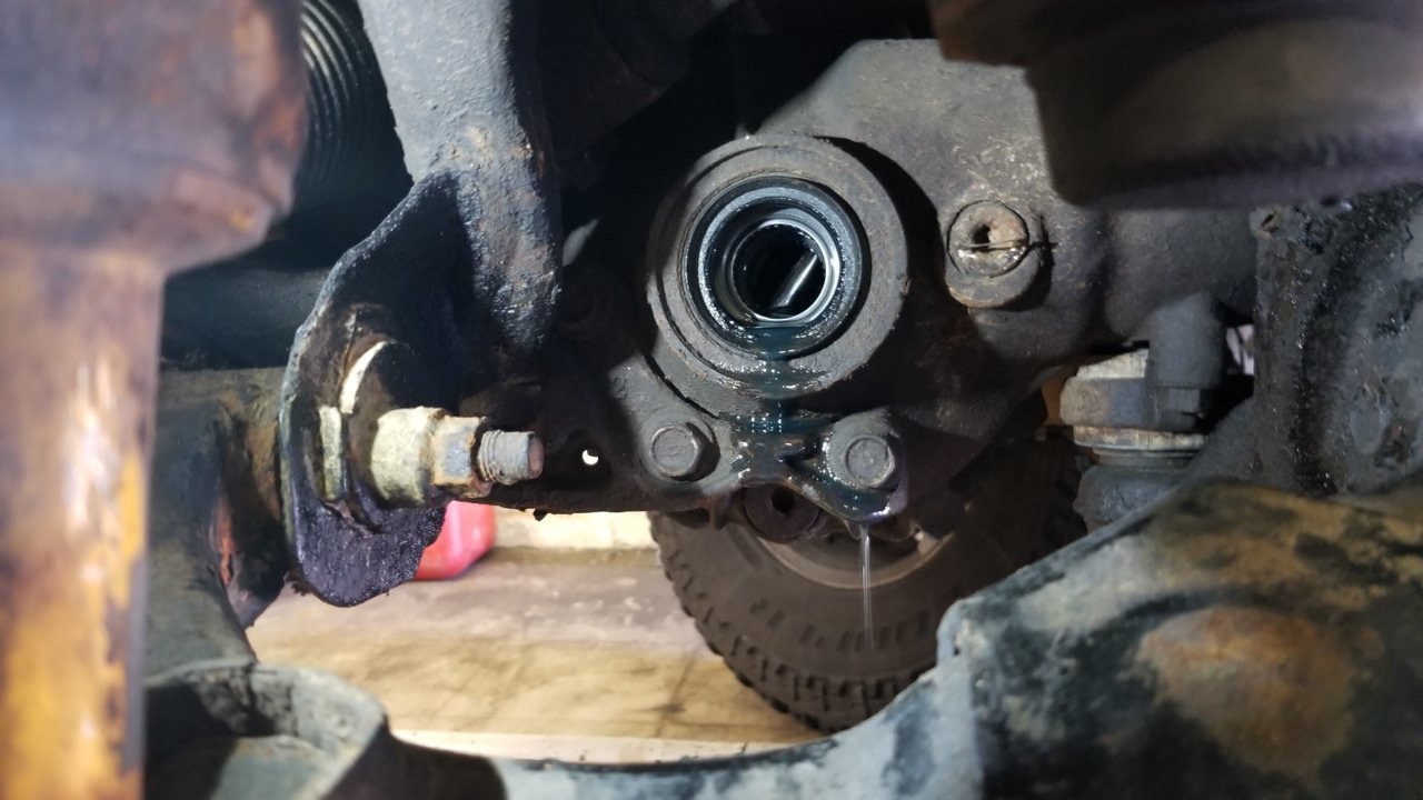

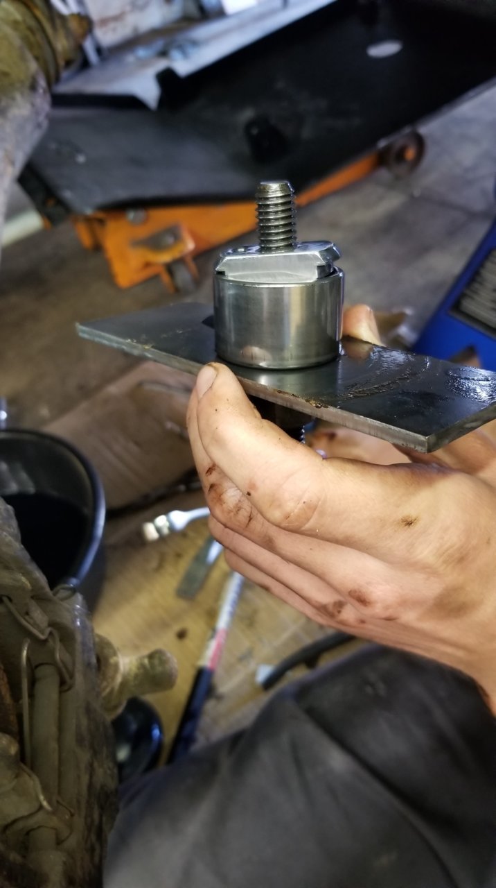

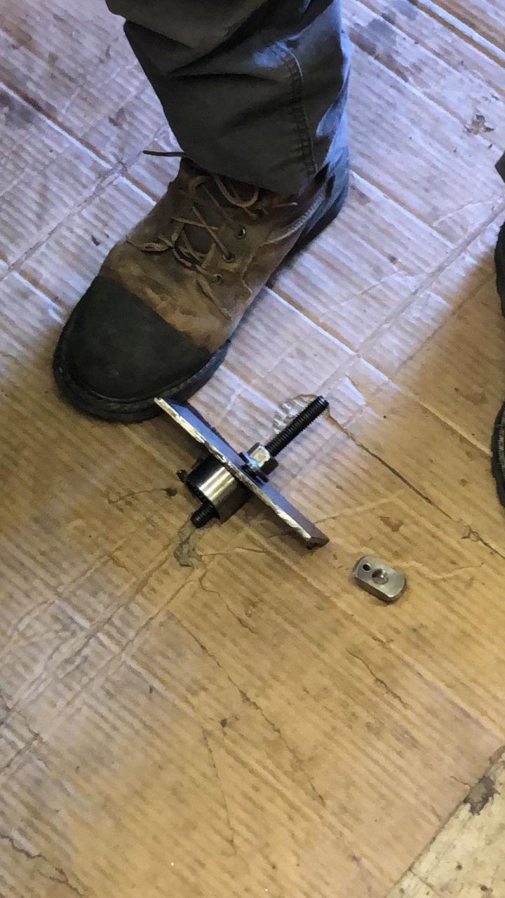

    Dropped in ECGS Bushing, and had the custom tool made by @tgelata
    Further swapped out an O2 Sensor, Bank 2, sensor 2, to get rid of a P0420 code. Fingers crossed its the solution.
    Filmed the driveline vibes ive been dealing with for sometime.
    https://youtu.be/_QcyLpV4grA
    Will be swapping out the carrier bearing.

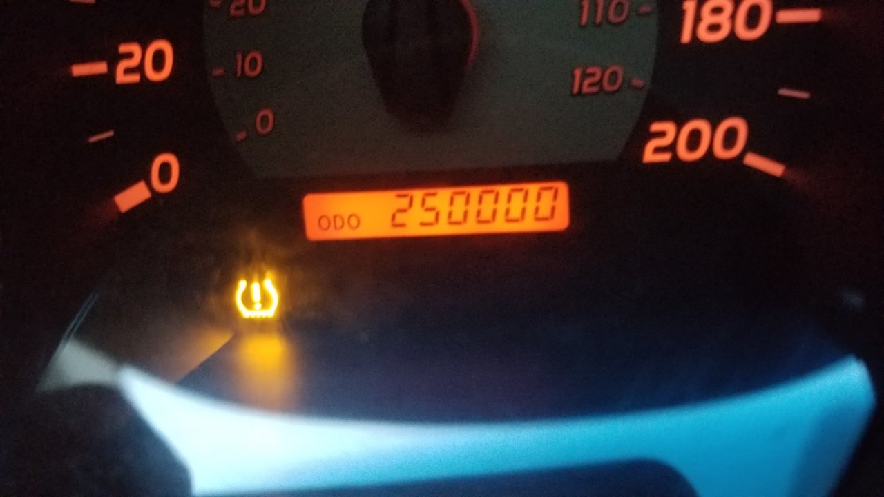

    Big day, finally broken in.
