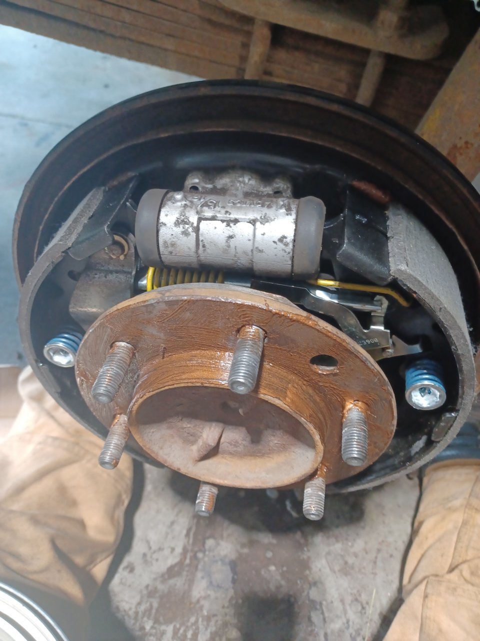

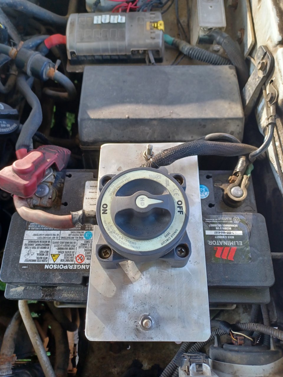

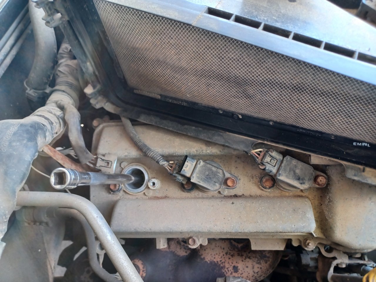

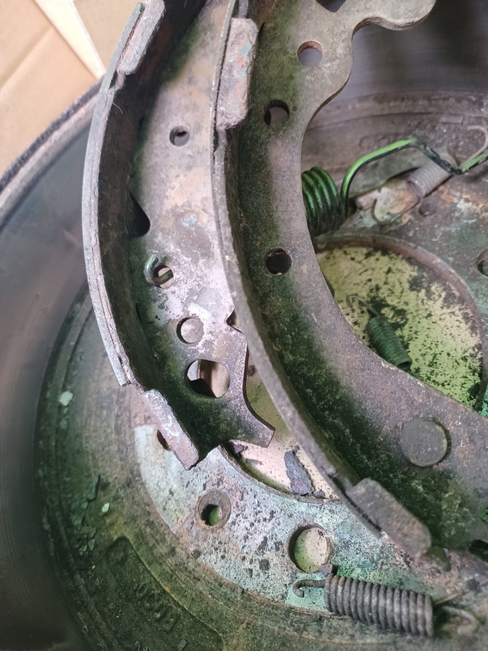

    The big 300k maintenance block.
    Battery tie down Plate
    Spark Plugs
    AT fluid change
    Front Diff
    Rear Diff
    Transfer Case
    Power Steering flush
    Drums and Shoes
    Passeneger Rear ABS sensor
    ABS wire fix
    1 x welding injury
    The three MVPs:
    @tacoma16
    @Shveet
    @Norilsk
    References:
    Rear brakes - https://www.tacomaworld.com/threads/drum-brake-shoe-replacement.510324/
    AT Flush - https://www.tacomaworld.com/threads/diy-full-flush-for-automatic-transmission.68462/
    Power Steering Flush - https://www.tacomaworld.com/threads/power-steering-flush.416379/
    Spark Plugs -

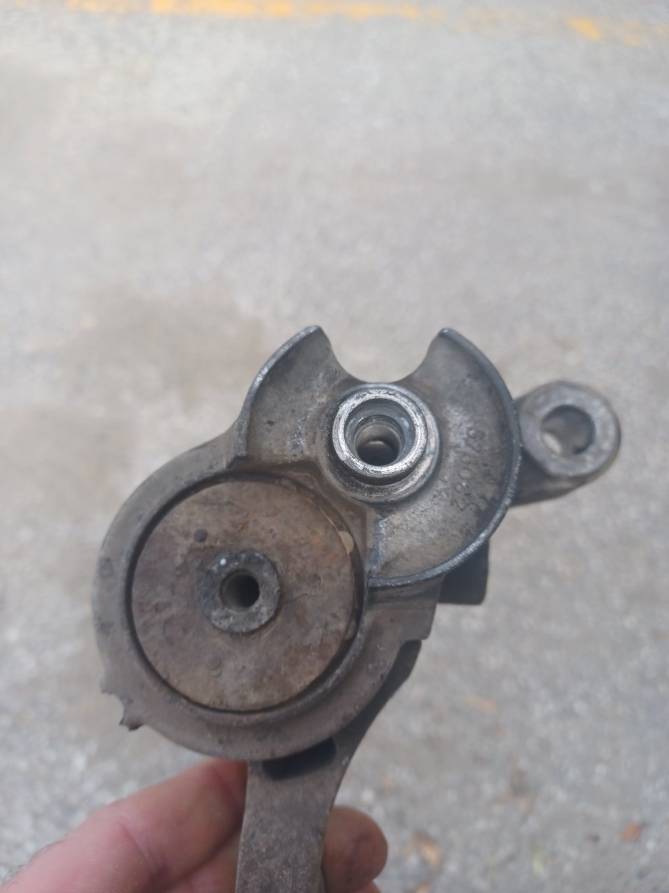

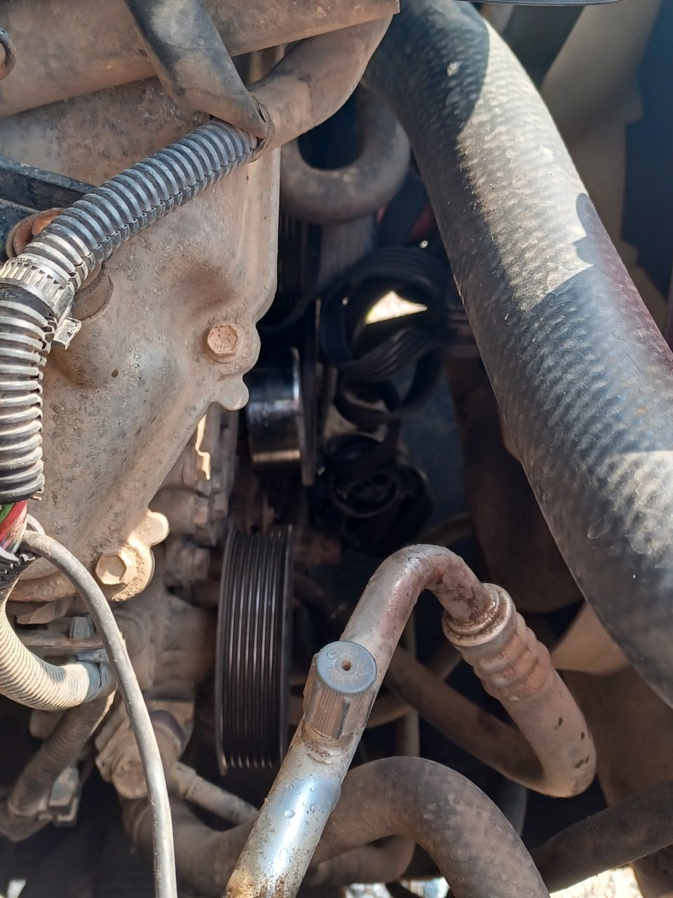

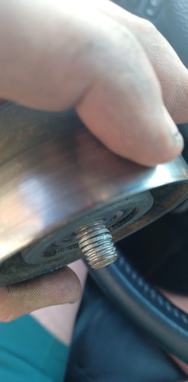

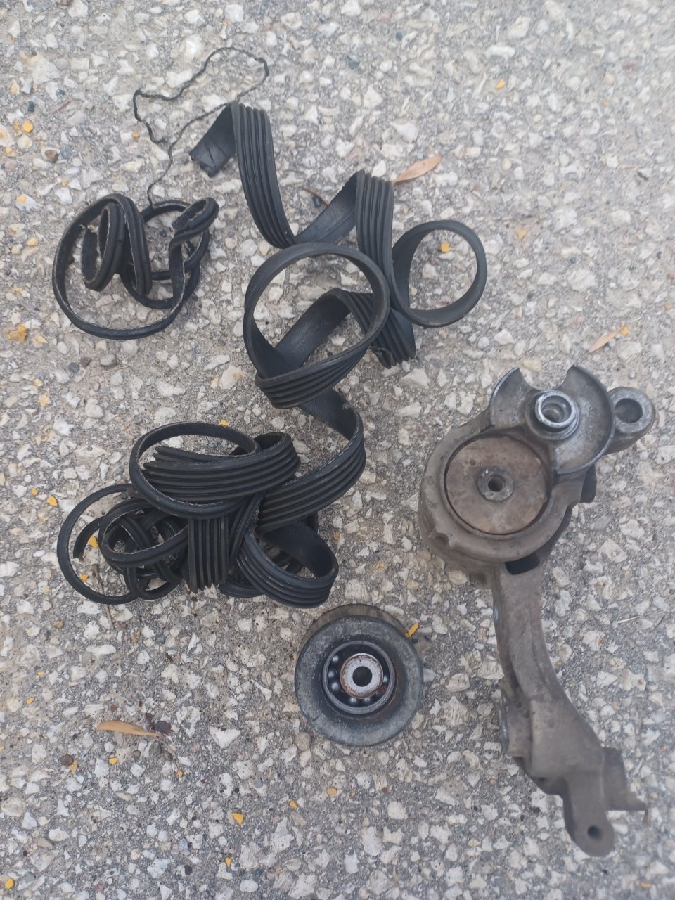

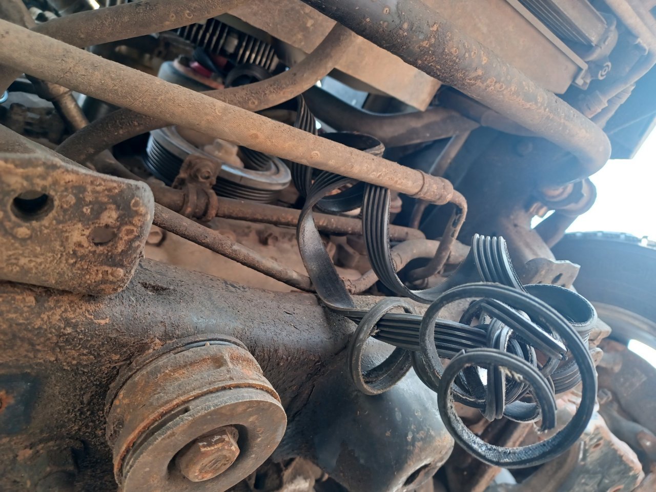

    305 000km in...

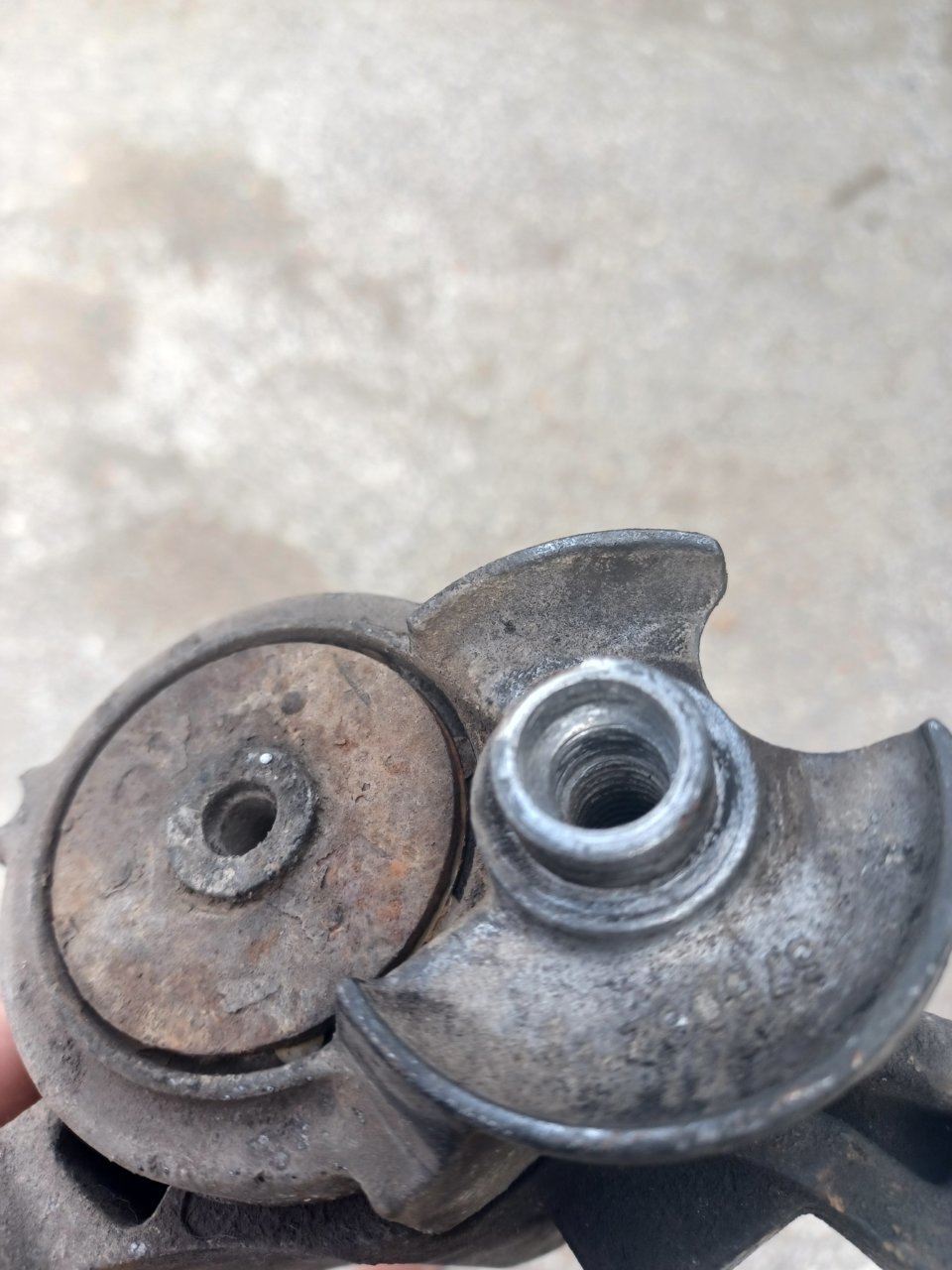

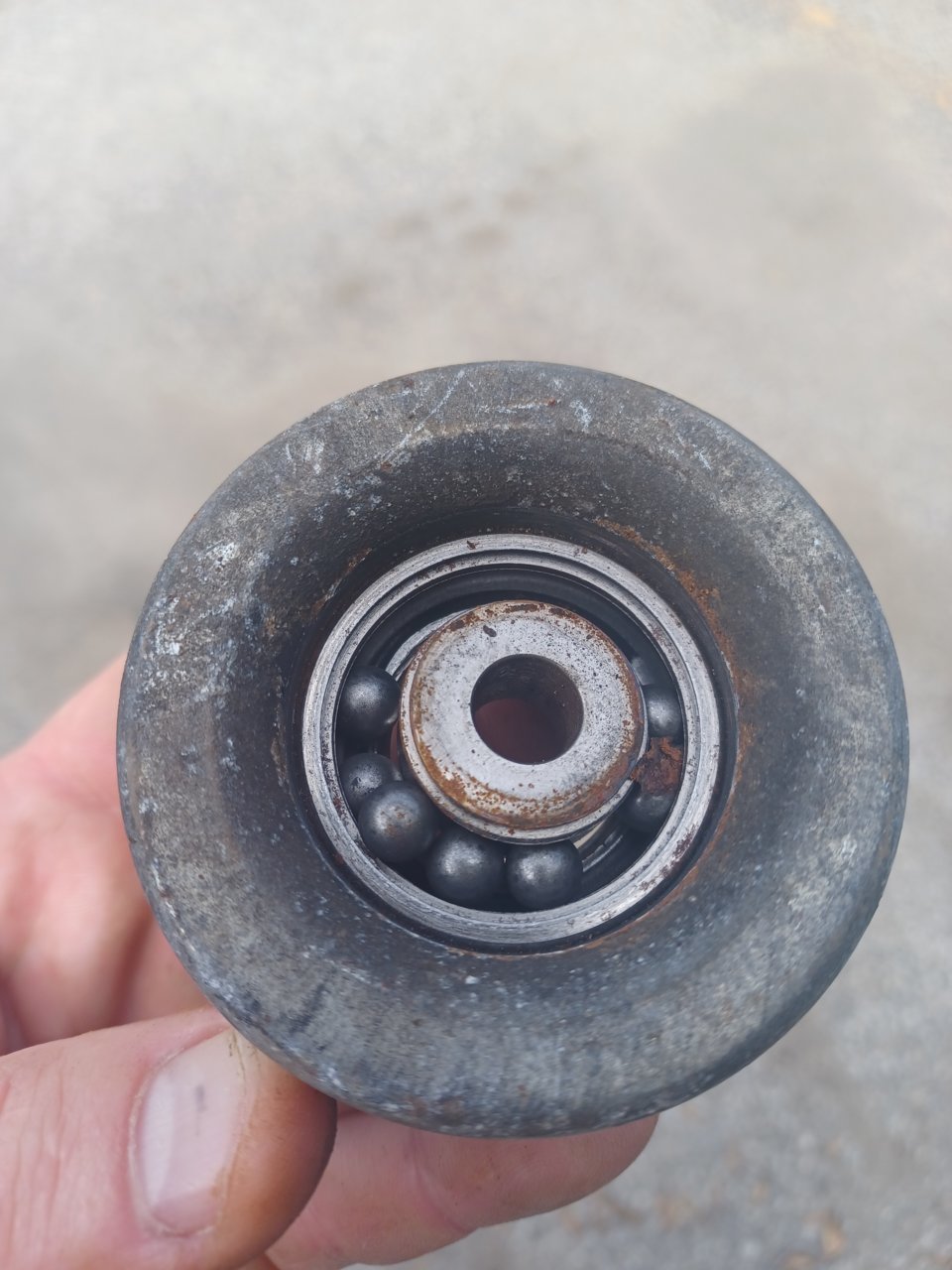

    Whilst travelling out west the upper idle bearing quit on me in a fantastic fashion and decided to shred my belt an hour outside thunder but thankfully, still within as reception area.
    Slapped the new belt and spare bearings on, only to have the tensioner bearing shred the threads inside of the tensioner assembly leaving me pretty stranded.
    $1000.00 in tows later and i swapped out for https://www.rockauto.com/en/moreinfo.php?pk=9118564&cc=1445515&pt=11659&jsn=2 at a friends house.
    The Toyota Dealership quoted me $1700 and i did it just over $400 CAD.
    There goes my beer money for the year...

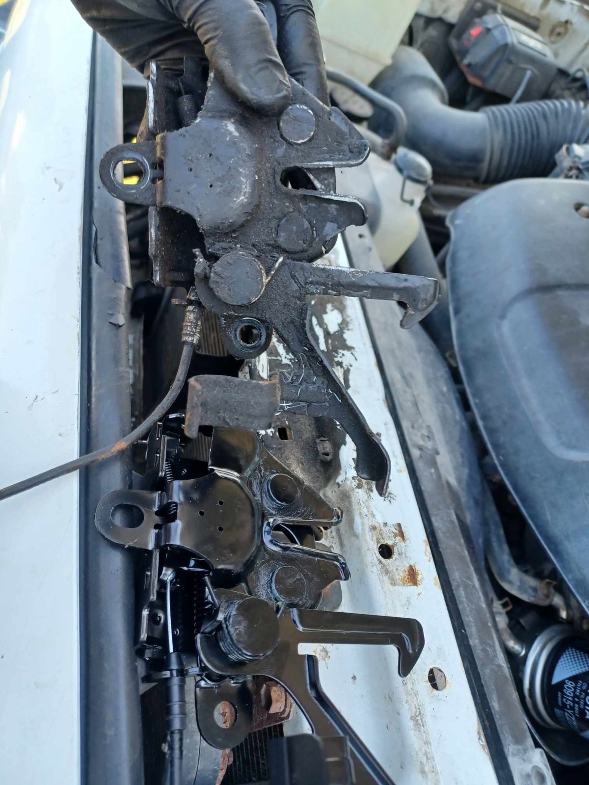

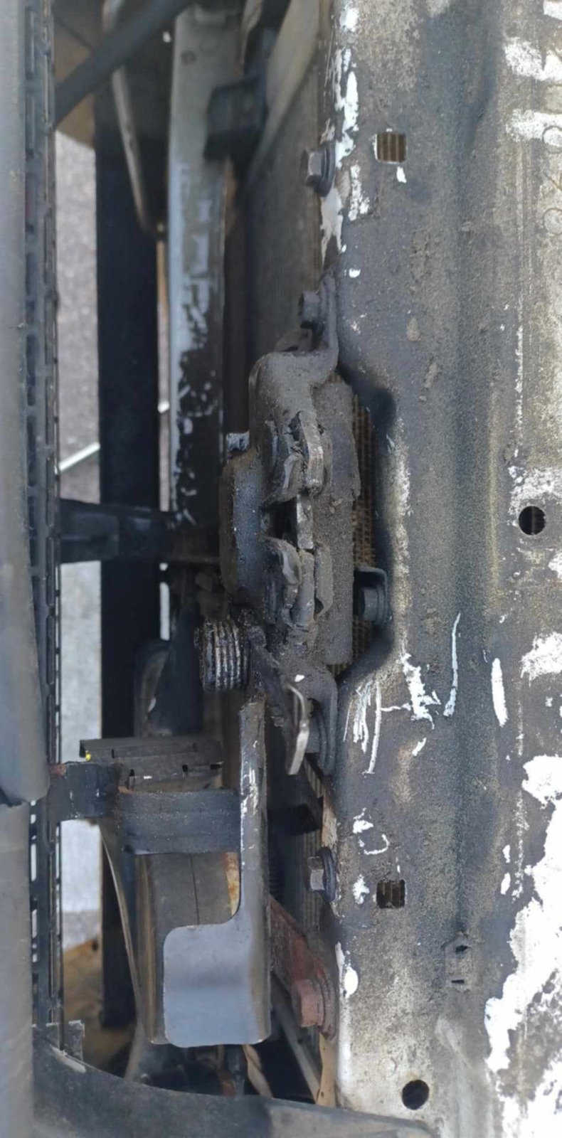

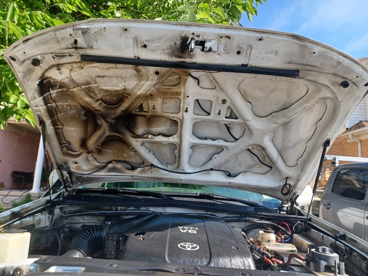

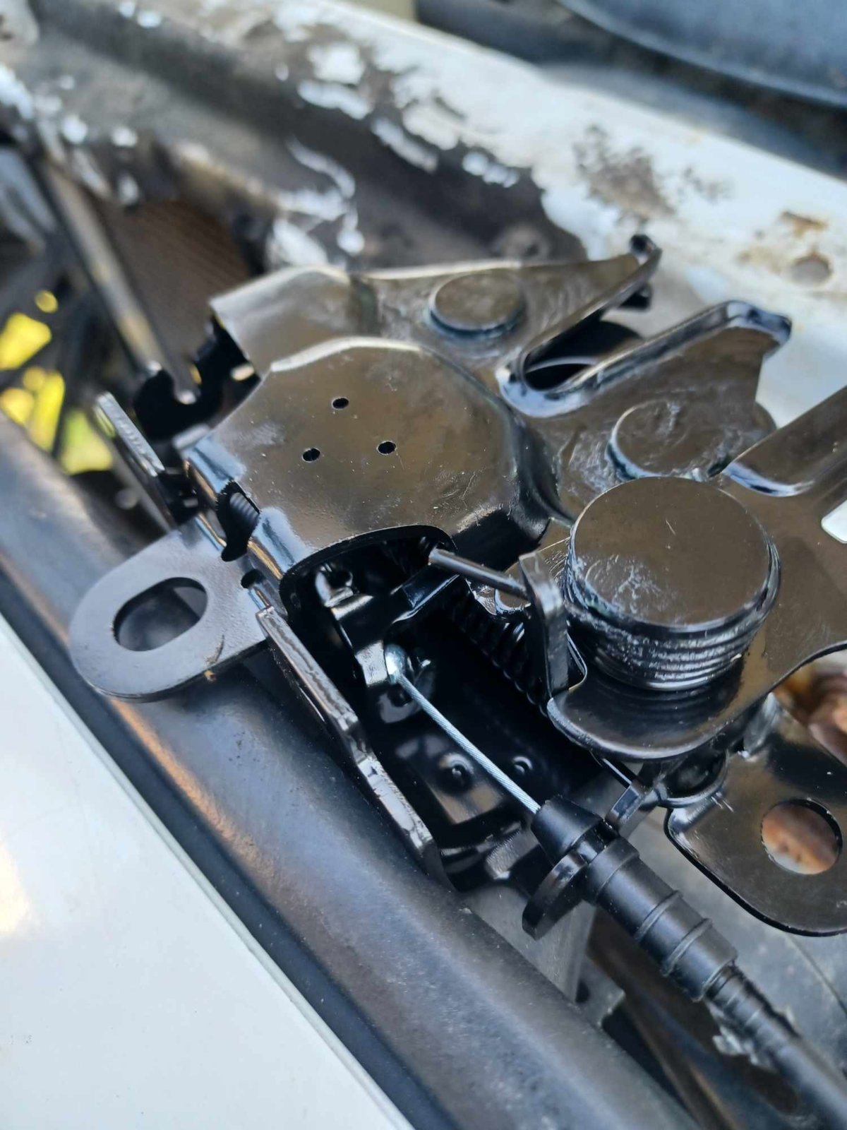

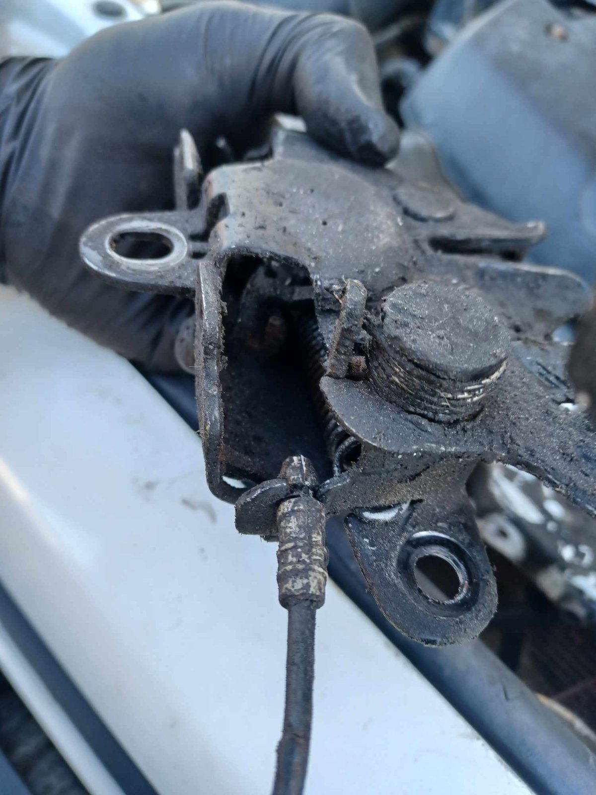

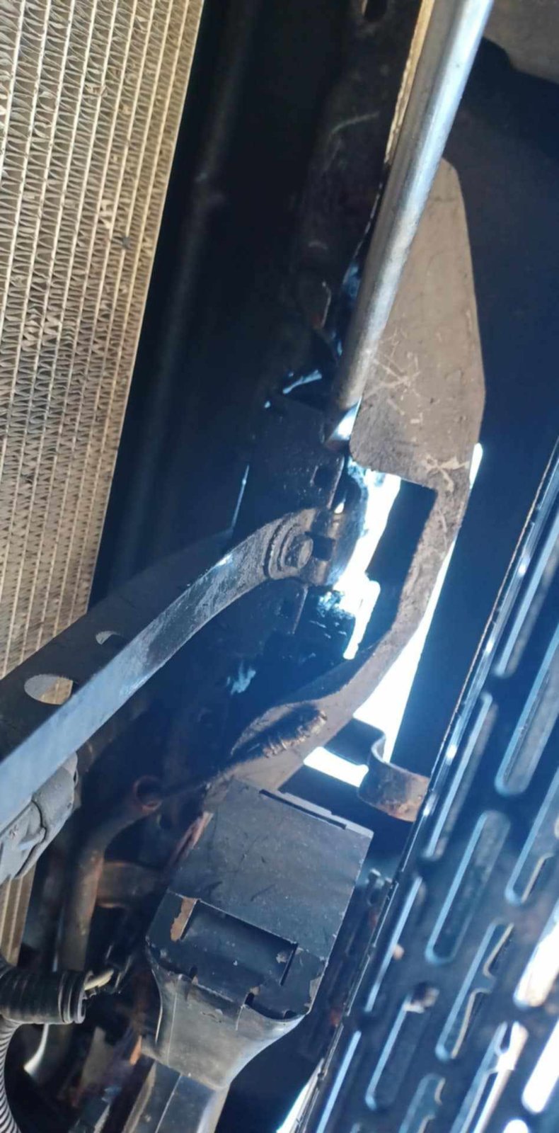

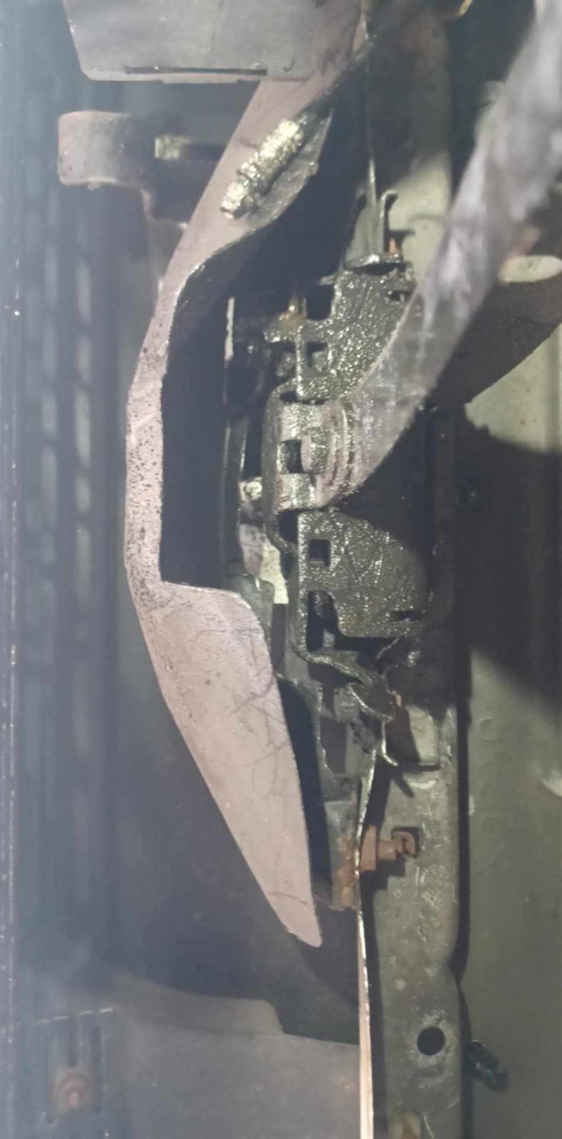

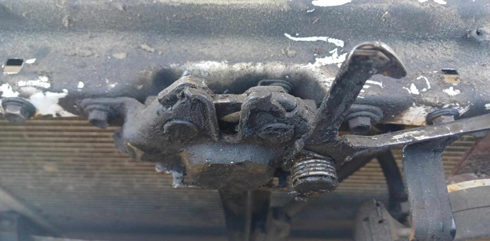

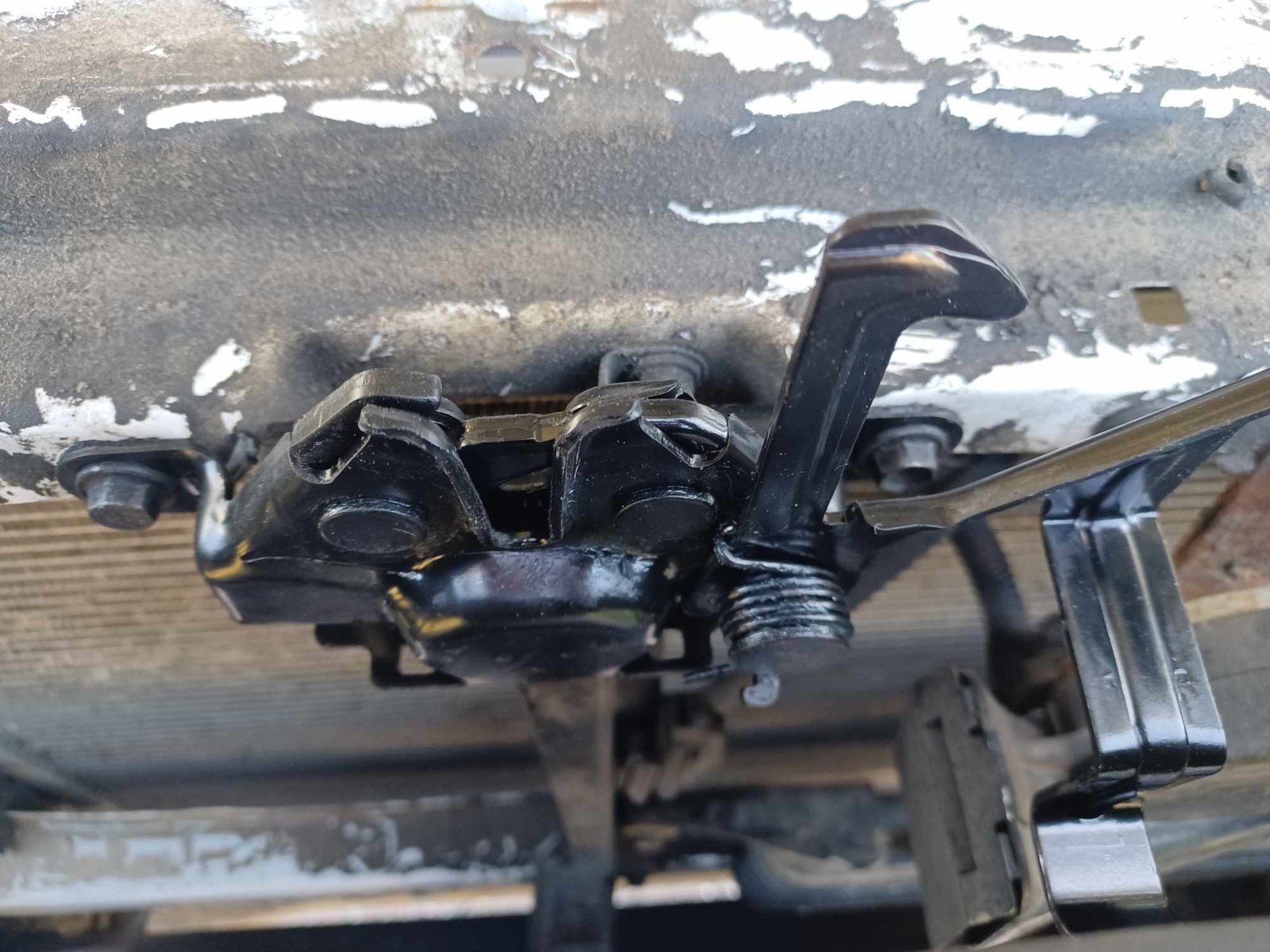

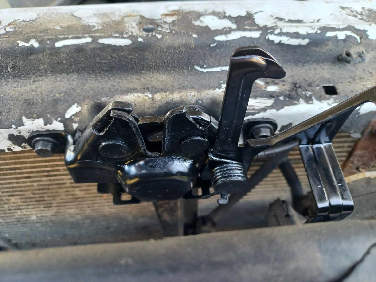

    The hood mechanism's wire decided to snap leaving my hood closed.
    Pro tip: Jam a screwdriver in the right most hole as seen below
    pop that bitch up and replace. Honestly, the most time was spent on releasing the hood from the latch itself. Running the wire back in the cab was easy 10 mm bolts all around.
