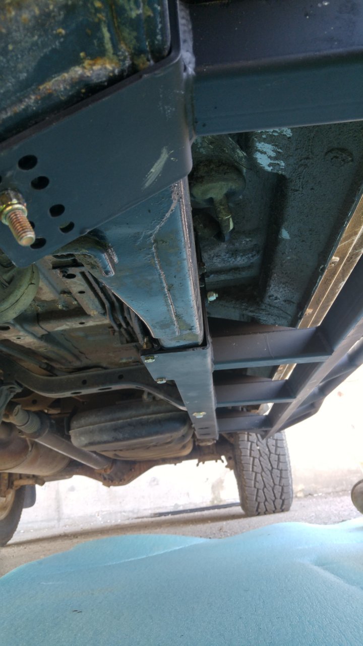

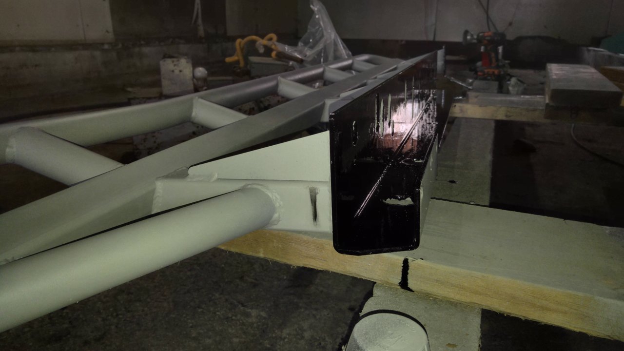

    All of them

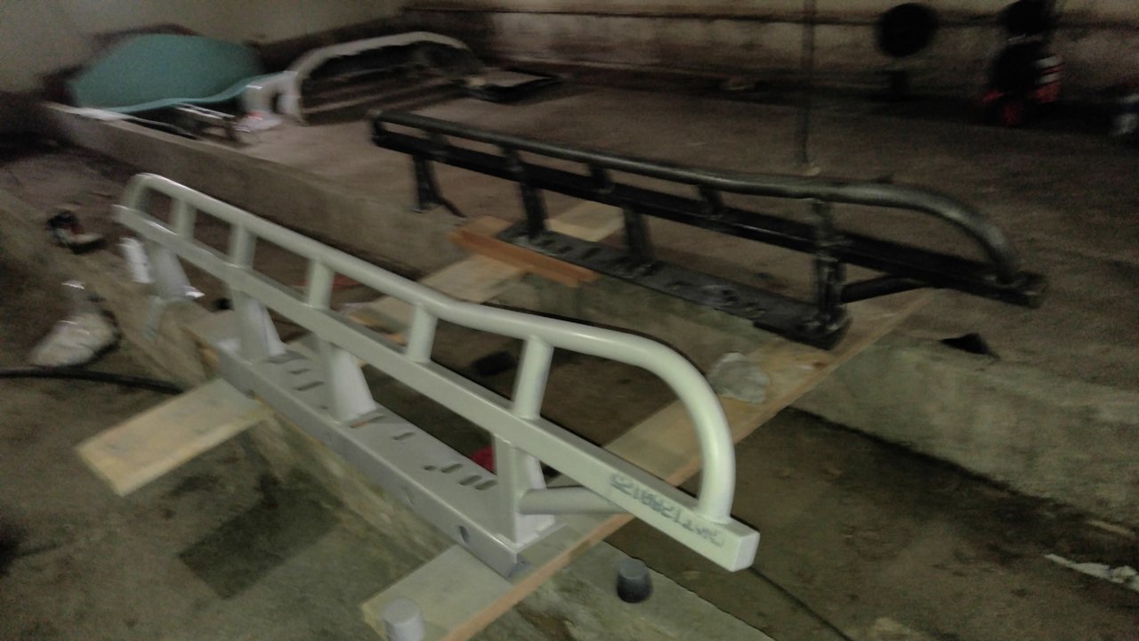

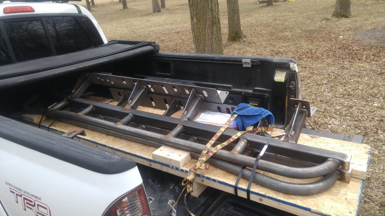

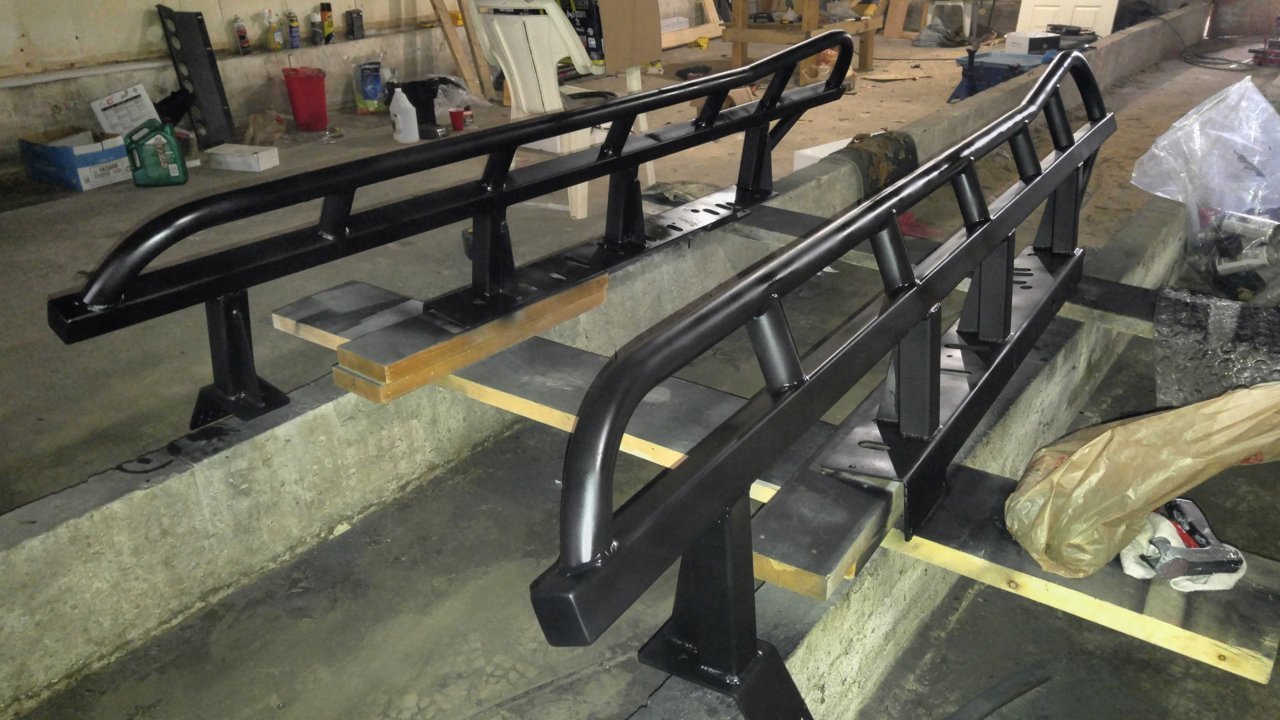

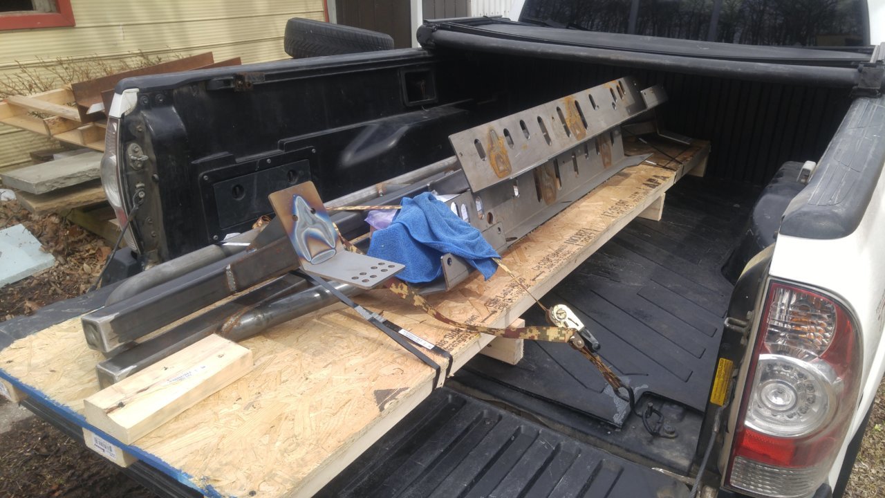

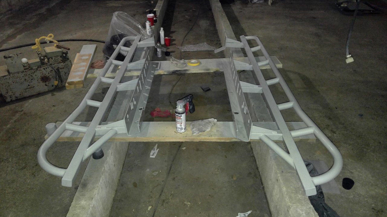

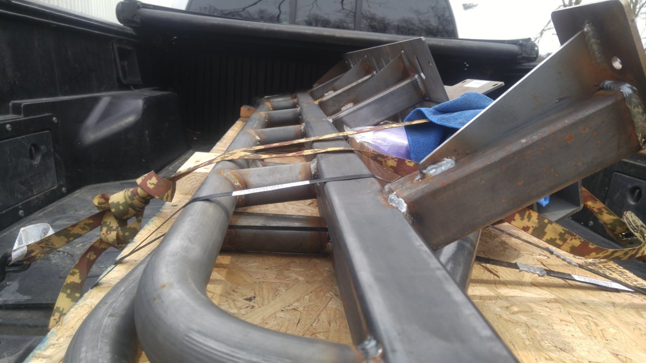

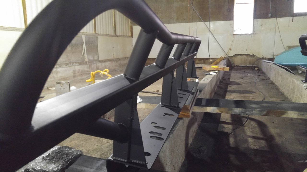

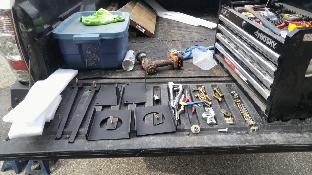

    Brace yourself. Pic heavy rock slider install
    Day 1: Pick up

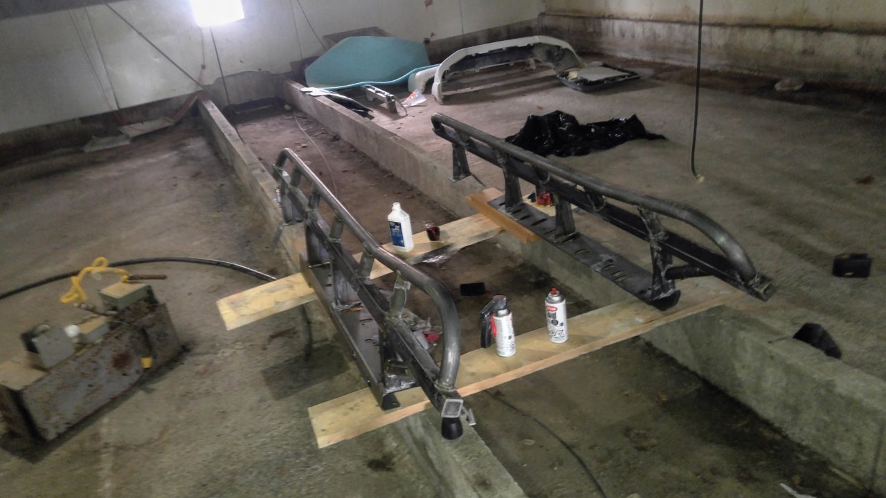

    Day 2: Prep
    Etch and Prep + Acetone + clean
    First coat Primer
    2nd coat primer
    POR-15 in the channel that will attach to the frame, as well the weld point slightly left of the channel, in case any water pools up
    Aweee yeaaa - First coat of matte black
    3rd/Final Coat of primer
    Ready to be installed

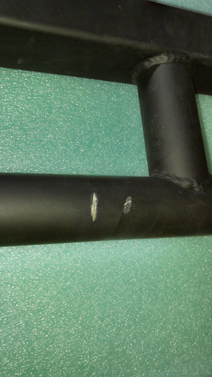

    Scratched it before the install. Makes me feel good that I didn't scratch a $200-$300 coat of powder coating. $8 can will fix that haha

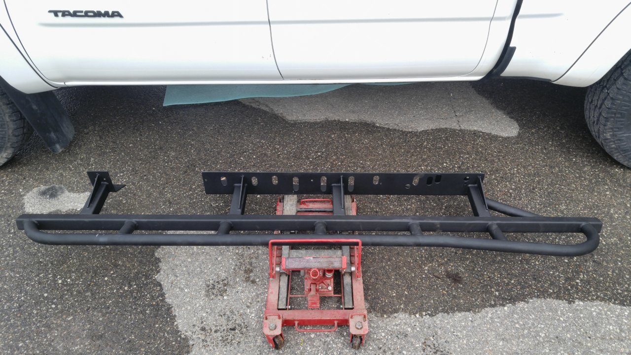

    Parts ready to go, painted them matte black to differ some errosion
    Install was a son of a bitch.

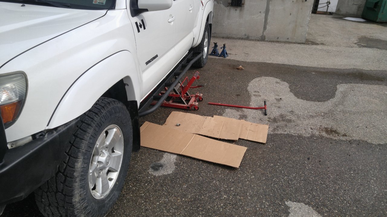

    Prep was interesting, did the install 98% by myself took me about 6+ hours, so pro tip? take the afternoon to do it with a buddy.
    Used a motorcycle jack. helps greatly. You can see the scratch in between the 1st and 2nd bar towards the front end.
    its coming along :)
    Drivers side definitely took longer (moving fuel lines, getting my hand in behind the fuel tank and frame)

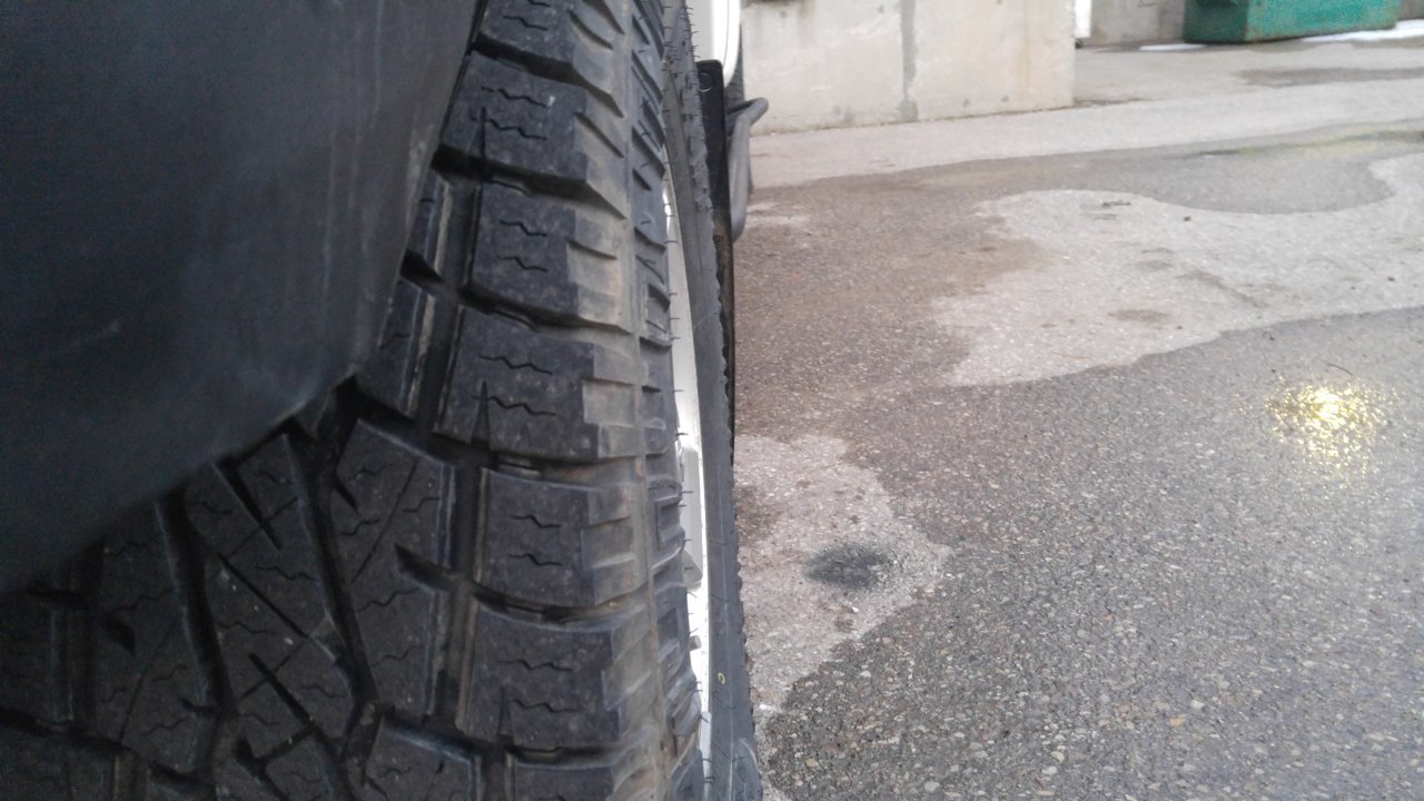

    Slider Profile. Kickout definitely worth it
    All in all a long install. Worth it.
