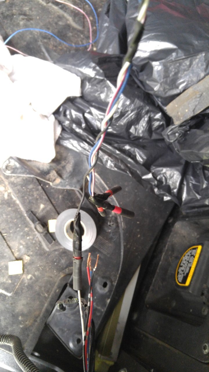

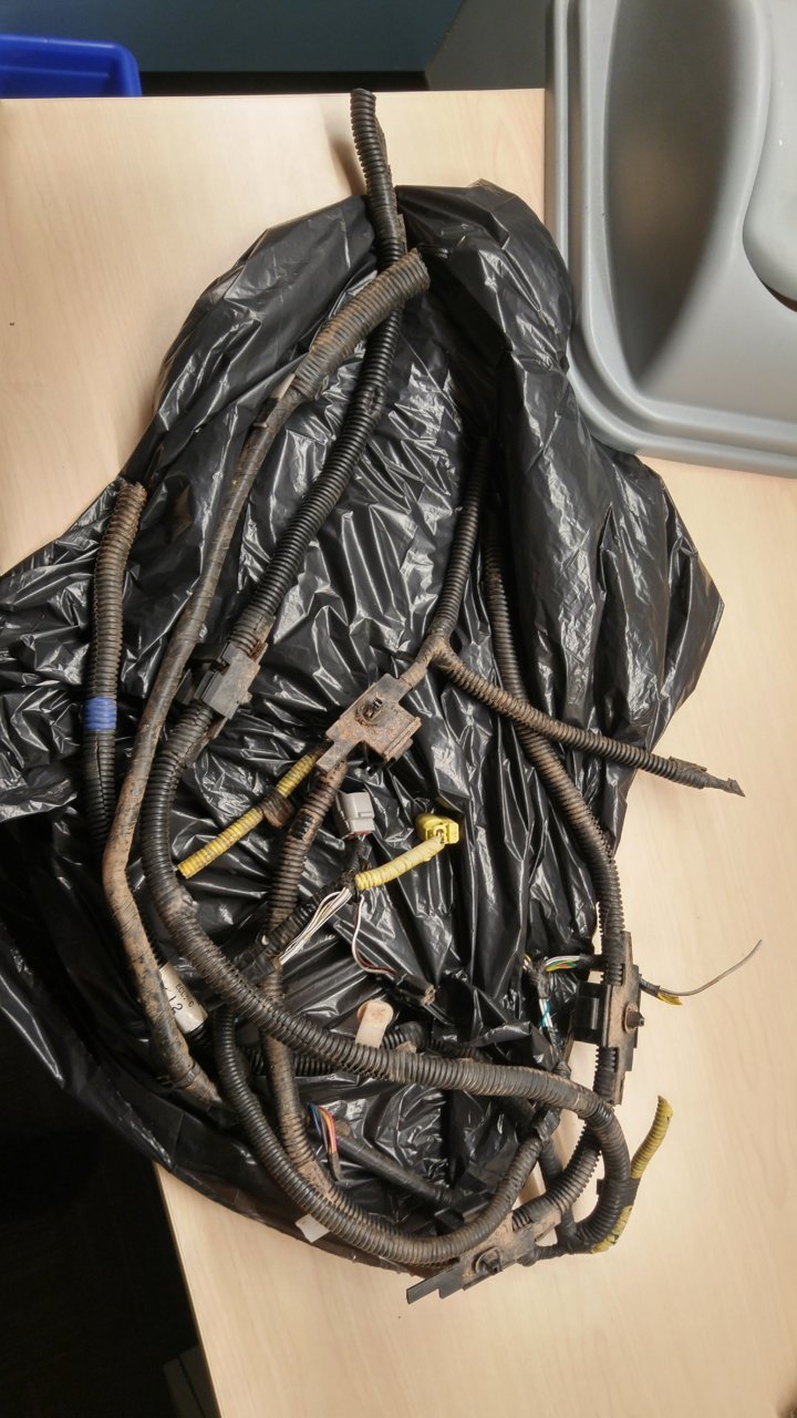

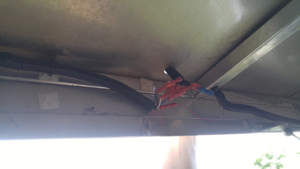

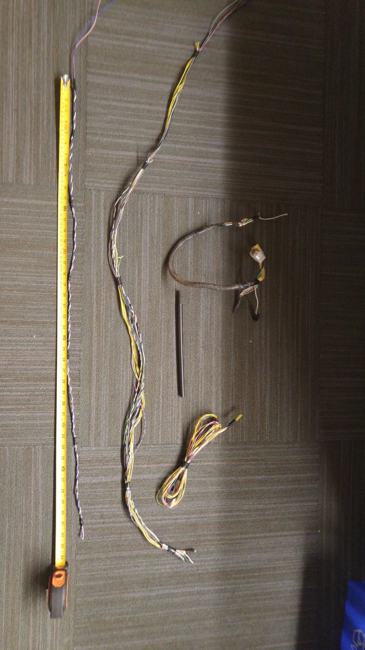

    Was going to journey to Princess Auto for some 22 gauge wire. Ended up going to a junkyard. Asked if they had any tacomas out back and the guy said "ya we don't get many in here we might have 2." so he took me out back and sure enough only had a 1st gen and 2nd that were almost all but gone.
    He took his clipers and cut off a bunch of wires, handed it to me and when I asked how much he said don't worry about it. Fucking awesome deal ahha.
    Spent sometime stripping all the funk down to get this:
    Still a nervous job and ran into a few frustrations with wires falling out but successfull extended the rear camera wire harness and is wrapped up water tight, protected and secured.
    Still need to find a bracket that points at the appropriate angle and hoping the brake light doesn't add too much hue to the video image.

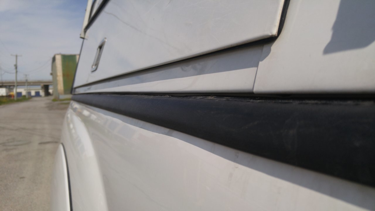

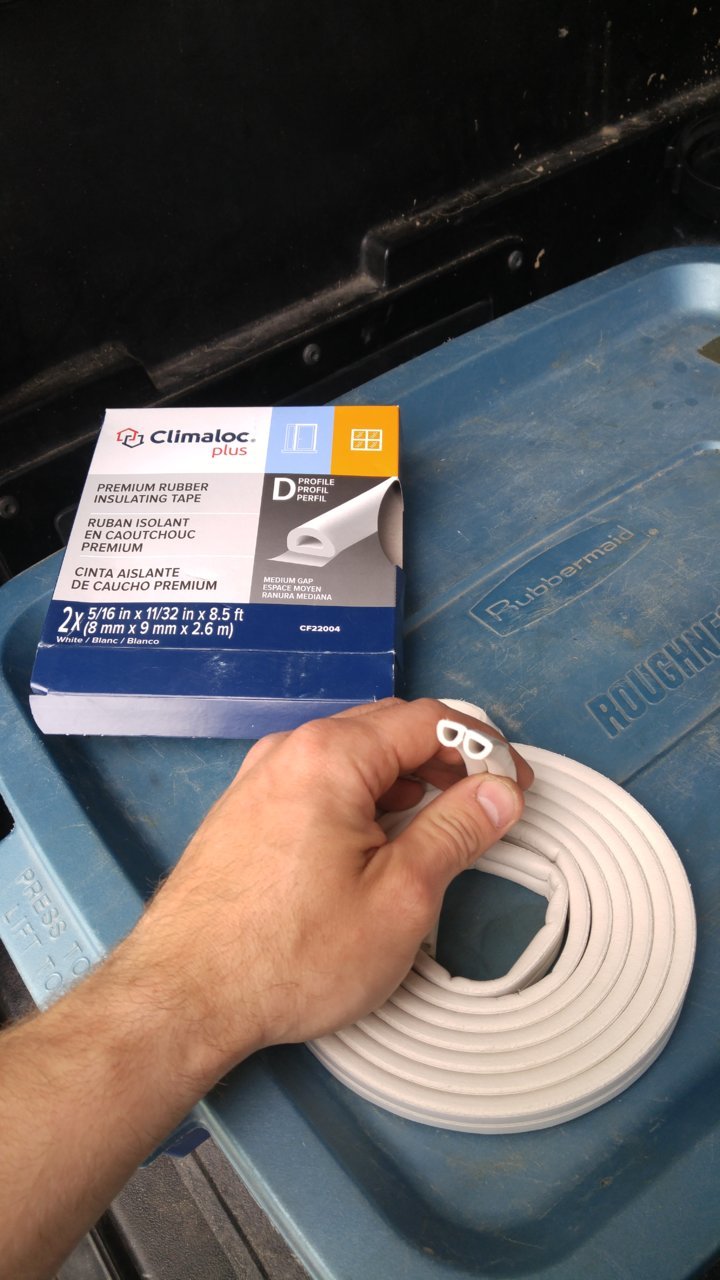

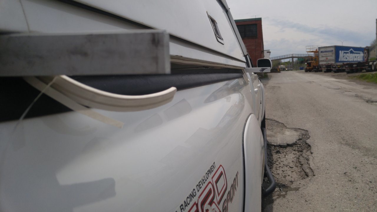

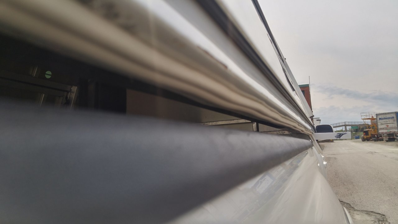

    Huge camper cap update for the white rhino.
    Sealed the forward edge, which for some reason had about a half an inch gap. Plugged it with a pipe insulator and cut to fit.
    Sealed the bottom edge of the perimeter of the cap so should be water tight.
    Before dropping the cap down and tightening the clamps
    Final product

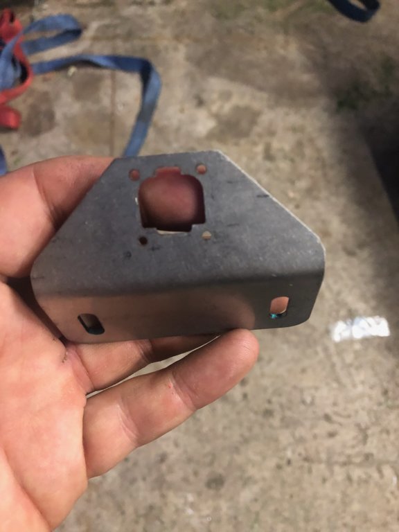

    That does help. I have to check the bracket for you tonight. I’ll send you a pm.

    May work with a bit of filing.

    Looks like it's doable. To achieve that angle I may need to add on a sort of "L" bracket it's looking better than my alternatives right now. Shoot me a text on how much you want for it and we'll go from there

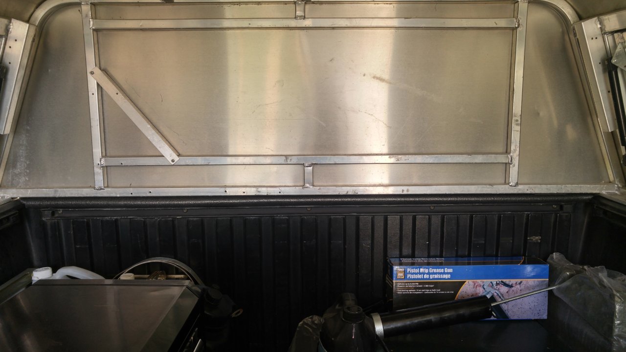

    Don't know how to utilize the space on the back of the door so I'm open for suggestions

    using rivet nuts you could bolt any light item you would like.
    I am planning on using a cord of some kind to hold paper towels and towels. May run a magnetic strip to hold cooking tools while cooking. I have used aluminum plate between the crossbars to mount a water pump.

    ya its a pretty interesting spot, any of the stuff I wanna put there has to be relatively flat. First aid kit, frying pans, maybe some cooking utensils. I like your ideas

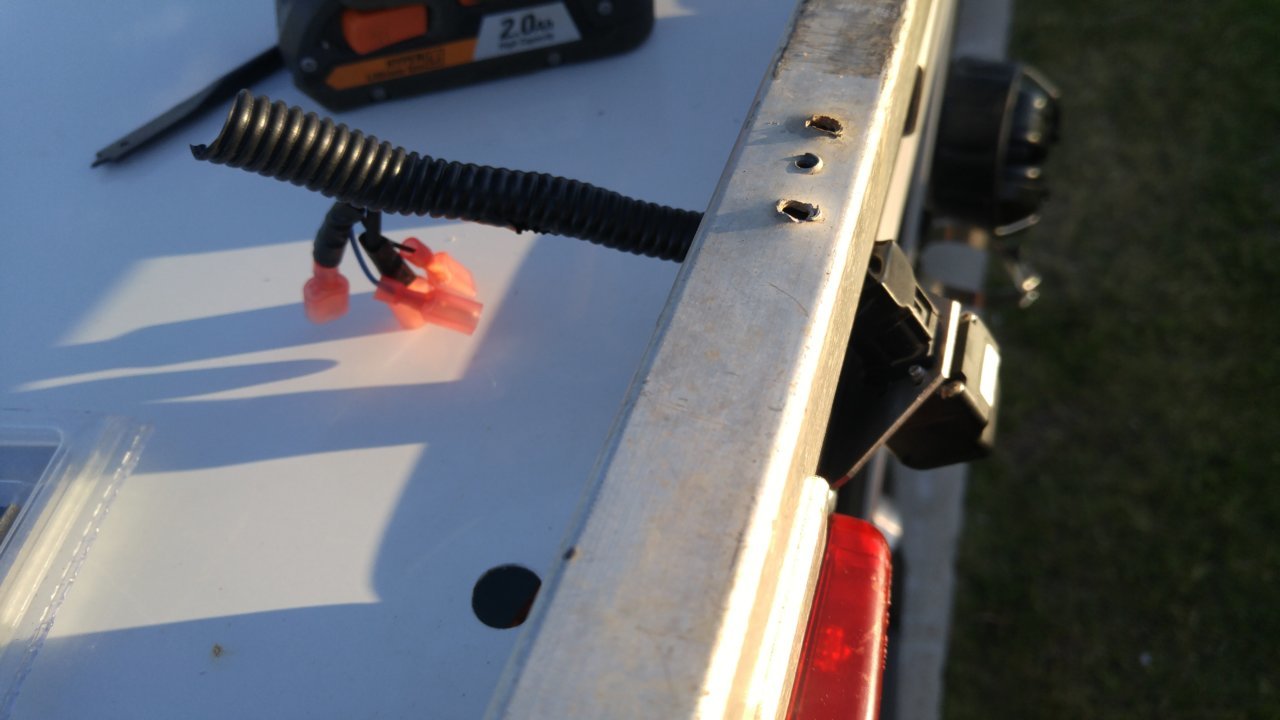

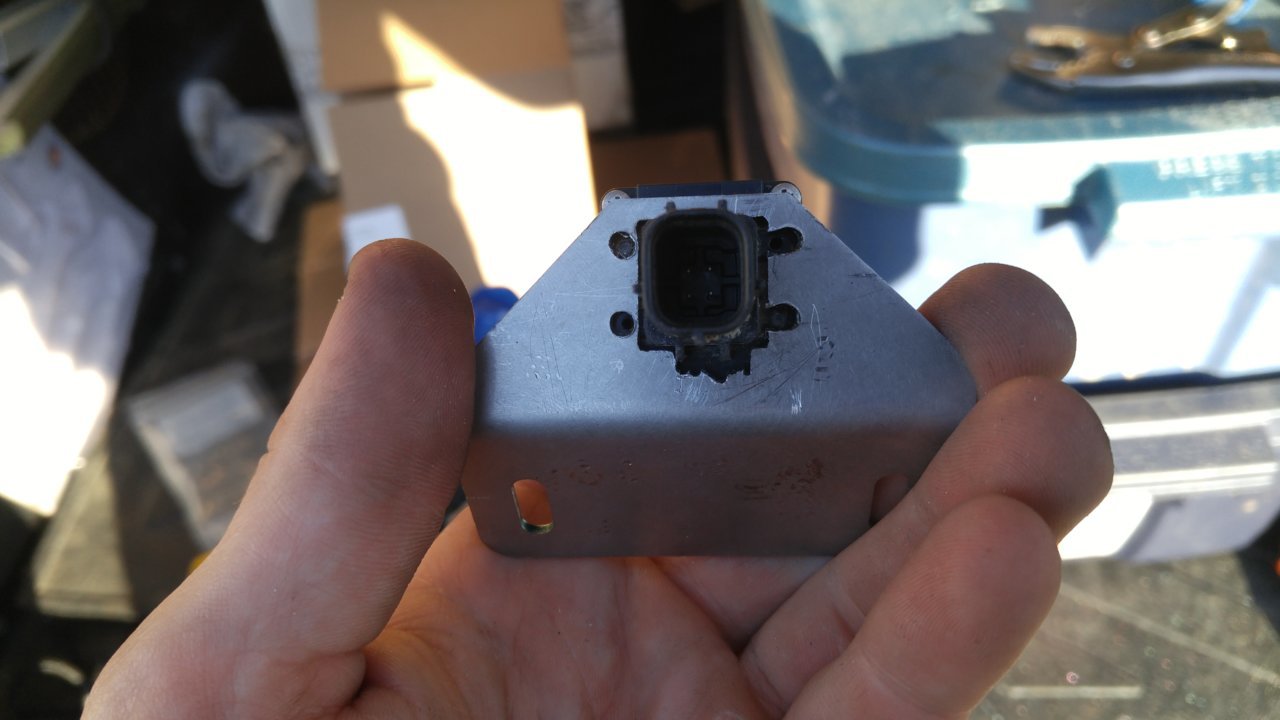

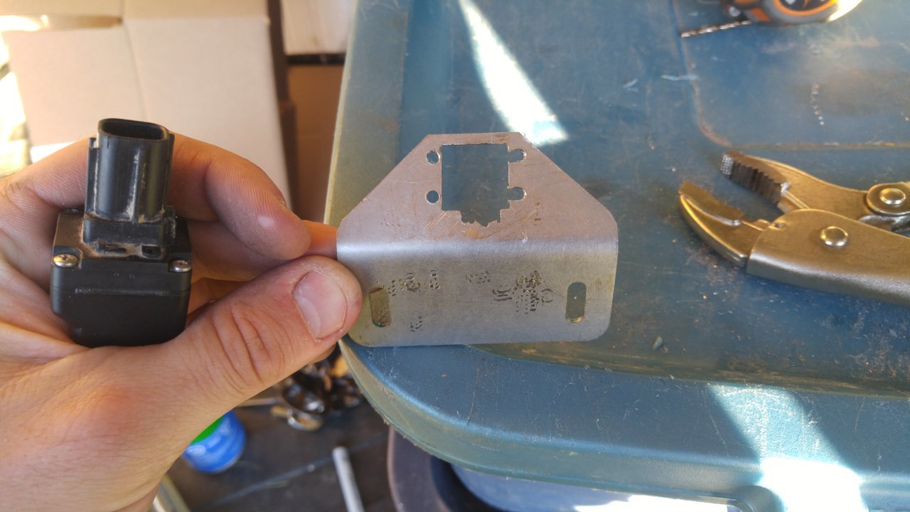

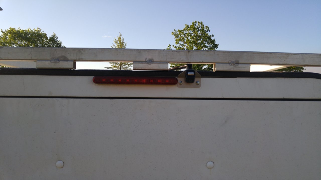

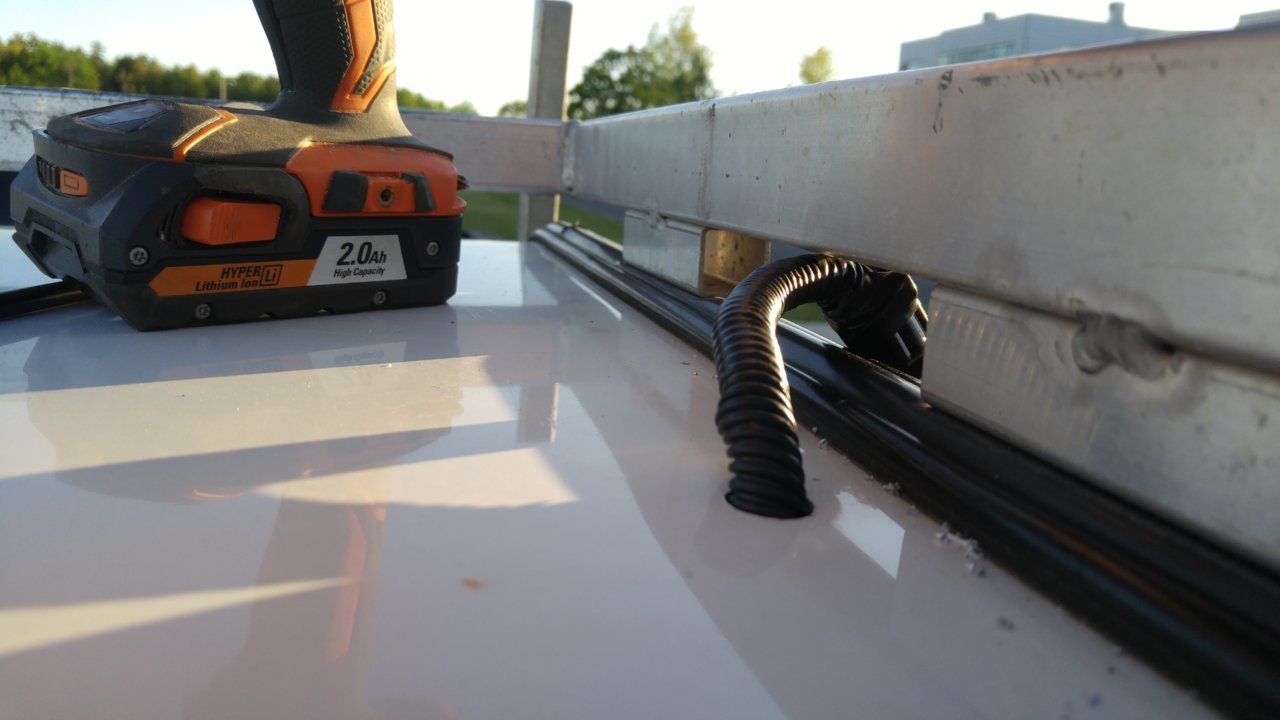

    Its mostly in place thanks to @tacoma16
    started with this
    Filled and cut with a tiny ass hacksaw
    to this
    looks like an abortion but works
    followed by a 9/16 hole through the cap.
    and where she sits now.
    SUCCESS!
    a scary and some time frustrating mod. ALSO, going to test it at night to see if the truck cap will give a red hue, flooding the video with some bad image. If all is good, will silicone the hole and tuck the wires away a lot neater.

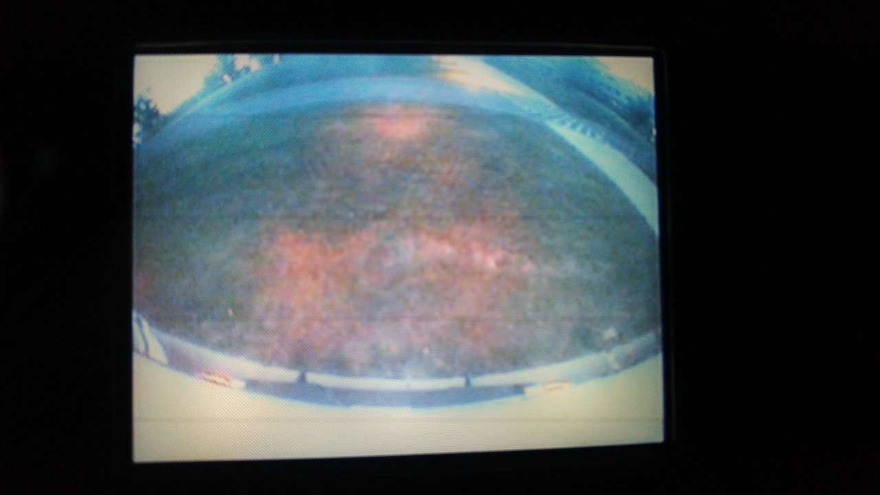

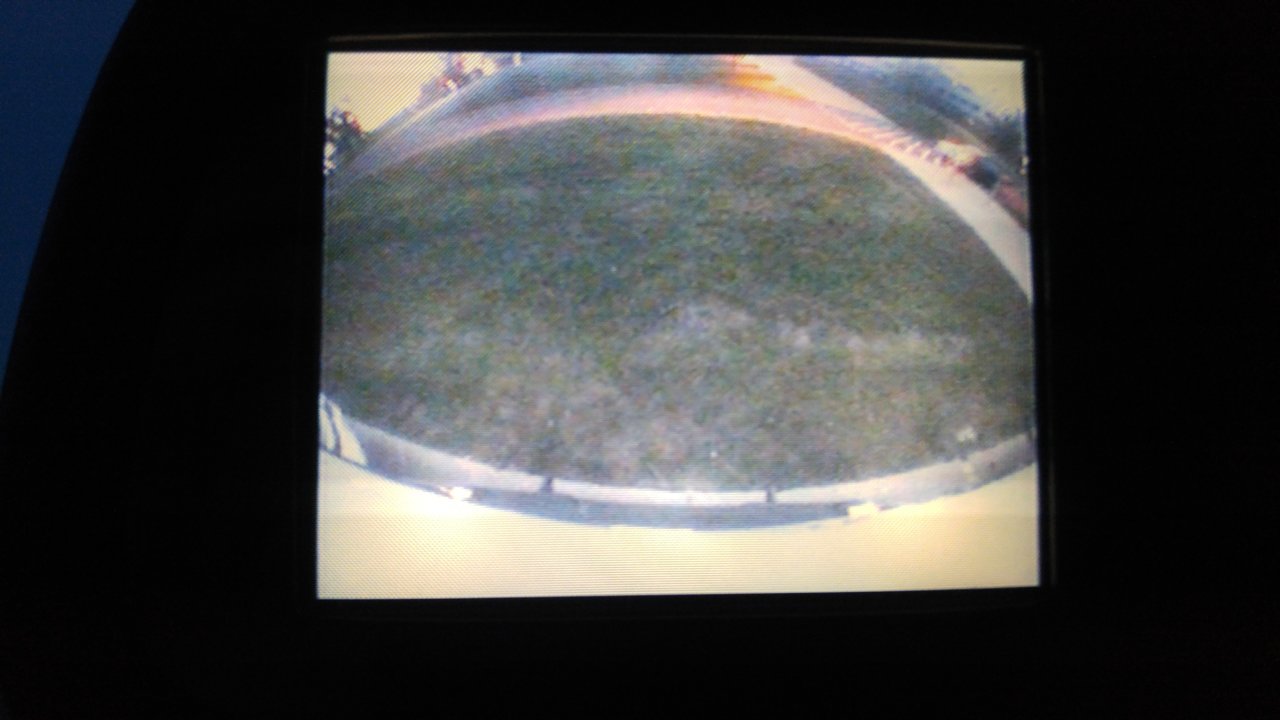

    No hue when backing. I think I can call this a success
    Backing with no brake applied vs brake applied
