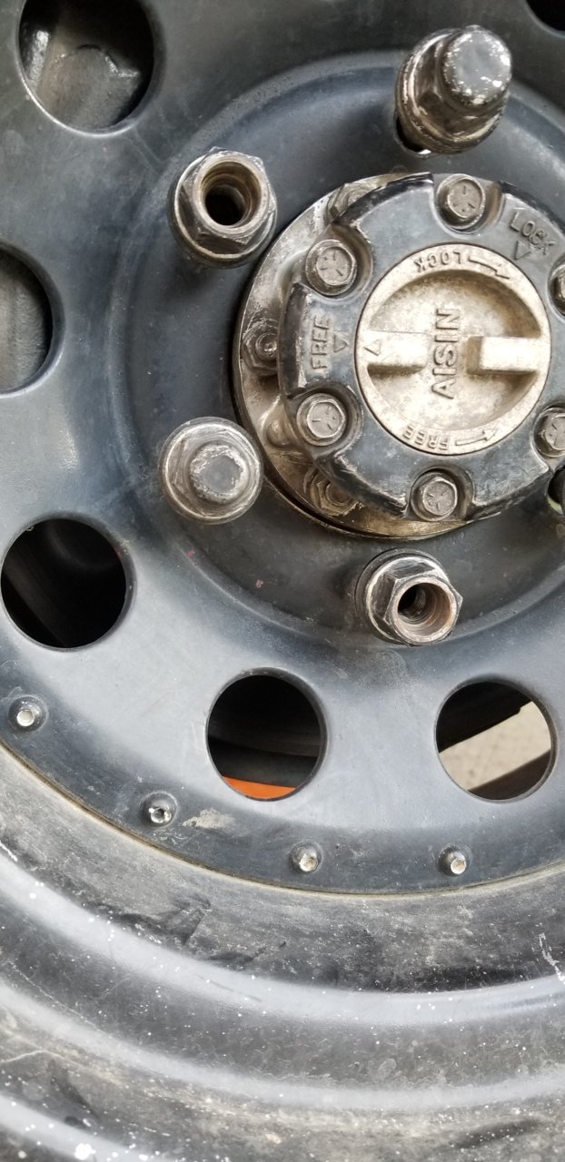

    So I recently noticed that my lug nuts on my Tacoma are not looking too hot. As you can see from the pictures, the seats of some of the lugs are completely mangled. They still hold my rims on just fine, but I am wondering if the slight difference in hub diameter and wheel "hub hole" (not sure what to call it) is causing my lugs to take all of the weight therefore trashing the seats.
    I tried to get my calipers on the inside of my rim to measure the diameter, but they extend too far preventing me from being able to measure it. The wheel studs also get in the way of me being able to measure the hub diameter.
    My best guess is that I need hub centric rings to relieve the weight off of the lug nuts. What do y'all think?
    The below image is with my truck lifted in the air with the wheel just sitting on the lugs with the nuts just loosely holding it on. You can see the gap between the wheel and hub.

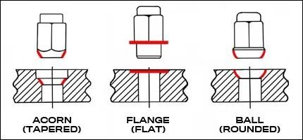

    Those lug nuts are stock hub-centric that come on our trucks. Commonly referred to as a mag or flat seat. Take a close look at the holes in the wheels you have and if you see a beveled edge or taper, you'll need to get the according lug nuts. From the looks of it, the stock lug nuts are just torqued down to seat the wheels to the point that the outer cap was distorted to match the taper in the wheel. The wheels you have (assuming they're aftermarket) will usually require a tapered or ball lug nut. See the example below.

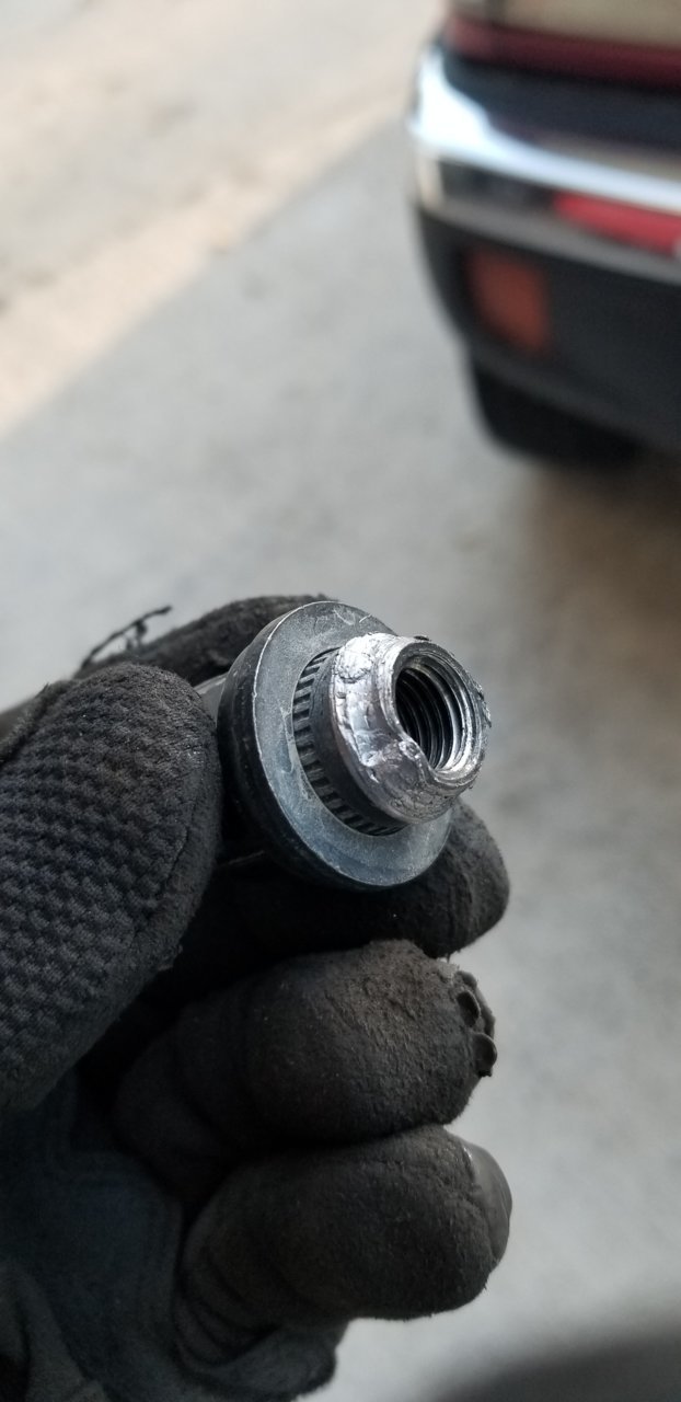

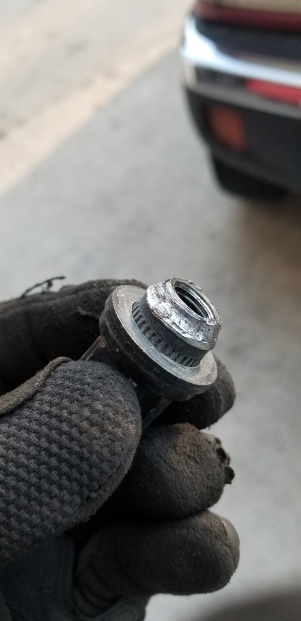

    Gotcha. The lug nuts installed currently are acorn style nuts. I will take a closer look at the seats on the wheels tomorrow to try and determine if they require a different lug nut that what is currently on there.
    Its strange though that the current lug nuts have those washer-like things on them that you cannot take off. They just spin around and do not make contact with any part of the wheel or hub. Kind of like what is pictured in the middle of the image you attached.

    Those aren't acorn lug nuts. They have been torqued into submission to the point where they became acorns. More than likely you actually do need acorn lug nuts though. The washer means that they are mag seats. The sleeve of the lug nuts below the washer is meant to be inserted unto the wheel until the washer bottoms out on the wheel face. The washer is meant to protect the wheel from damage of the lug nut socket. The fact that the lug nut will not insert into the wheel, thus not allowing the washer to make contact with the wheel surface means you have the wrong lug nuts for the wheels you have.

    Looking carefully at the first picture you posted it looks like you have two different types of lug nuts- open ended and OEM style. I'm willing to bet that those "open ended" lug nuts are actually OEM style lug nuts but the chrome cover has come off over the years. The cover or cap is notorious for separating from the nut itself especially on older truck or when an overzealous tech gives it too many ugga-duggas.

    Funny you say that.... The lug nuts with the open ends had caps that came right off when I blasted them with my new impact :rolleyes:.

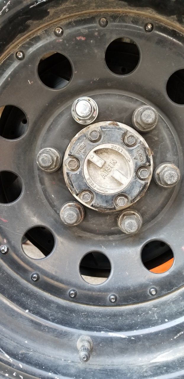

    All this talk has got me thinking, and i actually have different sized rear lug nuts. So those nuts could actually be the correct style for my wheel rather than the "OEM" style ones in the front. I will check tomorrow and hopefully that is the answer I need.
