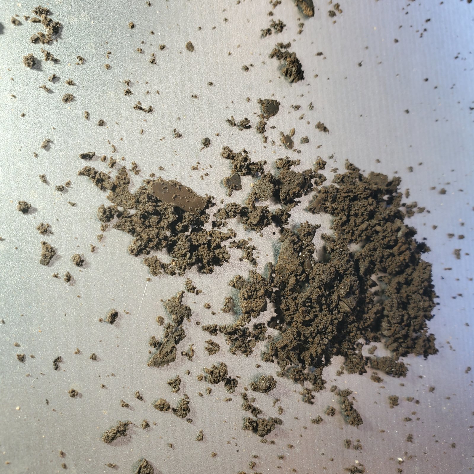

    Looks like dried mud to me.. Mud doesn't always have rock in it.
    K and N might not filter down to the same size particulate as a regular paper filter but the shit in that guys intake is not from from running a K and N.
    Rusty66 and Big tall dave like this.

    Here's another view of what I scraped out. It's brown and resembles dirt. 20231120_104521.jpg

    Crush it with your fingers. If it’s dirt that got through the filter it should be consistent and fine like baby powder.

    Wel whatever it is, it's obvious his truck sees some extra-ordinary conditions. I'd be cleaning stuff out and/or trying different filters if I saw that in my intake. He'll figure it out. Simply checking things more often is half the battle

    When you can read a newspaper through your filter element, it's not doing what it needs to do.
    Even a well cared for K&N will let shit through that has no business in an engine.
    The "Outerwears" help, but at the end of the day, they're just a band aid to the inherent design flaw that is oiled cotton gauze filter.
