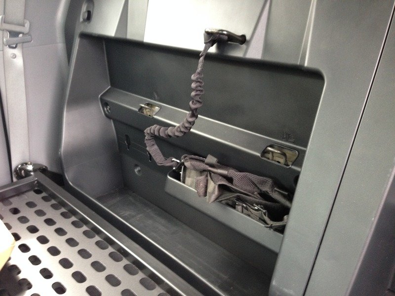

    Dog harness holder.

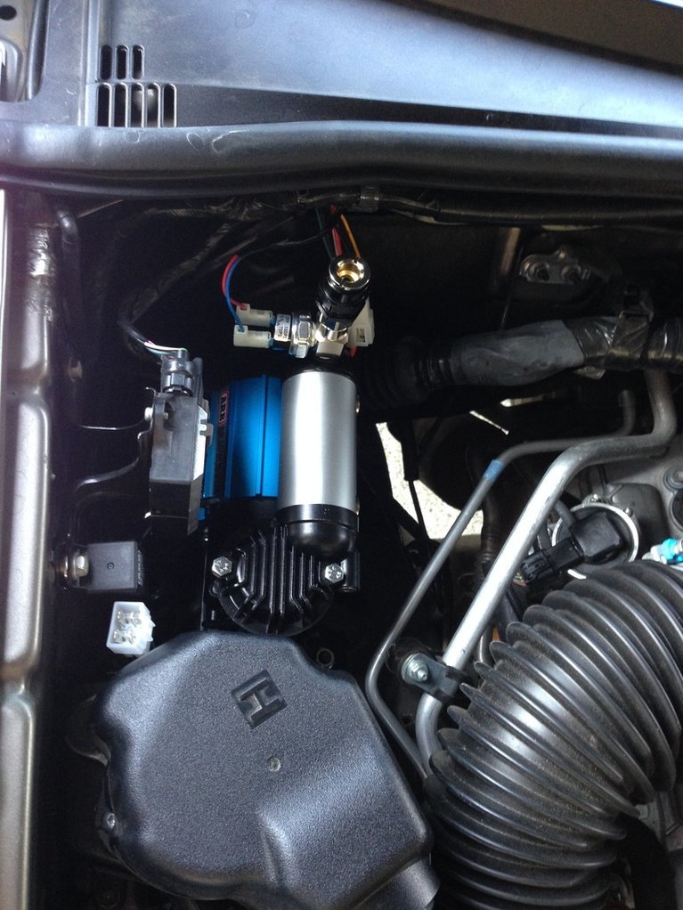

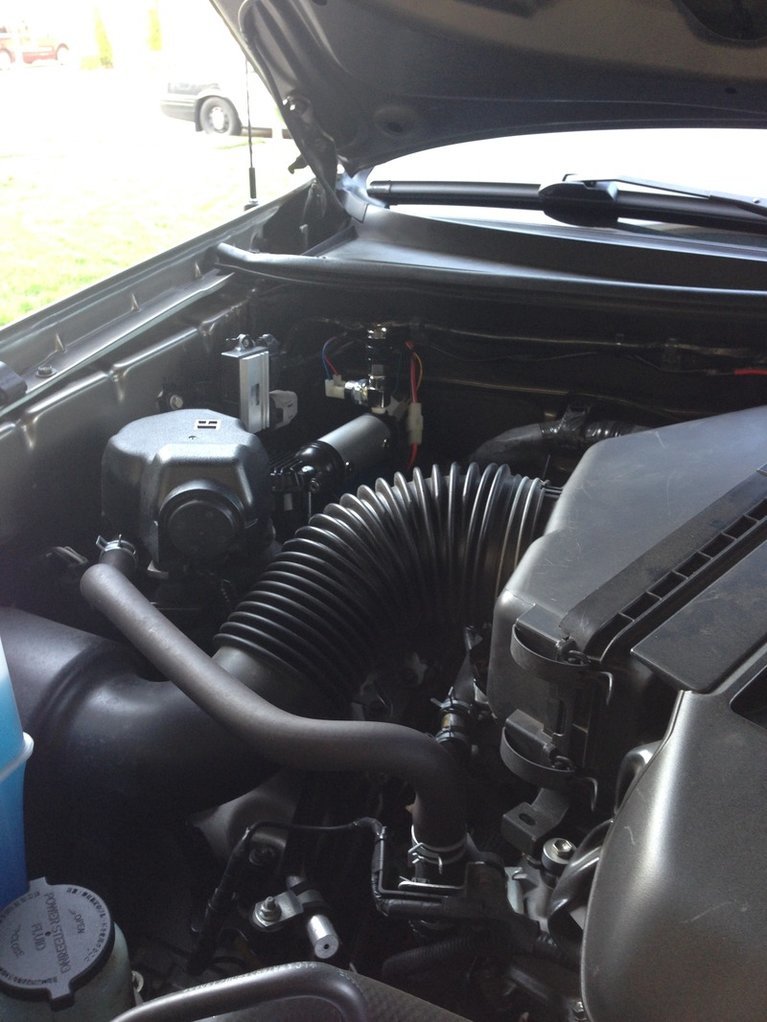

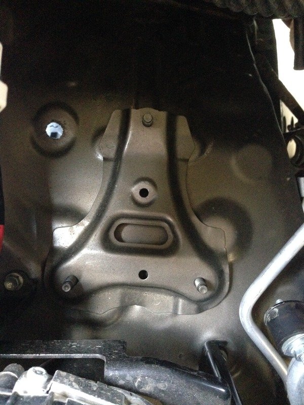

    I decided to install my compressor on the passenger side wheel well in the engine compartment using the three studs you can see here. I had to drill through a couple of the spot welds and add nuts and bolts, as the compressor was too heavy for the factory bracket's welds.
    A92794AD-44B1-4500-853C-4514857E5062_zps_56d5597e324515585d369566d43cd3ddbf11facf.jpg
    After a couple of design changes to my bracket, I ended up with this;
    E22EF019-1CB8-44A2-B6FA-B28F1FF3813D_zps_39ee2987e73391ca5fcc4eaa70d9e01cb5de6757.jpg
    709B5FAC-7B2B-413E-B527-1E6B9012964A_zps_be7f22324d8ed9edef630f68675f481ec3baa178.jpg
    Still need to figure out a place to temporarliy mount the switch in the engine bay. I don't want to run it into the passenger cabin, as I will eventually be adding an sPod.

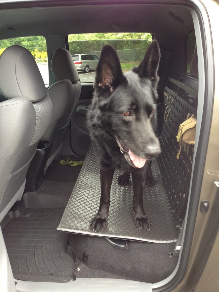

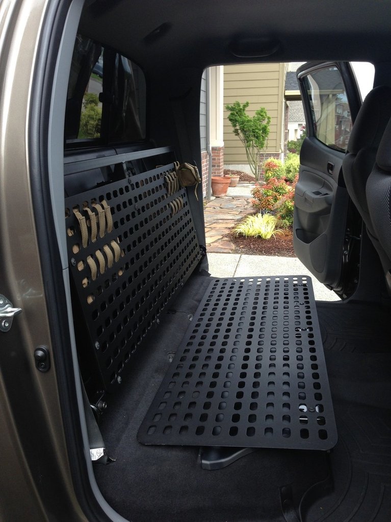

    More pics of the MOLLE Dog platform here.
