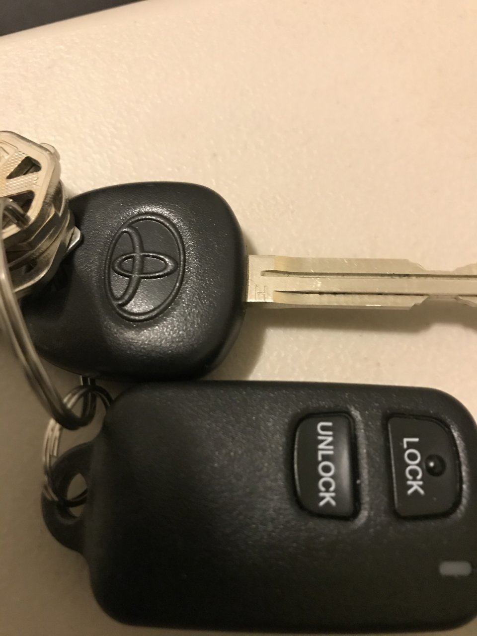

    Yeah I know there are different key designations, but for information my 2019 SR hard key (no fob) is an “H” key. I’ve since added Southeast Toyota keyless entry mod (fob).

    Post a picture of your key if you don’t mind. Pretty sure all H Keys have the integrated FOB, which is what I was talking about.
    Edit: after some research, it appears as though newer SR’s with the regular “dumb” key are stamped with the “H” as well. Just adds to the confusion.

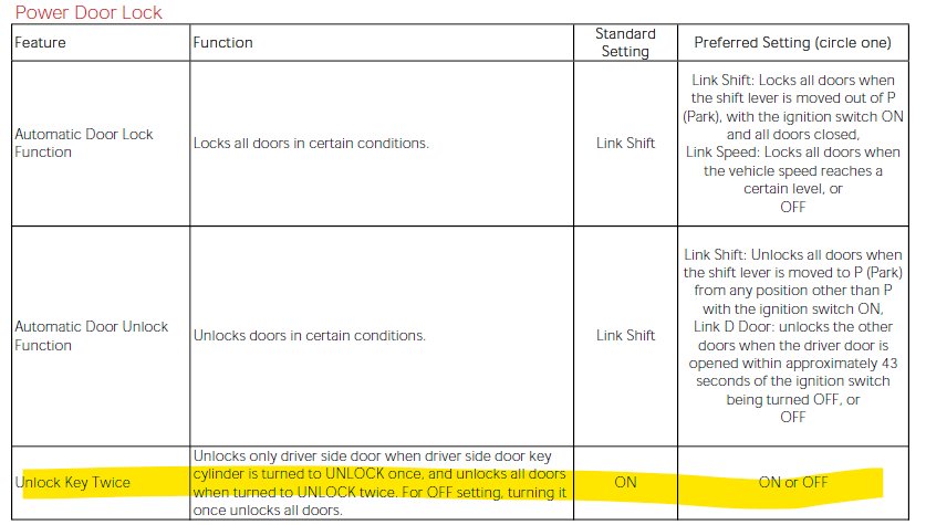

    Sorry, it was in Carista and the parameter title was around the "Wireless door lock" parameter. The parameter names are so way off base that "Wireless Door Lock" Parameter is actually 1-click driver, 2- all doors or not...

    tonered
    tonered bartheloni
    Sep 25, 2017
    #231055
    31,328
    tony
    Lynnwood, WA
    Thanks, Jimmy. But, I think I am more confused now? Sorry! :D
    I agree that the naming is not helpful for some of the parameters. Although from my past experience, the Carista customizations are the same as TS. No more / no less?
    From this description, it sounds like you are talking about this:
    Attached is the whole document that has been passed around.
    I do have this set to Off (all doors unlock).
    Although, I was I was mainly asking about killing the key-in / door-open chime. AFAIK, that isn't killable in TS or Carista, but I don't know every nook and cranny of TS.
    Thanks again! :cheers:

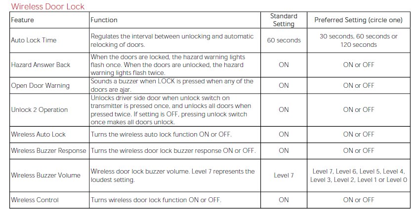

    Any idea if these setting would do it?
    tonered[QUOTED] likes this.

    I have both of those off. They are for the beep volume when you use your key fob.
    Here's the explanation behind those:
    CdnSldr[QUOTED] likes this.

    From reading description and the submenu they're in, I believe they apply to the feedback tone when you lock/unlock your vehicle using fob. The sound level corresponds to how loud the "beep beep" is when unlocking. I turned it down to 3 on mine. I belive if you set Buzzer Response to 'no', you will not get anything.
    Edit: I too looked over all the menus and submenus and couldn't find the magic setting to turn that thing off. I guess you can just disable the Door Ajar push sensor on the side of the driver door but you run the risk of not setting off something else that should when the door is actually open.

    Some time back Toyota started making all the Tacoma keys with the “H” transponder chip code, even the SR models with the hard key. Show me a picture of your H key fob first... lol

    It’s the exact same as the picture I attached in that post with the integrated FOB.

    But how do I know For sure YOUR key has an H? :rolleyes:
    I’m just joking with you for wanting me to prove what I said, eh :D
    Here ya go, every newer SR owner without keyless entry has one like this. The fob is from the Southeast Toyota distributors SR Keyless Entry kit I installed to get keyless entry (must already have power door locks). It works great (panic button is on the back), 2 fobs, and I got it for $100 shipped.

    Lol many members on this forum (including myself occasionally) frequently mislabel/misname things leading to more confusion.
    Yes, your key has an H on it, but is typically not referred to as the “H key” by forum members or forum venders. Specifically remote start venders. If you try and buy a remote start system meant for the “H key” it’s probably not going to be compatible.
    Clear as mud right? Haha
