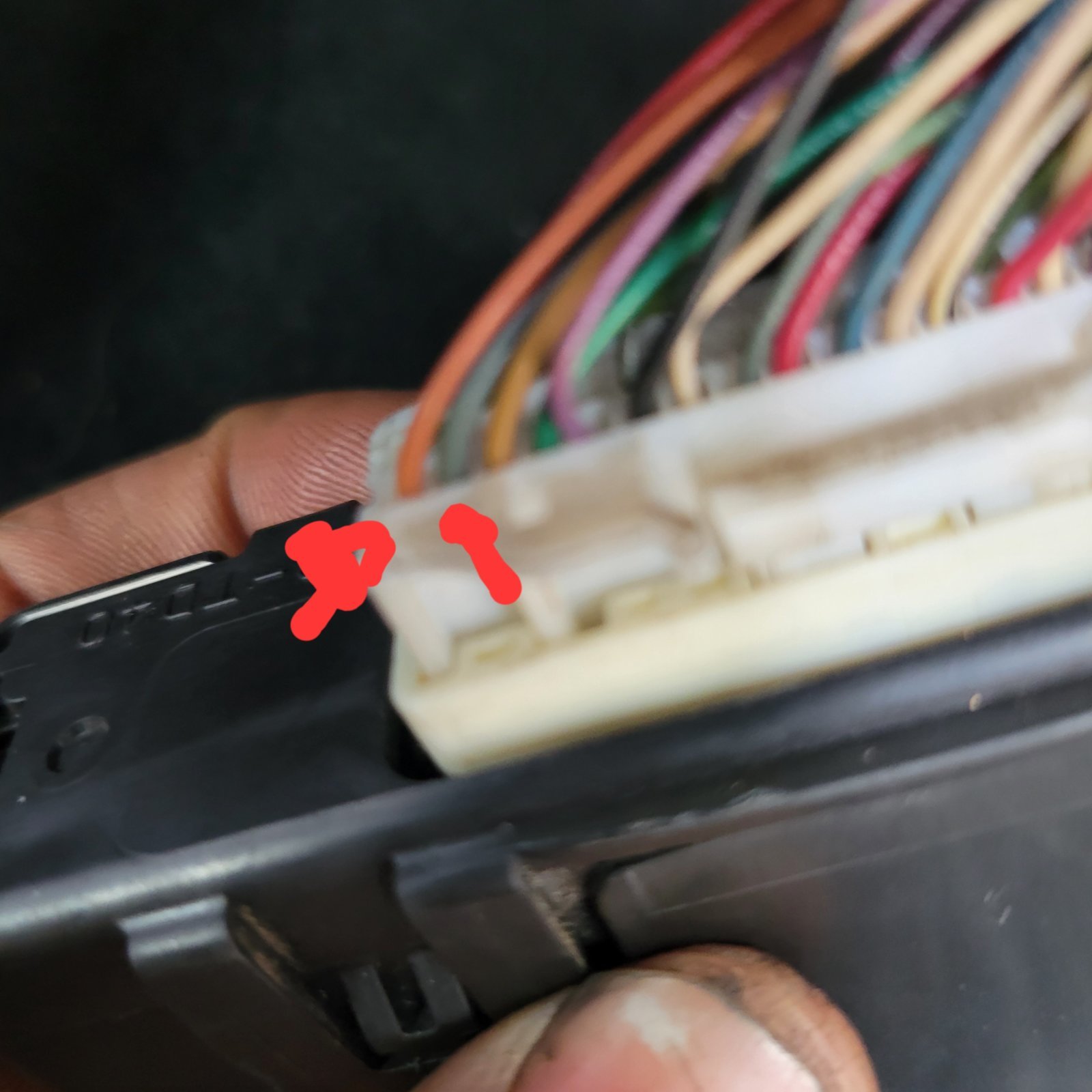

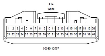

    I am having issue with a/c compressor not turning on I understand if a/c system conditions not right amplifier won't ground magnetic clutch relay coil. Disconnected amplifier and found continuity to relay pin so wires good grounded pin at amplifier harness with tpin and attach allagator clip to ground and checked to confirm at relay pin ground could be put to relay pin. I found two wires that have continuity to each other on amplifier connector side is this an issue? Something around 55ohms. Orange wire and dark bluish wire pins not numbered on connector or a/c amplifier component itself. These two wired I'm questioning are right next to each other. Meter leads probed one from rear one from front to avoid touching and giving false continuity test results. I am looking for a pinout for the connector at a/c amplifier if anyone can help me with that please. I also jumped relay on control side and found a/c compressor to turn on didn't allow to run long as i can't confirm refrigerant or a/c system oil level.

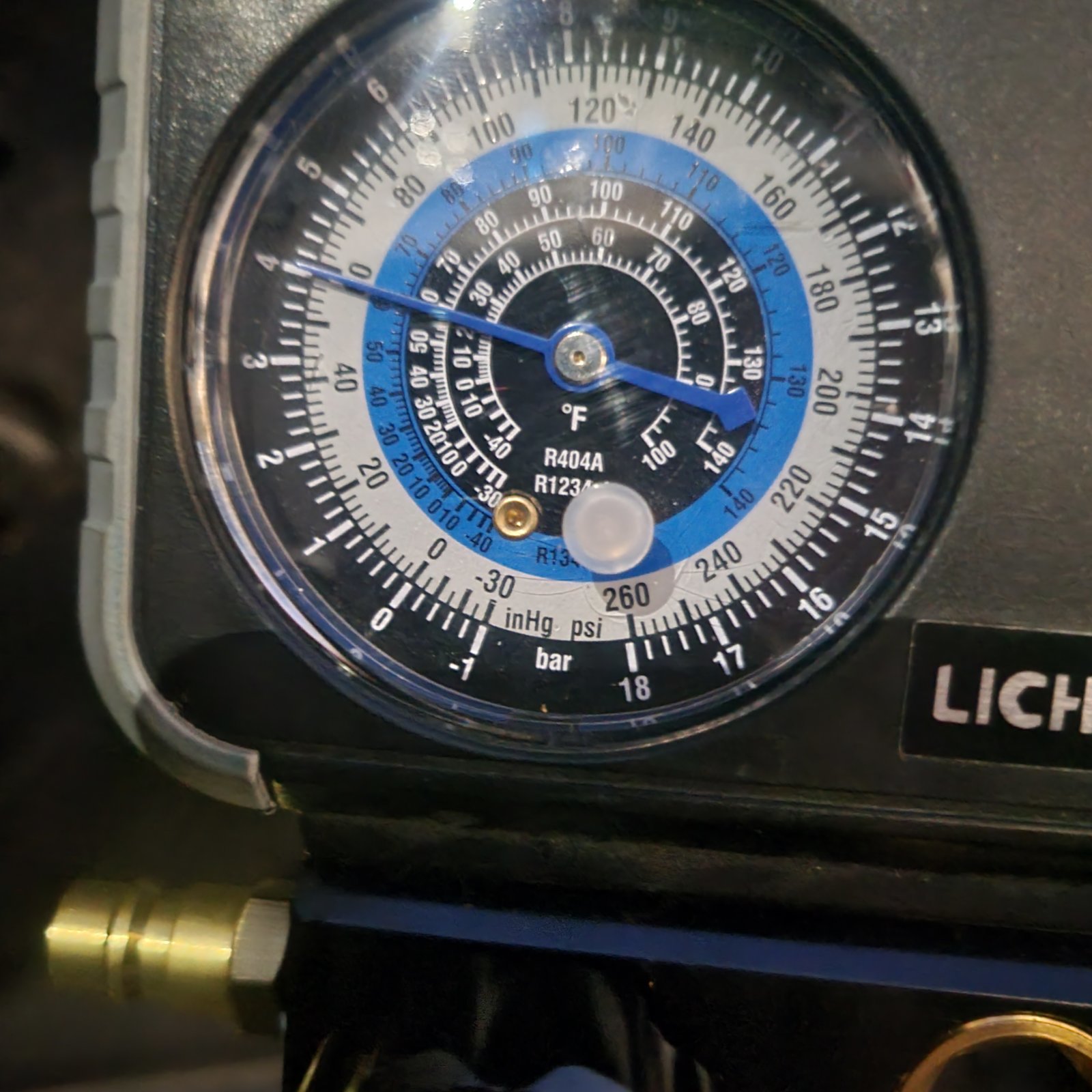

    No the light stays solid got static readings
    20 low
    20ish high
    Not real familiar with using manifold gauge set if any one could link helpful info that would be cool!

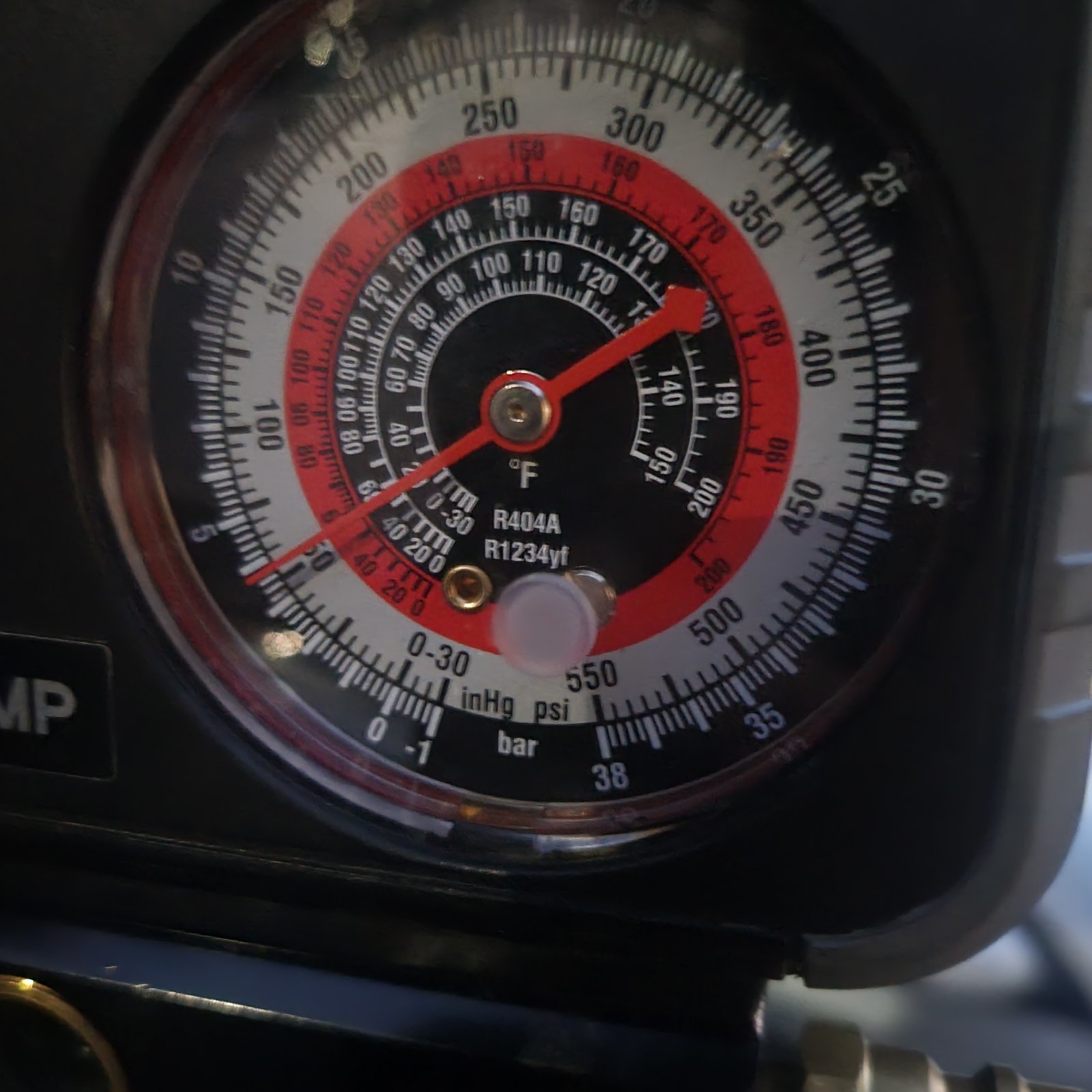

    I charged system now a/c light turns on but cuts out like a pressure switch telling it to cut out
    60 psi low side dynamic testing
    Little over 50 high side
    No a/c compressor operation
  10. Apr 6, 2024 at 6:21 PM
    Blairdev000
    Blairdev000 [OP] Active Member
    Jun 18, 2023
    #427065
    32
    2017 tacoma 4wd V6
    Gauge readings roughly 70 degrees here

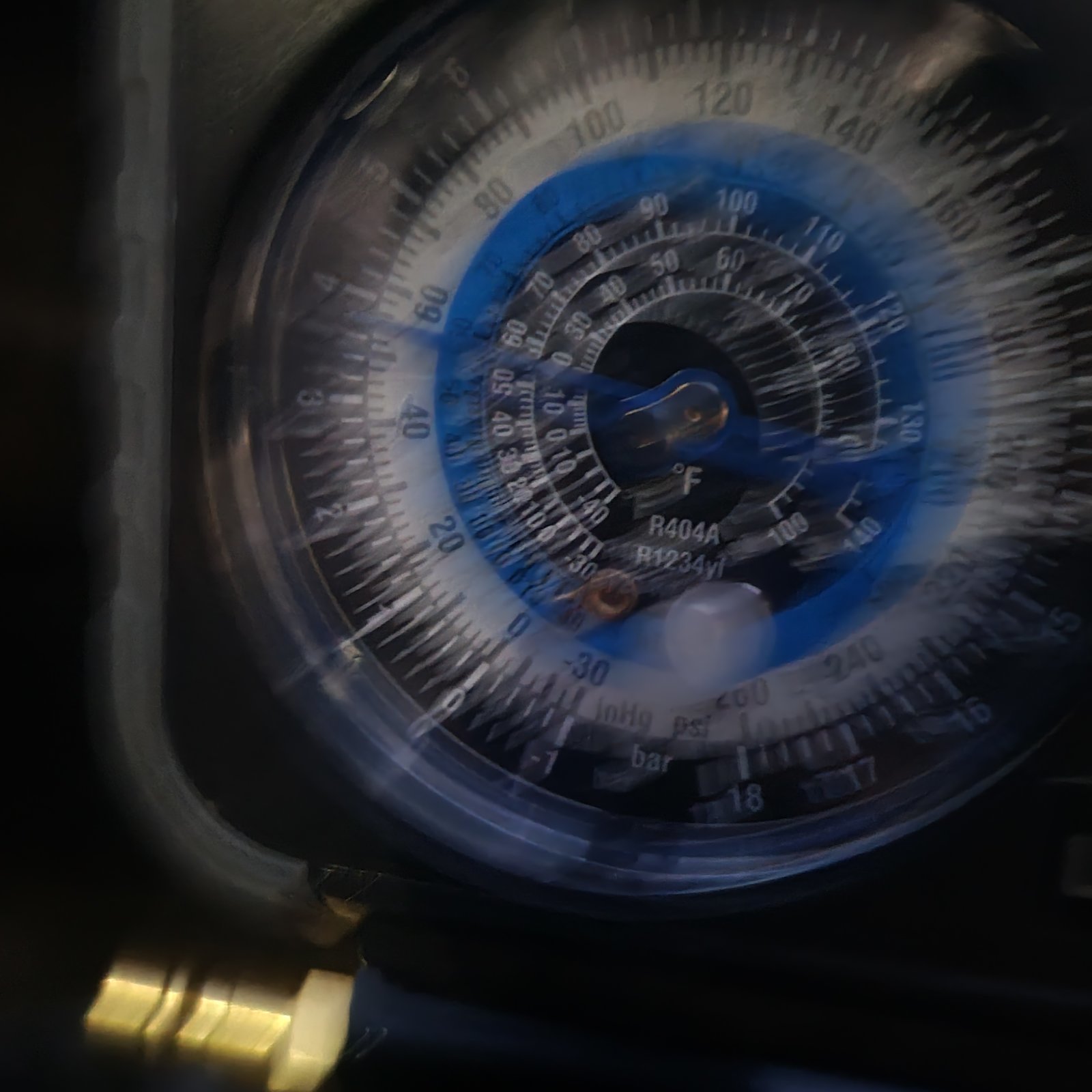

    Clearer image
  12. Apr 6, 2024 at 6:28 PM
    Blairdev000
    Jun 18, 2023
    #427065
    32
    2017 tacoma 4wd V6
    Compressor turns off too fast to get readings don't have a helping hand right now but I can tell it draws low side down and raises high side

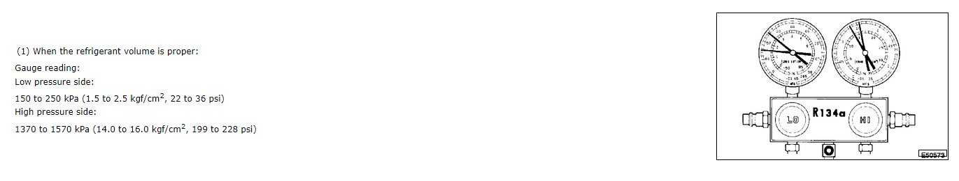

    Looks like a faulty compressor. Pressures should be low side + 100 to 200 more for high side.

    That image you sent shows the gauge to be 134a are those expected values still valid for 1234yf?

    Some reference:
