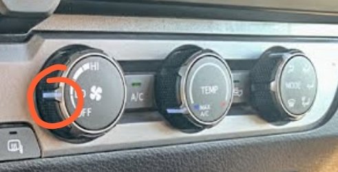

    Does anyone know where I can get the little white indicators for the climate control knobs? I think the previous owner removed them, but it's impossible to see where the knobs are turned in the dark. Pic below is from a truck I saw online. I just have an empty groove where those white bars are. Thanks!

    They're actually clear strip of the knob painted white. You can get some white touch up paint (or whatever color matches your trim) and paint them.

    The piece is actually gone. Nothing to paint!

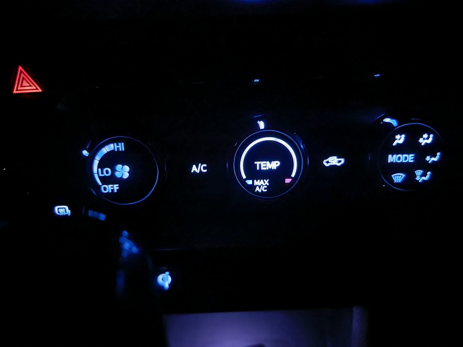

    Update! I bought FO rods from Amazon. I bought them a little large, then cut them down with a fresh straight razor blade.
    End product... I can see where my climate control knobs are at night! Thanks everyone for the advice!

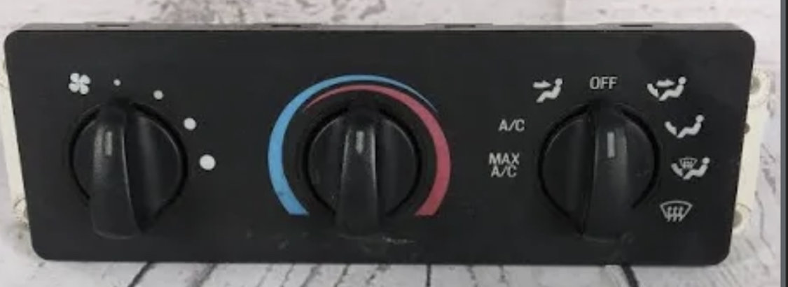

    I’ve been thinking for a while that I would like to design a ring add-on so each dial position is raised and immediately obvious when you touch it. My ‘98 Mazda (Ranger) dials could be adjusted instantly on the fly. You could touch it without looking and know exactly where each dial was and click it or spin it to exactly where it needed to go. I think it was an uglier but superior design.
