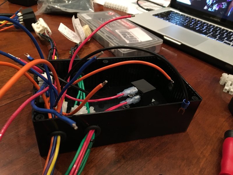

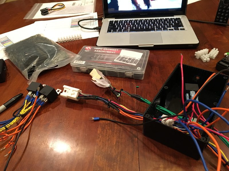

    Been working on fitting all the relays and terminal/junction blocks inside a project enclosure to make everything a little neater.

    I couldn't stand the random relays and junction blocks just hanging there, this makes it look a lot better haha.

    Hopefully tomorrow afternoon. I just had to finish stuffing all that crap inside the project enclosure and wiring the horn relay. I have to stop by my local pick-n-pull in the morning to pick up some parts. Now's a good time to tease my next projects!

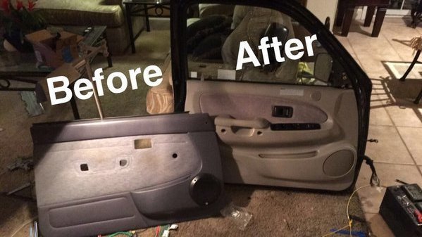

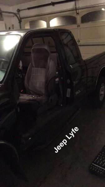

    I'm finally putting all this into the truck tonight. I have the driver's side door off to install everything inside. I've removed all the manual components and I'm working on swapping the key cylinders.
    It's currently 10 PM but damn I'm about to pull and all nighter for this.
  11. Apr 15, 2017 at 12:13 AM
    #91
    BartMaster1234
    BartMaster1234 [OP] American Auto Horns
    Aug 21, 2016
    #195197
    45,642
    Tyler
    San Francisco, California
    Flux Capacitor

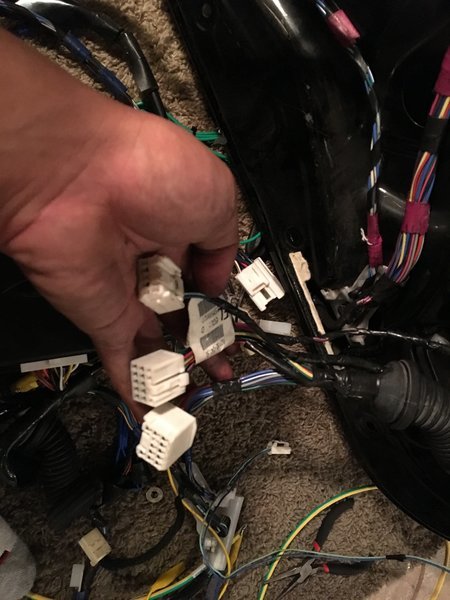

    Update 12:09 AM:
    Lock actuator is installed. Swapping the key cylinders was pretty straightforward, you just need to turn the cylinder counter clockwise. I installed the window regulator and discovered the motor didn't work, turns out it was burnt out. I stole a new one from my spare parts and I went on.
    Right now I'm working on merging the existing '98 speaker wiring with the '04 wiring (so I can have the speaker system be independent of the door system)
    (The smallest connector is the original '98 wiring harness, and the two larger ones are responsible for the '04 components)
    I chose not to use the '04 speaker and tweeter wiring since I want the power door retrofit to be independent of the original '98 wiring.

    To be honest with you I have no idea why I pulled the door off... I was just in the moment. Took about three hours to remove and install everything in just the driver's side door. Good thing it was in the comfort of my nice heated living room and not my freezing garage. Haha.
  15. Apr 15, 2017 at 2:05 AM
    #95
    BartMaster1234
    Aug 21, 2016
    #195197
    45,642
    Tyler
    Flux Capacitor

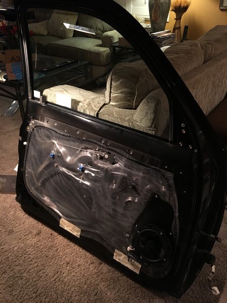

    UPDATE 2:01 AM PST:
    Just finished the driver's side door. I'll do the passenger door and wiring tomorrow, I'm exhausted.
    I ran into some issues when doing the driver's side Swap. First of all the Lock Actuator assembly is an absolute PITA to remove, and re-Install. You need lots of patience for removing the handle, arms, and reinstalling them properly. When reinstalling and removing the glass removing the bolts for the window track helps a lot.
    After installing the '04 window regulator I discovered the motor didn't work. I stole one from my '98 parts doors and it all turned out okay. It worked fine yesterday I don't know what happened. Windows work great now but it's really really slow going up, at least compared to my Mercedes E320 windows.
    Lastly I didn't bother changing the round speaker for the elongated one the '01-'04 model years used, I had to trim a considerable amount of speaker shroud on the door panel for it to fit with a Dremel. It fit just fine afterwards.
    I have to go pick up some replacement plastic sheeting to act as the moisture shield since the old one was basically disintegrating when I removed it. Otherwise the driver's door is complete. Now on to the other door and hooking it all up.

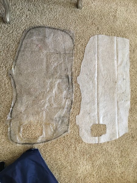

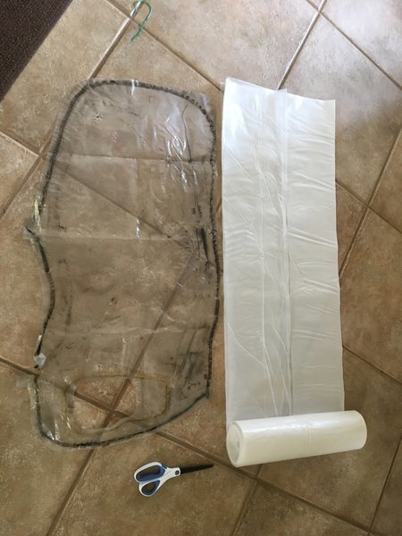

    I dropped by Home Depot to pick up some 4 mil plastic sheeting to replace the original moisture barrier. Also got some RTV Automotive Silicone to seal everything in.
    Once I install the new moisture barrier I'm going to put the driver's side door in and do the passenger side and the wiring. I'll keep you guys updated!

    Attempting to cut a new moisture barrier.

    Painstackinlgy cut the new moisture barrier.
