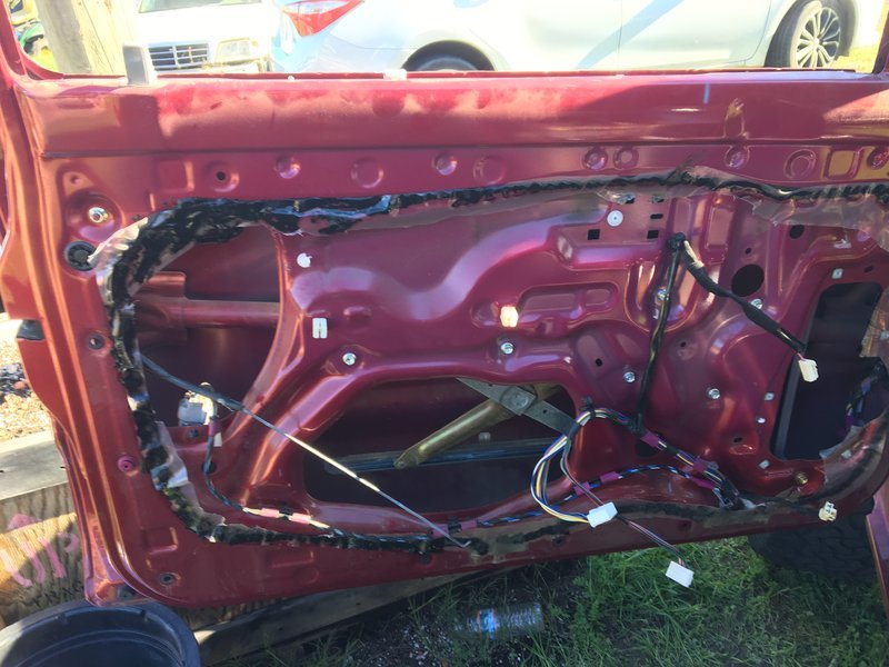

    I was talking to another member who offered his full power door setup as well, and he told me there SHOULD be a connector to plug into behind each kick panel below the connector for the speakers. (Connector 2) This would make the conversion basically plug-n-play. Unfortunately while my Taco did have the plastic housing and room for two connector, it did not have the power door connector and only the speaker connector.
    Would I still be able to do the conversion without them? Pictured are the two connectors for speaker and power door behind the kickplate (I lack connector 2, but have connector 1)
    Here's the harness (I'm presuming the one with two wires is for the speaker). That's a helluva lot of wires for JUST signal and power to the other door. Does the ECU do anything concerning the power doors?

    So that picture showing the labeled connectors 1 and 2 is not your truck? How many wires are coming out of that connector #2 on the door side? It probably makes sense that there are so many. You've got some power going in and a negative/ground going out, but you not only have wires for the windows going to the passenger door, but also those for the locks and the mirror. For that reason, it's probably right that there should be a buttload of wires in connector #2... perhaps a dozen?

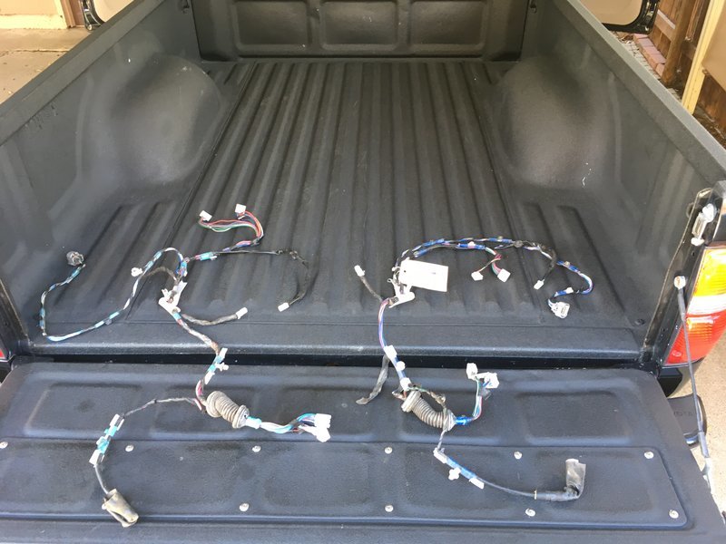

    Nope this was an example truck showing the connector that I lack. I only have connector 1 which is for the speakers. These are the pictures a user sent me. By looking at it, you're right it's at least a dozen wires.
    Wait a minute, wouldn't each power component (mirror, window, warning lights, lock, etc.) each have a ground and a power wire?? That would account for at least 8 wires, with the other 4 presumably for signal.

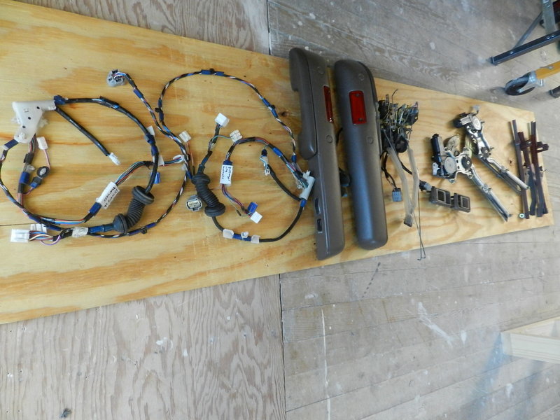

    Here's the harnesses and parts:

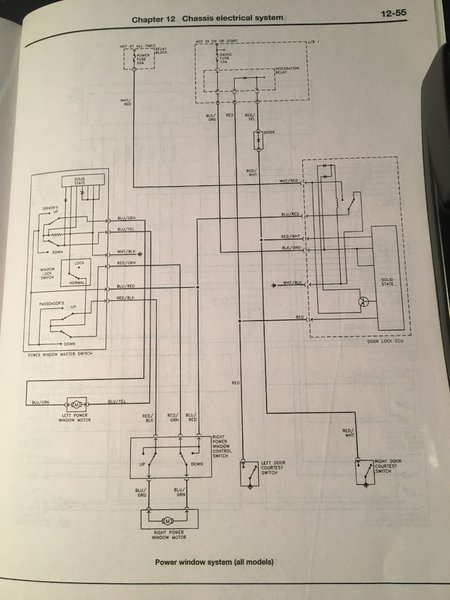

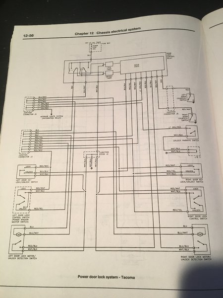

    I just whipped out the Haynes repair manual for the locks and windows. I was right in saying violet and pink wires are for the speakers. Now I can't read schematics for crap. How hard would it be if I cut off a female connector off another truck and wire it up so that it works off 12v? I'm guessing for things like the lock system and warning light is that I'd need a constant 12v so it's powered all the time, and for things like the mirror and window can use a 12v source for when the key is in ACC.
    Would it be that simple? Connecting each accessory to a 12v power source?
    The power window diagram talks about a Door Lock ECU, is this the main engine control unit or something else? Would I need a new ECU to run power locks?

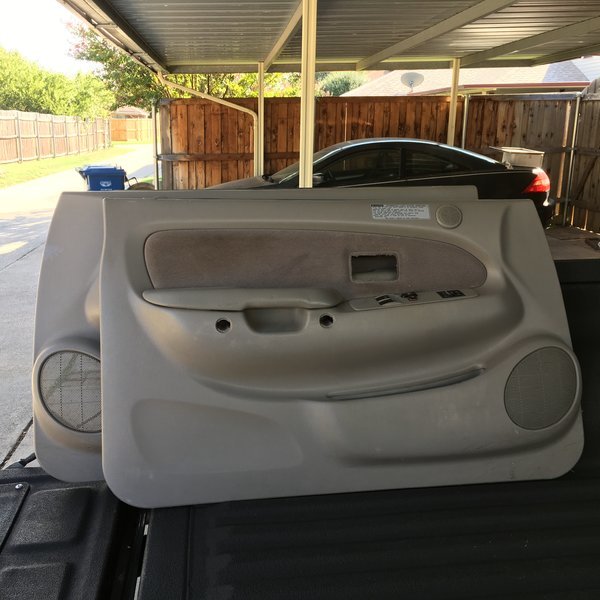

    98 Tacoma SR5 4x4
    Do you still have all the power windows and locks parts? Those door panels are tan and not grey correct?

    Fox 2.0 Coilovers in the front and Fox 2.0’s in the rear, Total Chaos UCA’s, Al-lpro expo leafs, K&N cold air intake, TRD headers,Magnaflow catback exhaust,URD short throw shifter, switched out my 60/40 bench seat for some Tacoma Limited seats, Replaced the vinyl shift boot for a leather one, completely soundproofed the cab w/ Frost King. Replaced stock radio with a Pioneer AVH series head unit. Focal component system w/a 10" sub powered by 2 Alpine amps. Weathertech floor mats. Line-X'd the bed. SCS Ray 10’s, Installed an A.R.E. MX series camper shell. All-Pro Apex front bumper w/ All-Pro skid plates all the way back to the Trans. Low Range fuel skid plate.
    No they're grey but someone already has dibs on them. "Rancho Toyota Recycling" in Cali will most likely have what your looking for, Their in Cali and ship next day. If they don't have it, it wont be too long before they eventually do.

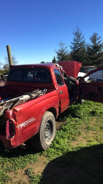

    I decided I wanted to do this properly (and not use crappy aftermarket motors, actuators, and shiz) so I found a wrecked '04 Limited and pulled all the door components out of each door. I also went behind the kick panel and cut as much of the door connector harnesses as I could so I could unplug them and remove the doors if need be.
    The passenger's side door got caved in from the accident and the window regulator got bent beyond repair so I need to pick up a new one. Motor is still good so I should be fine.
    I've been looking at wiring diagrams of the factory service manuals and it doesn't look too bad. 12v in the right places, and signal cables spliced in the right places and you have power everything. I didn't bother using the original alarm and remote key module so I'm going to use a Viper alarm and remote entry module to control the lock actuators. (Would be way too complicated and involve swapping the whole truck wiring harness, B-ECU, and ECU.)
    Here's the truck I got them off of:

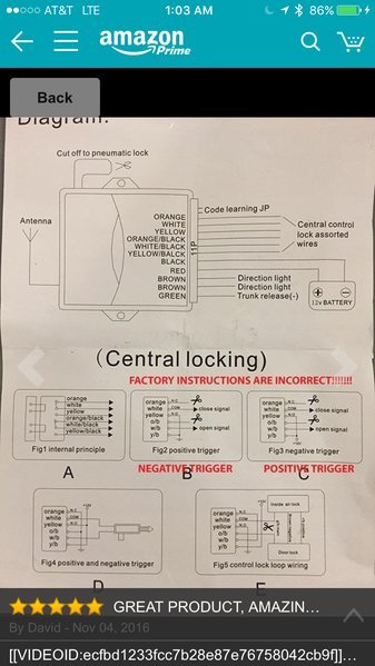

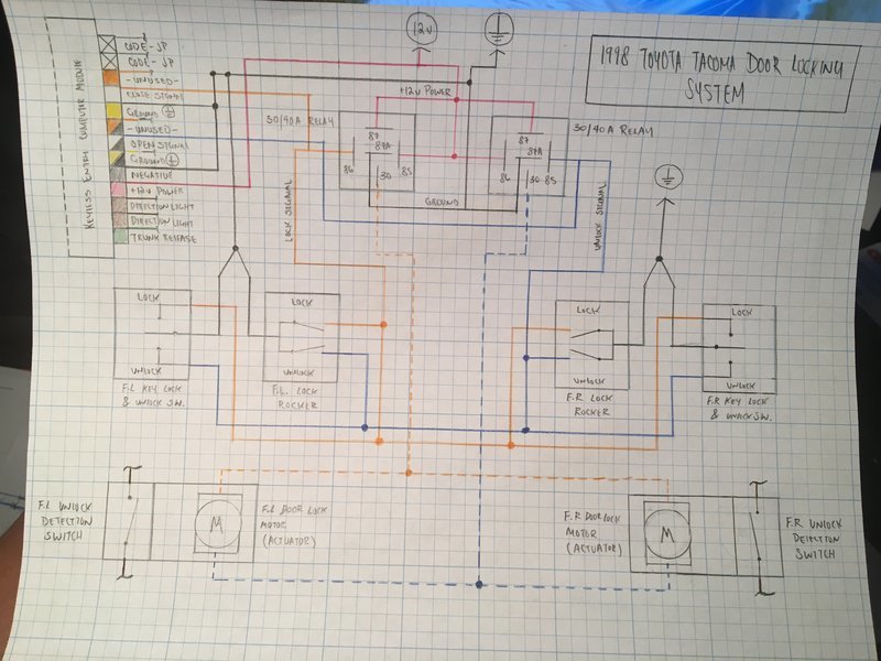

    Making some progress! Thanks to @mechanicjon I managed to figure out the locking system. This system schematic will operate the power lock actuators in conjunction with an aftermarket negative trigger keyless entry system with the absence of the factory body ECU/Integration Module. It's controlled by a cheap $16 dollar lock module, and two 30/40 amp relays.
    Here's the schematic for the aftermarket lock system I'm using.

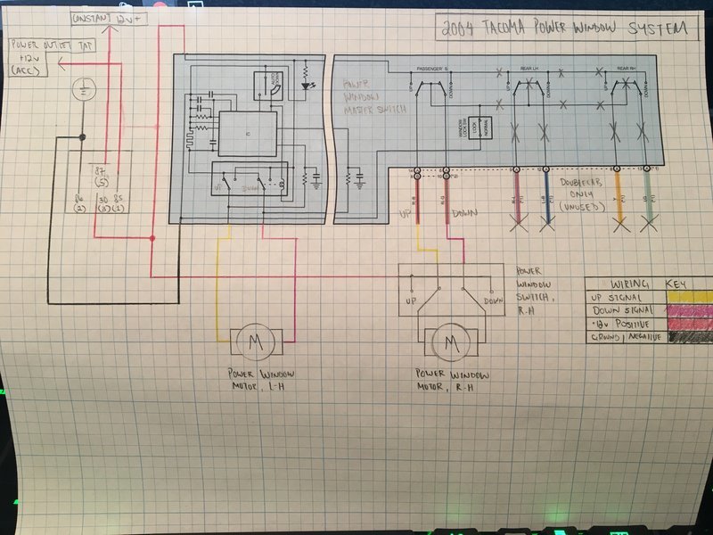

    Haha thanks! You're right about that, it really isn't easy at all. It's a lot of staring at the FSM wiring diagrams, labeling, and trial and error. Can't stress this enough I wouldn't be where I am without @mechanicjon's guidance. Man is a wiring genius!
    Here's a sneak peak at the power window schematic I'm working on.
