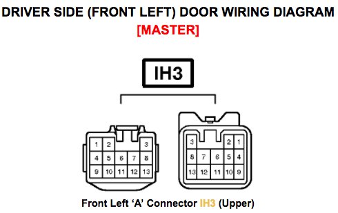

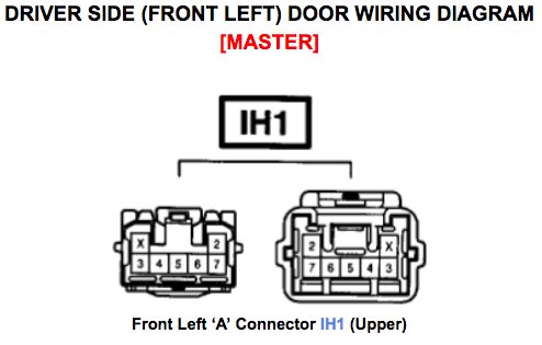

    I was wanting to replace my old door panels because they keep trying to separate the main fiber board piece and the top trim piece. I have had to retighten the metal tabs a couple of times and some of them were missing when I got my truck. So I found this thread and thought I would try swapping my two piece door panels for newer one piece versions.
    I went and got all of the parts needed but when I tried to test fit the plugs the bottom one worked but the top plug on the 2002 was way bigger. I did not get the other ends of the plugs from the 2002 hoping that because I already have power windows and door locks that the harness would work. I really didn't want to turn this into a wire chopping and splicing project.
  3. Nov 2, 2017 at 12:44 PM
    #123
    Phessor
    Phessor Well-Known Member
    Feb 15, 2014
    #123156
    3,716
    I'm sure it doesn't help that I have an Xtra cab and the door panels and wiring harnesses came out of a double cab.
  4. Nov 2, 2017 at 12:50 PM
    #124
    BartMaster1234
    BartMaster1234 [OP] Well-Known Member
    Aug 21, 2016
    #195197
    46,051
    Tyler
    Pittsburgh, Pennsylvania
    Flux Capacitor
    The plug that goes into the master switch? It would bigger since it has contacts for the rear window switches since you said you got them from a double cab. Try using your original wiring harness and switches.
  5. Nov 2, 2017 at 1:00 PM
    #125
    Phessor
    Feb 15, 2014
    #123156
    3,716
    I am referring to the plugs that terminate at the kick panel.
  6. Nov 2, 2017 at 1:05 PM
    #126
    BartMaster1234
    Aug 21, 2016
    #195197
    46,051
    Tyler
    Flux Capacitor
    Same thing, it would have one larger tan connector with provisions for the rear doors. Specifically connector IH1 (on extended and single cabs) and connector IH3 (for double cabs). You can make the double cab wiring work by utilizing the correct connector and re-pinning it.

    The new window and power door lock switches use different plugs. For now it looks like I will need to modify the passenger and driver side harnesses to make them work. And I might add power mirrors later down the road.
    The 3rd Gen 4Runner has the correct IH3 plug on the driver side kick panel, but the passenger side is different. I can use the 4Runner and 02 double cab plugs to make a compatible harness for my 98 Tacoma.
  12. Nov 2, 2017 at 5:25 PM
    #132
    BartMaster1234
    Aug 21, 2016
    #195197
    46,051
    Tyler
    Flux Capacitor
    You're right totally forgot about the switch differences. Power mirrors are stupid easy to wire up - you already have the harnesses too. It's a matter of about 5 or so wires - three for signal two for power/ground. Check the diagrams on the first page of this thread.
