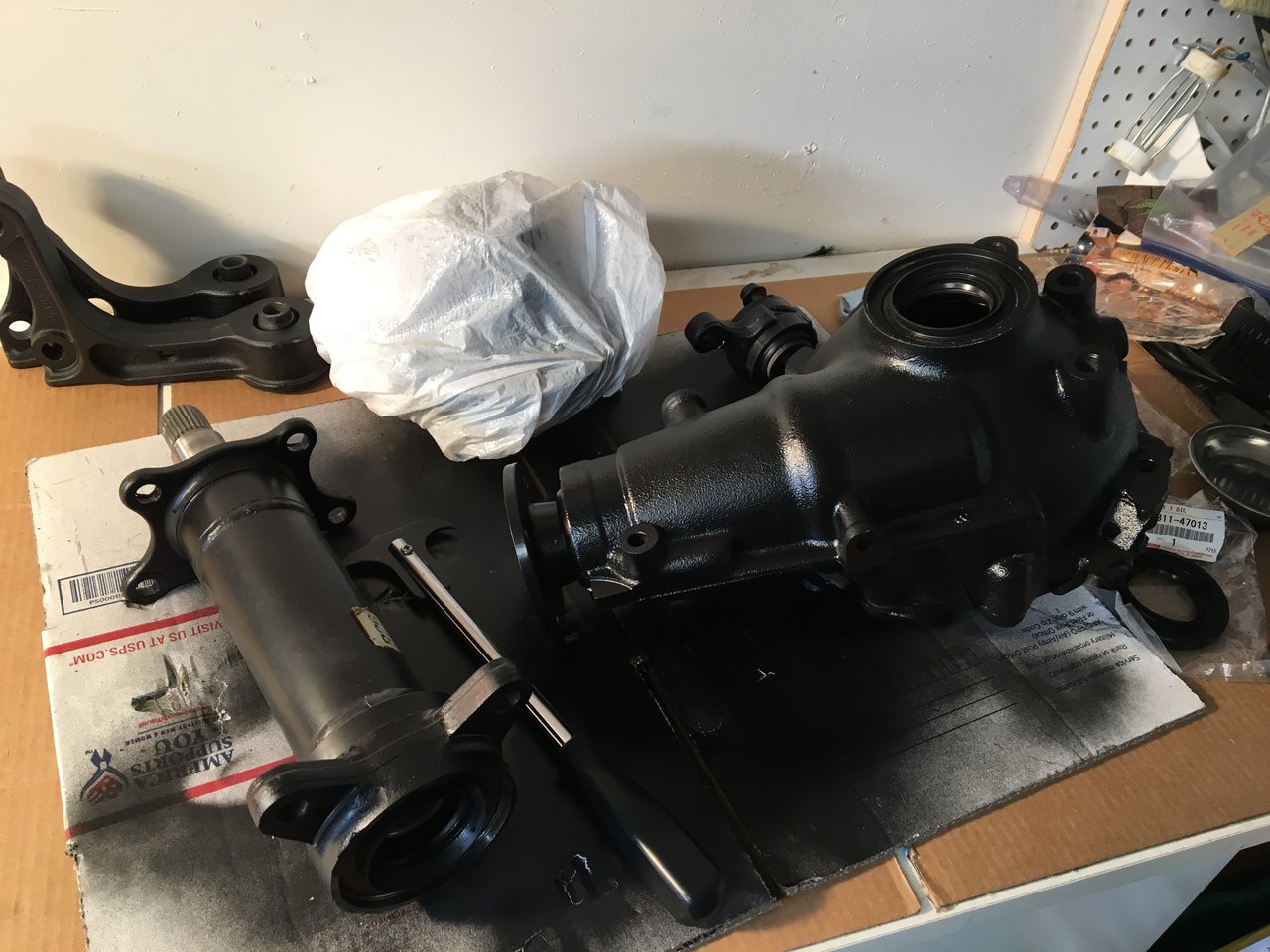

    If you're asking if the ADD and Manual Hub gear clamshells are the same (which is shown in my pictures above) they are. What's different is what mounts on the axle tube flange shown below, and the addition of an ADD gear stub. The clamshell is the same regardless of ADD or Manual Hubs.
    You will need an ADD gear stub to use an ADD axle tube on a manual hub clamshell. Luckily for you I have my old one if you need it.

    Tyler, here's a diagram of a manual hub diff - what parts would I need besides #8? If it's only #8 I'll go for it and keep all the stuff from my spare add diff to put into it. I'm guessing I'll need the output shaft and bearing though, numbers 5 and 4 or do those swap over from the add tube as well?

    They come as one assembly the bearing holds the intermediate shaft in Place.

    Unfortunately no, it had the intermediate shaft along with a bearing and an oil seal. Comes out as one unit.
