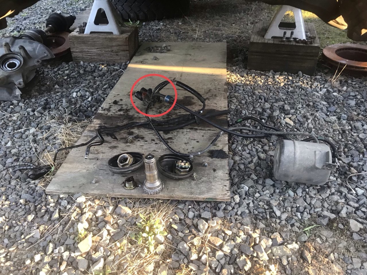

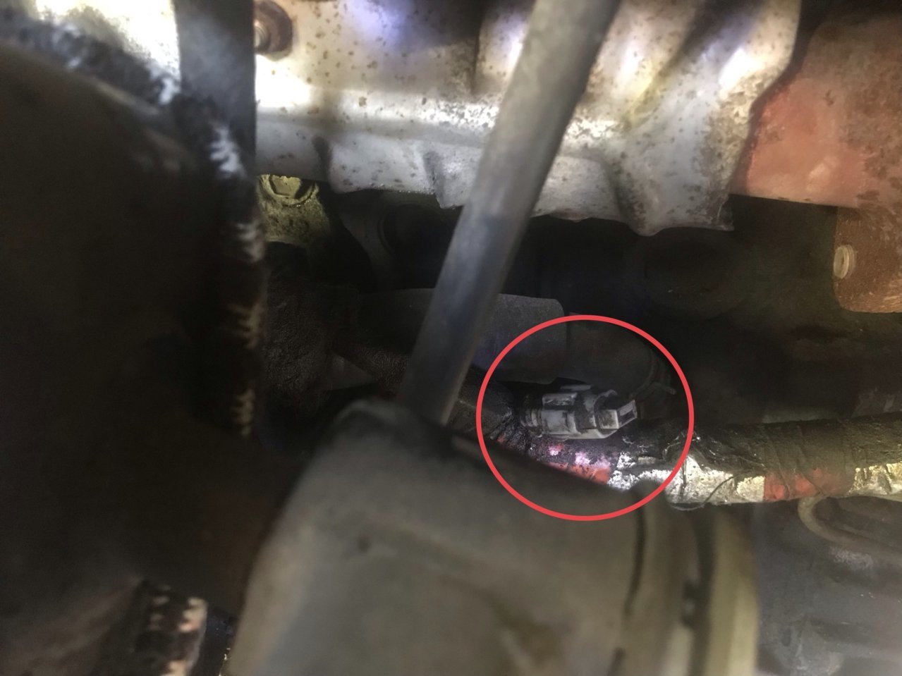

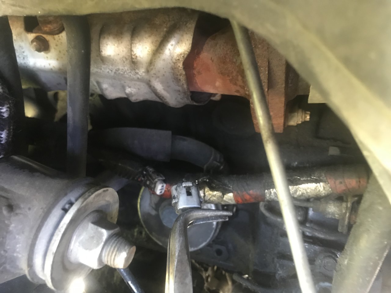

    For my own tastes I want the dash indicator to work when I switch into 4wd.
    I figured out how to get mine to illuminate, hopefully this helps others searching to achieve similar results.
    In the driver side of the engine bay under the exhaust manifold is a wire loom with a connector on it. On my truck that came factory equipped with ADD, this connector was connected to a wire that went to the actuator on the ADD diff tube.
    Circled above is a picture from the donor truck that came factory equipped with manual hubs. The connector on this truck has a termination on it that basically serves as a jumper wire.
    161DD522-362D-4B99-B9C4-34BDF1EFD6E1.jpg Simple solution, plugged this into my truck, dash light works.
    I’m unsure if this works on prerunners being swapped to 4wd because a lot of the electrical may not be there, but at least a place to start looking.
    I also negated the entire ADD vacuum system including the vacuum canister in the driver side wheel well and capped the vacuum line coming from the intake manifold. Verified this as well from the donar truck which doesn’t have the vacuum canister or the vacuum/electrical control circled in the pic below
    Pile o’ parts I no longer need sitting under the donar truck.
