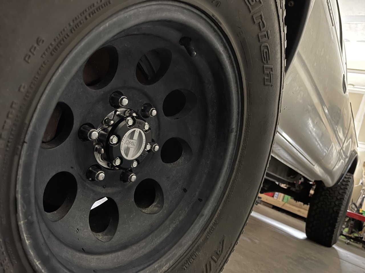

    No way to cut holes in center caps to fill that little space?

    There are OEM center caps with holes that came on Tacomas with manual hubs and alloy wheels. But I prefer mine totally nude like the olden days.
