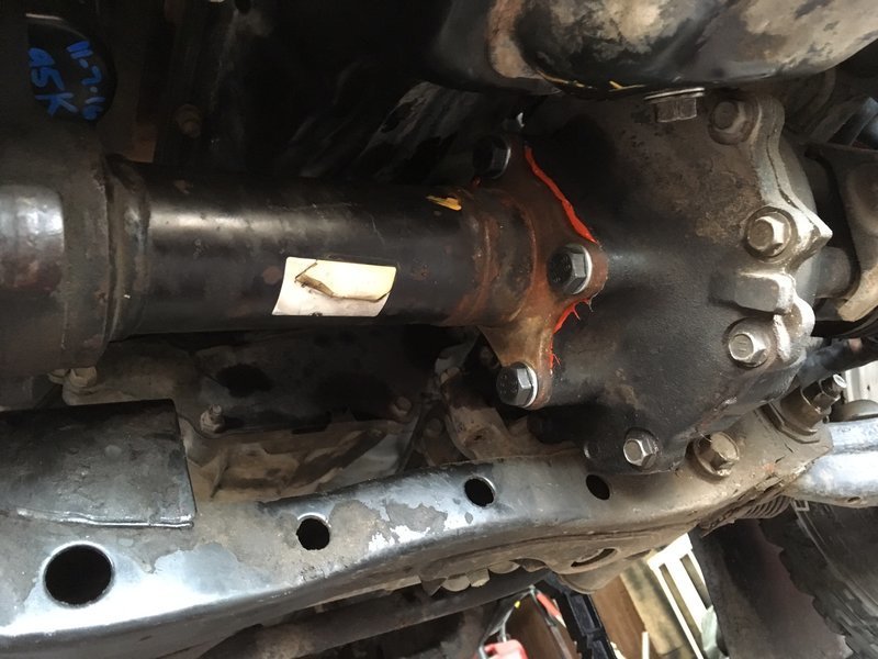

    The intermediate shaft has a frame bracket with 3 bolts that take a 19MM socket. Behind that are 6 E14 external torx bolts holding the intermediate shaft/ADD actuator on the front diff. If your front diff has never been apart before, these torx bolts are going to be brutal. I would strongly recommend having a set of broken stud and bolt sockets, in case you strip one of these like I did.

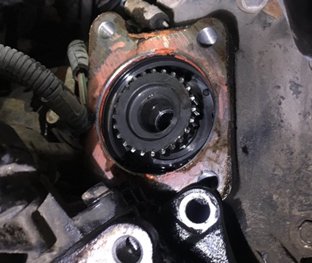

    Here is what the front differential looks like with the intermediate shaft/ADD actuator assembly removed.

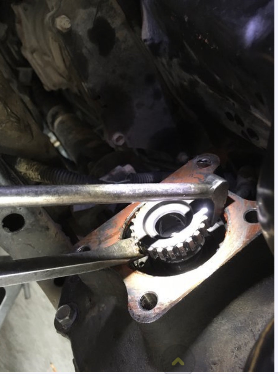

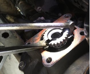

    If you have a J-shift transfer case and have to reuse your ADD intermediate shaft:
    Key on the ignition, shift into 4-HI and key off. Unplug the ADD actuator from its wiring harness and disassemble it. Put a hose clamp on the shift fork to keep it permanently engaged in 4WD and reinstall everything on the front diff. The hose clamp needs to be wide enough that the shift fork can't move. If you skip this step, your passenger side CV axle will not be connected to the front diff even if the locking hub is turned in. Leave the wiring disconnected so the ADD actuator doesn't burn up from attempting to shift in and out of 4WD. The ADD wiring harness can be unplugged near the starter and removed from the chassis harness.
    If you have a J-shift transfer case and a non-ADD intermediate shaft:
    Use the double pry bar method again to remove this gear. It has a spline and snap ring just like a CV axle. Then the non-ADD shaft fits like it was meant to be there:

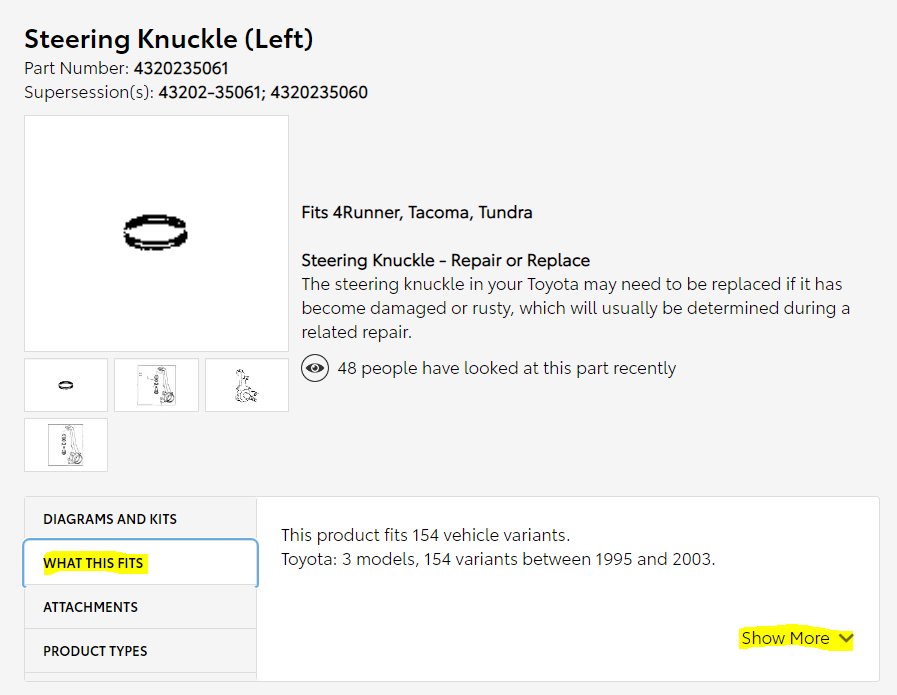

    This might help - Go take a look at this steering knuckle.
    https://parts.toyota.com/p/Toyota__/Steering-Knuckle-Left/63066616/4320235061.html
    Notice "What this fits", click on it and then click on "Show More"
    You'll see all the various models you can look at for steering knuckles, or just re-use your own (will require pressing out the ADD hub and swapping in a manual hub along with a new bearing of course). If you do not have ABS and you find a set of steering knuckles with the ABS port, you can plug it with this - https://absolute-wits-end.com/toyota-truck-abs-sensor-delete-plugs-front/

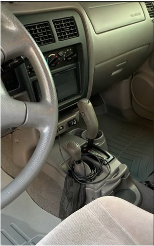

    Sorry to bother you again with this thread, but since I did the manual hub conversion on my truck I started feeling like a rough/vibration by the floorboard and front end, that I finished replacing many parts trying to find out the problem (Lower Ball Joints, Control Arms Bushings, New Rack and Pinion and Bushings, Tie Rods). Also, I went to different mechanics, but they don’t make an accurate diagnostic and the last one told me that he found some metal residues when he removed the free wheel hub from the passenger side, when I checked it, that metal residues came from the drive axle spacer (Reference Picture Below), something is like pulling the passenger side drive axle or something like that.
    Now, going back to the intermediate gear shaft that I asked you before, this gear needs to be removed or I need to leave there as now is? sorry if sounds too repetitive.
    My Tacoma has different a style of lever T/M shift, that doesn’t have the ADD button like yours, I don’t know if this make any difference relative to leave or remove the prior intermediate shaft gear.
    Sorry for insisting so much on this gear, the thing is this feeling like rough/vibration floorboard that my truck has, feel very similar when the 4wd is engaged, so I don’t know if this gear is the guilty of this problem and I failed when I leave it.

    Hello Juan,
    My truck did not have the 4WD button on the transfer case stick. It was the normal J-shift case, called that because it shifts in and out of 4WD in a "J" pattern. I can't tell from your photo which transfer case you have. That gear sticking out of the front differential is only needed if you're keeping the ADD actuator and intermediate shaft. I removed it from my truck in order to use a donor non-ADD shaft:
    As for your truck's symptoms, you said you found metal residue that came from the spacer in your freewheel hub and it feels like 4WD is engaged on that side. To me that sounds like you have a malfunctioning freewheel hub that's not fully releasing from the CV axle when you have it turned to the UNLOCK position.
