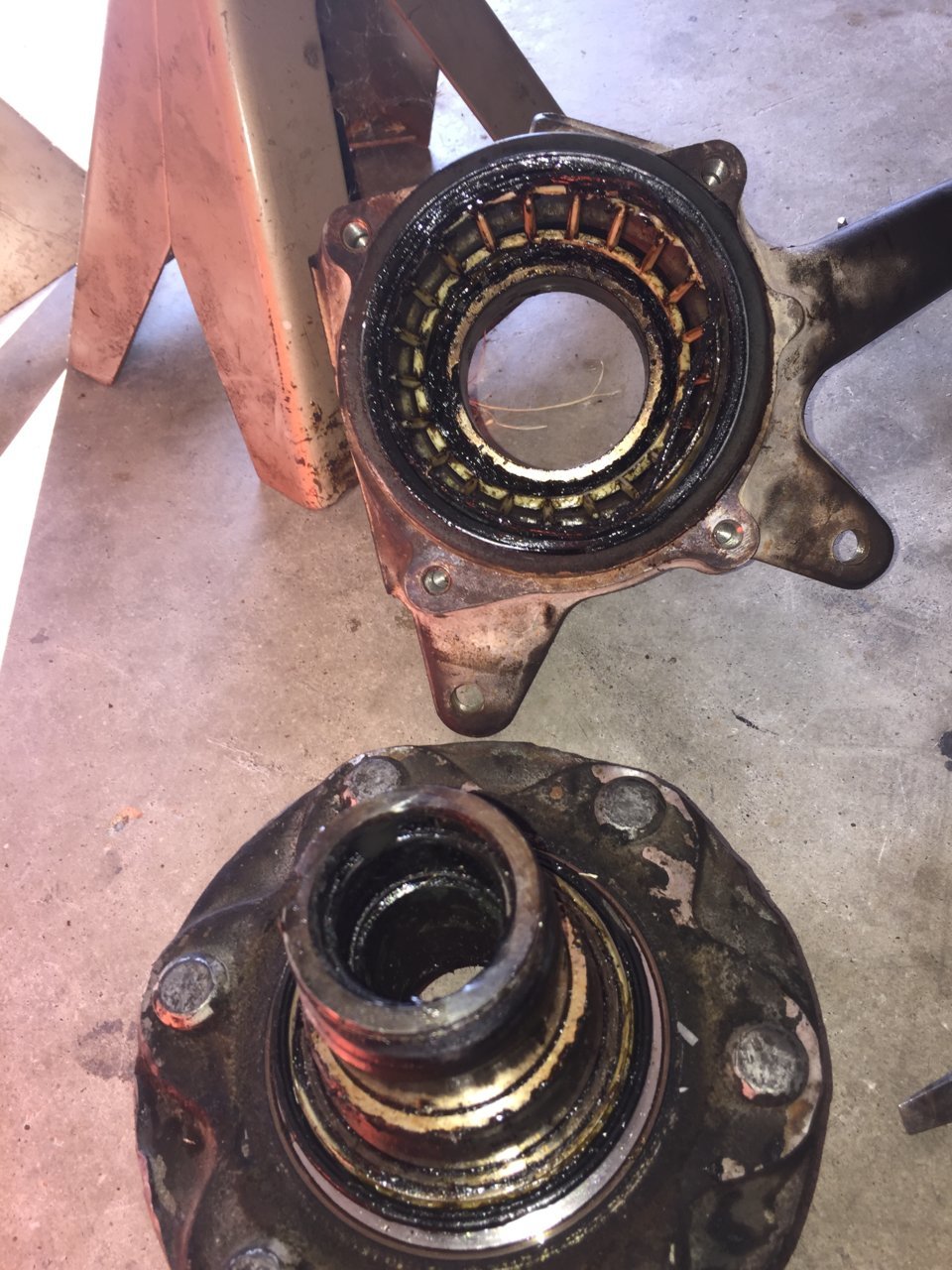

    466F3BD8-CC98-4B86-B44F-3D7BABEF09AC.jpg This is what I had in my ‘98 Taco. Bearings spilled out when separating but the main bearing was still intact behind the c clip in the knuckle.
    It had 1 taper bearing & one regular bearing.

    No, no, no, no. Your bearing just came apart when pressing the hub out. You have half of the bearing on the hub spindle and half still in the knuckle. Trust me. It's just one bearing.

    Yeah correct.
    It took me forever to realize that. I spent a lot of time searching. Its one big bearing.

    You are so correct. I am not worthy to post in your presence.
    Seriously, thanks for setting me straight.

    That's not the way I intended you to take my post. I just wanted to inform you that what you saw with your hub pressed out of your knuckle wasnt exactly what you thought. I want people to have accurate information, especially in a thread I started. It's too bad you took offense to being corrected. I come across a little strong at times so maybe I'm partially to blame.

    I did not take offense. I’m delighted that you pulled my head out before I bought that taper bearing. Keep doing what you’re doing. I really do appreciate your help.
