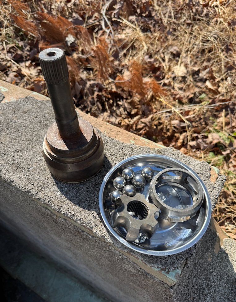

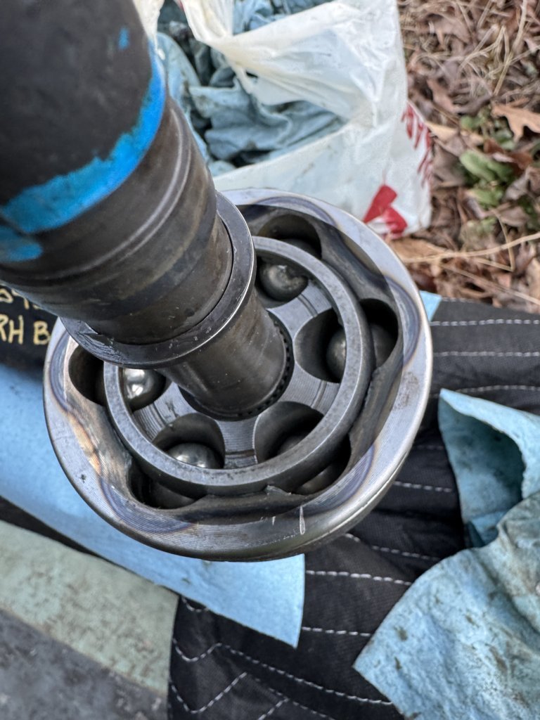

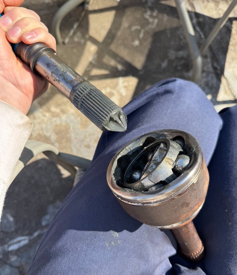

    Well, after messing with it for a little over an hour today, I got the clip off and the axle disassembled! It really did feel almost impossible and I think the trick is to just keep playing around with it, you can get the idea of what you're trying to undo by looking at the smaller clip at the top of the shaft near the tripod bearing, you're trying to remove the same one on the other end just buried beneath the star and ball bearing assembly, full of grease, with no visibility, and about a centimeter of space to get a pick into...I'll try to post a more visual writeup here shortly to hopefully be of help to anyone else trying to do this. That bottom bearing assembly is actually a really elegant piece of engineering, it took a minute to get all the components out after removing the shaft, you kind of have to rock the bearing race back and forth and pop out the balls one at a time.
