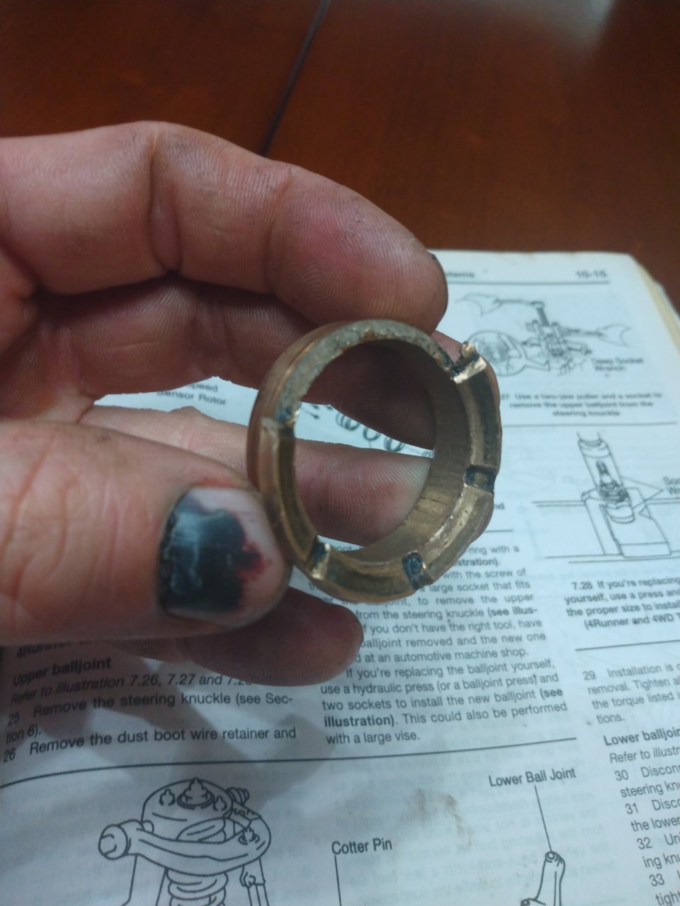

    any help with finding these online? or what the name is part number is? it's hard to know with the diagram... this one broke and the other is missing... oh brother. any help would be appreciated

    zippsub9 likes this.

    I got you, just give me a second. I just rolled back from a horrible I-85 road trip full of traffic jams.

    yeah, I ordered from ors last night. 45 a pop... wowza. went to Toyota this morning and they don't keep them in stock, just to confirm. thanks for your help btw

    was Toyota able to give you a part number at least?

    nah, their digital fsm doesn't even show the part because it comes with a new hub assembly ( and not sold separately). tacoma world knows... Toyota doesn't... advice to everyone, please be careful with these so you don't pay the premium. now I have to wait for shipping, and god knows during the holiday and this pandemic backup how long it'll take. haha, looks like she'll be down for a minute. I believe they were broken from previous owner. she is 26 years old, so who knows the history.

    I got you if you need it sooner. Shoot me a PM.
