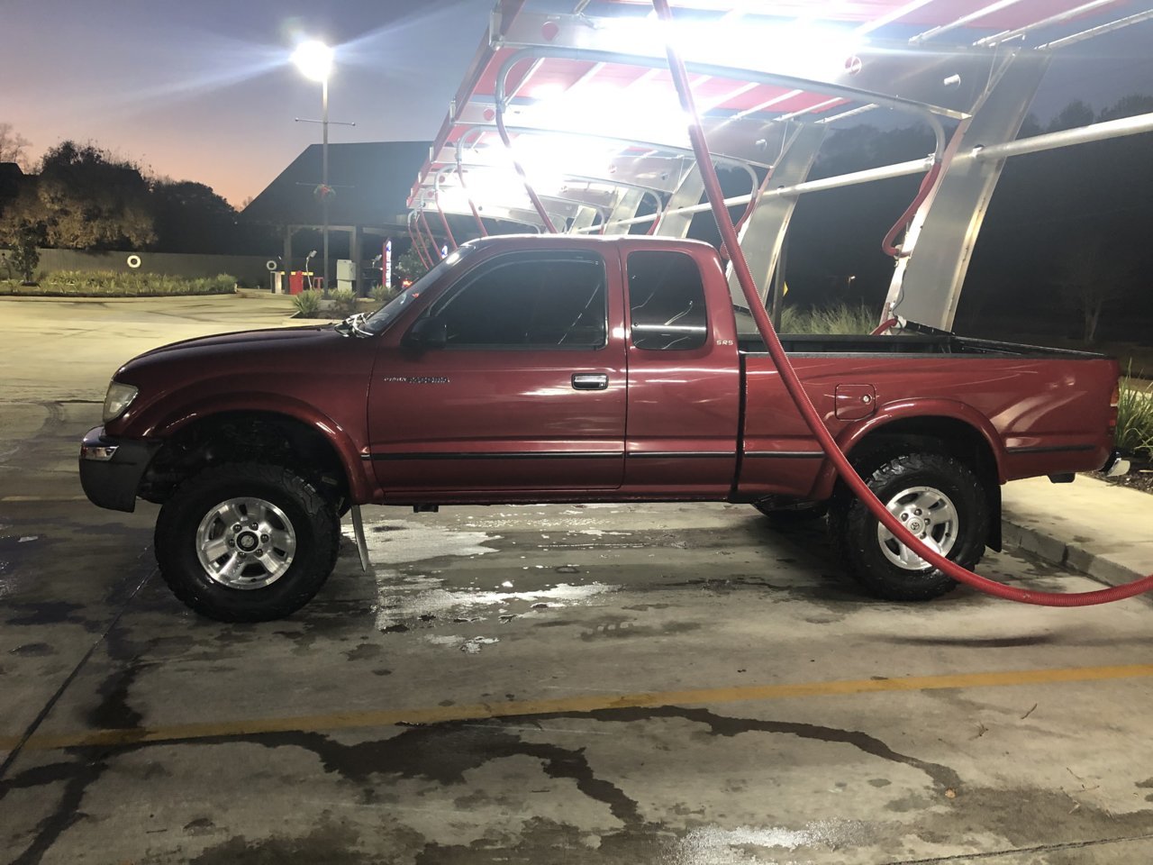

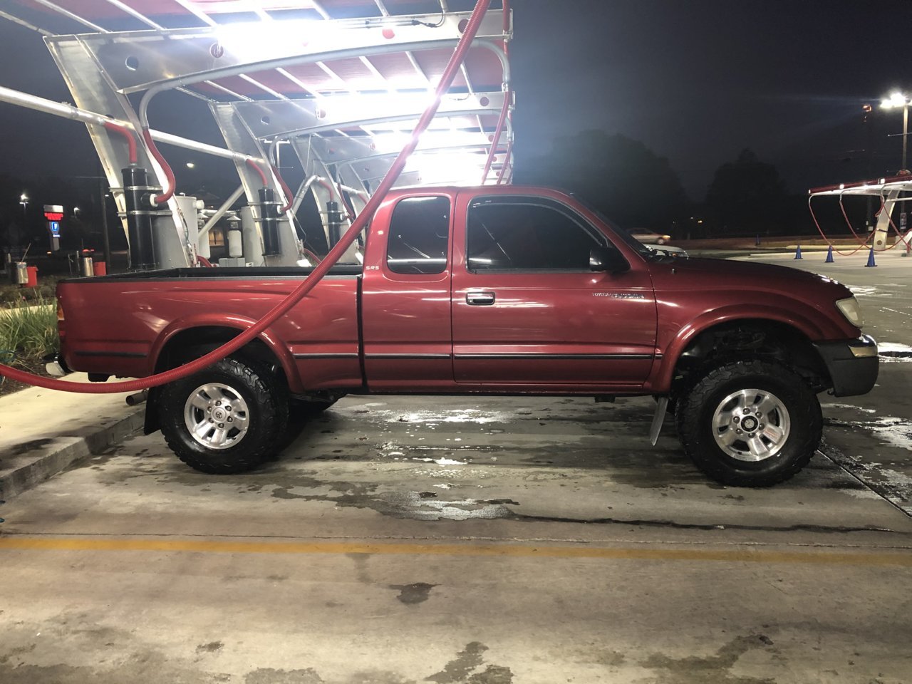

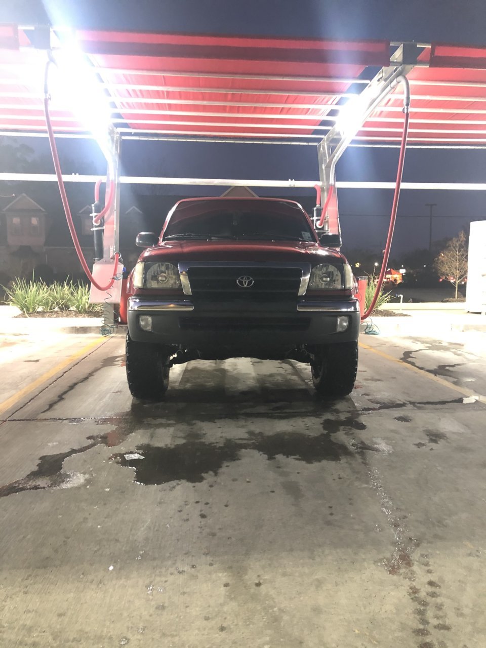

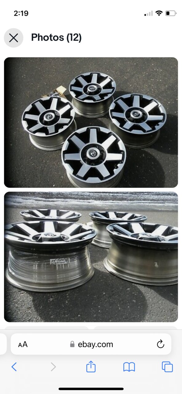

    30CA09A3-71FE-4315-9CF7-EFE0DCE5B096.jpg 7DBAC7AB-41B2-4EDB-BFA8-5F7DAA0DA6A0.jpg 48579281-2BFD-415F-BE9F-B0F4E8B5706B.jpg 11EE0326-A3A2-453C-914A-A54D5A19BBC2.jpg What’s up guys, new to the site & first time posting. I have a 2000 Tacoma 3.4 automatic with manual locking hubs & I’m gonna be needing new tires soon. I’m thinking about also upgrading the rims but I’m not sure about which ones to go with. I really like these 17” 4 runner rims but I have two questions, the first is will I have to do any modifications to the front far as spacers or anything of that nature & two, will these center caps on the rims go over my manual locking hubs if I decide to keep them on there full time? Curious if anyone has this setup or can offer any advice. Thanks for the help! 30CA09A3-71FE-4315-9CF7-EFE0DCE5B096.jpg7DBAC7AB-41B2-4EDB-BFA8-5F7DAA0DA6A0.jpg48579281-2BFD-415F-BE9F-B0F4E8B5706B.jpg

    I have locking hubs and a different flavor of 4runner wheel (trd pro sema), the caps fit just fine. I cut holes in mine to reach the dial, but thats the only thing i did different.
