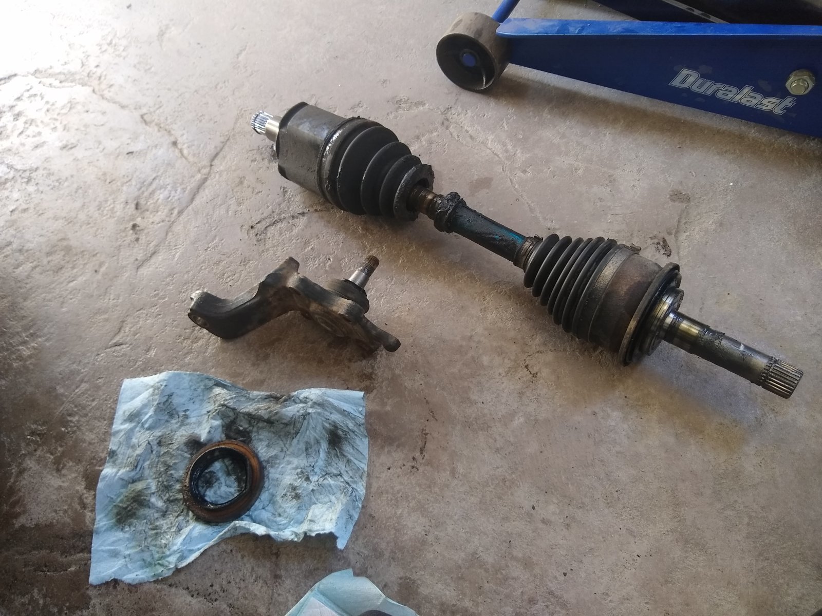

    Here are my old axles...
    This is driver...
    This is pass...

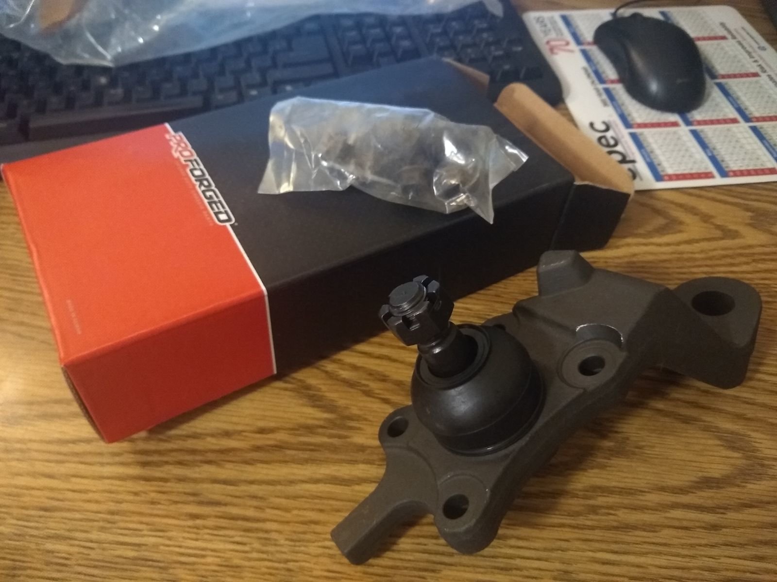

    I also replaced my CV axle oil seals and replaced my lower ball joints on both sides.
    I bought ProForged lower ball joints and they seem pretty solid so far.

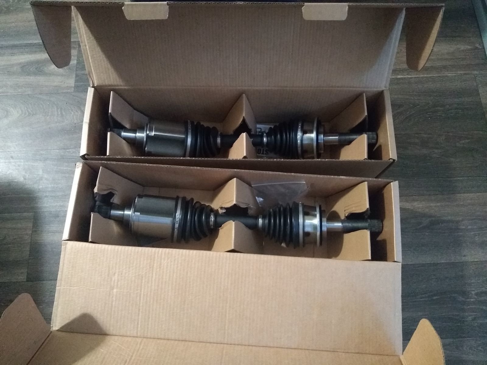

    My NAPA CV axles...
