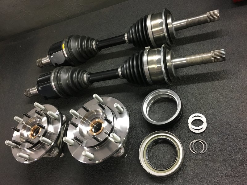

  6. Jan 15, 2017 at 3:15 AM
    #86
    Sideline Hero
    Sideline Hero Active Member
    Mar 2, 2016
    #179964
    37
    Bu
    Hawaii
    Updated 1/15/17!!!!
    Manual Locking Hub Conversion Kit for Toyota:
    05-17 Tacoma
    03-17 4Runner
    07-14 FJ Cruiser
    A complete manual locking hub conversion using genuine Toyota parts for a direct bolt in application.
    The kit consists of:
    2 - CV shaft assemblies
    2 - Hub/bearing assemblies
    2 - Dust seal spacers
    2 - Dust seals
    1 - Set of Warn Locking Hubs
    1 - Hardware bag
    I had installed the first kit on my 2014 Toyota 4Runner 4x4 a few years ago. The the front drivetrain and suspension is also similar to that of the Tacoma and FJ Cruiser. I had noticed a difference in gas mileage, better brake response and less wear and tear on the front drivetrain parts while in 2WD. To use the 4WD, you would need to get out of the vehicle and engage the hubs manually. Right now i have 1 complete kit, 2 currently being assembled and am also currently working on the next big order. If you have any questions, id be glad to try and answer them to the best of my knowledge and expertise. Thank you for looking!FullSizeRender.jpg
    mamaheu, emelianenkov, Bobcdn and 2 others like this.
  7. Jan 15, 2017 at 3:28 AM
    #87
    zippsub9
    zippsub9 Well-Known Member
    Nov 3, 2014
    #141634
    4,538
    Halfmoon, NY
    14 DCLB
    Shit bolted onto other shit, and junk.
    Interested, waiting on price point...
  8. Jan 15, 2017 at 5:36 AM
    #88
    HolyHandGrenade
    HolyHandGrenade NOOB
    Mar 25, 2013
    #100579
    11,800
    Tim
    Garage Most Likely
    DCFB (RIP)
    Some Stuff
    How much? I'm all over this. I already have a twin sticked FJ case. I already want to do the ADD delete. This is just what I need. Are chromoly axles still an option?
  9. Jan 15, 2017 at 5:37 AM
    #89
    HolyHandGrenade
    Mar 25, 2013
    #100579
    11,800
    Tim
    Garage Most Likely
    DCFB (RIP)
    Some Stuff
  10. Jan 15, 2017 at 5:45 AM
    #90
    HolyHandGrenade
    Mar 25, 2013
    #100579
    11,800
    Tim
    Garage Most Likely
    DCFB (RIP)
    Some Stuff
  11. Jan 15, 2017 at 5:53 AM
    #91
    HolyHandGrenade
    Mar 25, 2013
    #100579
    11,800
    Tim
    Garage Most Likely
    DCFB (RIP)
    Some Stuff
    Only thing I'd want different is for high angle inner CV boots installed. I'm sure if anyone is doing this conversion, they're lifted enough to wear the pleats on their boots.
    eccracer104 likes this.
  12. Jan 15, 2017 at 6:16 AM
    #92
    POOLGUY
    POOLGUY Well-Known Member
    Feb 19, 2013
    #97958
    11,061
    JEFF
    ALABAMA
    2008 TRD Sport 6sp, 2015 TRD Offroad 6sp
    Dobinsons suspension
  13. Jan 15, 2017 at 6:56 AM
    #93
    DistortedAxis
    DistortedAxis Well-Known Member
    Sep 17, 2016
    #197526
    309
    Jason
    Toronto
    Desert Sand Mica, 2006, V6, 6SPD Manual, SR5, DCSB, 4X4
    STOCK
    Interested. Subd for pricepoint.
    But want LT too..
    Any plans on doing LT axles?
  14. Jan 15, 2017 at 7:01 AM
    #94
    stairgod
    stairgod NOOB
    Aug 16, 2015
    #161924
    7,965
    Jo n
    PA/NJ
    2011 MGM Trail Limo
    Locked Boosted 35s
    DistortedAxis likes this.
  15. Jan 15, 2017 at 7:03 AM
    #95
    stairgod
    stairgod NOOB
    Aug 16, 2015
    #161924
    7,965
    Jo n
    PA/NJ
    2011 MGM Trail Limo
    Locked Boosted 35s
    LT axles would be a noce option
    HolyHandGrenade likes this.
  16. Jan 15, 2017 at 7:05 AM
    #96
    vssman
    vssman Rocket Engineer
    Jun 17, 2013
    #106440
    10,006
    Paul
    Naugatuck, CT
    2013 SR5 double cab
    Nice job! As noted above - price please...
  17. Jan 15, 2017 at 7:11 AM
    #97
    HolyHandGrenade
    Mar 25, 2013
    #100579
    11,800
    Tim
    Garage Most Likely
    DCFB (RIP)
    Some Stuff
    Shift on the fly is nice. What I don't like is the backing up and driving forward multiple time to get it to engage / disengage...
  18. Jan 15, 2017 at 7:13 AM
    #98
    donaldwagner
    donaldwagner -Don-
    Jul 9, 2010
    #39961
    310
    Donald
    College Park, Orlando
    2013 single cab 4x4
    My 99 had manual hubs, and constantly wonder how easily parts would interchange with my 13'. Interested in price as well
  19. Jan 15, 2017 at 7:14 AM
    #99
    vssman
    Jun 17, 2013
    #106440
    10,006
    Paul
    Naugatuck, CT
    2013 SR5 double cab
    Locking hubs give you shift on the fly - sort of... Example snowy morning, clean off truck, lock hubs & drive off with transfer case in 2WD. Shift TC to 4WD when needed, off when not. When at destination and don't need 4WD anymore, unlock hubs...
  20. Jan 15, 2017 at 7:19 AM
    #100
    BadBrains
    BadBrains Spreading the Aloha
    Apr 28, 2010
    #36179
    1,620
    AL
    '07 Taco LT, '00 GS-R, '75 C10, '83 CJ-7, '19 T4R SR5
    King, TC +2"LT, 35's, Aluminum this and that.
    Without the axle shafts installed so it would save on shipping, and I could install the +2 LT axles would be nice.
    Throw in a case of Hawaiian Sun Lilikoi and I'm sold.
