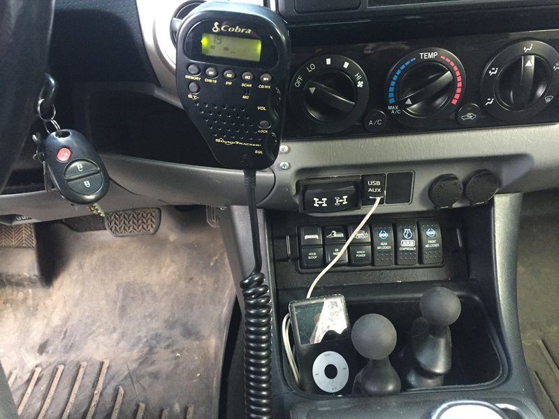

    I think locking hubs would be great but even more than those I would like to have an actual shifter type transfer case such as I had in my 1st gen. The knob just feels too insecure to me.

    Twin sticked FJ case :thumbsup: Add an FJ tube and the op's locking hub kit? Perfect. Just a LOT of money.
    For me, I just need to be sure I'm not going to go SAS in the future before dropping another 3k into my current setup. That's the manual hub kit, FJ tube swap, and shipping.
