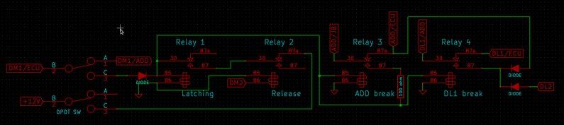

  6. Jan 18, 2017 at 6:56 AM
    #126
    tgear.shead
    tgear.shead Well-Known Member
    Aug 20, 2015
    #162276
    1,735
    I've got the 4wd ecu tricking covered;
    Now this schematic is actually intended for tricking the 4wd ecu into believing that the ADD is engaged, when in fact it is NOT, but some minor adjustments would have it do the intended job.

    I worked all of this out when I did my 4WD conversion, but I did it without the PLC, instead going with all relay logic. 6 DPDT relays to actuate the transfer case and one to actuate the ADD. I have them wired independently. I also made a Adruino circuit and code that would do all the things you listed above. Ultimately, I decided to just go with relays and two independent switches. I also designed a PCB with all the logic built in to be plug and play. I scraped the whole idea because I'm going to swap to an FJ t-case.
    I'm interested in your project though. Keep my updated. I had a lot of fun learning all this stuff.

    Where did you find DPDT relays rated for 15 volts on the coils?
    Did you manage to source the sockets on the 4WD ECU?
  20. Jan 19, 2017 at 7:30 AM
    #140
    jowybyo
    jowybyo Well-Known Member
    Nov 19, 2013
    #116863
    6,092
    Joe
    Baltimore, MD
    '14 MGM DCSB Postrunner 4wd Conversion, Debadged
    http://www.mouser.com/ProductDetail.../782XBXM4L-12D/?qs=h3Xc2LqAeakL8fGKbK%2bXPw==
    No, that was one thing I didn't spend a lot of time looking for. My PCB just had a terminal block, but there's a good chance you can find the socket. My plan was to supply a new wire harness to interface with the ADD, t-case, and my PCB since I was able to find the connectors for the ADD/t-case.
