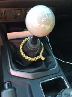

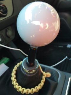

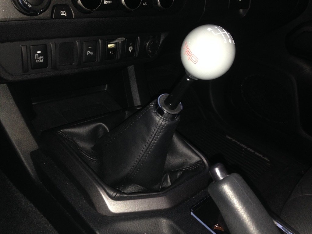

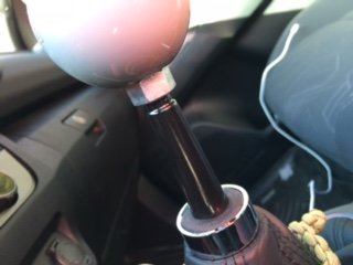

    IMG_0317.jpg IMG_0319.jpg Got this idea from a member from this forum. Rubber grommet from Home depot is another method. Also lost the original lock nut so had to get another.

    Any chance u got a part number for this grommet? Feel like I would be looking for hours at homedepot and then get the wrong thing lol

    Sorry i do not have that info

    That shift knob looks pretty cool. Look kinda big. But nice job on install!

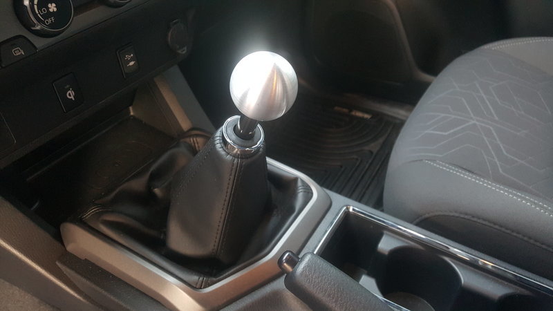

    Here's the grommet used.

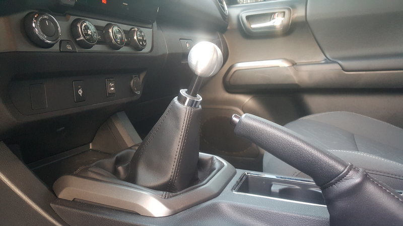

    Same grommet. Thanks for the info btw. Knob is from https://twosrus.com/catalog/product_info.php?cPath=21_46&products_id=104 twos r us. They custom make shift knobs for toyota mr2's. Awesome deal, great people to deal with and rocket fast shipping. The best part is that it's simple and high quality. Plus now you can actually get your fingers under the shift knob unlike the factory one.

    Cant change the shifter alone? its simple. twist the chrome ring at the top of the dust boot a quarter turn or so. It will come loose and just slump a little bit. Then unscrew the shifter and remove. Slide grommet down to the boot and screw on new knob. There is nothing you can mess up.

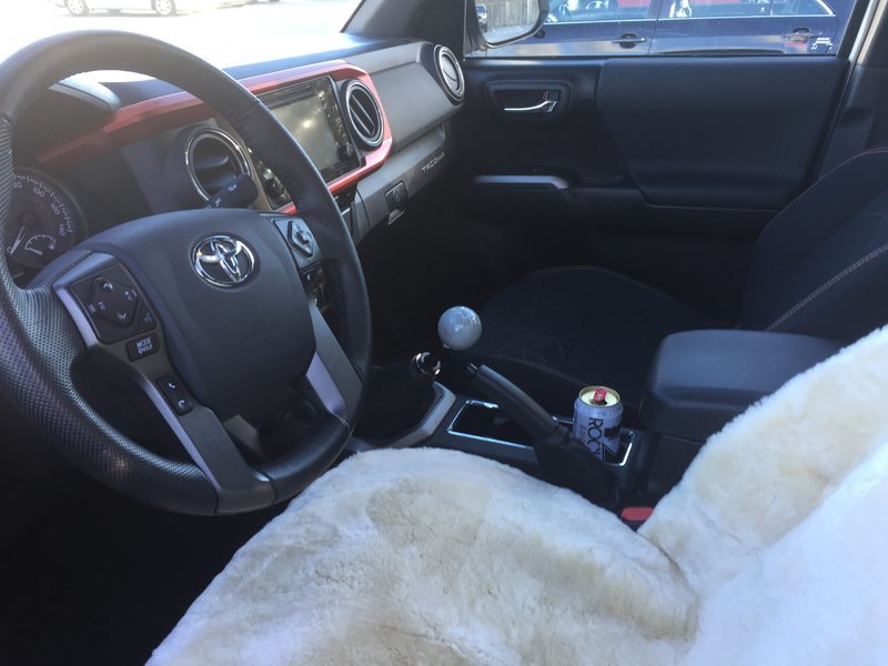

    IMG_1445.jpg Love the trd shifter. I inadvertently created this 70's retro look with the sheepskin and que ball shifter

    All you need now is a pair of fuzzy dice hanging from the RV mirror like me...

    Those sheep-skin covers are pretty awesome.

    Details on that black grommet ? How is the shift boot staying up? Looks clean :hattip:
