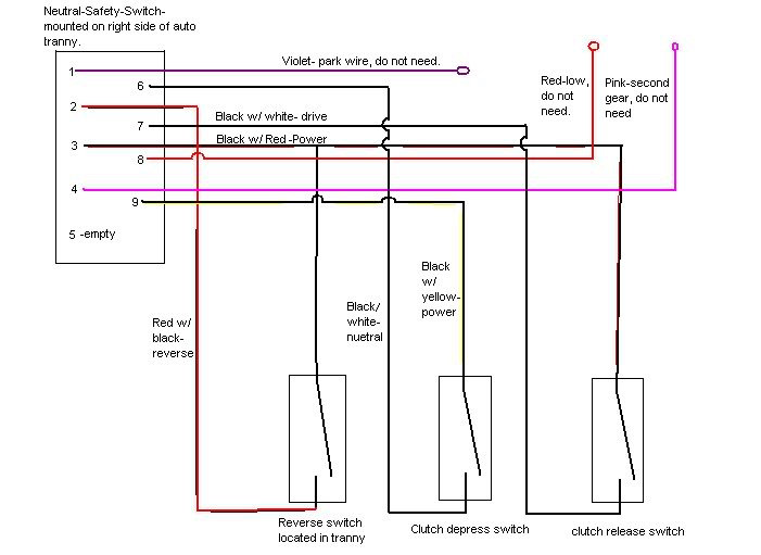

    Hi juste swap a manual transmission in my 2003 double cab and triying to bypass nutral safwty switch to crank my engine any picture or diagram wte would be apreciated
