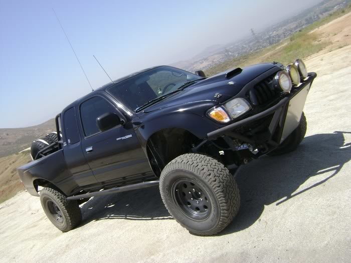

    Tucson
    5 lug BEAST!
    Secondary air filter removed, elbow mod, BFG T/A KO (31x10.5R15), 15" American Racing Mojaves, BHLM, Dome Light MOD (Blue), Pioneer headunit, Sockmonkey 'TACOMA' Decals, Readylift 5-lug SST, Rear Shocks - Bilstein TRD, Dynomax Super Turbo #17748, DDM Slim Ballast HID Kit H4 Hi/Lo -35W 6000K in headlights, Apexcone Raptor HID Kit H3 - 35W 6000K in Hella 500s, aFe CAI #51-10762, WeatherTech Floorliner, 200W Smart AC Inverter

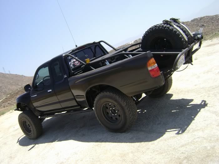

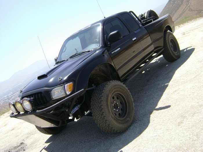

    Alex, I know it is easier to handle an automatic when offroading, you could get use to a manual. Like I told you when you asked me if I had a 3rd leg, I just prefer a manual, that's what I own and what I like to drive. But if you do find a way to make it an auto, I hope it does not take too much out of your wallet.
    This is the one he bought.
