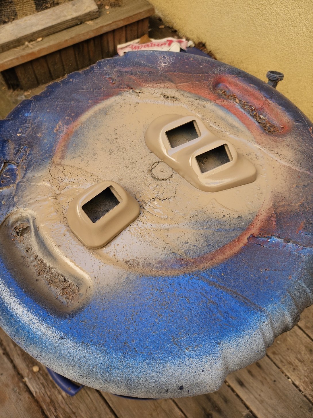

    so project status. Painted the switch mounts, they look nice. They forgot the 5 screws needed to secure them so im waiting for those.

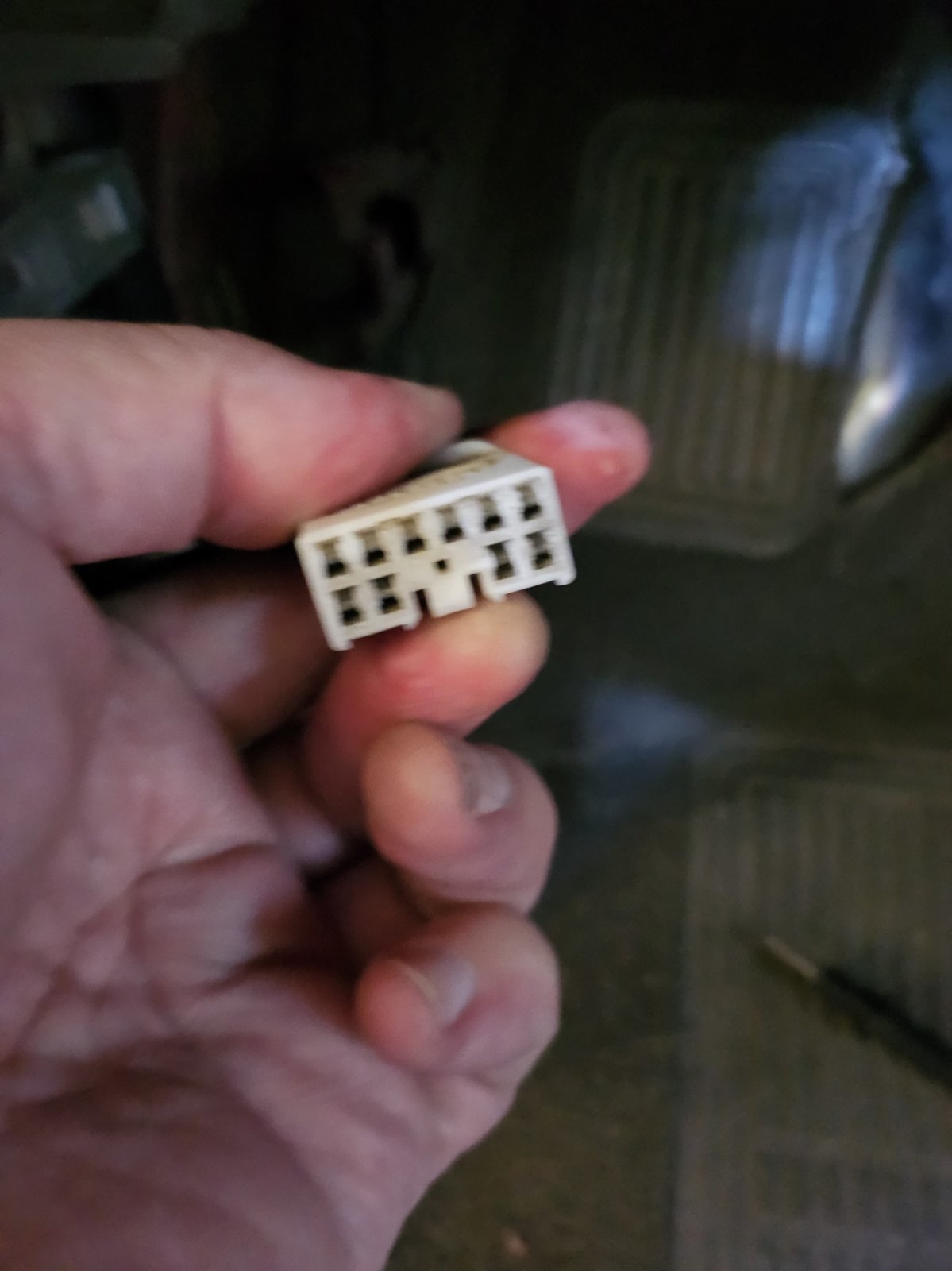

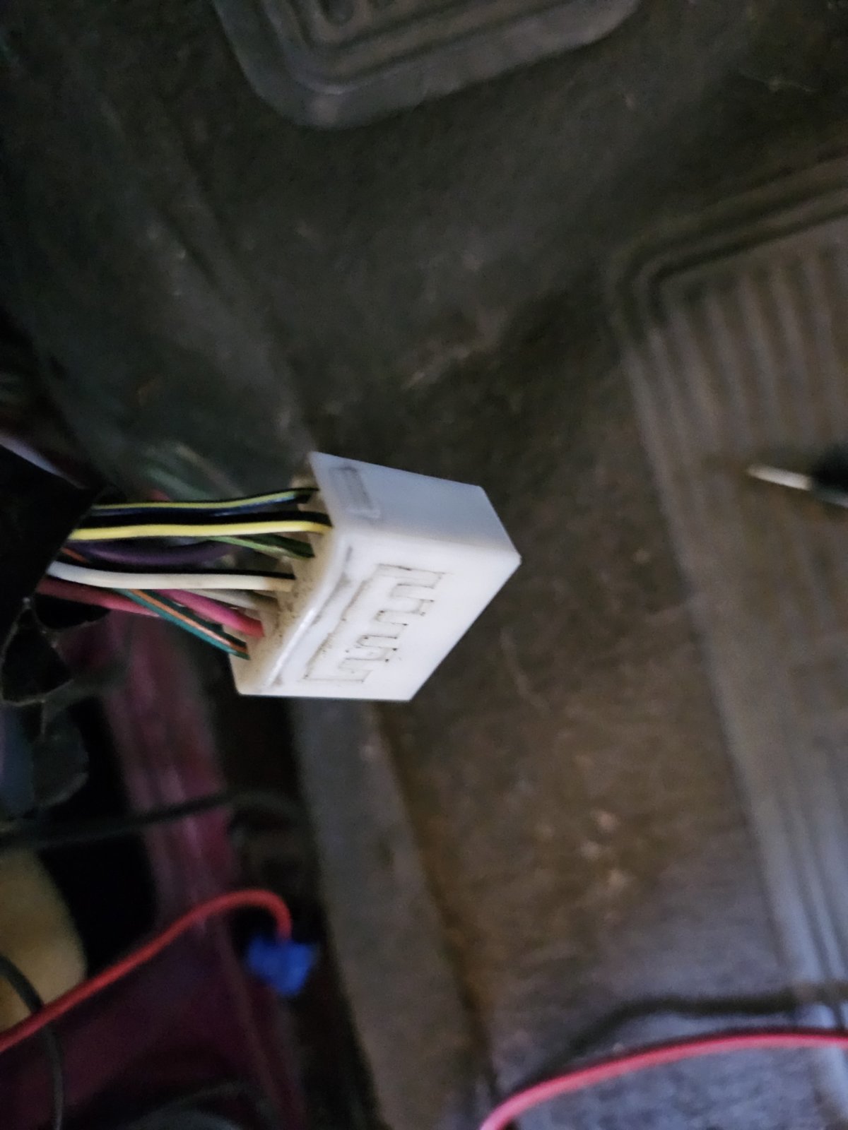

    Looking to secure a power source location. The lower kick connector is there and 2 wires on the right side end both show 12v with ignition on. I have the FSM but cannot see color wire codes for those 2 wires. Any help? I was reading that the Factory PW power stays on for 45 sec after key-off so you can raise the windows still, I'd love to find that wire if possible.

    So i'm wondering if I should wire it to that plug, or just use that plug to trigger a relay? I have a spare 40w relay left over from my camper shell panel mod.

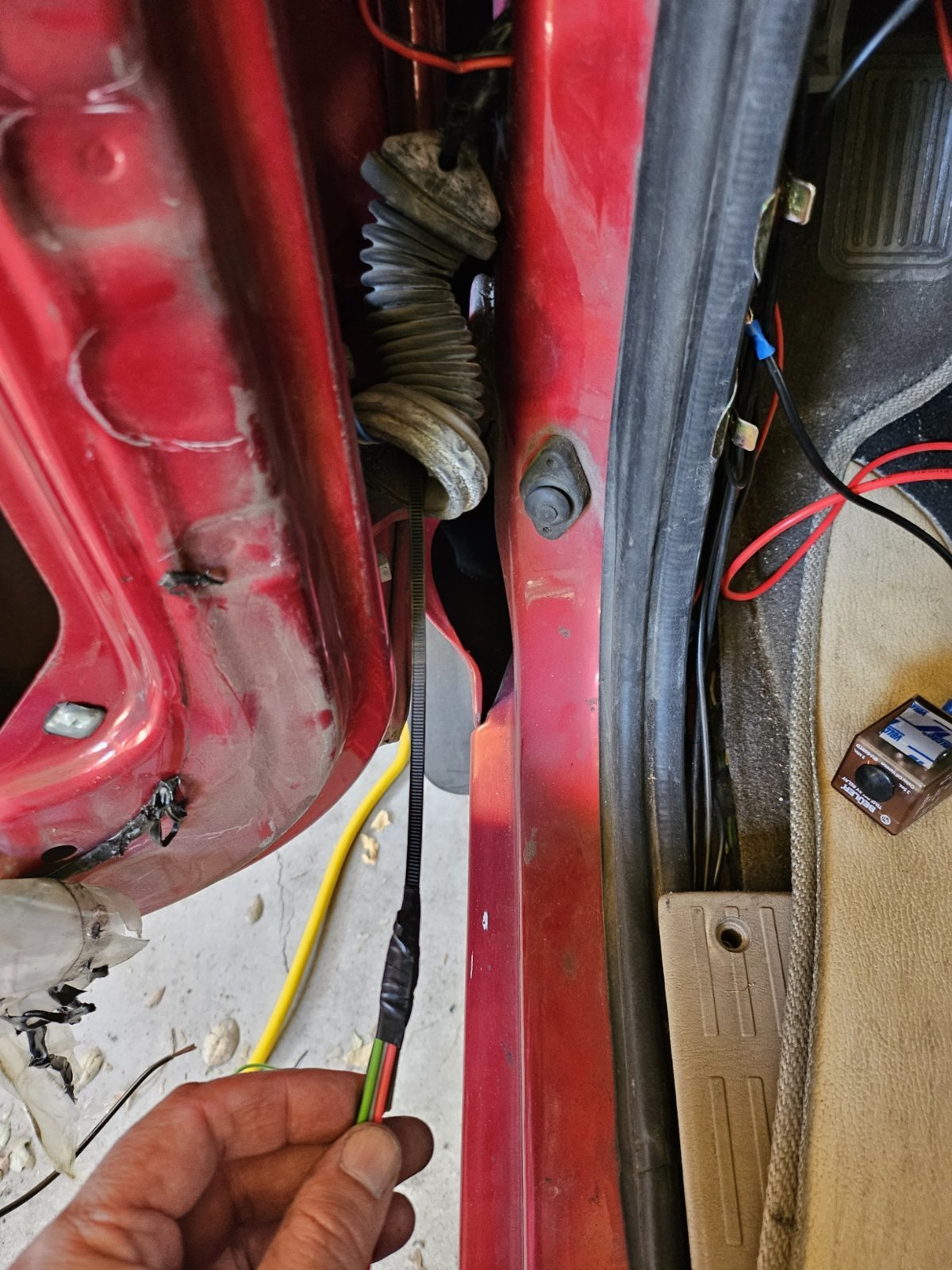

    project day..
    The 5 screws for the panels arrived while i was doing it. Make sure they are in your switch kit if you do this.
    Also the A1 window kit says that the old manual windows are held in by 3 bolts, but the new one takes 4, and they dont give you that 4th bolt so head to the hardware store and get a few very short M6 flange bolts.
    So far i have the hardware installed, just need to tidy up and connect the harnesses and zip tie stuff. Also, you will ruin your doors water barrier so have some plastic handy to replace it. Hardest part so far is using a zip tie to snake the wires through door panel, into rubber grommet, then into cab. more to come..

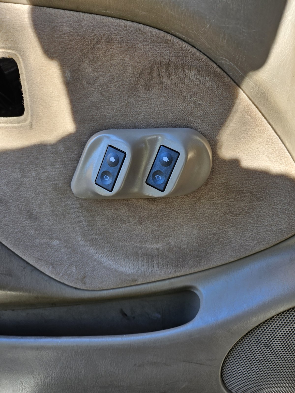

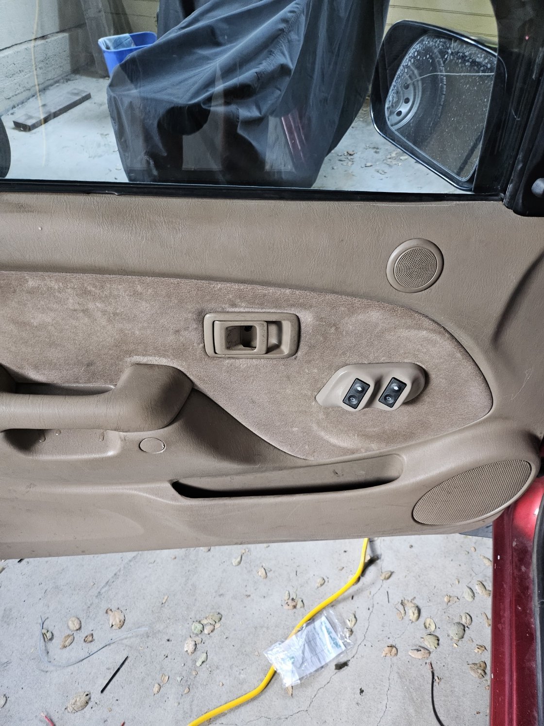

    All done. A few quirks, the drivers side control for the passenger window is backwards, still works fine I'm just too lazy to rewire it. That time delay relay i got for it is not staying on after i cut the ignition so i need to figure out why. The A1 guide says the LED lights on the switches are green, they are not, they are white. It was hard getting the drivers door panel back on since the switch harnesses exit the door out the bottom and you have to get them laid flat it the door wont click back on.
    Make sure every time you connect the harnesses you check for wires that get pushed out by accident, push them back in.
