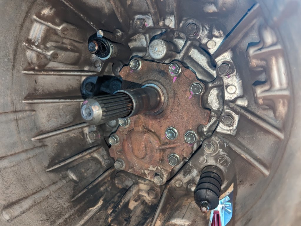

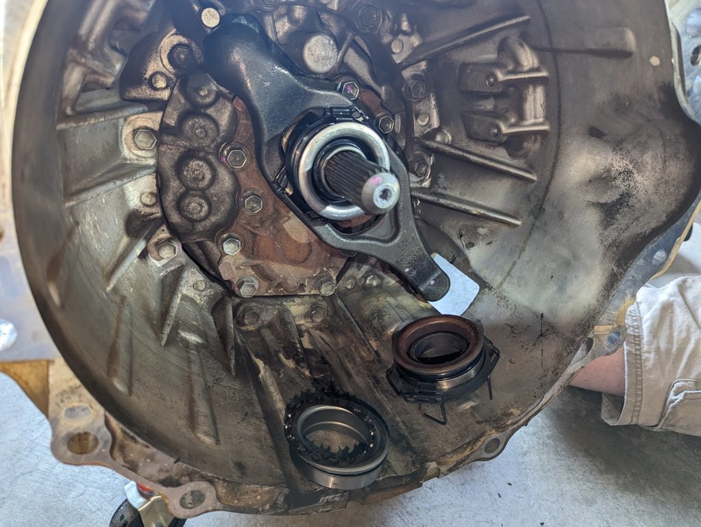

    Sorry for the trouble. Note that there is no fork bearing. Just a pivot pin on one end and the slave pin on the other.
    BTDT. I have replaced three TOBs so far. First at 88k, then every 10k afterward. Each time, I lubed up the pivots.
    Tore down the first TOB and found it was bad. The second was returned under warranty. I have not taken the third on apart yet, but it didn't feel good even assembled. You can see the Red Death of it in my quote below. Only 15k on that. Got some extra mileage out of it after pulling the slave spring.
    If you have this recurring problem, I would suggest trying the slave spring removal. It is an absurdly strong spring:
    https://www.tacomaworld.com/threads/no-slave-spring-mod-nssm.839250/
    This last time, just a few weeks ago, I swapped the friction disk and pressure plate. I found at least two of the PPs bolts were on the loose side.
    Good prices for the kit on Amazon that appeared to genuine Aisin parts.
    Just in case, you can see the pivots that the fork rides on:
    Fork in with some of my bearings. Haha!
