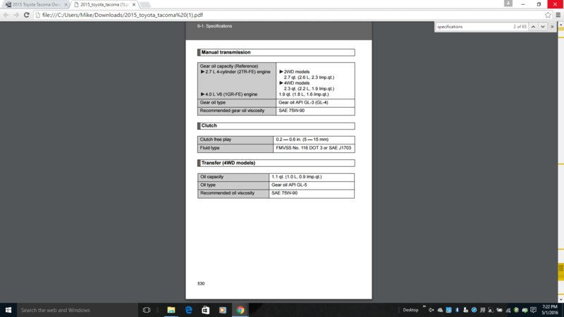

    How many quarts of Redline MT90 should I need when draining and filling the transmission?

    almost 2 or 2 qts.

    I thought it was 3.15 quarts...I ordered a gallon of MT90 just to be safe.

    Go to -> http://www.justgivemethedamnmanual.com
    Select Toyota - then yr/model you are working on. - download - go to -> Specifications. Your question will be answered when you get to that section of the Owners Manual.

    Interesting...the manual it pulls up only shows automatic transmission, not the 6 speed

    Every Owners manual I've every accessed thru that site had both manual/automatic info

    2015 Tacoma owners manual

    Thanks, must have overlooked it
